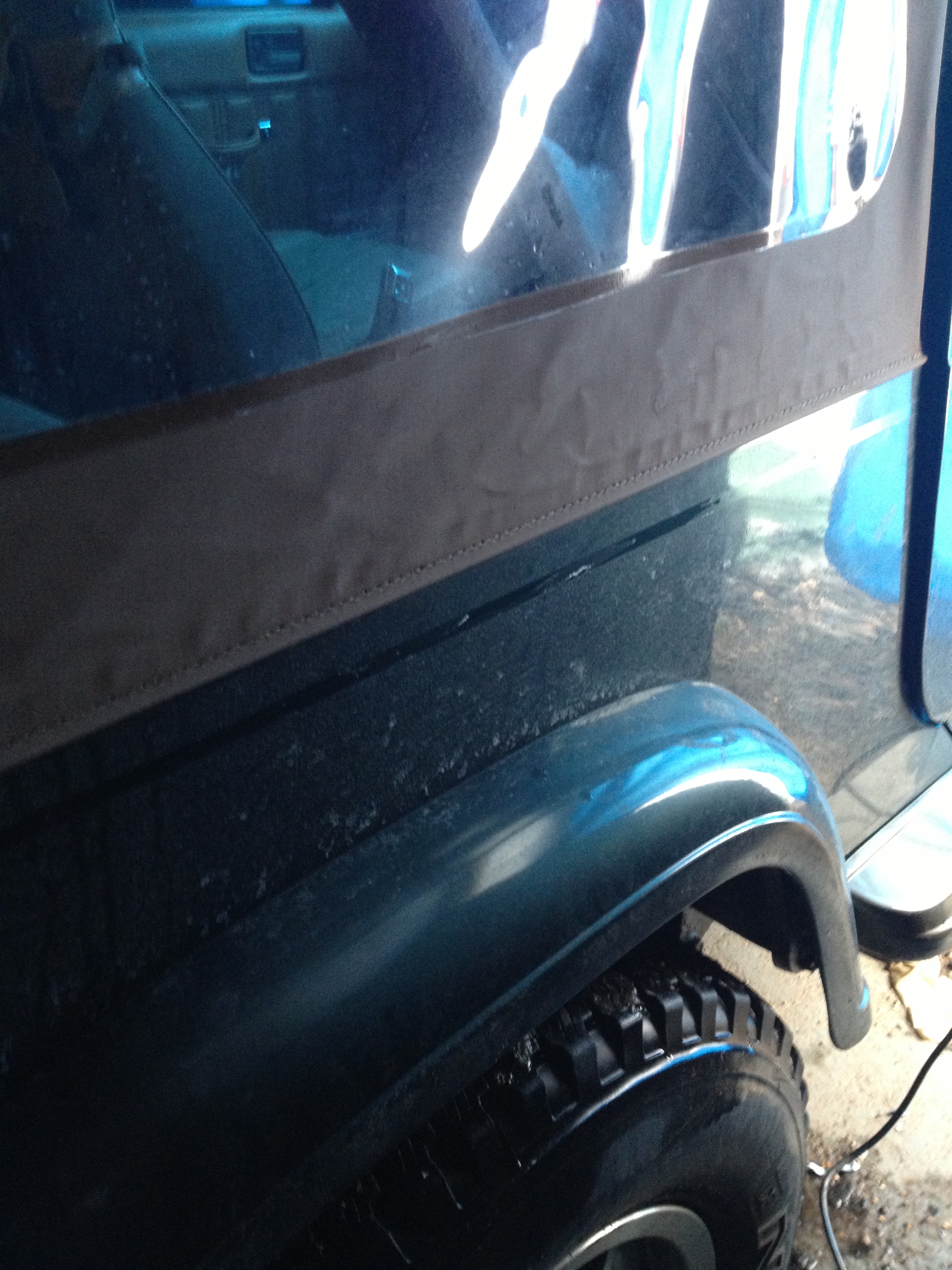

i sold the hard top for £340 ($544 USD) a lil less than i wanted but its gone as i couldnt store it! I used the the money to buy the best top supertop spice.
i know its not the "movie correct" one but it means i can run full doors in winter and halves in summer, as its my daily drive. Its super tight love it.

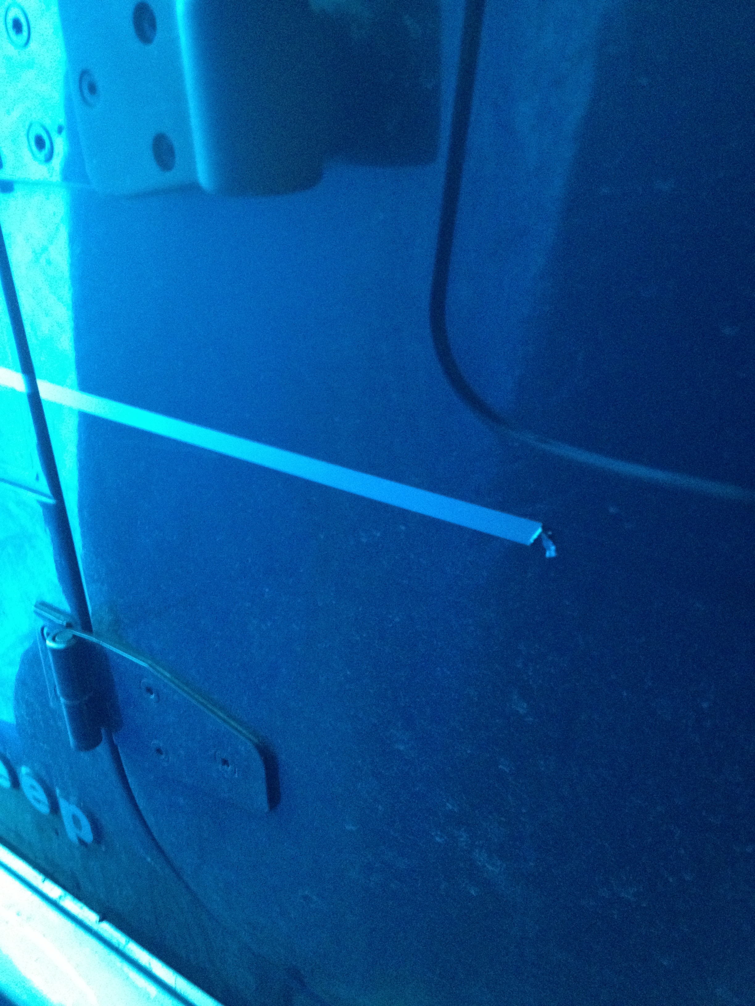

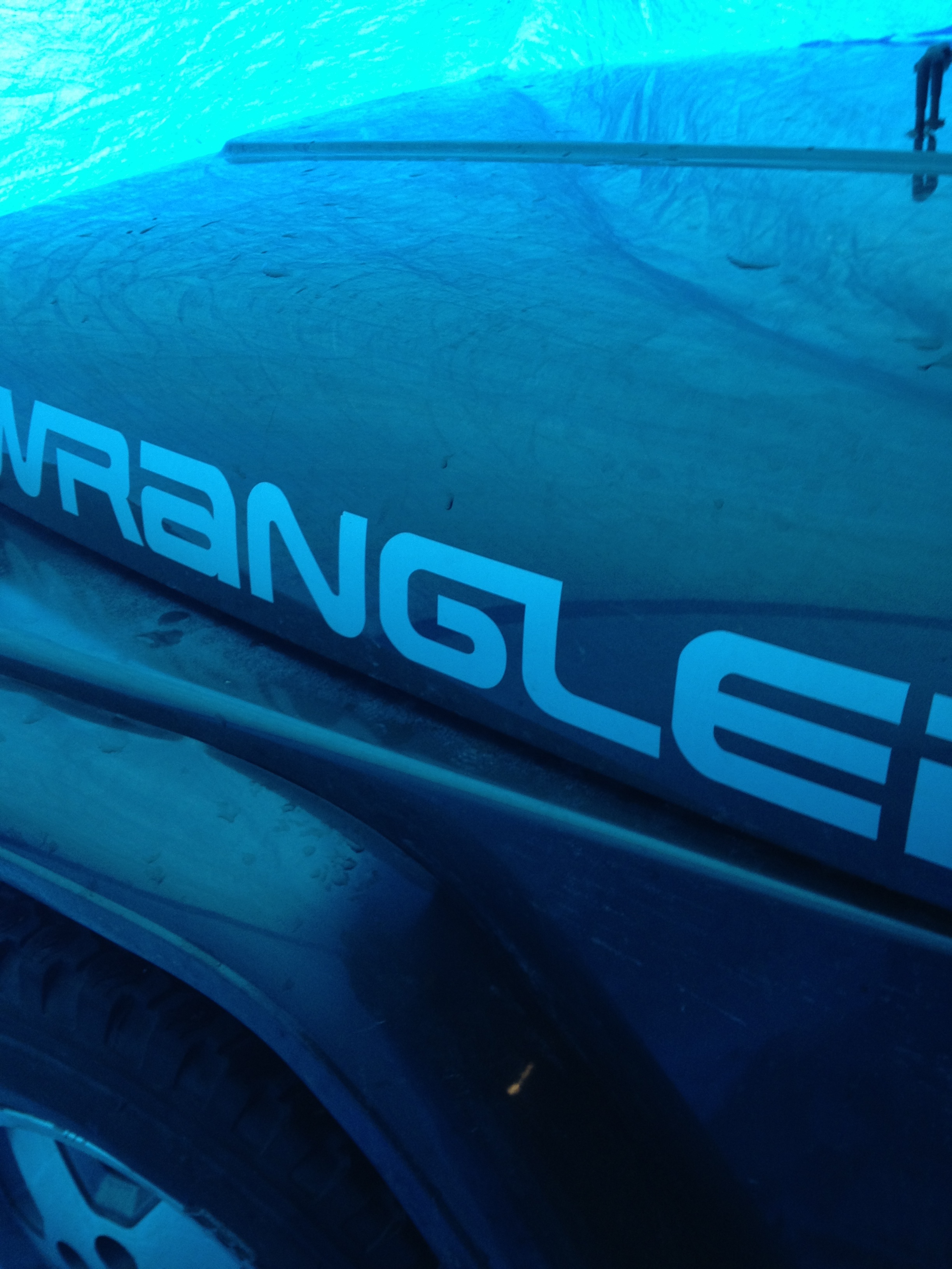

while i was waiting for it to warm up in my friends warehouse i used his heatgun to get the sickers off. all gone, just a bit of glue left but thats gonna go when the paint happens. getting that sorted soon a guy next door to where i was is getting me a quote. he seemed excited to be able to do it too.
before and after shots
