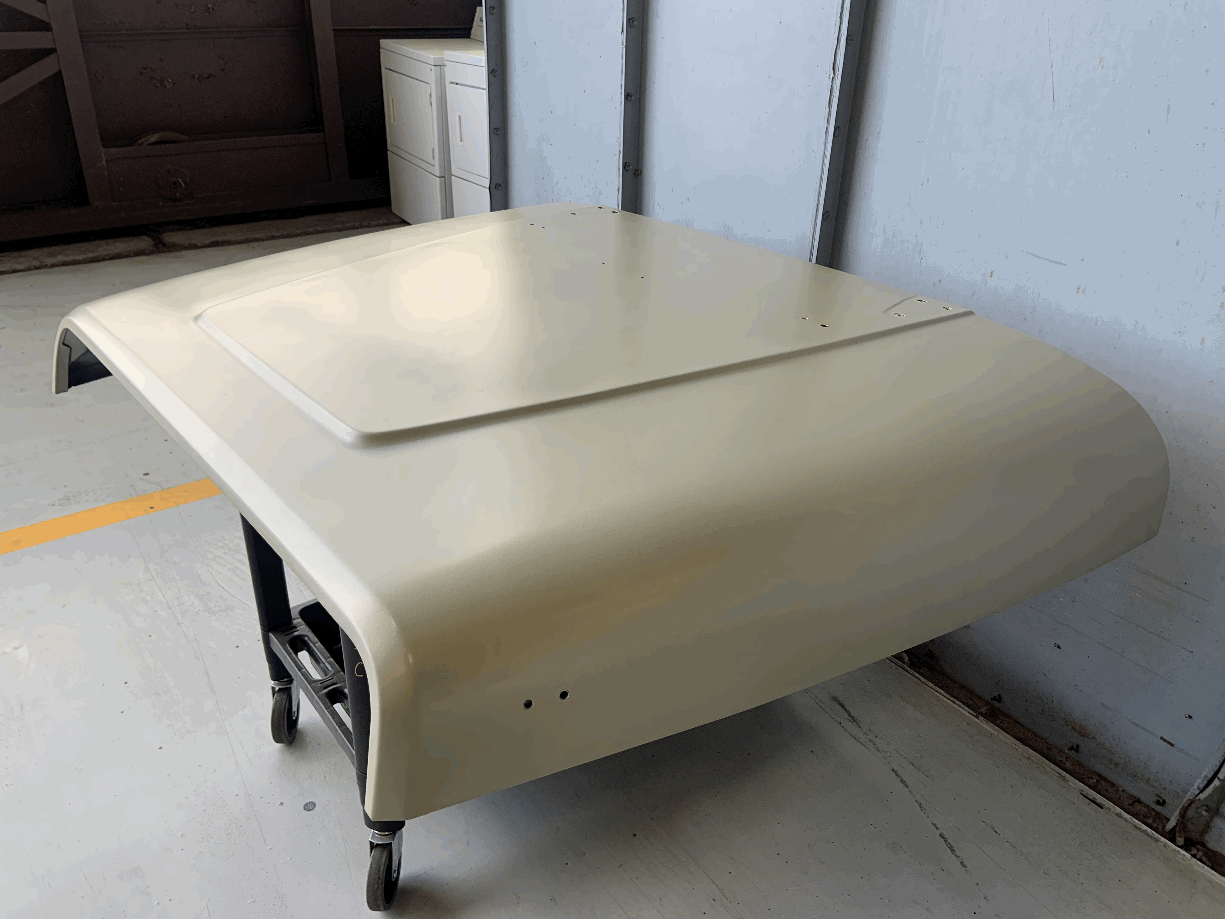

Post by Dwight » March 9th, 2022, 9:08 pm
Something about that fresh sand beige....

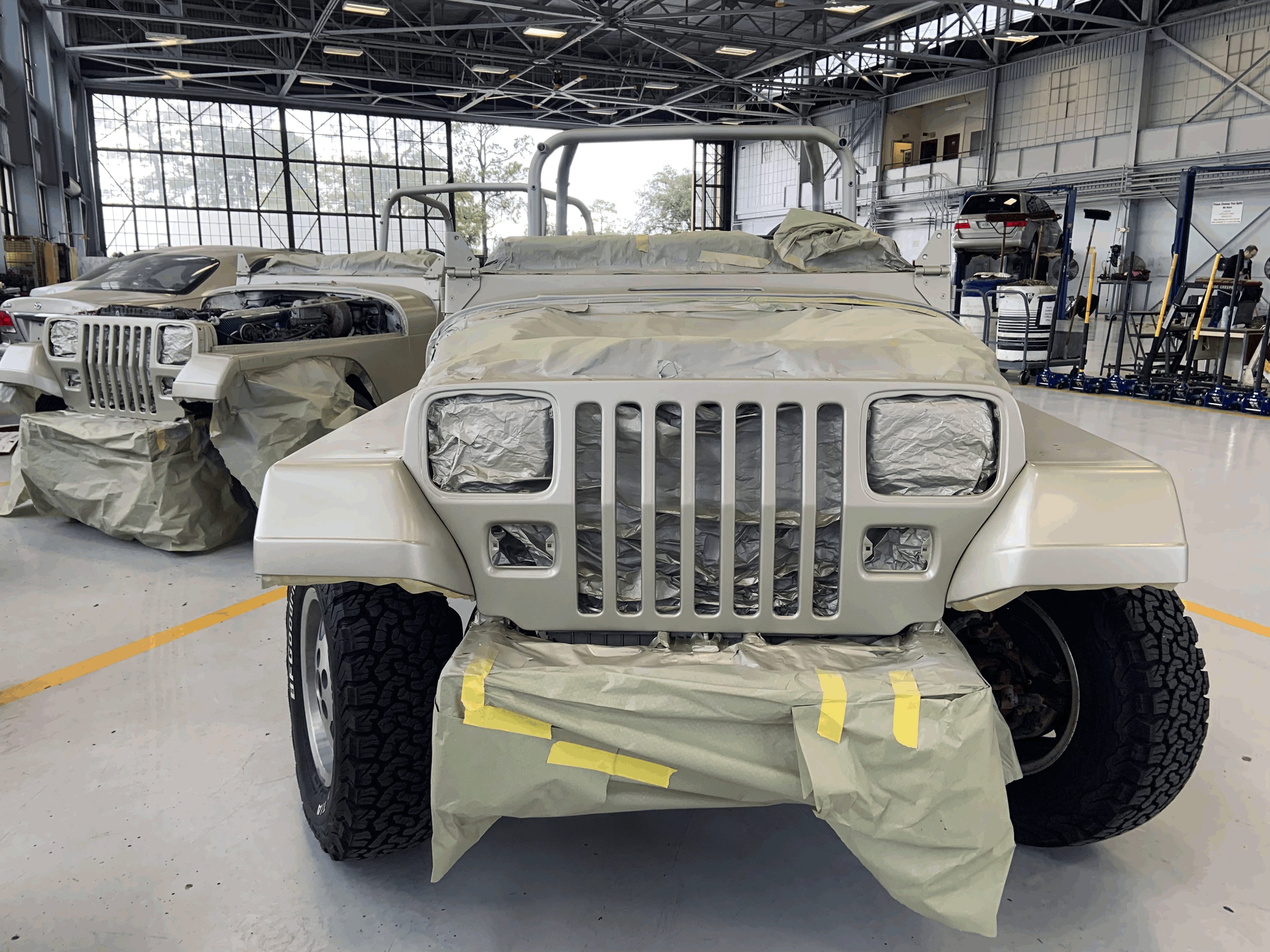

Post by Dwight » March 10th, 2022, 7:57 pm
Just dropping another photo, but this time with both Jeeps. To say it's been a heck of a week would be a massive understatement and there's still Friday and Saturday to go. I thought sanding and masking two Jeeps was exhausting....Well after taking a closer look at my Jeep once it dried, there were some areas that had a "gritty" feel to them. We think the weather was too hot for the reducer we used and the paint was drying too fast during spray. Regardless, I went over the whole Jeep again with a red Scotch pad and then over the whole thing again with 800 grit sandpaper to get that gritty feel out. After another 2 coats this morning, the Jeep looks and feels great. I'm much happier with the result and glad I took the time to re sand.
Jeep #2 turned out great as well. Tommy will have much better before and after photos for his Jeep. It's come a long way and I'm sure he will share some photos over on Facebook.
Tomorrow we will be doing the fender flares with Sherwin Williams P30A primer since it has an added flex agent, and then with sand beige. Cracking and chipping paint on the fender flares have been one of the biggest pains of these Jeeps since they flex so much, so we spent a little extra money to hopefully help alleviate that problem in the future.
Saturday will be spent putting things back together such as the hood, flares, etc and getting the Jeep ready for masking off the stripes.
While I love the process, its been extremely stressful and I'm looking forward to it being over so I can just drive and enjoy it.
