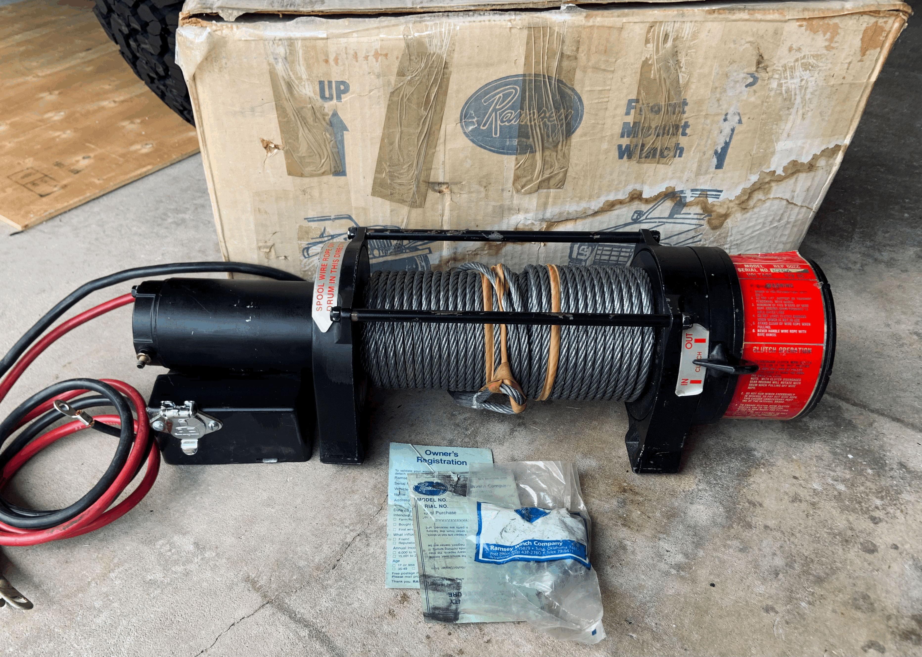

Picked up a new in box REP6000. Not every day you come across a 20+ year old winch that's never been used. It's going to sting a little, but I have to change out the decals and add chrome tie rods to make it more accurate.
I already sold off the other REP6000 that I had in order to offset the cost of this one.
