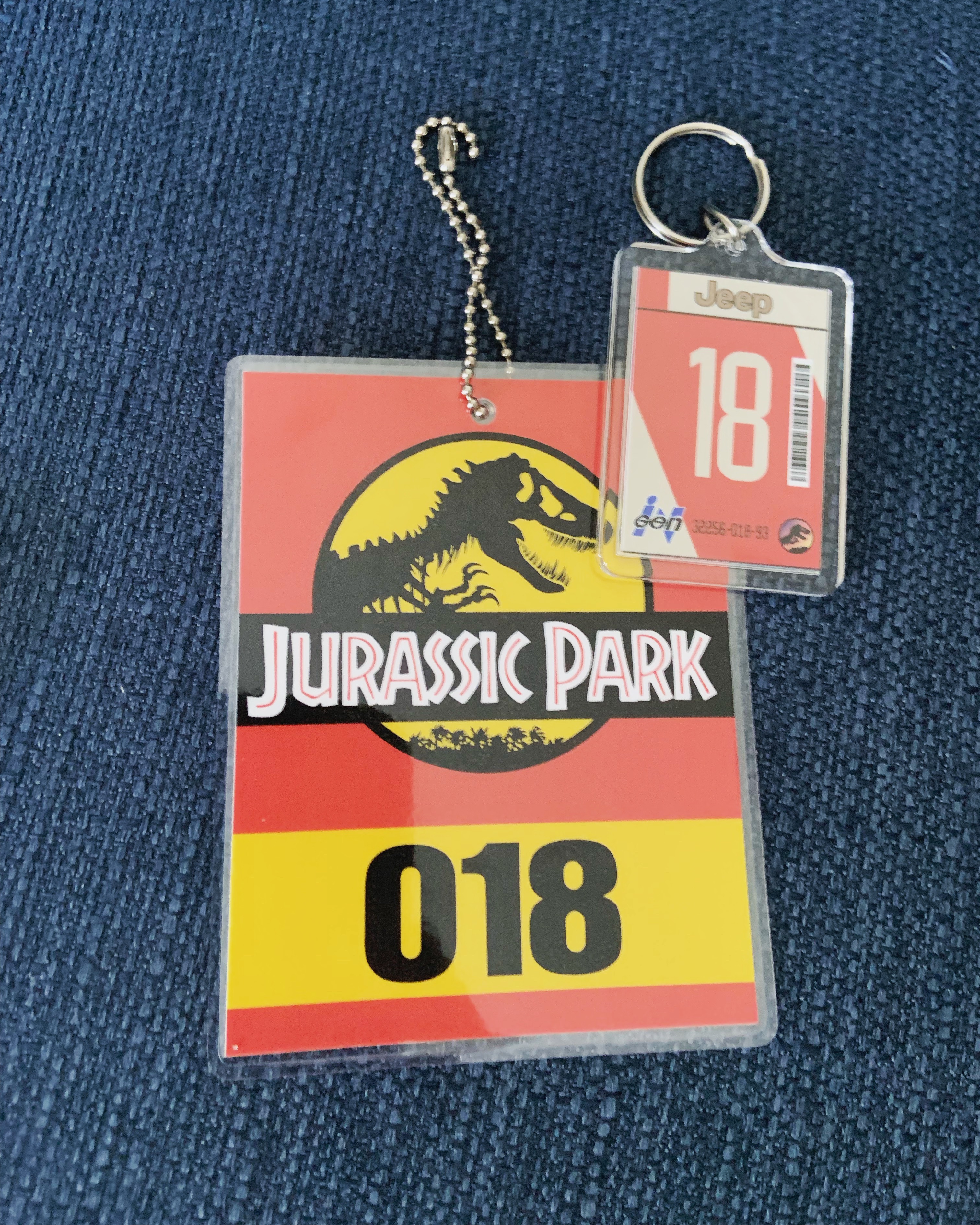

Also, my Mirror Tag and Key Chain came in from JurassicParkProps on Etsy. He does quality work and even the key chain has a nice little touch. The attention to detail made the purchase more than worth it. I mean I'm sure I could have made my own mirror tag but I don't mind supporting our members at all.
