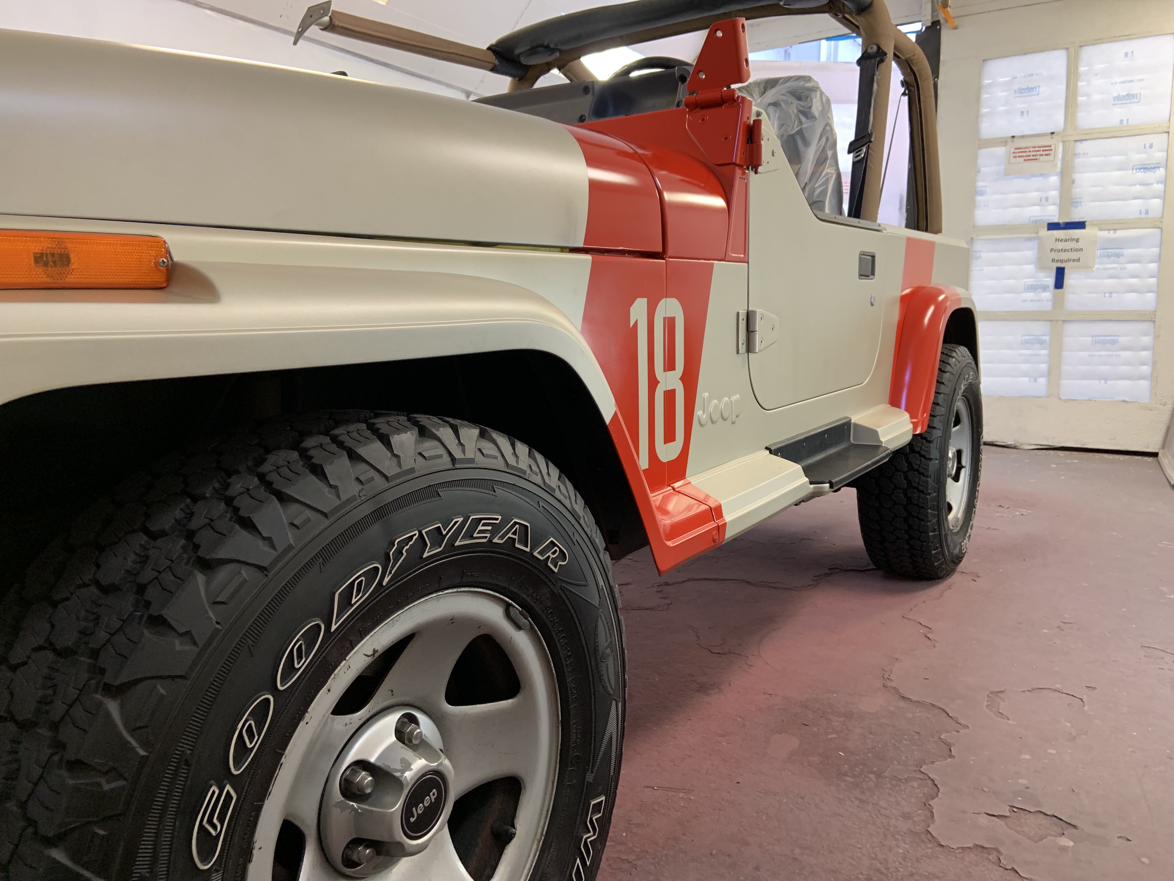

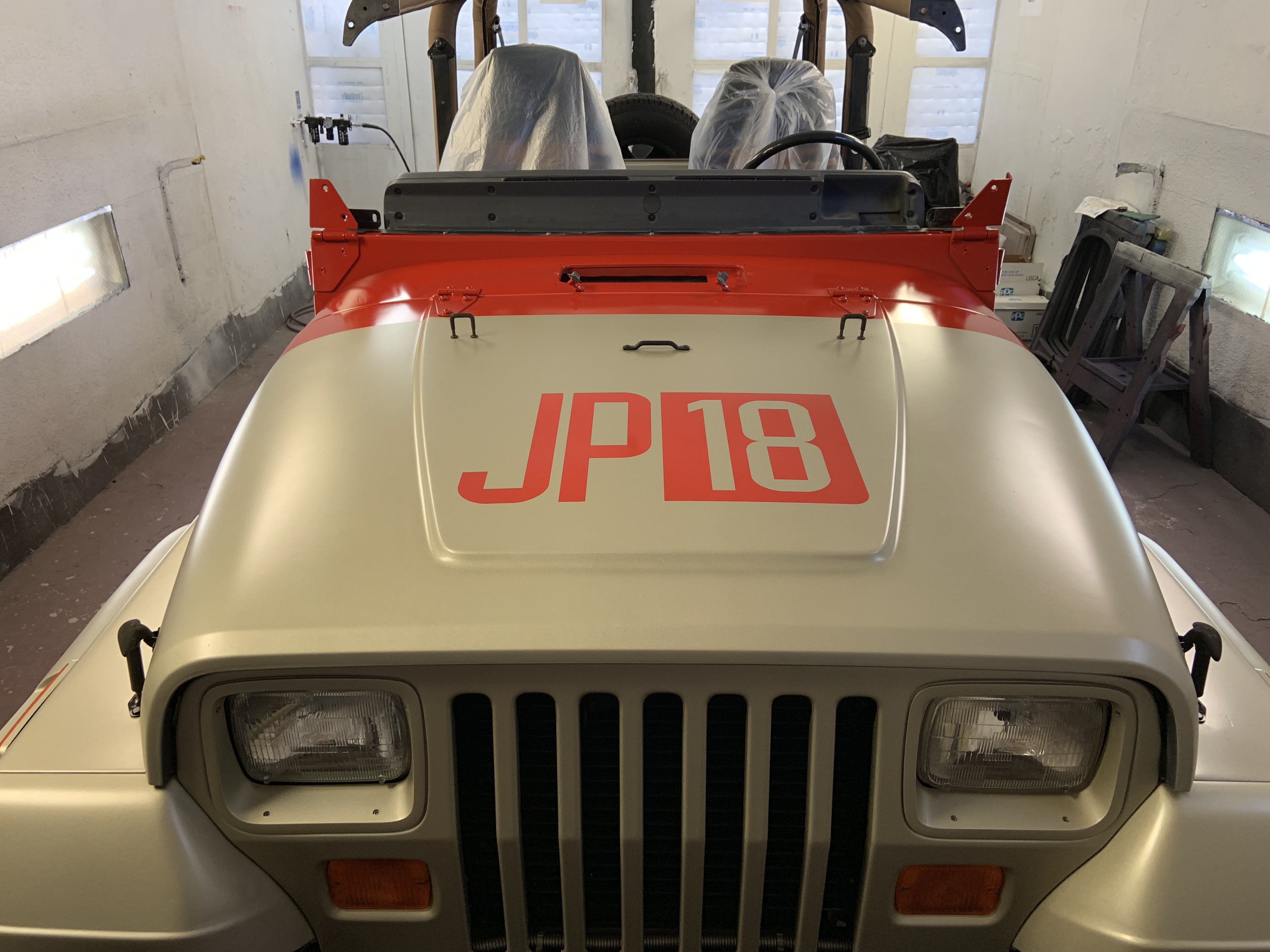

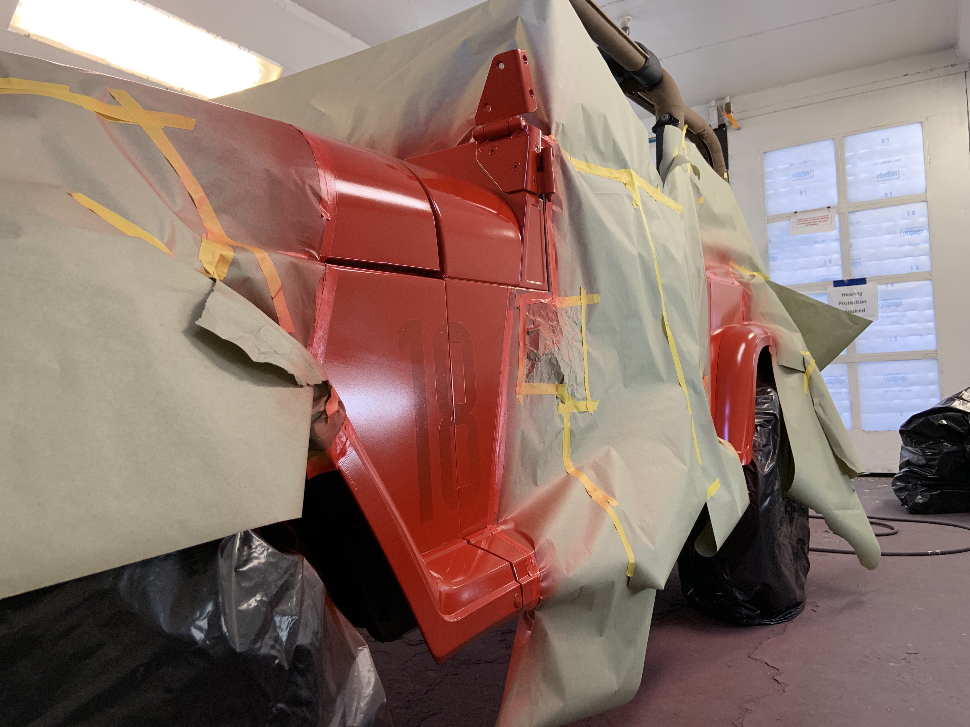

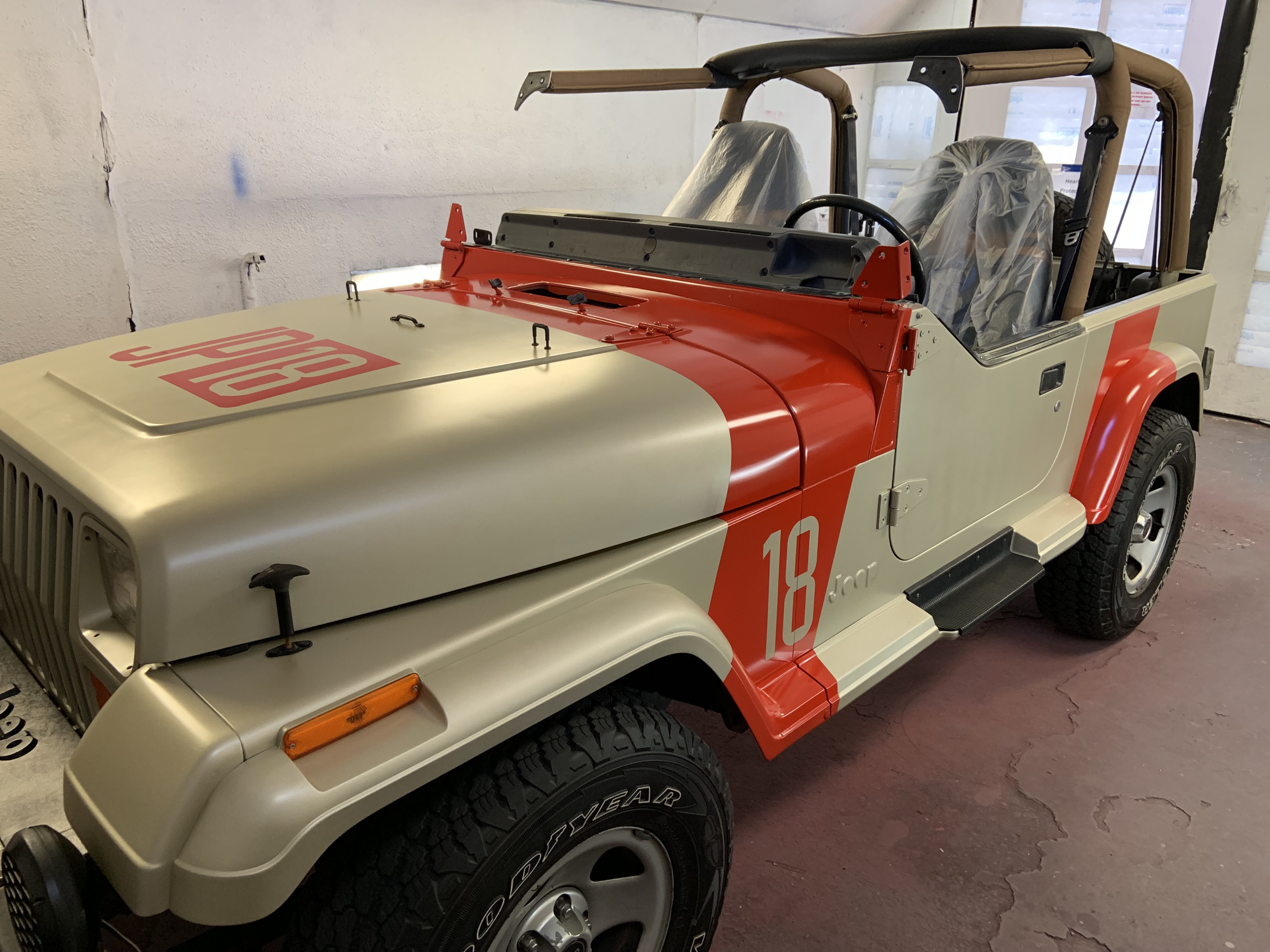

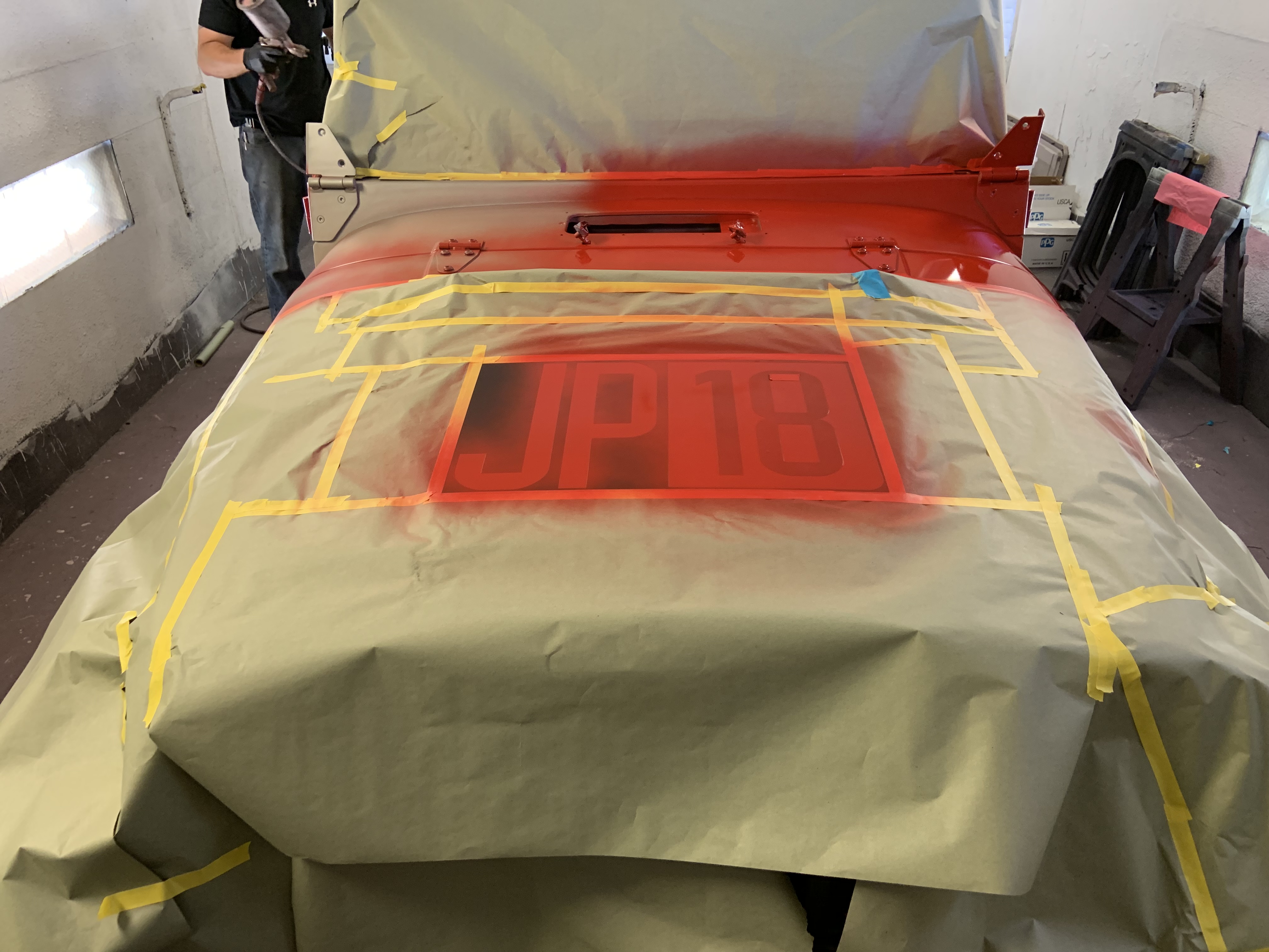

JP18 finally got her numbers and red stripes today. Was definitely more tedious to mask everything off and get the stripes as close to screen accurate as possible, than it was to actually paint.
Letting it set in the paint booth until Tuesday, then i'll be installing the windshield/light bar, side mirrors, door decals, license plates, and rims. Should be looking near 100% come next week. Still need a few odds and ends like the whip antenna, winch, rear fogs, etc, but those will come with time.

I appreciate the feedback! I made sure to do as much research as possible before starting the conversion. We painted the entire Jeep Sand Beige, then before laying the red down, masked off the back side of the windshield. Definitely would look weird if the back of the windshield was red

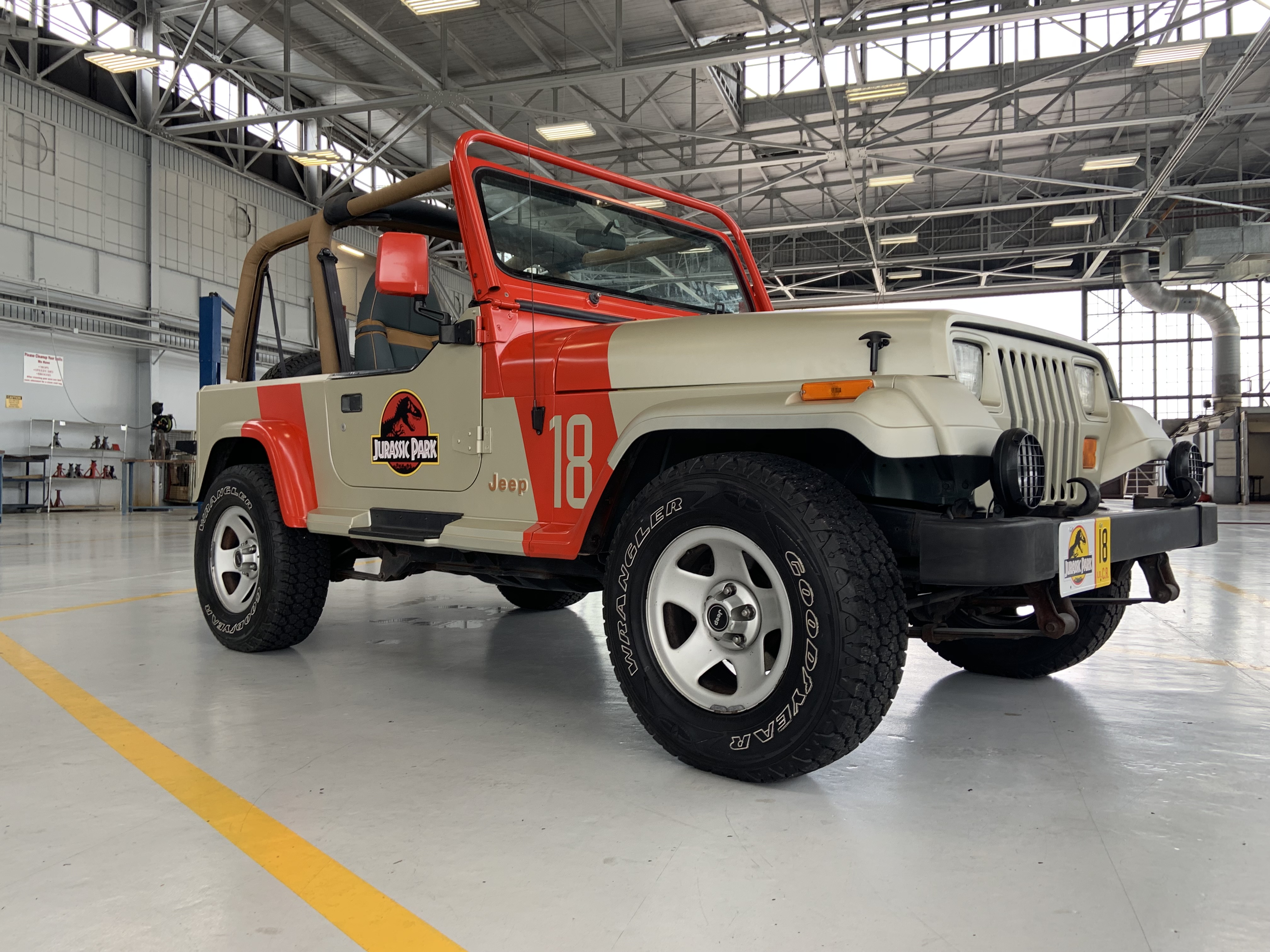

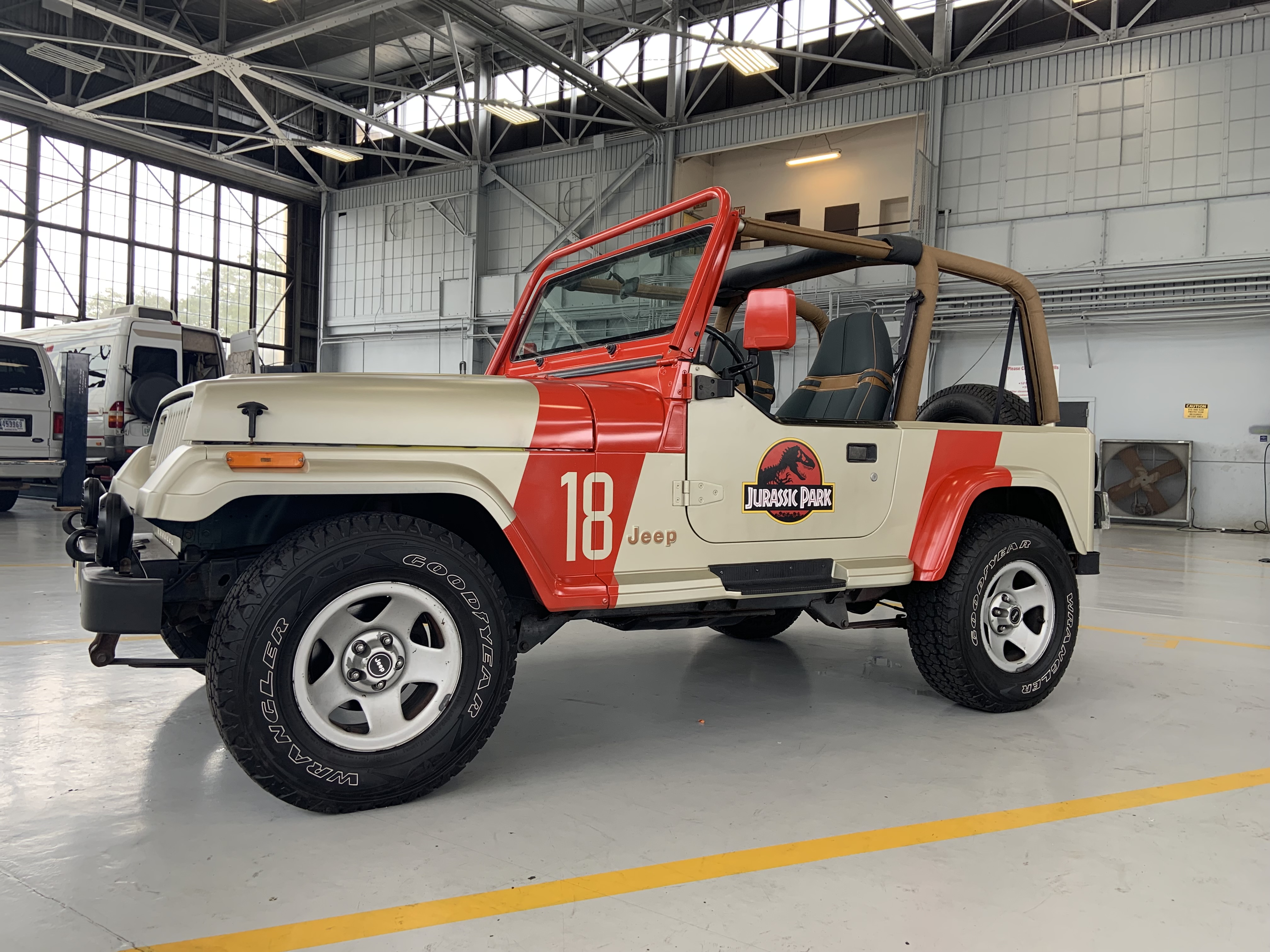

Got most of JP18 put back together today as well as the decals put on. Looks so much more "Jurassic Parky" with the decals. My 5 BFG KO2's should be here Thursday and i'll have my red rims mounted then.
Other than that, I just need to get a Ramsey 6000 Winch and plate, whip antenna, rear fogs, and rear view mirror tag and she should be good to go! Feels like everything is coming together nicely!
