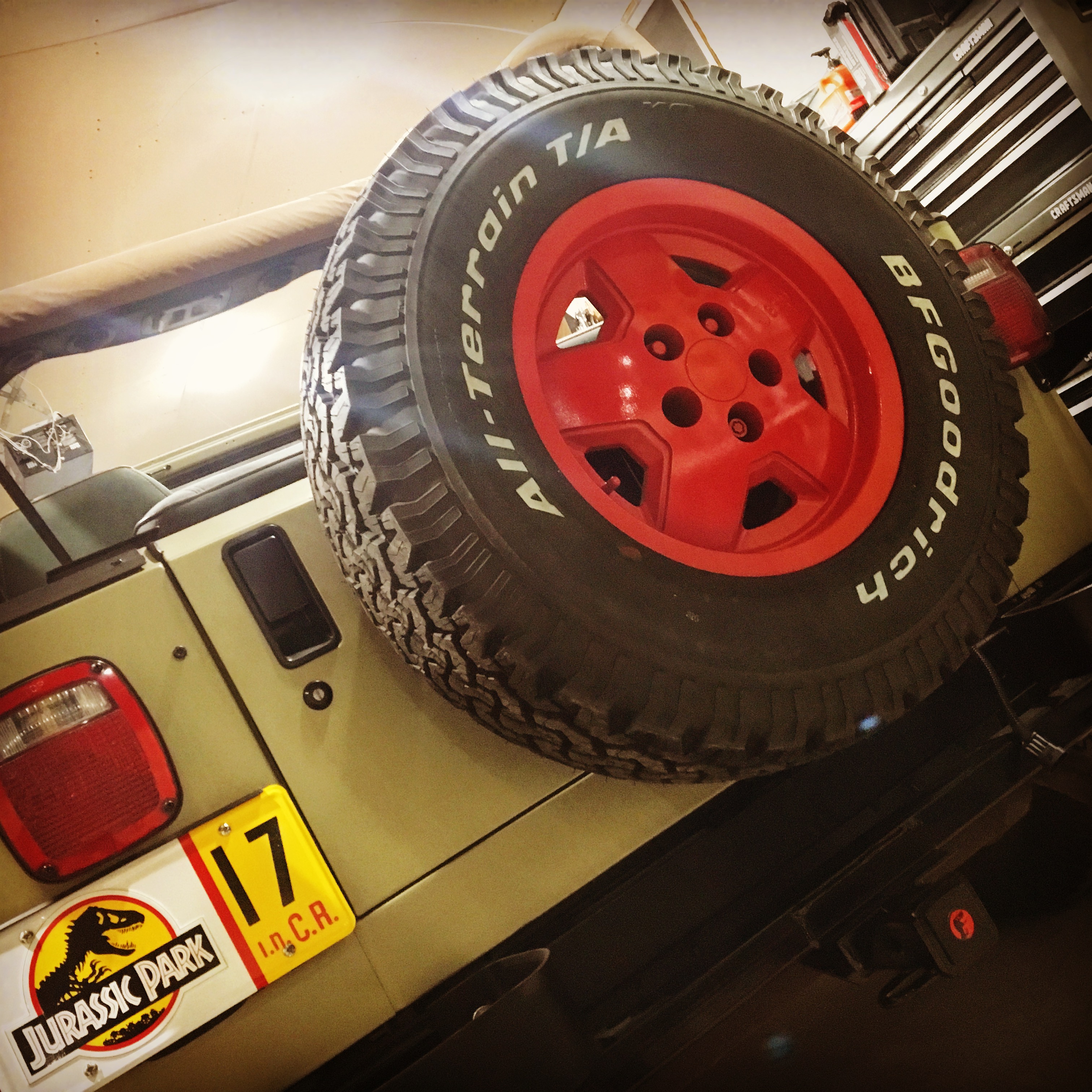

Bluetooth stereo is wired and installed. Spare tire is mounted. I'm extremely happy I went with 30" tires!

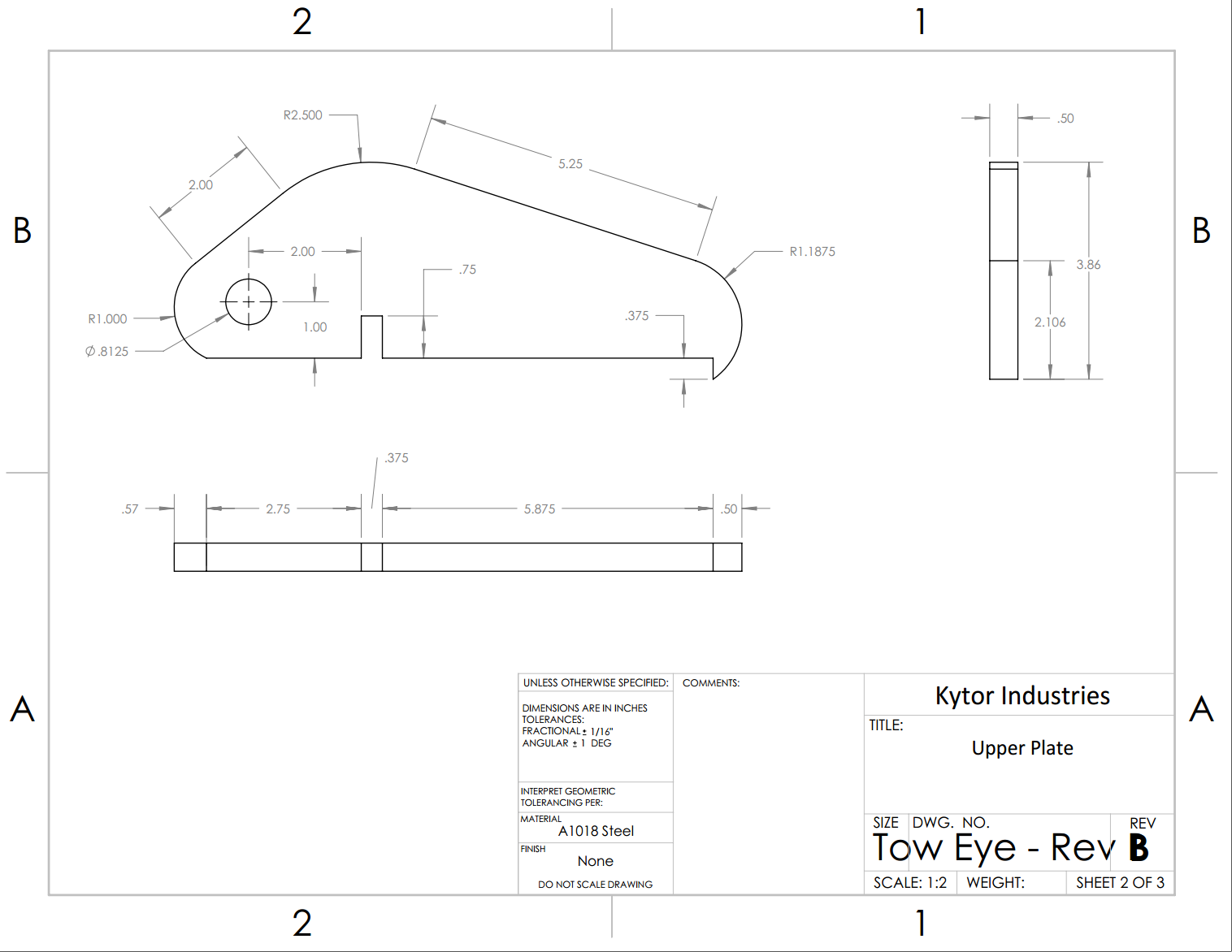

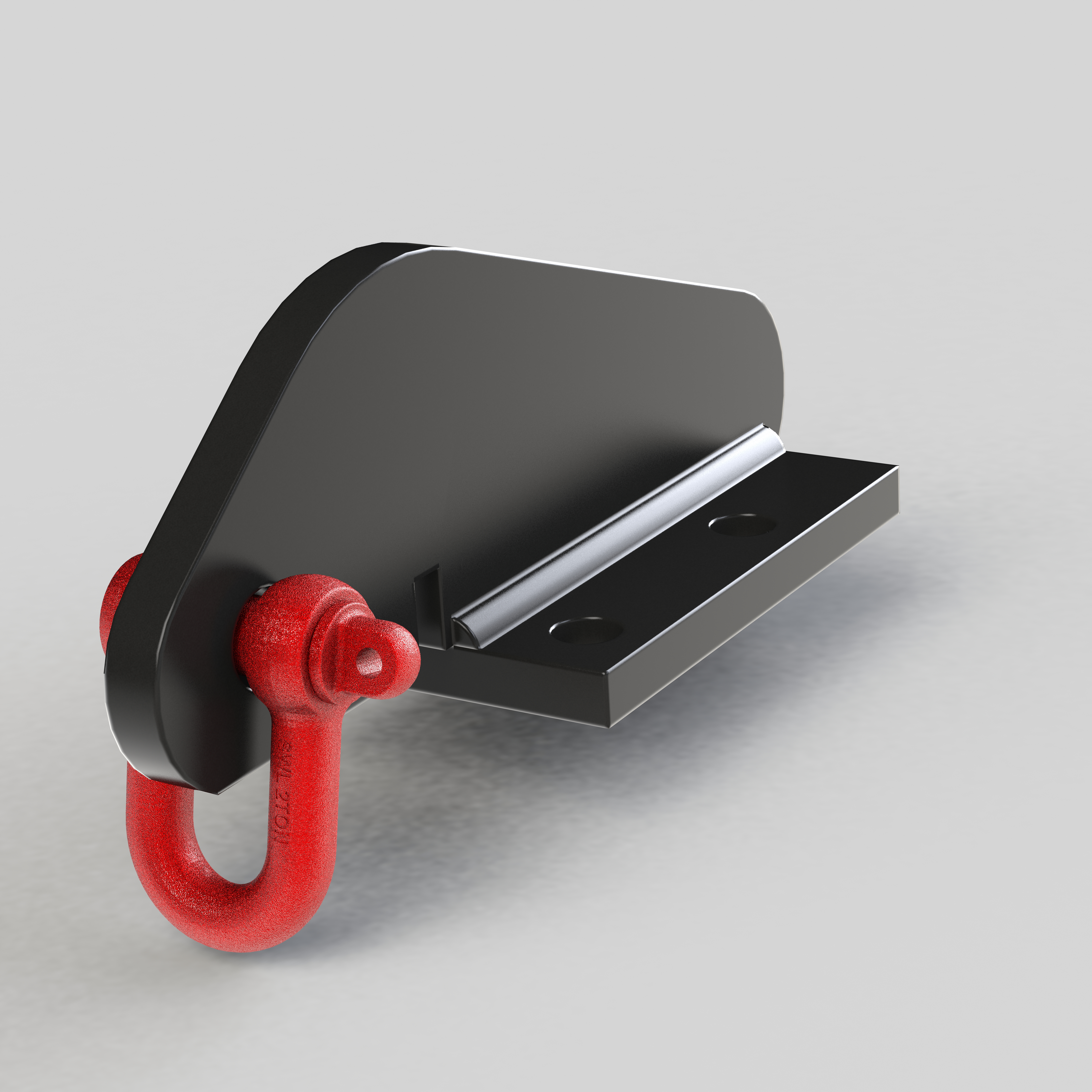

The rapid prototype arrived. The bad news is that it needed modification (which I fully expected). The good news is that it's not that far off and I've drafted the final revision for production.
A very tight fit, it needed some modification...
A miter saw made quick work of the 3D print!
Dimensions revised and validated with a RAPIDER prototype.

I always choose those connectors as well. Perfect choice! Also now that you have the model and a 1:1 print for the tow hooks, think about making them with a track torch. Its the cheaper choice. Its a blow torch on a electric driven track. After, you will have to use a belt sander to clean the edges.

ratrace427 wrote:I always choose those connectors as well. Perfect choice! Also now that you have the model and a 1:1 print for the tow hooks, think about making them with a track torch. Its the cheaper choice. Its a blow torch on a electric driven track. After, you will have to use a belt sander to clean the edges.
I'm probably just going to bench-build them myself with a handheld plasma cutter. It won't be perfect at first, but I can grind down the imperfections easily enough.
I updated the first post with the latest drawing revisions for the fog lamp bracket, tow eye, and light bar.

I can see a plasma cutter working great, even better if you had a guide to follow. Keeping the cutting head 90 degrees to the working surface will require a steady hand. I have not been keeping up but once you are done we might be the only two guys with the tow hooks. good work!
