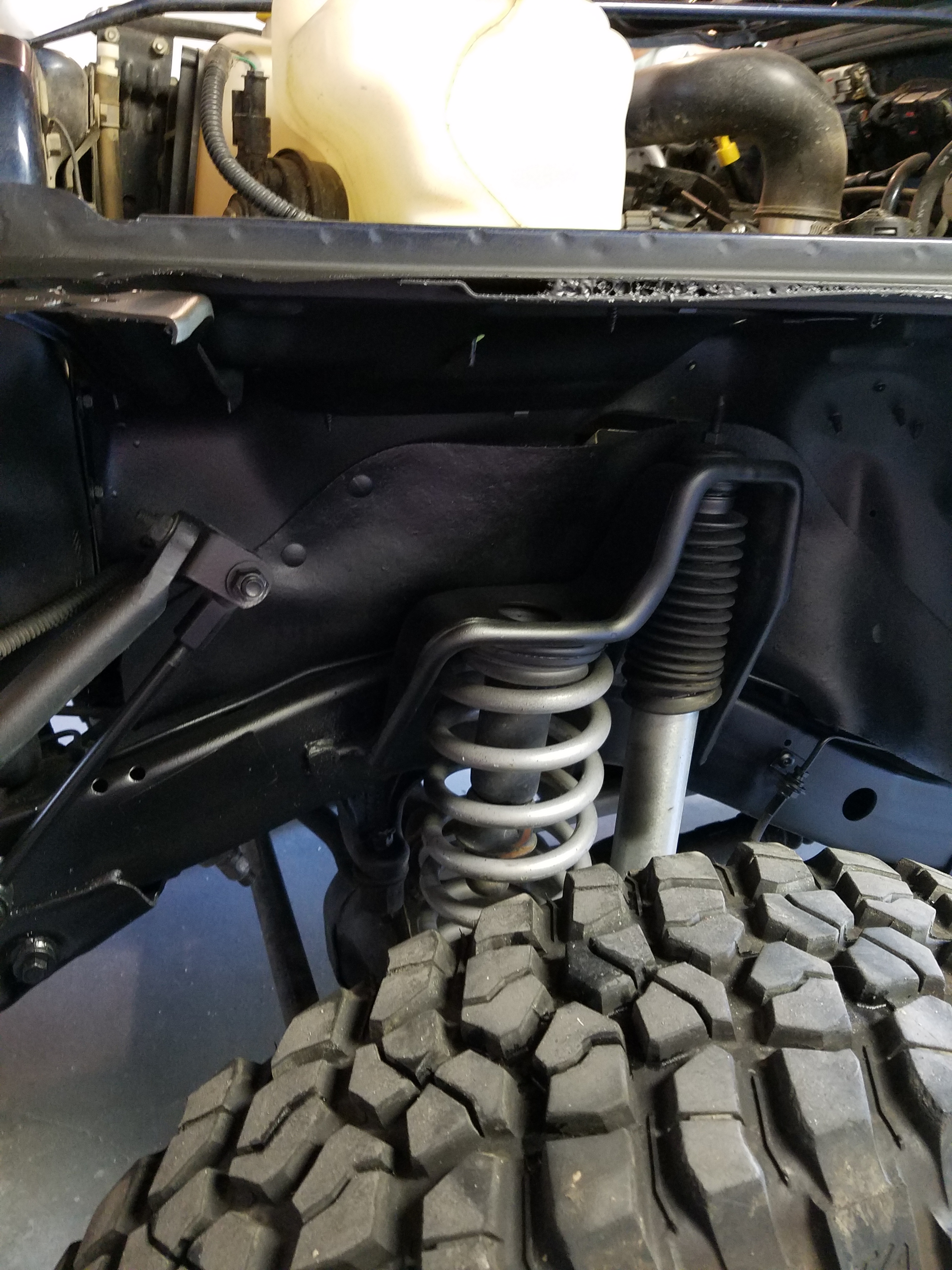

Here it is torn down prior to sanding. We fit the CCFabs hoodline fenders, then removed them for undercoating.
Also put some undercoating on the inner fenders as well, after the plastic was removed.

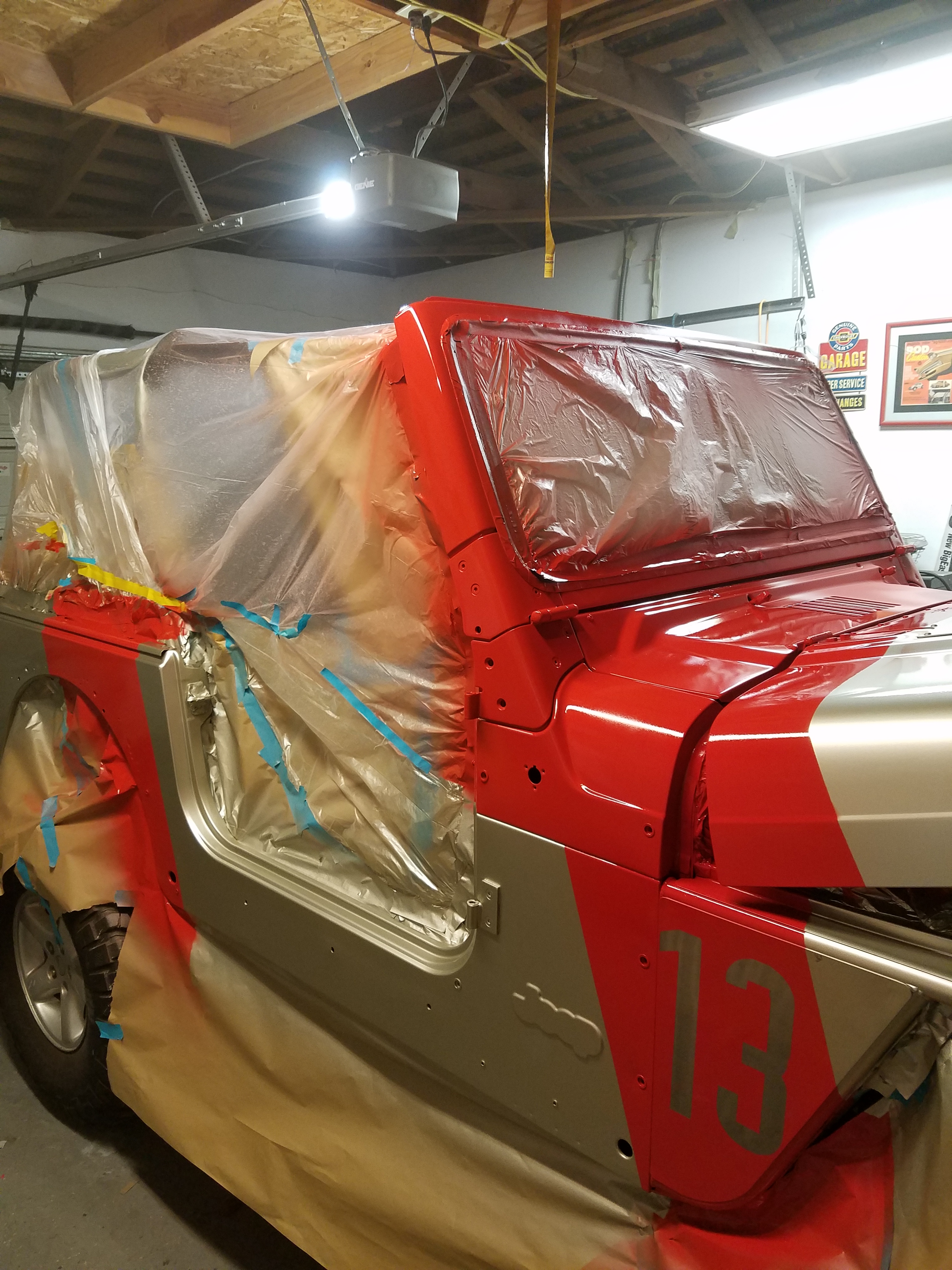

Then came a whirlwind of sanding, fitting parts, then finally PAINT. Prep work takes a long time, and it feels like you're getting no where, but once that first coat of paint licks that metal, it's all worth it.

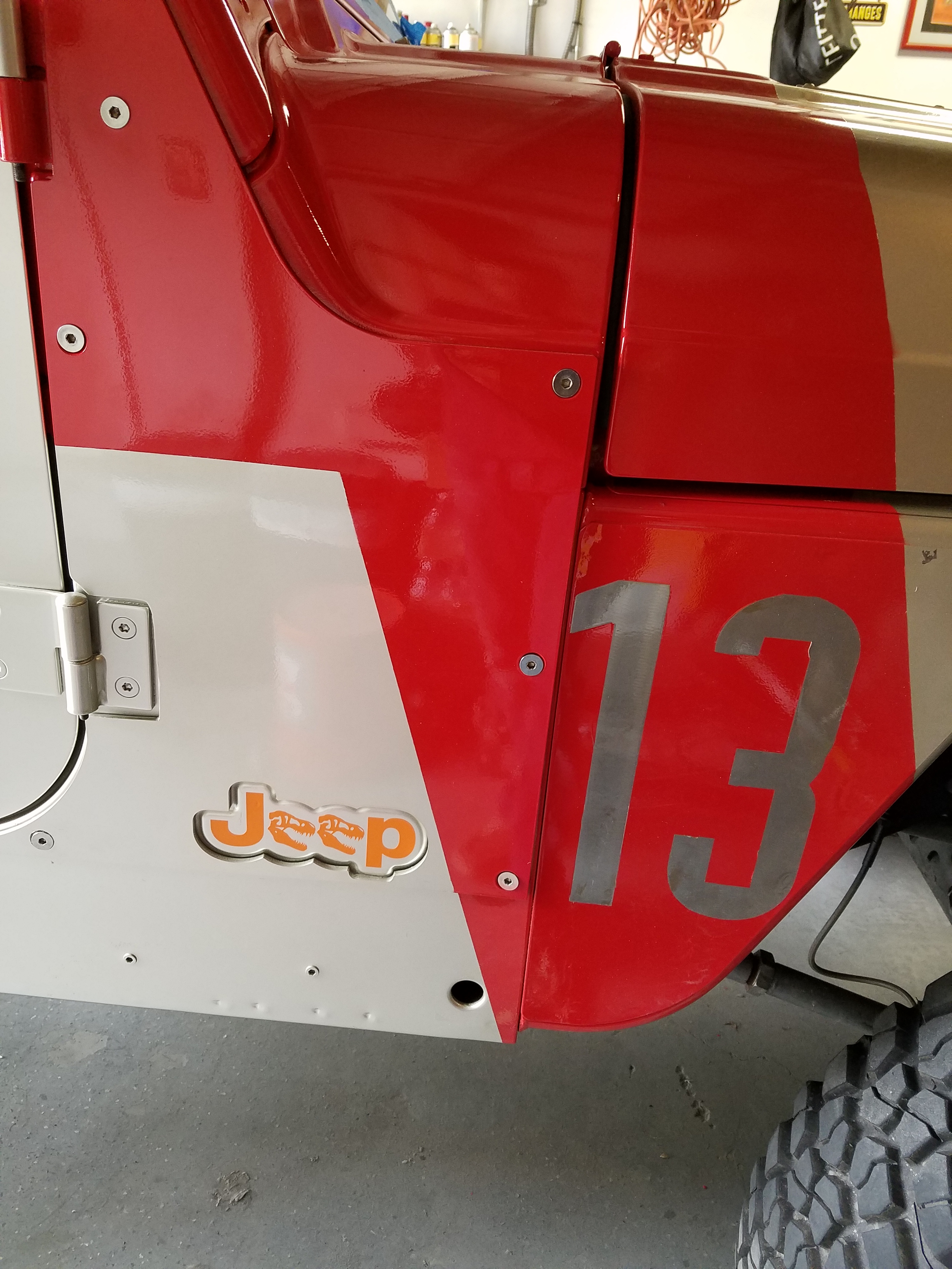

Once the beige dried, we made all the measurements using a protractor and painter's tape. We also laid all the stencils. We chose to let the bare metal show through on the fenders and the hood. We took a few artistic liberties because, after all, it's a TJ, not a YJ.

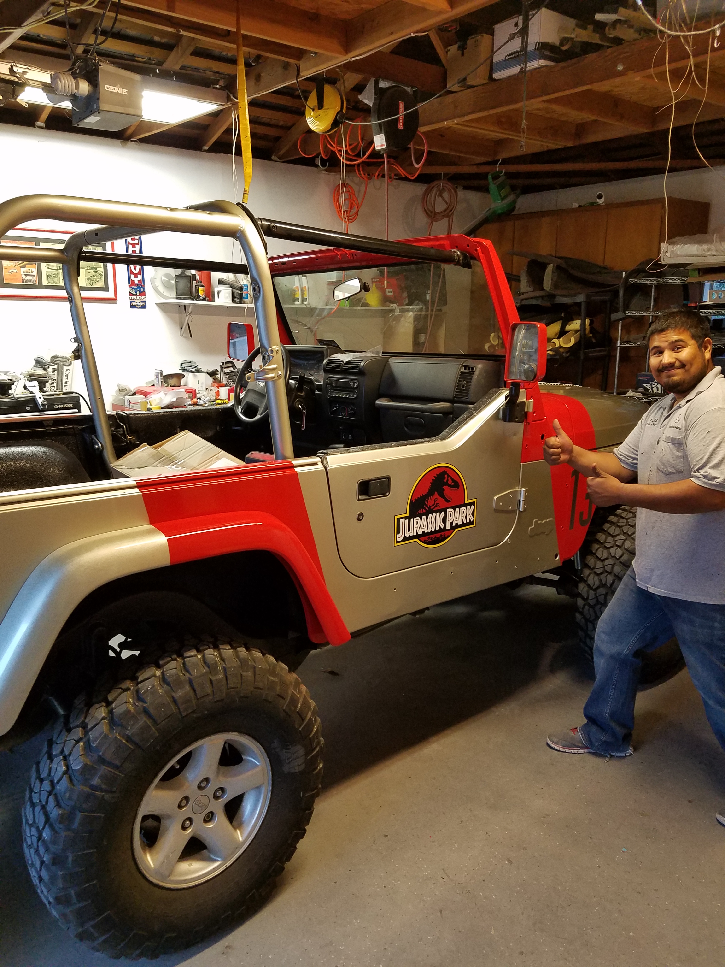

Probably the most gratifying part of this entire project was putting those logos on the doors. Those half doors with the JP logo make the whole thing. We also installed some Rugged Ridge Light Bar Mounts, and a $60 52" light bar from Amazon that works pretty darn good. Pictured there is JD, the master bodywork/painter. You can hardly tell any damage occurred even if you know where to look!

And here is the finished product, although we all know that there is no such thing as a "finished" Jeep:

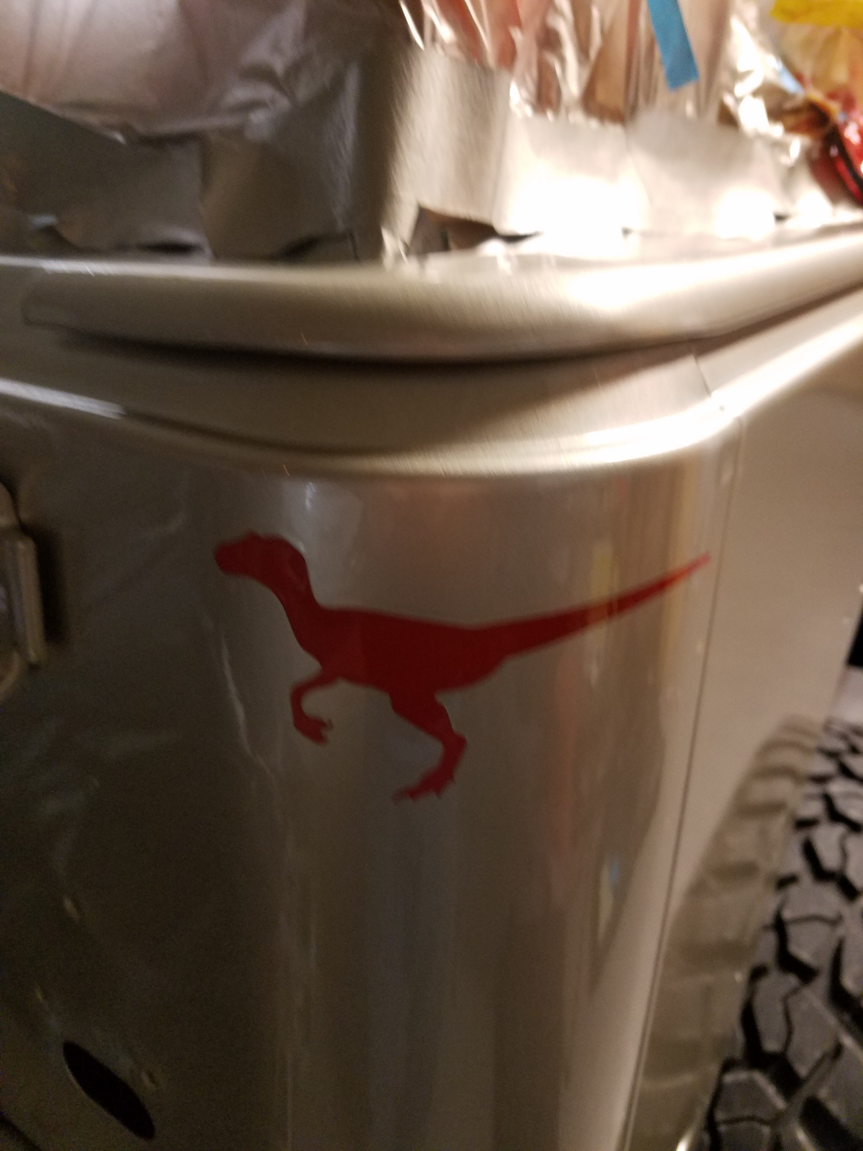

-Performed Jurassic Park Jeep Paint Job per EdynB's measurements/angles using Sand Beige Metallic (1992 Jeep Wrangler) and Ford Performance Red (1992 Ford Explorer). This included the use of reducer, hardener, and various miscellaneous supplies. Also used Hare's Den (AKA Decal Nerds) for the number stencils and Decal Hunterz for the JP Logos on the doors, all from Etsy. Prompt and great customer service from both.
