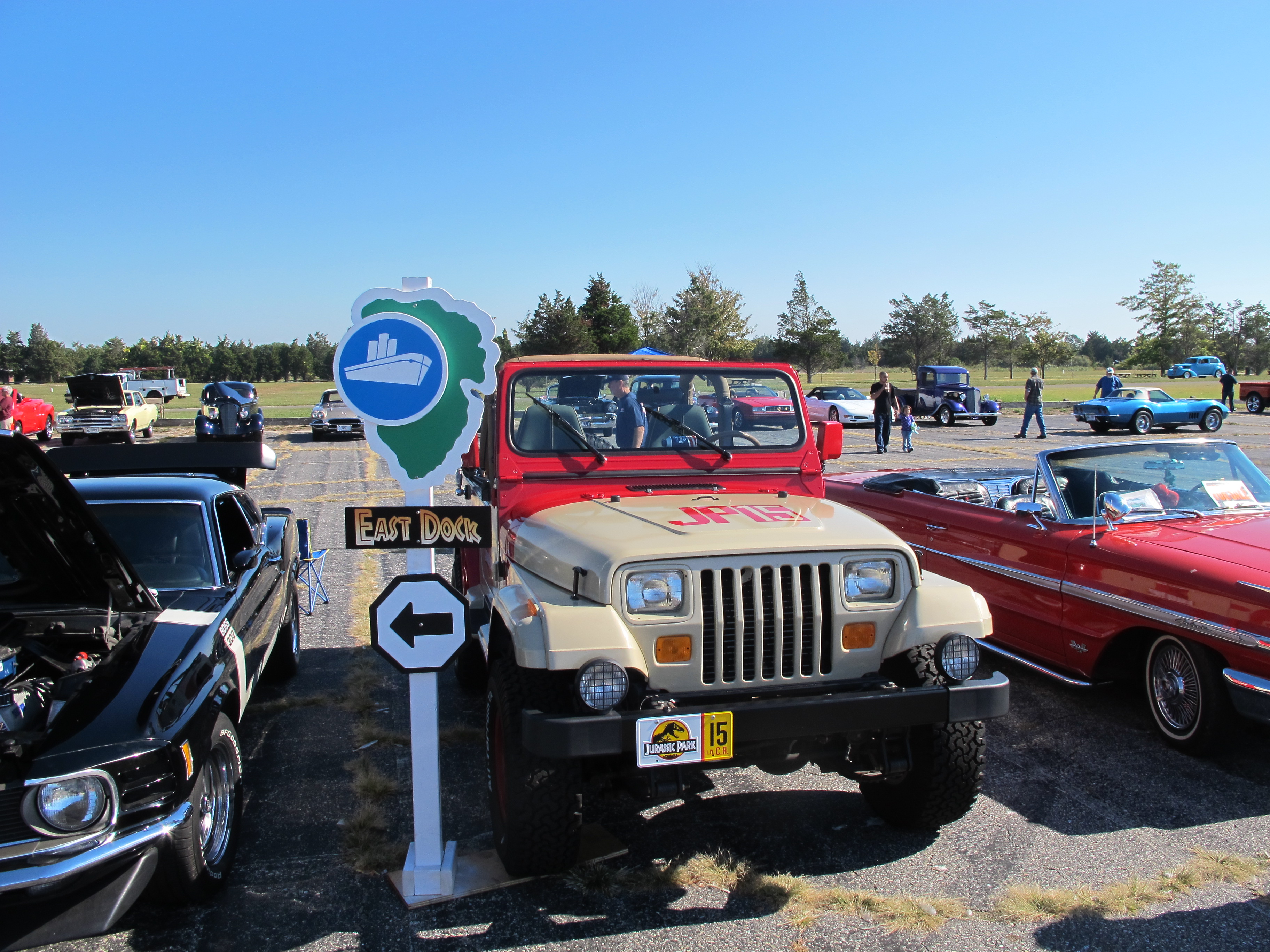

Went to another car show today. No awards were given out (not that I would have won), but it was at a beach my wife and I were going to go to anyways. I spent the prior two nights finishing off the East Dock sign I started months ago. I think some of the paint was still wet when I left for the show. The majority of the cars were pre 1970's American classics. This was kind of the crowd that thinks any car built after 1965 isn't worthy of being shown off. Anyways, here's a pic of my Jeep there. I was a tad scared the sign was going to fall over onto my neighbor's Boss 302 :o
I might put some tropical ferns down on the base of the sign for the next show in 2 weeks.

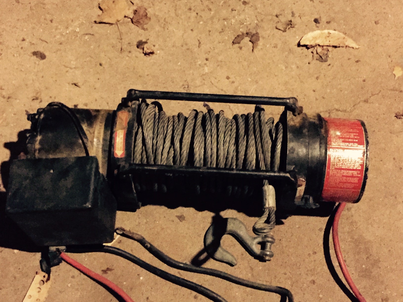

Also received this today. Doesn't work but for $87 shipped I figured it's worth a shot to see why. I might tear into it tomorrow. Anyone know the best way to diagnose a non-functioning winch?

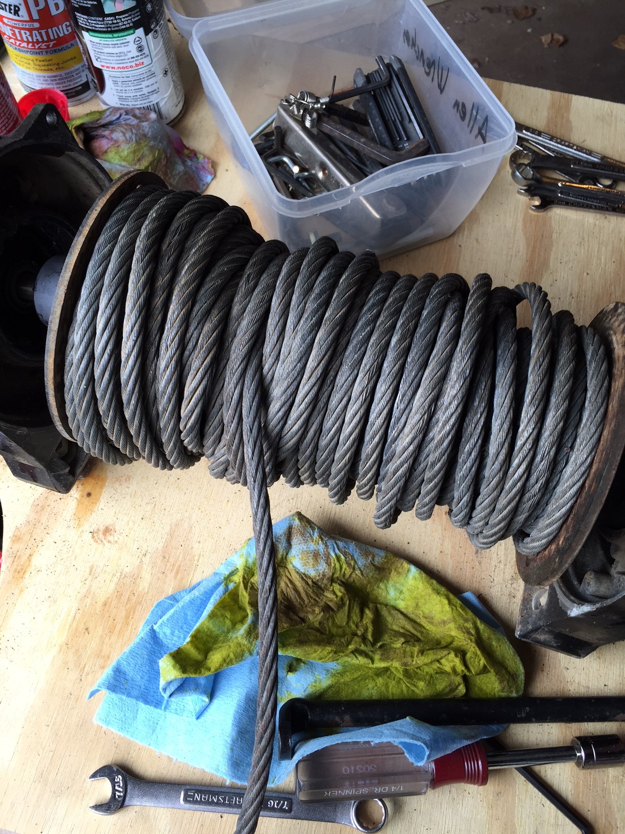

And I took about an hour to work on this today. It appears to only be a faulty remote switch at this point. One of the screw/nuts that holds the remote switch body together was missing, so I know the previous previous owner looked into it. I think the failure point was somewhere inside the connector of the remote that plugs into the solenoid box, which doesn't appear to be serviceable. I'm tempted to just buy another brand or universal remote or hell, even spend less than $10 for a wireless remote for this. A replacement 12' remote from summit is $45+ shipping. I'm going to do more testing tomorrow to verify the motor and solenoids work before I order anything, but tonight in my drunken stupor I was able to get the motor spinning in both directions by just switching the wire that powers each solenoid so I think I'm ok.
I'm also going to strip the winch down, clean up all the electrical connections and give the body a good cleaning... It's pretty dirty.
