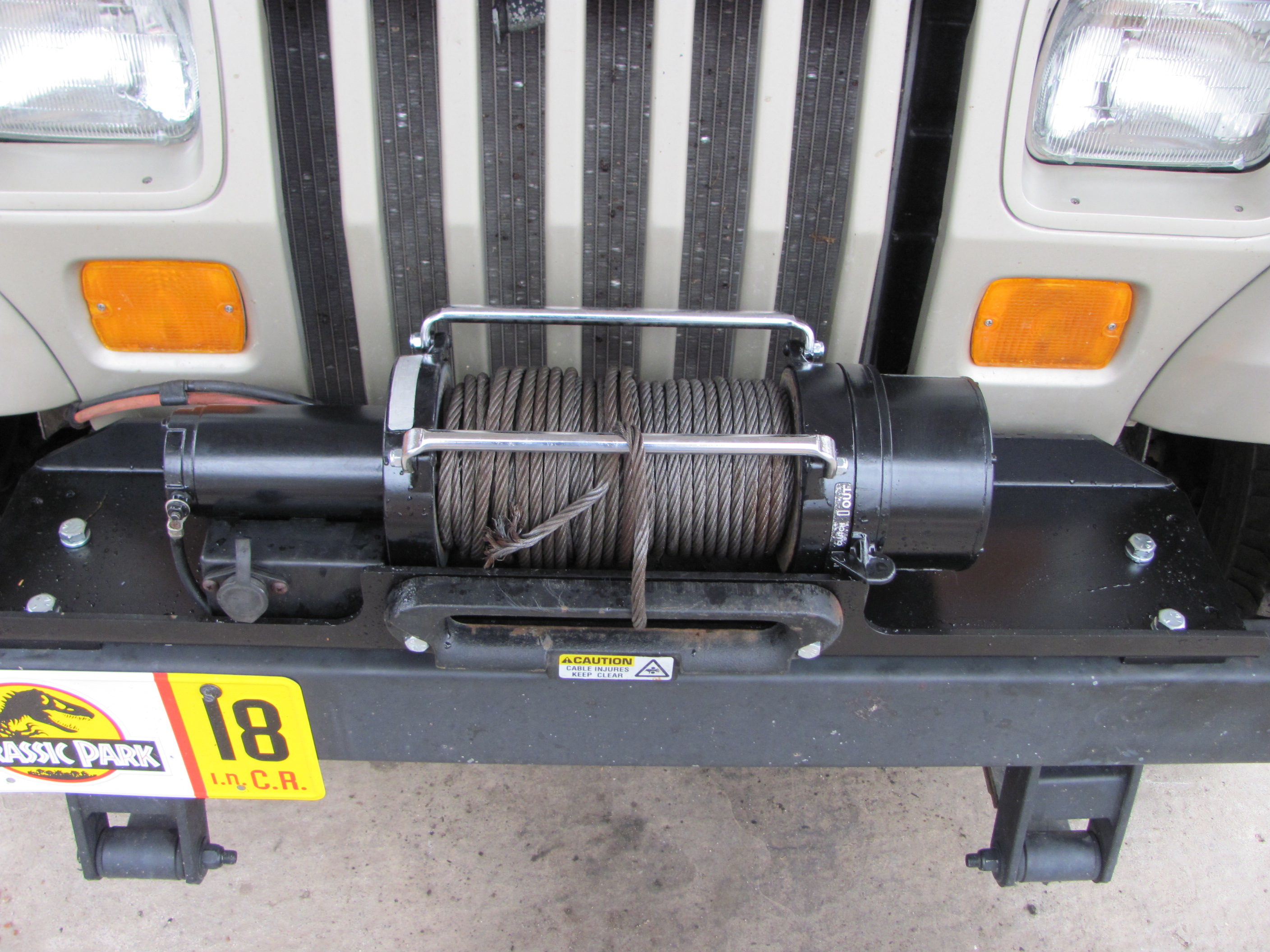

I finished it up this morning. After getting the power cables ran i hit the out button over and over again. I would hold the button down also. I gave the solenoid a good workout and it started to work again. The contacts on the solenoid are corroded up some from lack of use.
Post by ratrace427 » January 9th, 2013, 12:21 pm
yj87jp wrote:Looks brand new again:)
Thanks, but with a new cable it would look better. I dont know if i want to put a new cable on. There is a place in Tulsa that can put the hook on for me but i can also get a new cable from them if i choose. Im thinking the new cable will look just like the one i already have after a year or two but i dont know.
Suggestions? Should i do a new cable or know when to quit?

That cable looks like you use it, I say keep it! What's the cost of a new one?
Post by ImperialTrooper » January 9th, 2013, 11:02 pm
Your current cable still looks good. I'd keep it.

I made a template today for the hooks. After prolonged staring at the photo provided by imperialtrooper, I noticed that the hook plate doesnt cover the little holes in the winch plate. I am guessing about all the other dimensions but i have got it close. What thickness of plate does everyone think these are made from?

if your winch plate is 1/4", than those look like 1/2" to me... Looks good!
