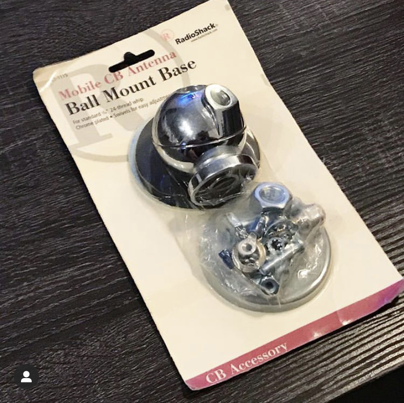

I recently ordered a screen accurate ball mount for the whip antenna. So grateful for other JP members who have collections of discontinued parts. Going for screen accuracy, it really helps having these parts available to buy from other members. And I know there are parts that are "close enough", but any chance I get to actually get ahold of a screen accurate part, I can't pass it up.

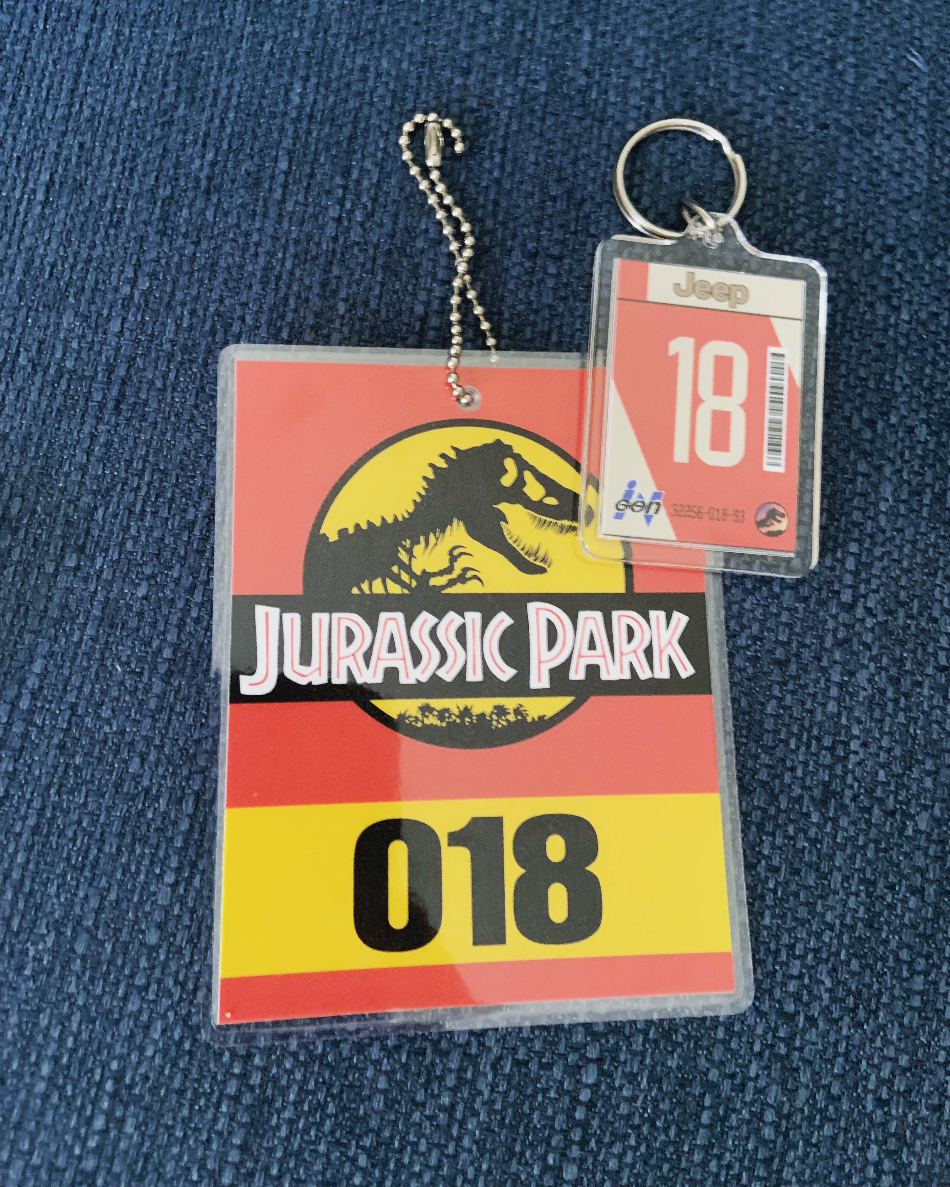

Also, my Mirror Tag and Key Chain came in from JurassicParkProps on Etsy. He does quality work and even the key chain has a nice little touch. The attention to detail made the purchase more than worth it. I mean I'm sure I could have made my own mirror tag but I don't mind supporting our members at all.

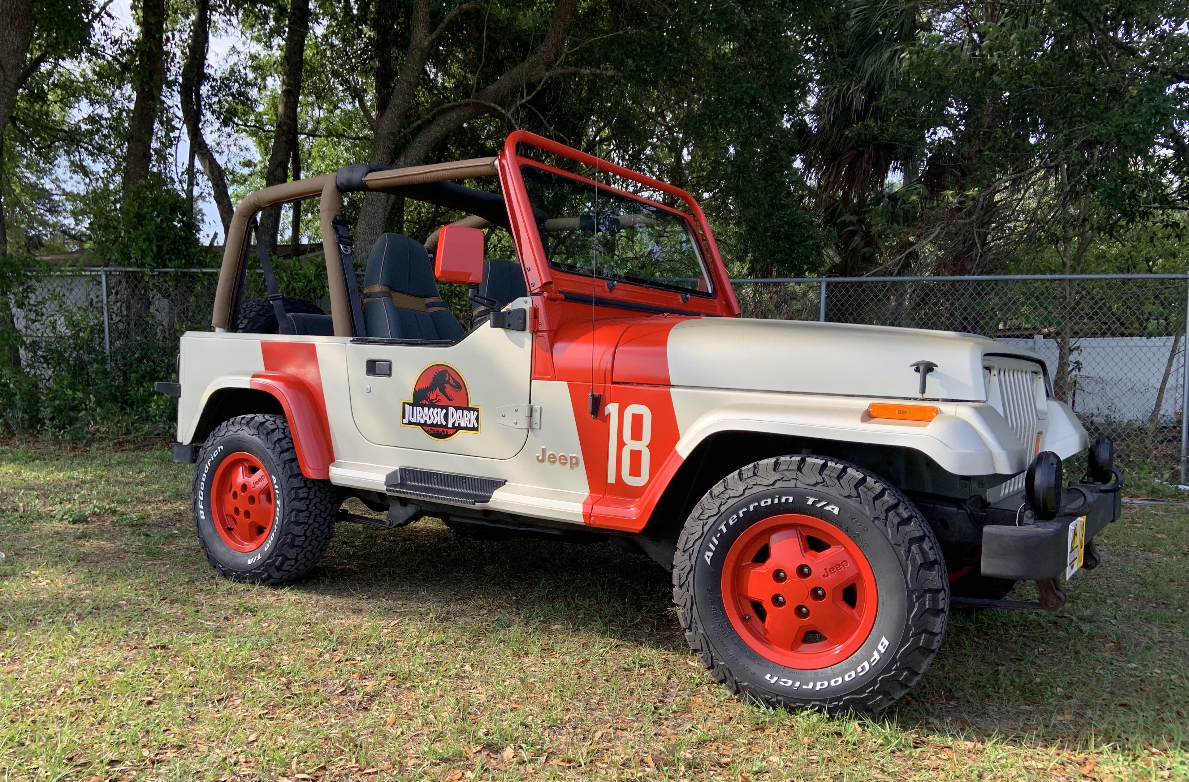

Just made it back into town from a work trip. Thanks for everyones advice. I agree with everyone that it's most likely a grounding issue. I will tackle that as soon as possible. In the process of moving prior to leaving for another week long work trip. In the meantime, here is a picture taken while out and about.
Beautiful looking jeep!
May be I missed it, but what size tires did you chose? 235?

Yep! I went with 235/75R 15. The 30's rub slightly when you turn the wheel all the way so didn't want to go with those.
