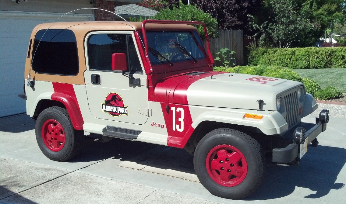

Got a whip antenna installed today. That's about it until I get it painted with actual paint at some later date.

Awesome! How did you attach that to our light bar?

Post by jbc455 » May 19th, 2013, 8:54 am
Thanks!
I just drilled some holes and used some clips I had laying around. I need to find something else as these let the antenna slip down.
Re: The beginning of JP13
Post by ratrace427 » May 19th, 2013, 9:40 am
I stuck my aerial under the light bar mount then tightened the bolts up. Its not coming out but it sits close to the window frame and slaps against the corner. I put a piece of vacuum tubing over the end of the aerial to prevent noise and paint damage. Its been working great for the past year but what about putting some vacuum tubing over your end? I bet it would fix your slipping problem. Get some small tubing and use wd-40 to help with pushing it over the ball on the end. If you have a CB you dont want the antenna touching metal or it wont function.

Post by jbc455 » May 19th, 2013, 10:54 am
No CB here. Mine slaps the hard top. It's loud. I may put a bumper on the top when it goes back on in November or so.
Post by COBrian » May 19th, 2013, 2:57 pm
I've seen ppl put tennis balls on these to lesson the whacking noise when it bumps the car (and to protect their paint from scratches I suppose)
These ball mounts are pretty cool,, you can rotate the center and then rotate the half of the ball and point the antenna more away from your jeep/hard top. Might lesson the slapping.
