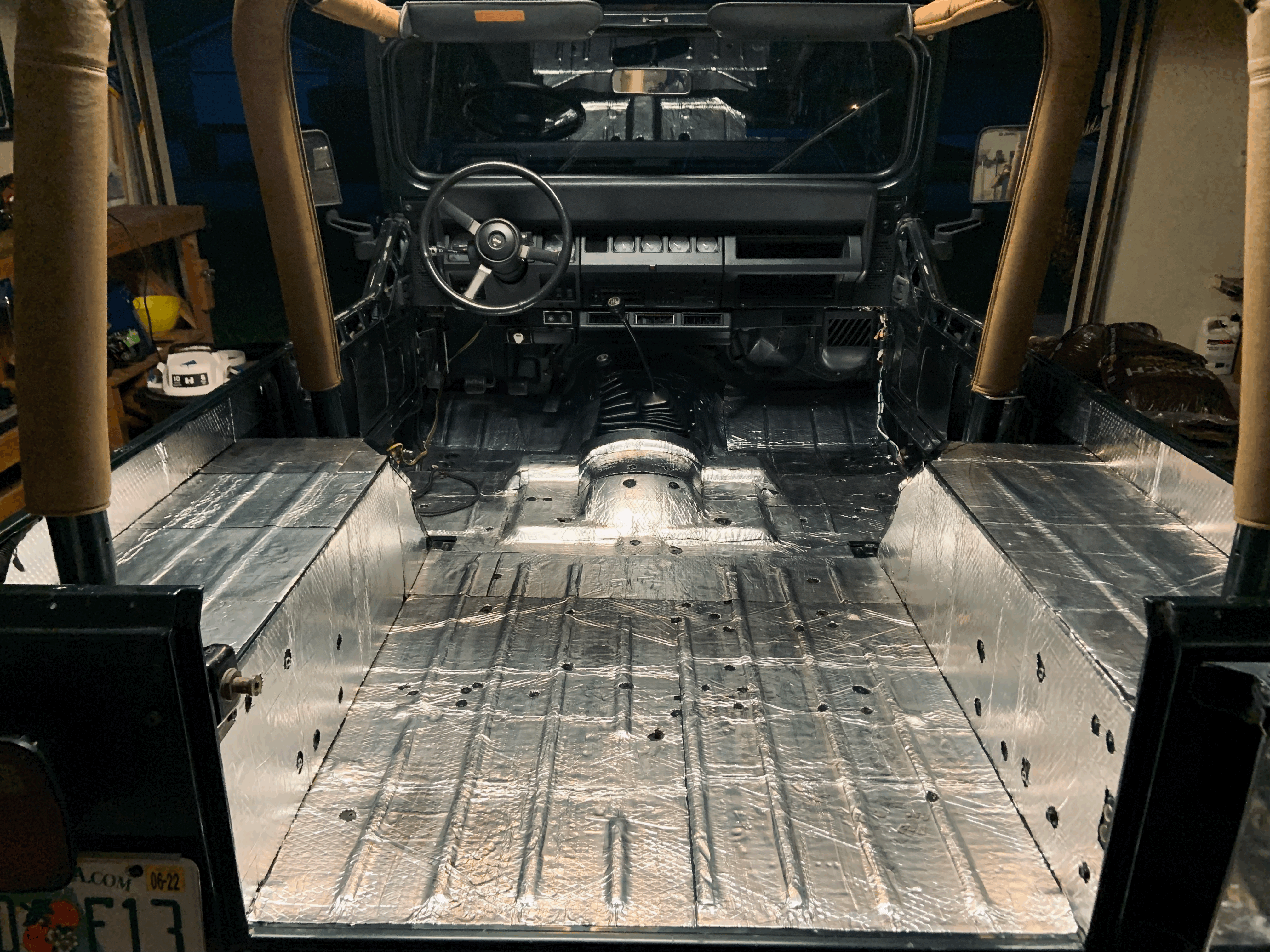

The carpet is one of those things im not the most knowledgeable about but there have been quite a few discussions over on Facebook over the best options. If i were ordering a set for myself in the future i would be doing a complete set WITH rocker panels, in the cut pile option, dark green, WITHOUT mass backing (since im using sound deadener). You could do either the carpet with mass backing and not do sound deadener, or you could do both if you want to spend an extra $230. I think my sound deadener will be just fine.
I don't believe the Jeeps had floor mats, but for the sake of protecting your carpet, there are some rubber floor mats that have the same tread as BFGoodrich tires. Not sure where to get them thought.
For my original carpet, i'm actually having the carpet professionally cleaned tomorrow and then they will most likely go back into the box until i'm done painting.
Lastly, I am installing the sound deadener on the entire floor pan area. Basically any area that gets covered by carpet will get some sound deadener. I even added a little to the understand of the black plate that covers the hole where the shifter boot is. Here is a progress update on how much i've done. Only have the passenger floor board area left to do.

Really well done for the sound deadened. It looks so nice ! Serious work done, it looks like OEM ^0^

Haven't done much to the Jeep recently other than finishing the installation of the Noico 80mil. Although, there's not much left to do other than get the Deaver leaf springs installed, get some searchlight ring guards, clamps, and wire caps.
Then it will be on to paint and light assembly for the final push.

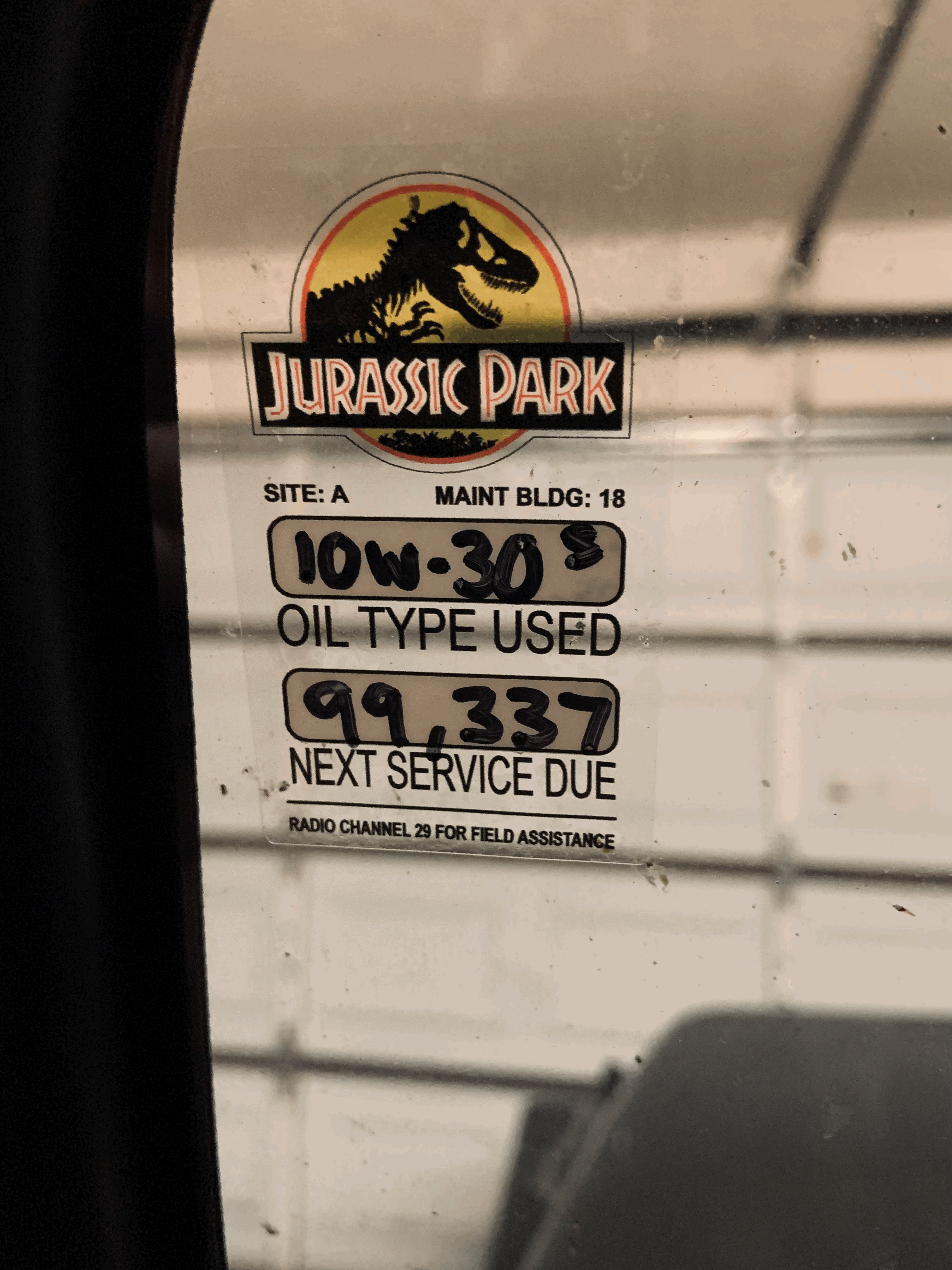

Although not screen accurate, I love little details like this that really bring a build to life. Its something you would think that an actual Jurassic Park would of done for the Jeeps.
