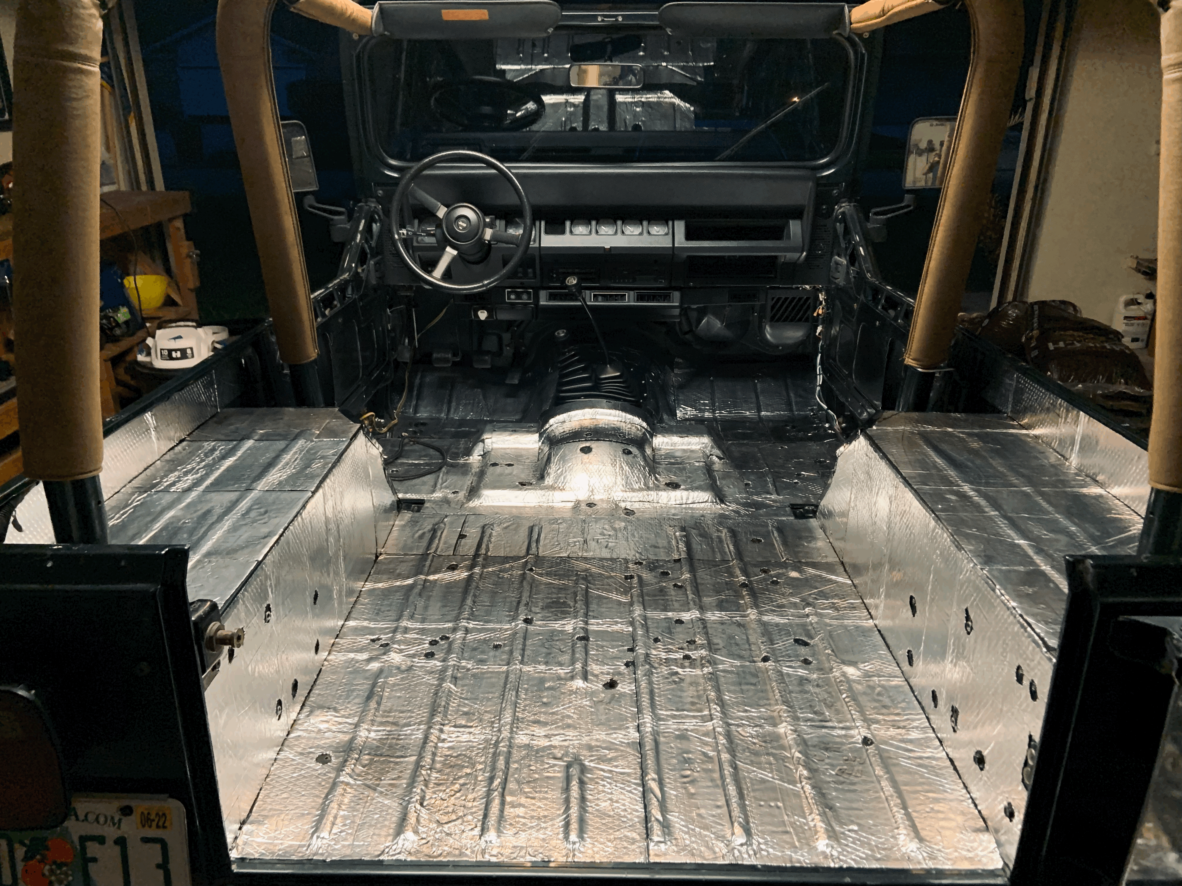

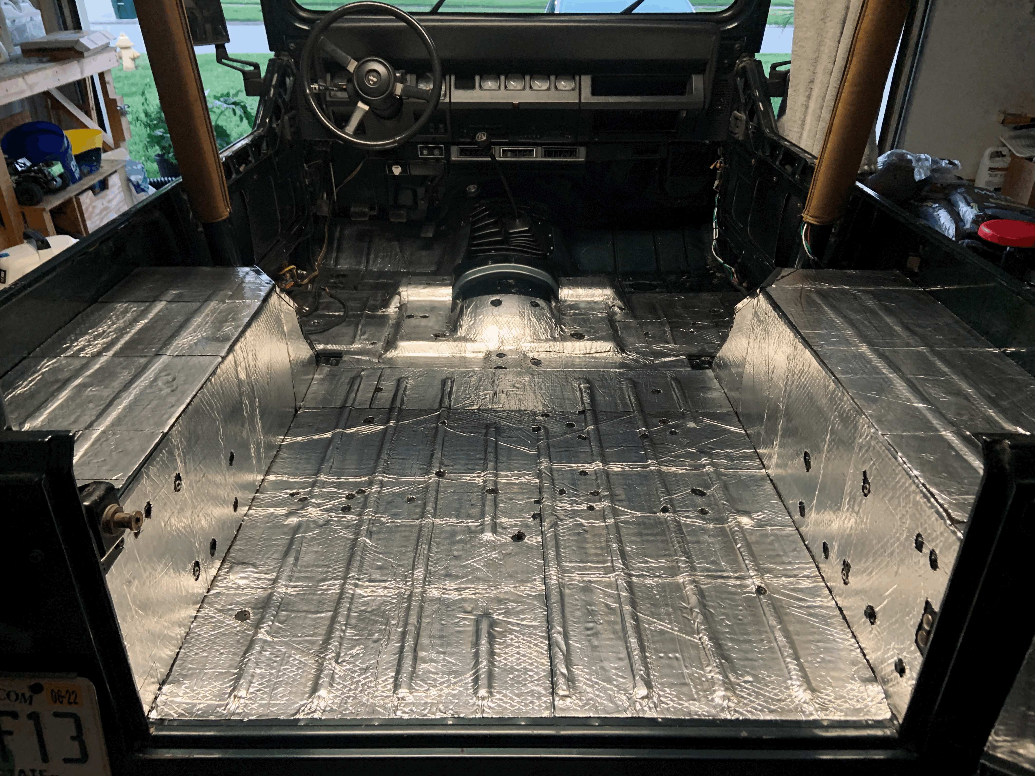

Lastly, I am installing the sound deadener on the entire floor pan area. Basically any area that gets covered by carpet will get some sound deadener. I even added a little to the understand of the black plate that covers the hole where the shifter boot is. Here is a progress update on how much i've done. Only have the passenger floor board area left to do.

Really well done for the sound deadened. It looks so nice ! Serious work done, it looks like OEM ^0^

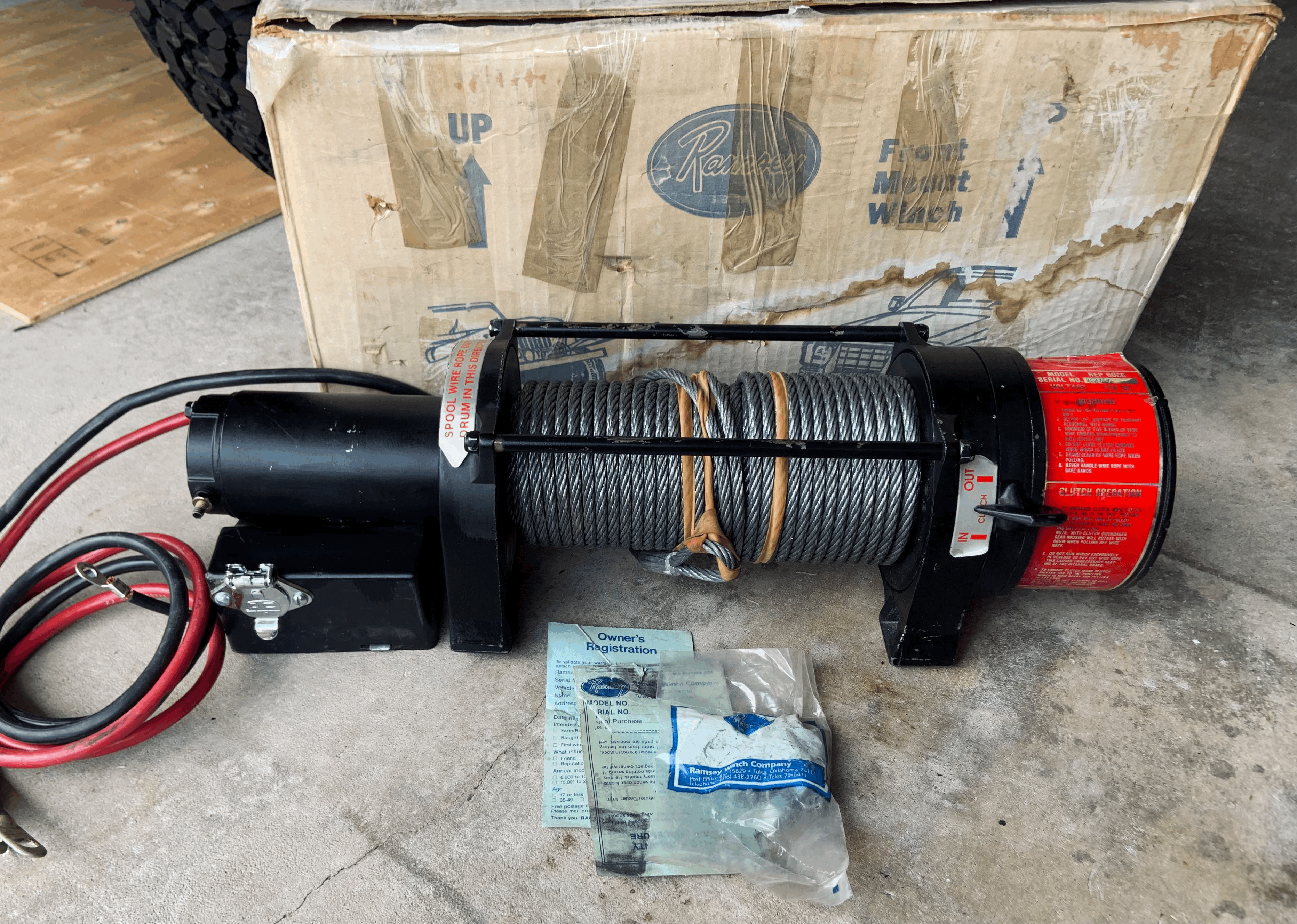

Picked up a new in box REP6000. Not every day you come across a 20+ year old winch that's never been used. It's going to sting a little, but I have to change out the decals and add chrome tie rods to make it more accurate.
I already sold off the other REP6000 that I had in order to offset the cost of this one.

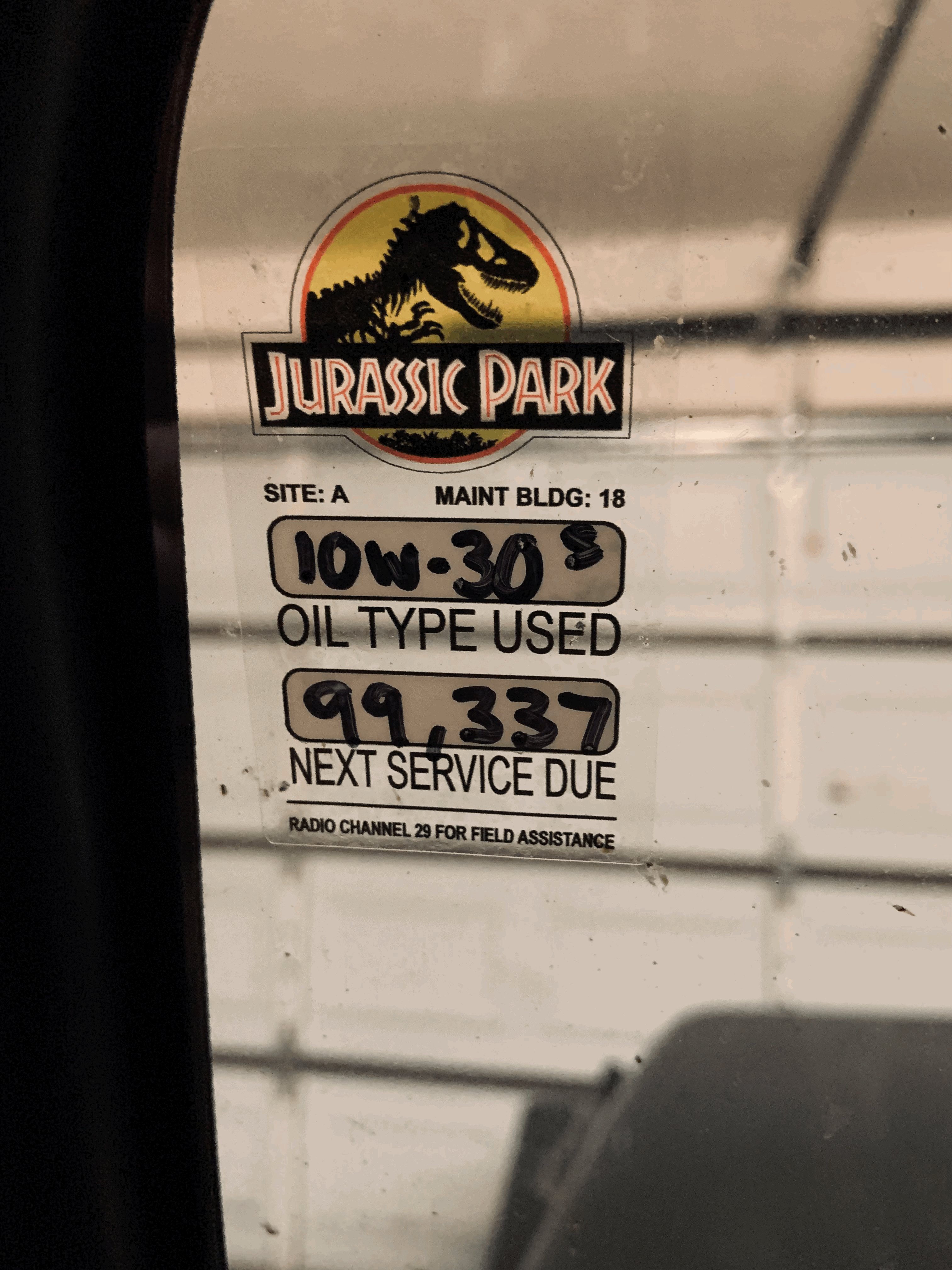

Although not screen accurate, I love little details like this that really bring a build to life. Its something you would think that an actual Jurassic Park would of done for the Jeeps.

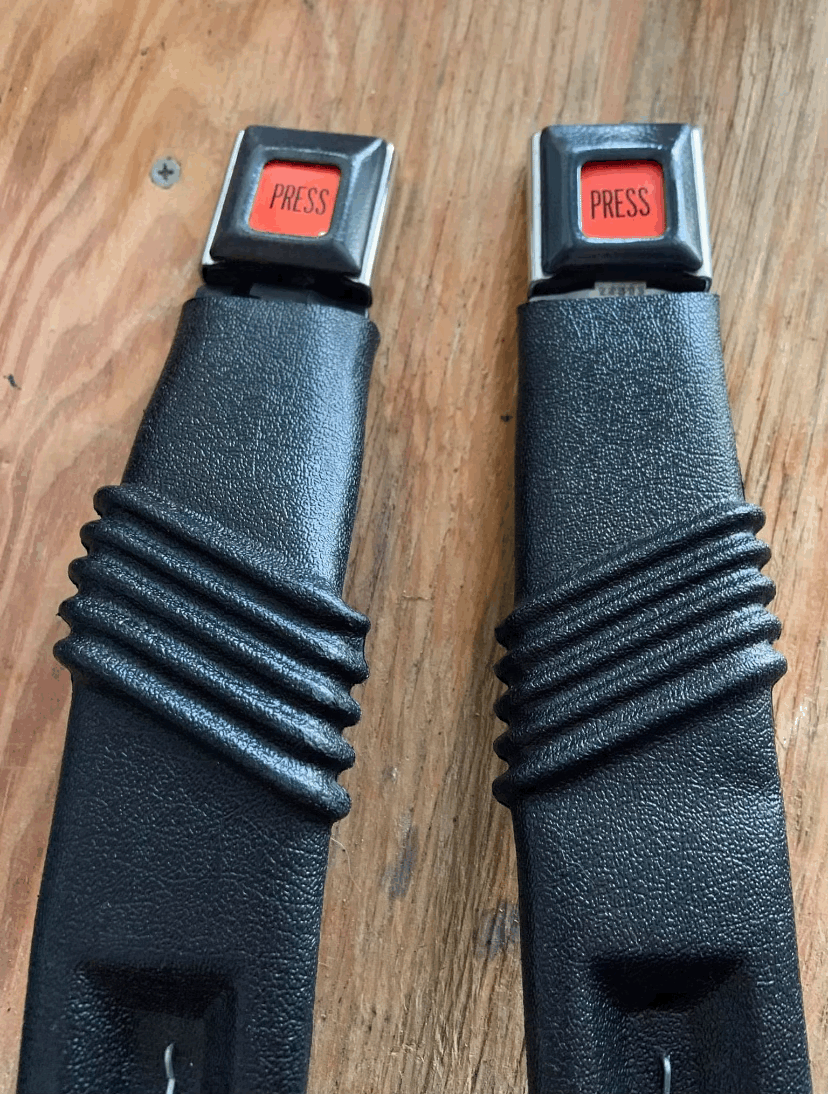

Not a big update since I'm at a small roadblock in my builds progress, but I've just been doing some minor restoration on some of the smaller details. This weekend I did the seatbelts. Took some Simple Green and a soft bristle brush to clean them, used some chrome polish on the back side of the buckle, added the new PRESS decals from 401graphics, and finished it off with some VRP from Chemical Guys.
