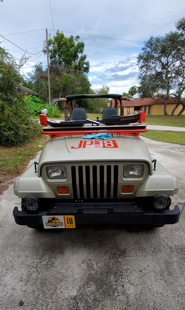

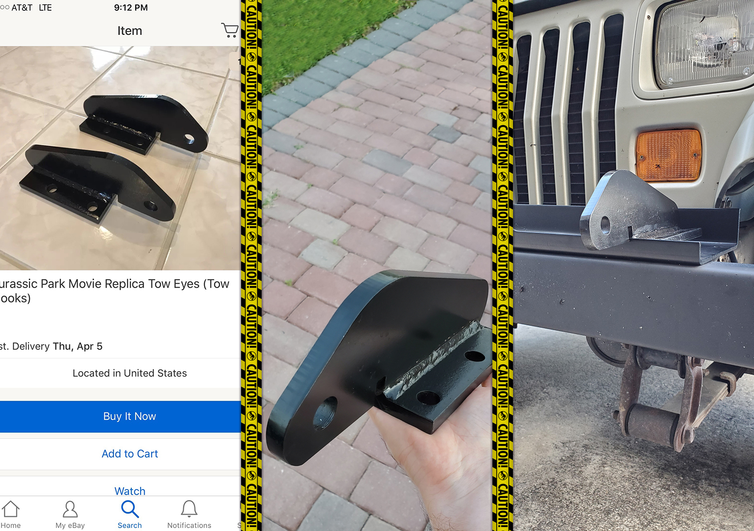

Early on in my Sahara search I did pick up one item that seemed to be few and far between in production, the tow eyes! Fitting that when picking up Jeep 18, it was one accessory it didn't come with. What a match! It was made to be.

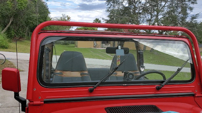

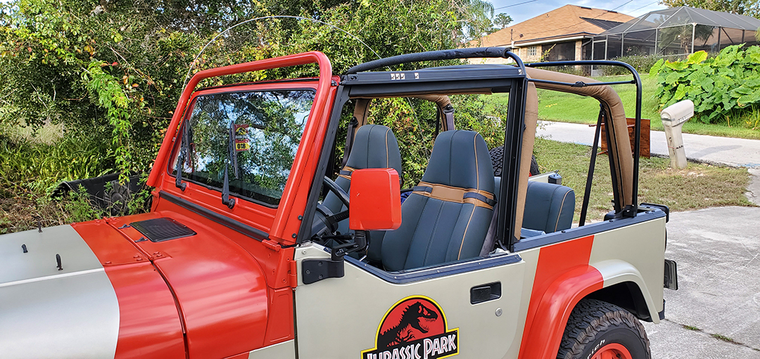

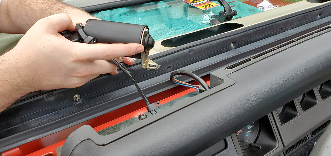

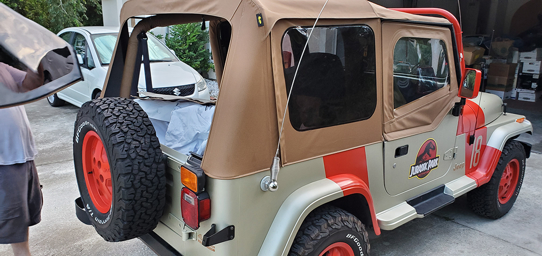

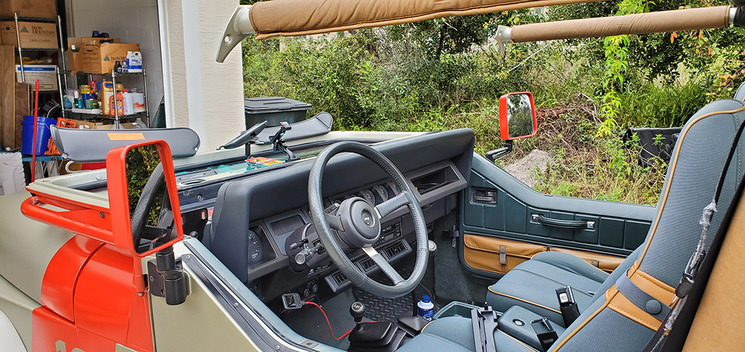

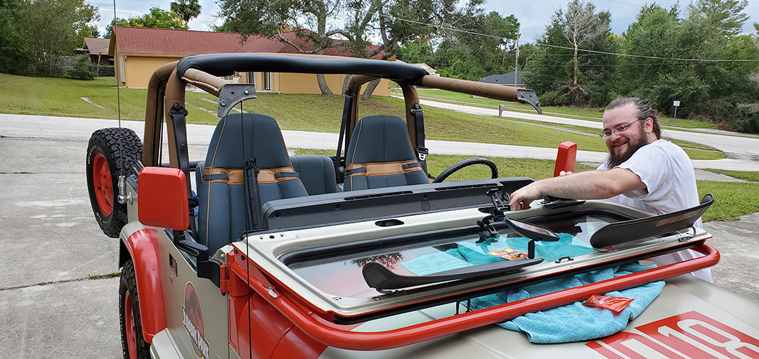

The first to-do for the Jeep was reinstalling the windshield wiper motor and getting the Bestop spice soft top installed. Luckily the Jeep has a home in the garage, but being Florida, you never know when you'll be out and caught in a 30 minute downpour. I recruited my buddy Herb one afternoon and while on my way to see him, one storm cloud loomed between me and his place. For the next 10 minutes, I drove like Ace Ventura with my head out the side to see as rain smacked me in the face and the wiper-less windshield. The rest of the day was sunny and beautiful, I arrived with a dry Jeep... me not so much.

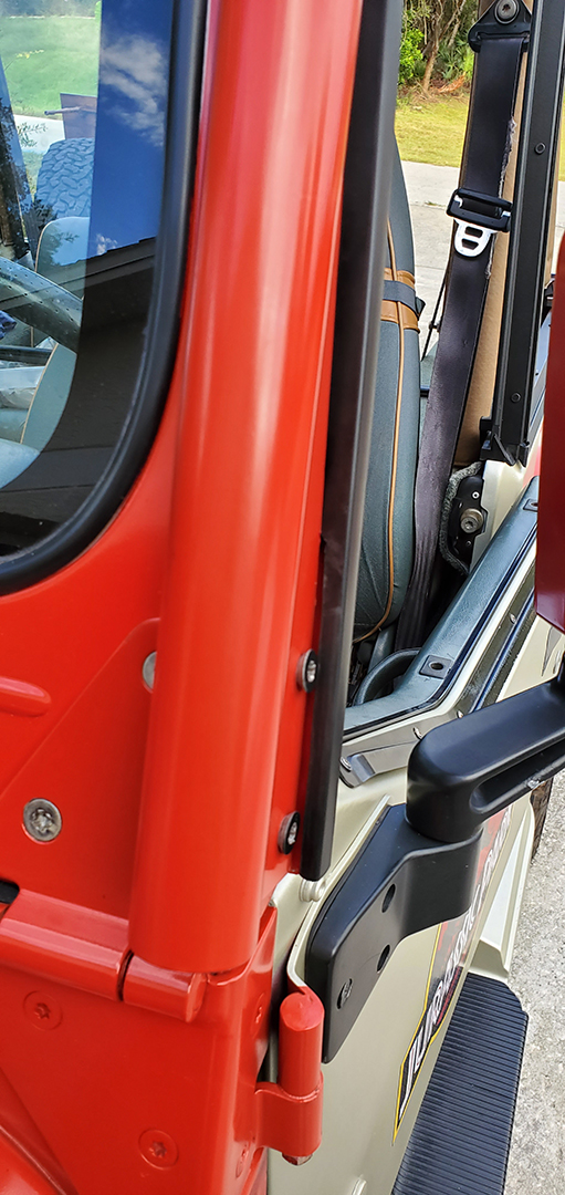

First up was lowering the windshield, plugging back in the wiper motor, and realigning the wiper blades.

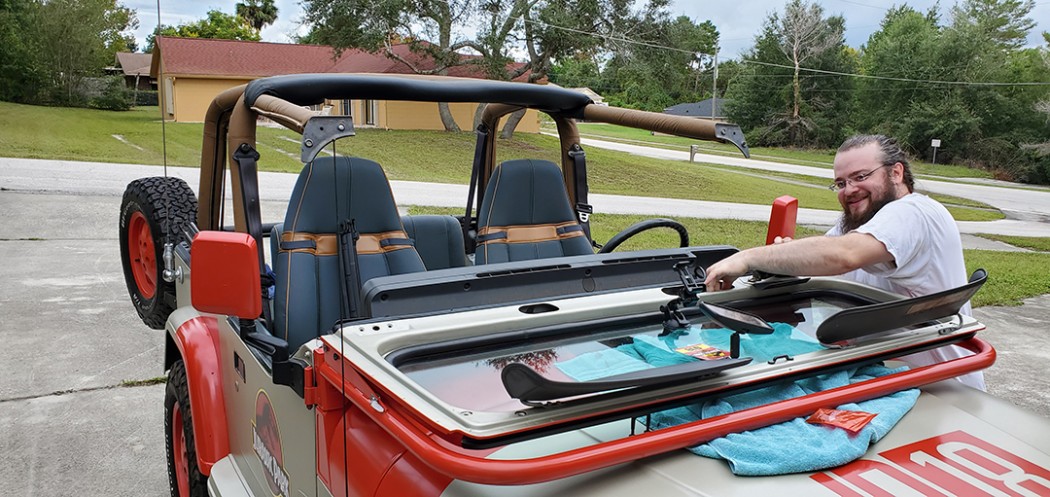

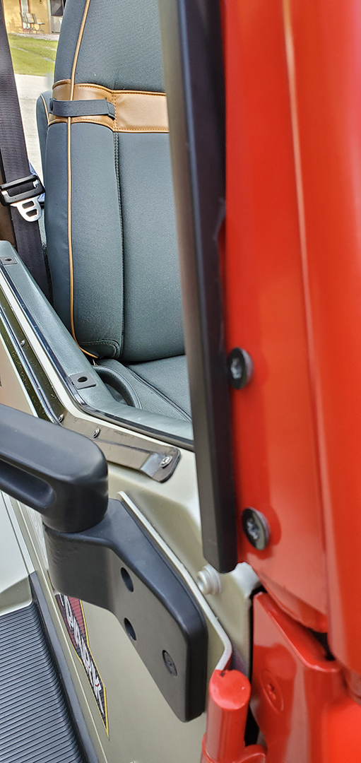

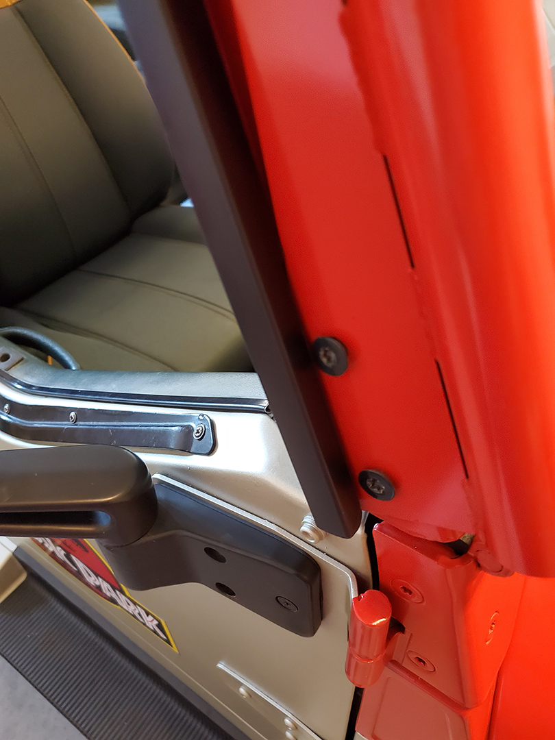

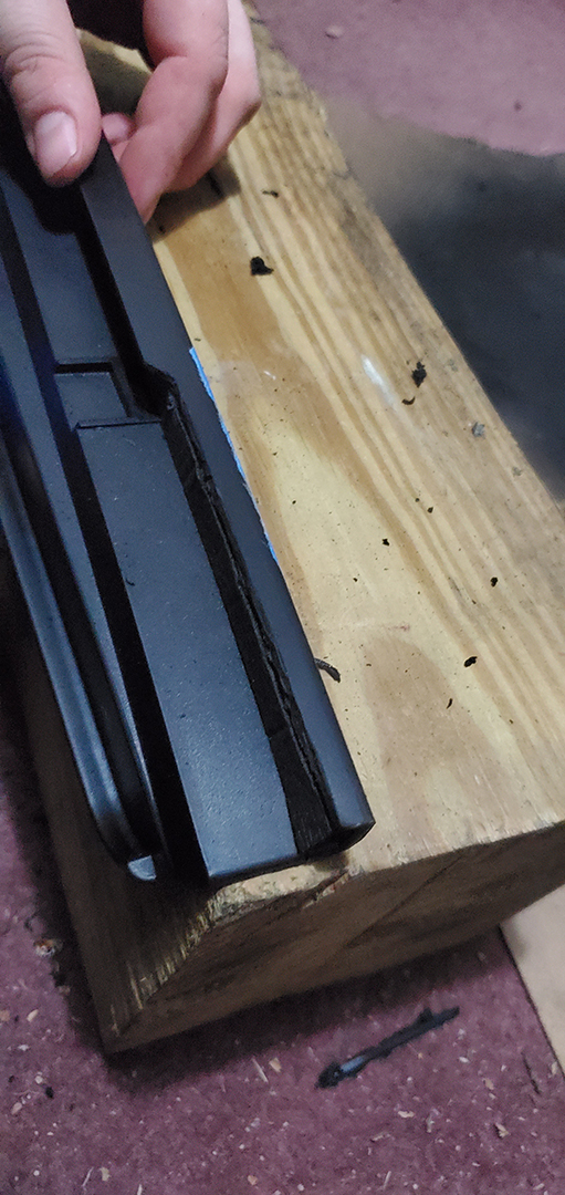

Next was the Bestop frame install. One minor issue I came across was with the A Piller mounts. The light bar obstructed the mount from sitting flush with the windshield frame. We masked off part of the mounts and dremeled and sanded off the unnecessary plastic. If anyone else has a different remedy to this, I'd like to hear what you did.
The rest of the install went well. We had left the canvas top and windows in the sun to help with the final zipping preparations. Not bad for a day's work. Jeep 18 is rain ready. Oh, also upgraded the stereo with Bluetooth! :D

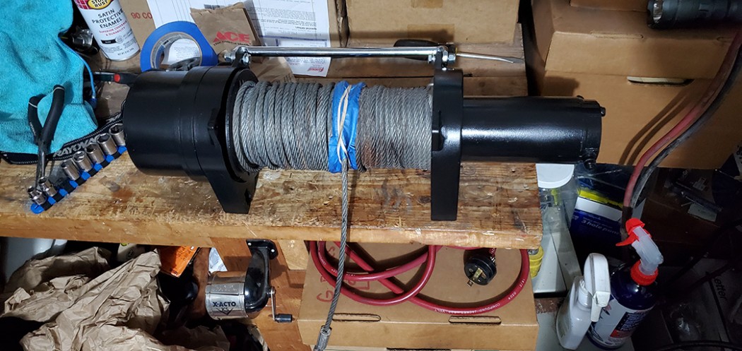

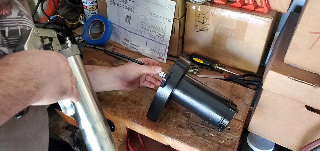

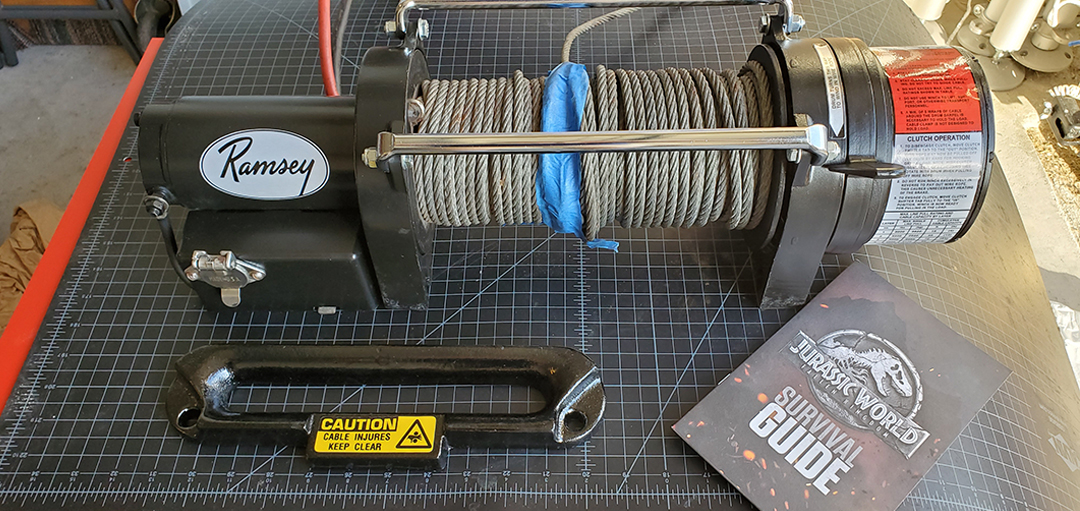

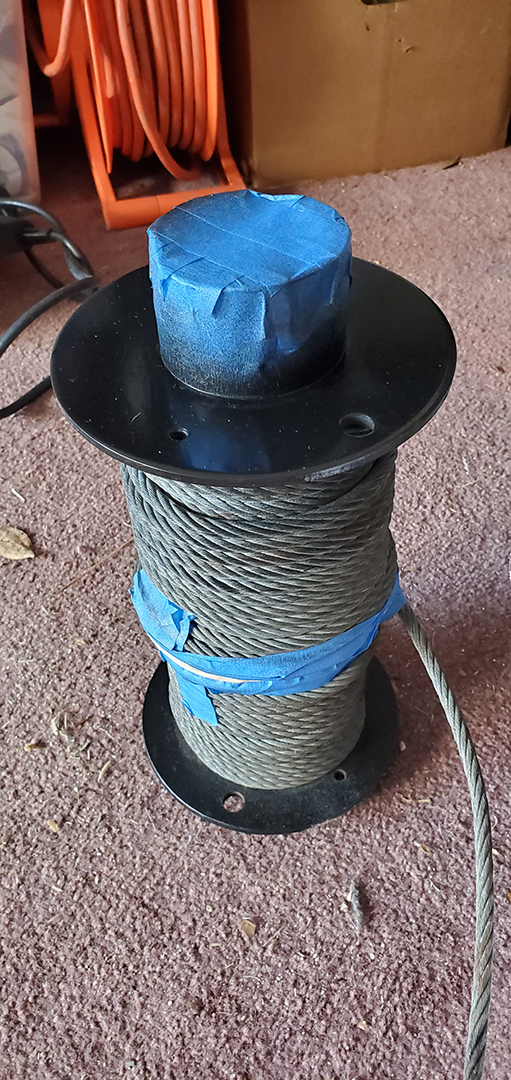

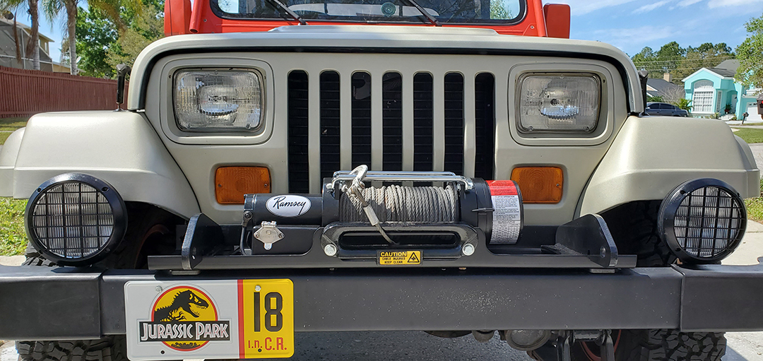

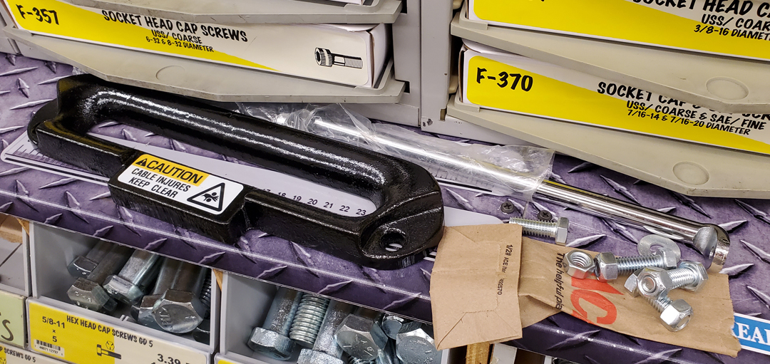

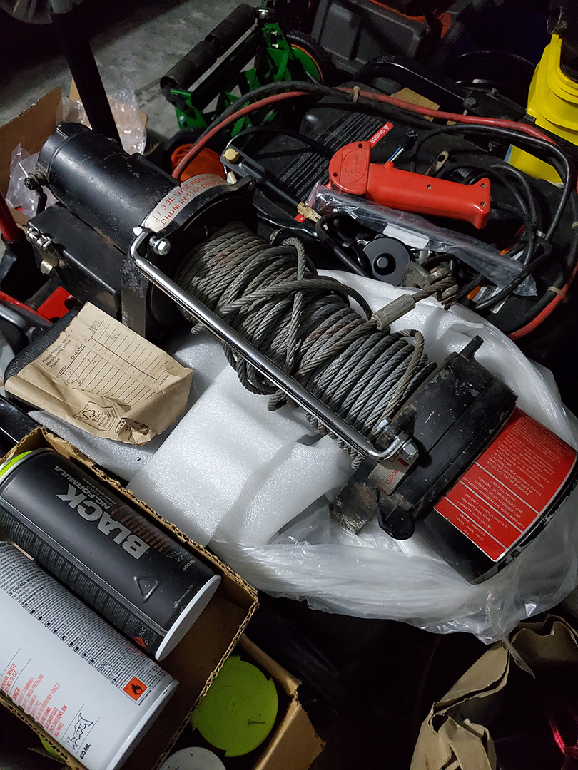

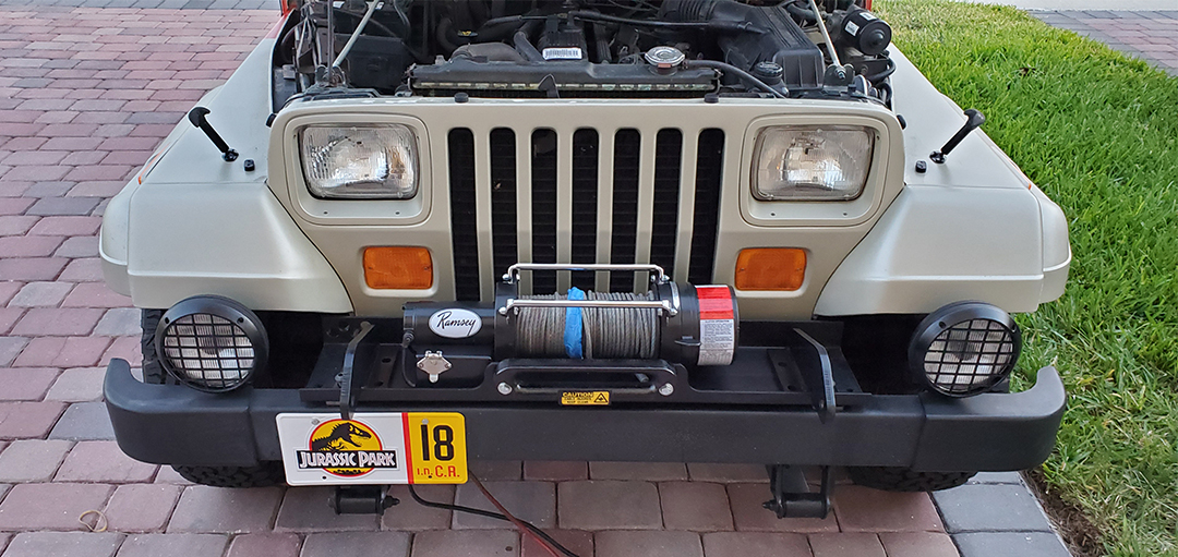

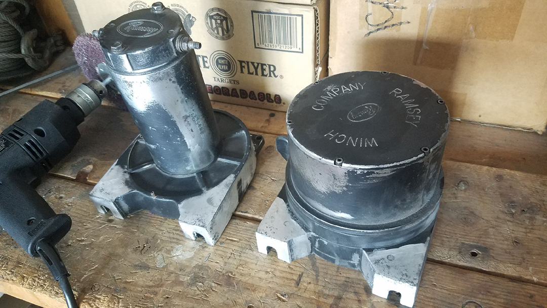

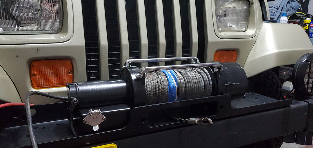

Ramsey Winch REP 6000 prep:
Dwight supplied me with the winch but it was in need of a little TLC. Time for some cleaning, sanding, greasing, cleaning, spooling, and painting.

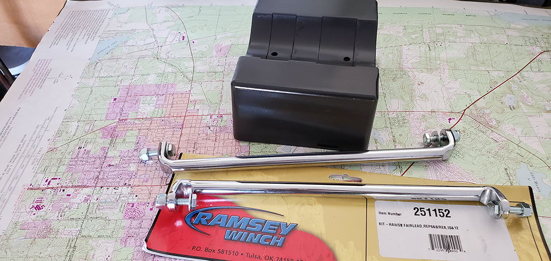

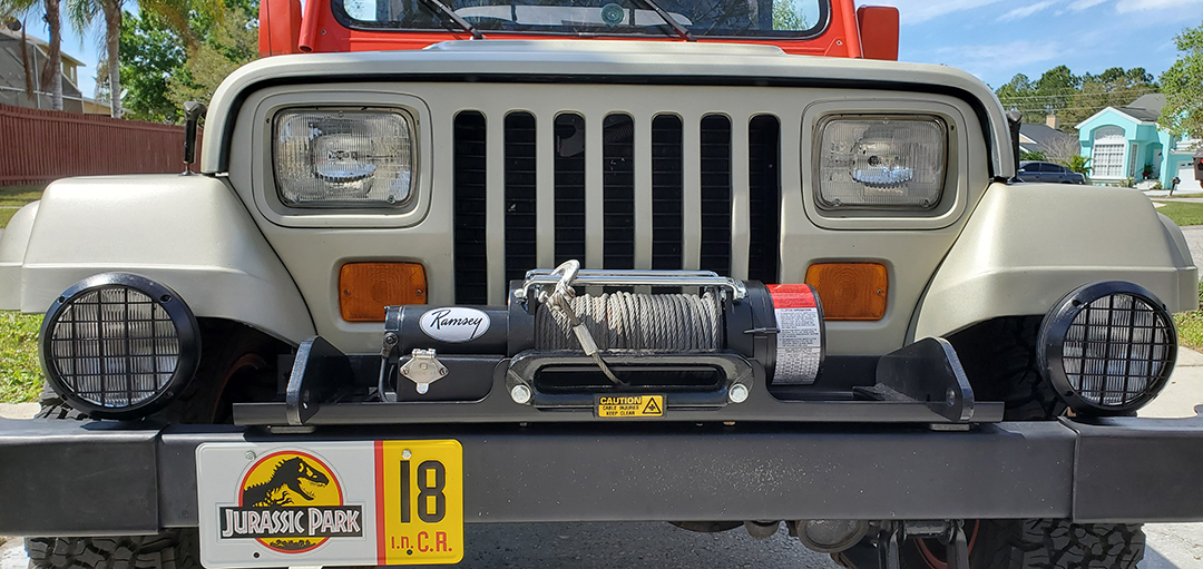

Mail call from Summit with replacement decals, new tie rods, and fairlead.

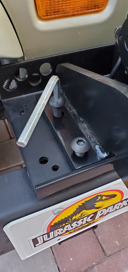

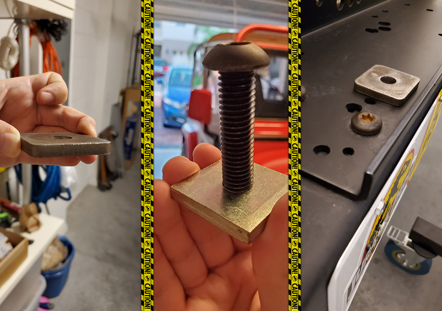

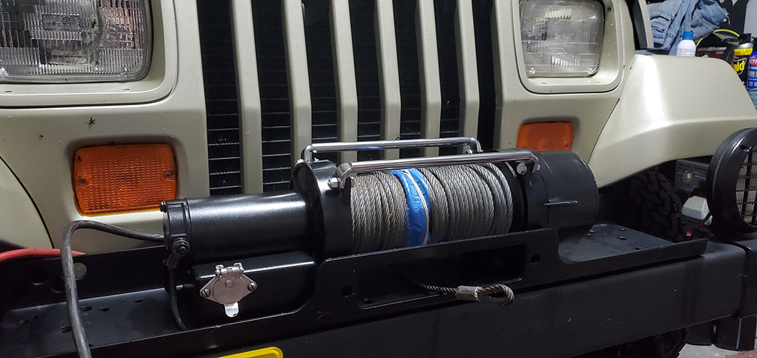

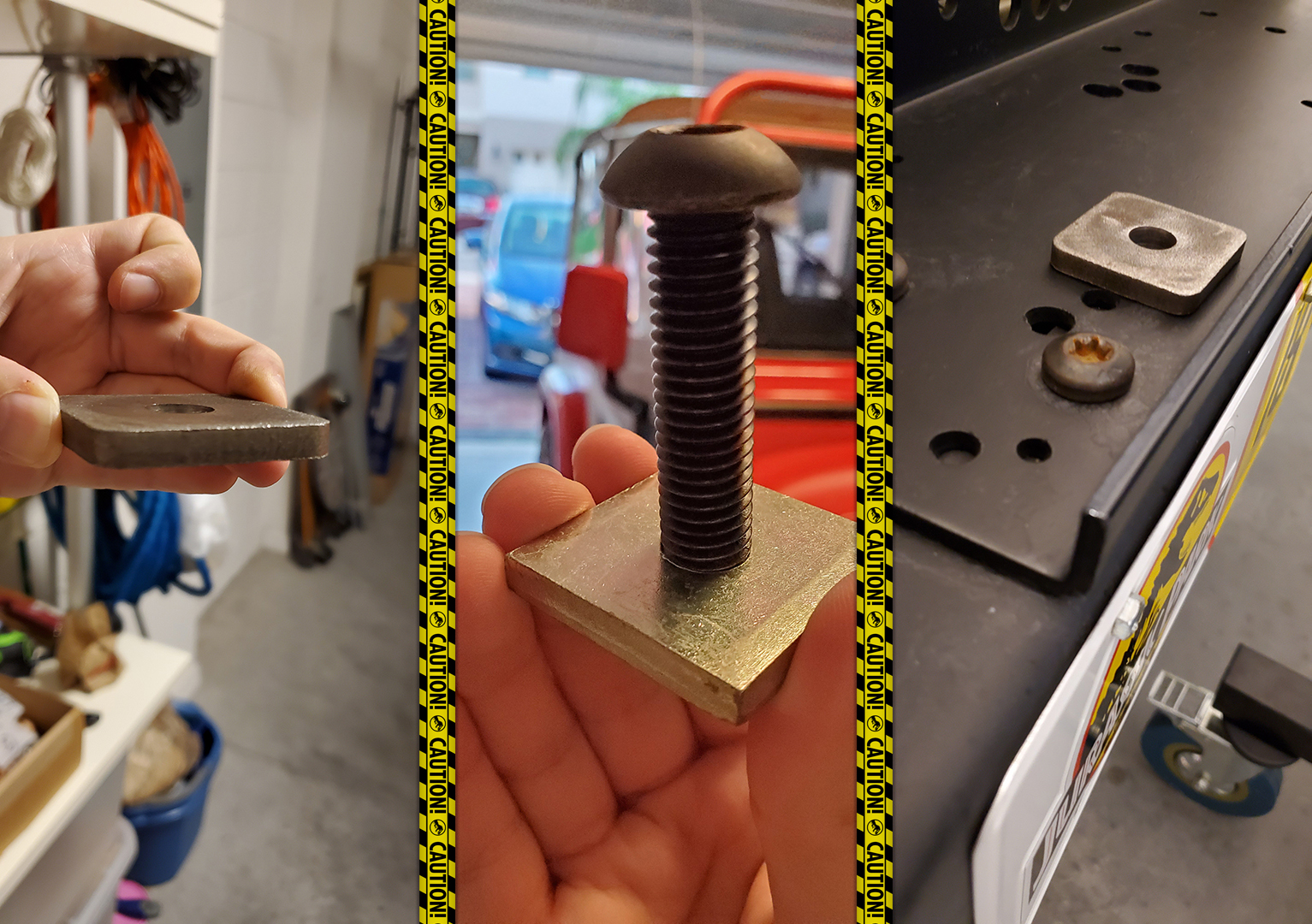

Initially Dwight was going with custom spacers for in-between the bumper and the winch plate. I ended up using 2x2x1/4 inch spacers. I wanted to have a clean look versus using washers, I think these did the trick nicely.
Additional decals supplied by Kevin at jp.401graphics.com.
Final assembly.
Ikea PTSD.
All in all, I'm very pleased with how this came out. Early on, I wasn't certain of the cable's condition until unspooling it. I do plan on replacing it, but for now, it's fine to showcase.

Post by Munker68 » April 17th, 2020, 3:24 pm
Great job on the winch it turned out great! When I restored my 6k I did not replace the cable, I think the color of the used metal looks so much better than a new line!
