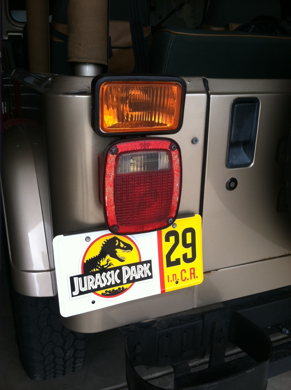

Ordered some rear light ohh 2 weeks or so ago... Got around to messing with them this week. These were the right size, but originally chrome, and they had a visor like rock guard deal. I thought the rock guard could be rmeoved, but it was molded into the piece that holds the lens together... SO i had to cut it off. Then I painted all (actually black plastidip again), and installed them up.. Other than missing the screw to attach the cover from the correct KC lights these (now that they are black) look very nice, IMO.
I took apart the rear housing, drilled the hole down through both plastic and the metal shield, inserted a washer as a space in between the shield and the plastic housing, so I wasn't bending the housing when tightening, bolted it down, and done. I have not wired it up yet, so they are non-function at at the moment, I am still deciding if I want to drill through the body or route through the taillight housing.
These were $29.. here.. http://bumpersuperstore.com/i-11436894- ... d-set.html
You can see the plastic guard I had to trim off, as the plastic guard and retaining ring are all one piece. They also have it in all chrome with NO guards, which is probably the better option now that I found out the retaining ring and guard are one piece in the one I bought. http://bumpersuperstore.com/i-11436904- ... g-set.html But the thick plastic retaining ring does look more like the kc lights than the all chrome versions metal retaining ring.

Those look almost identical to the KCs. Awesome price too! Nice find

Those look great after removing the guard! In the web site photo they look yellow but the right color in your photo. Awesome find! You should post that in the fog light thread if you haven't already.
