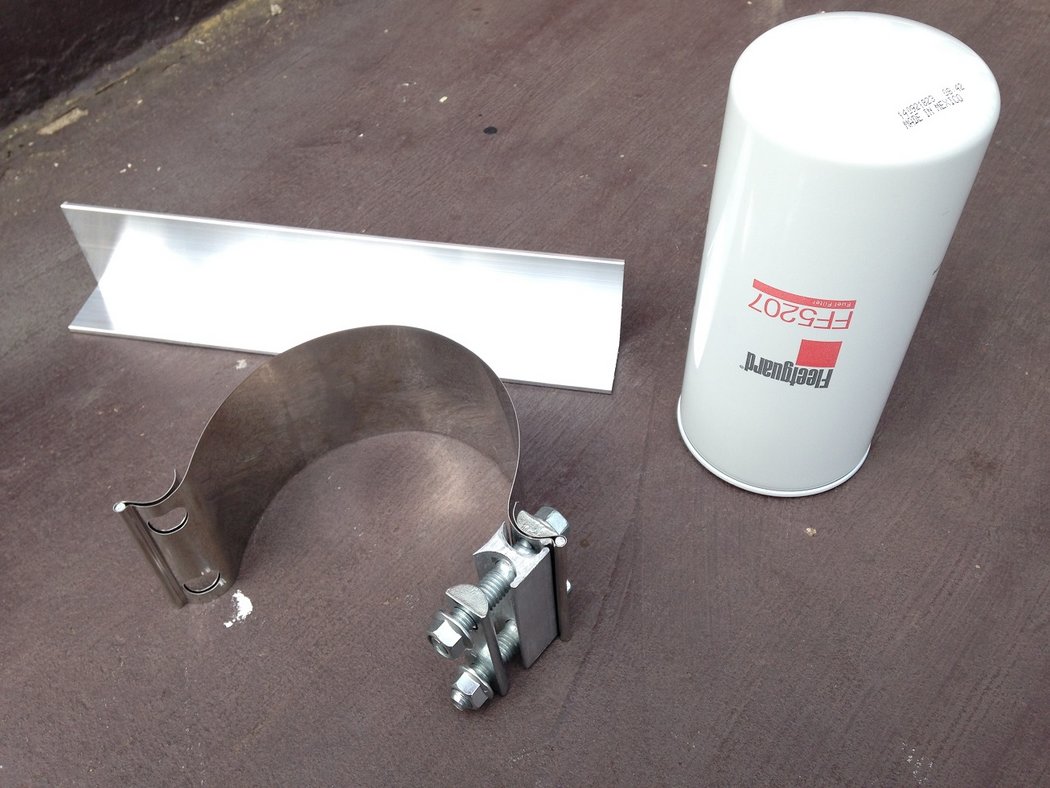

Thought I'd upload some build pictures from my buzzer project. Trying to track down a quality grab of the correct tone to go with my fence display once i get my other light.
The bits I used for build. A fuel filter for a Mack, a 3.5" stainless exhaust clamp and a length of aluminum angle.
Parts Used
Parts Used

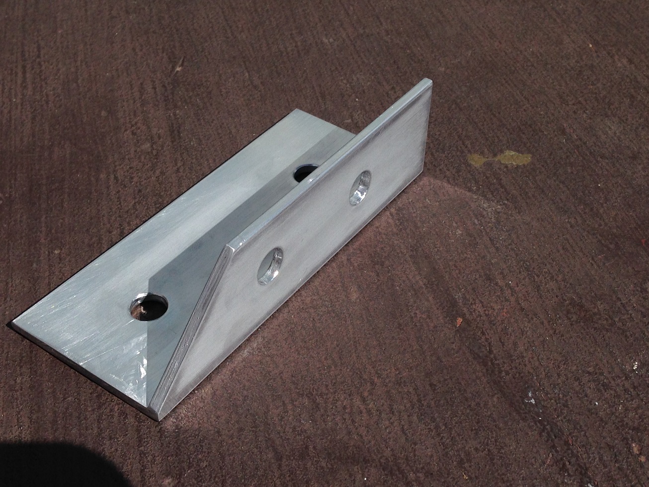

The finished bracket, drilled and brushed.

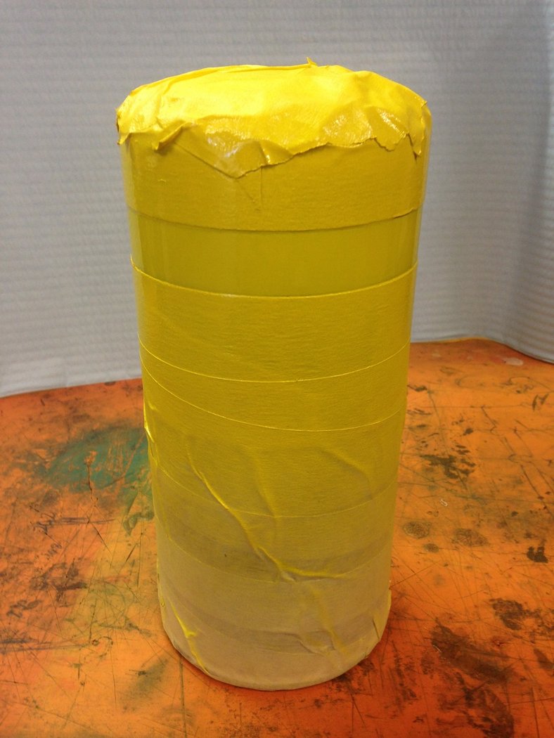

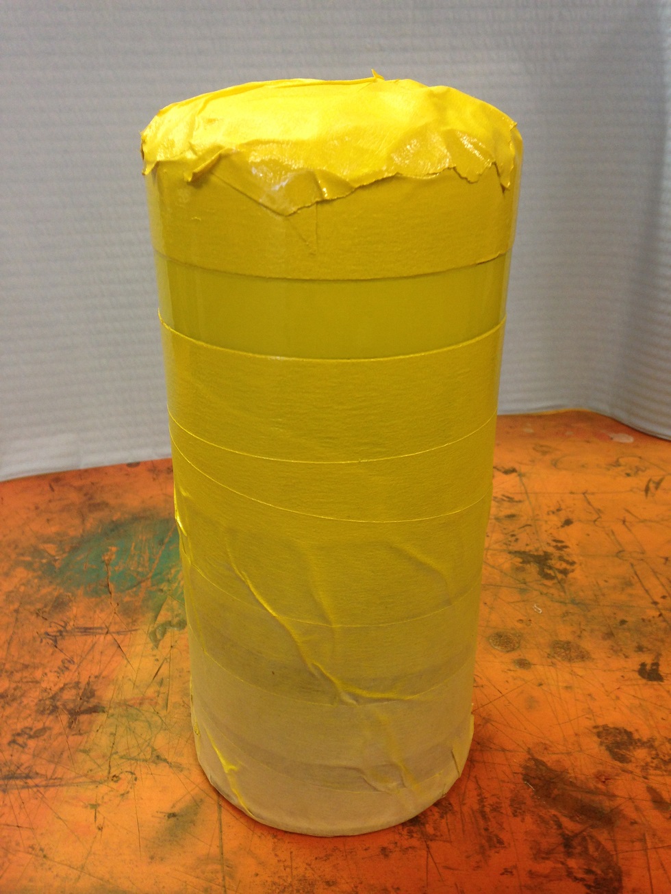

Masking leaving a band of red for the amber line, then painted.
Masked and Amber on
Masked and Amber on

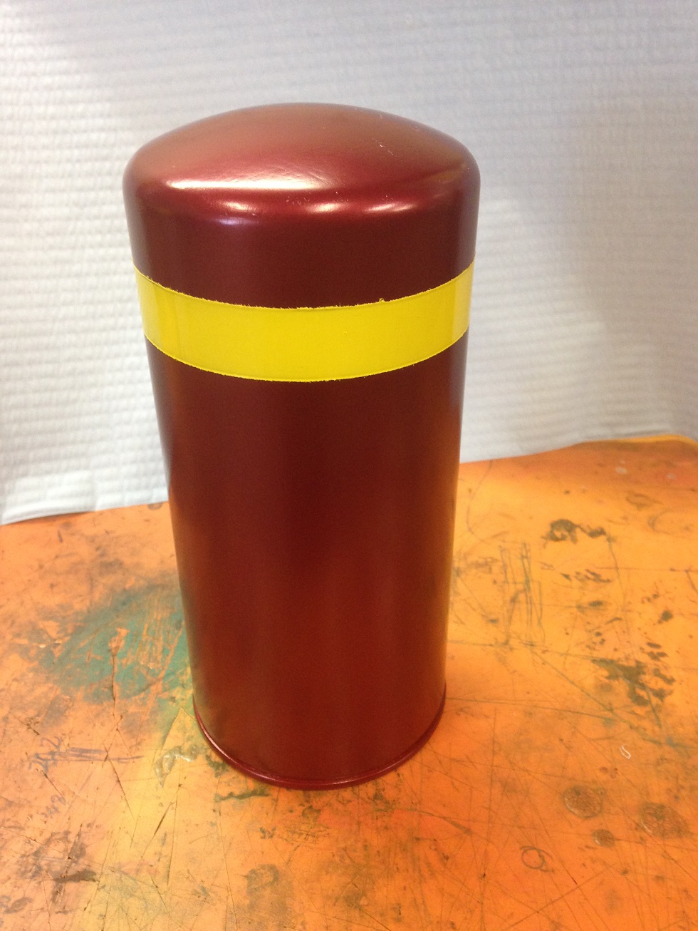

Masking tape removed.
Masking Removed
Masking Removed

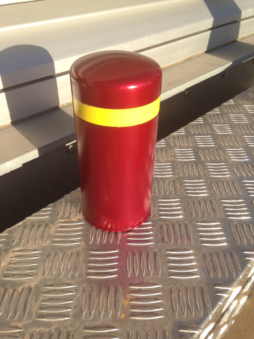

Clear coats sanded back followed by a polish.

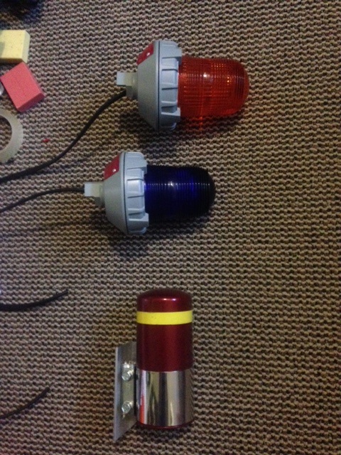

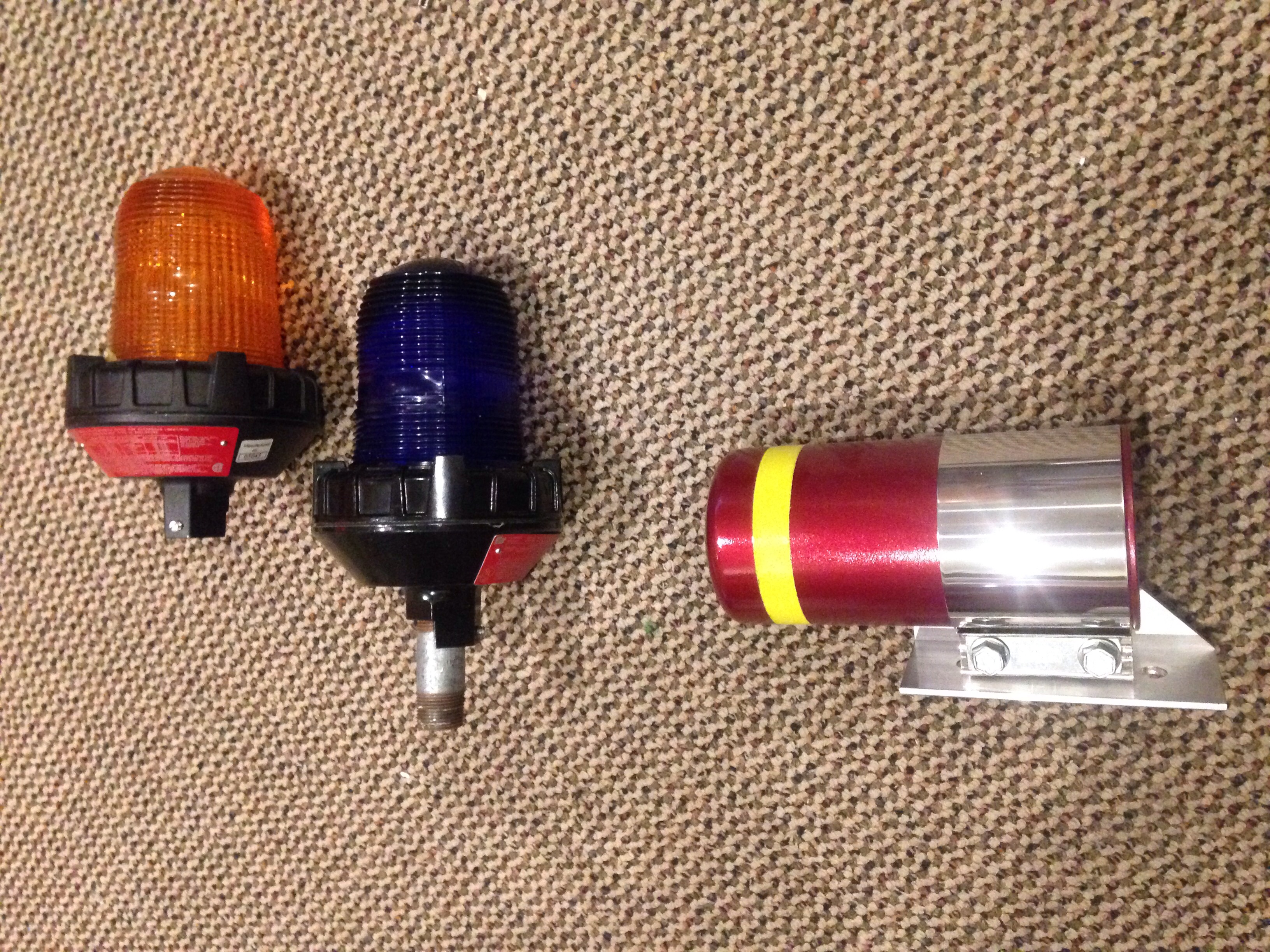

Completed buzzer, clamped onto the bracket and shown beside one of the lights for scale. :D
Finished.
Finished.

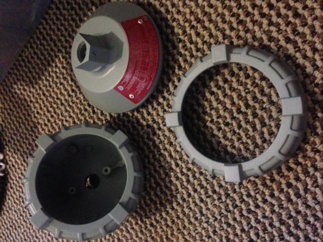

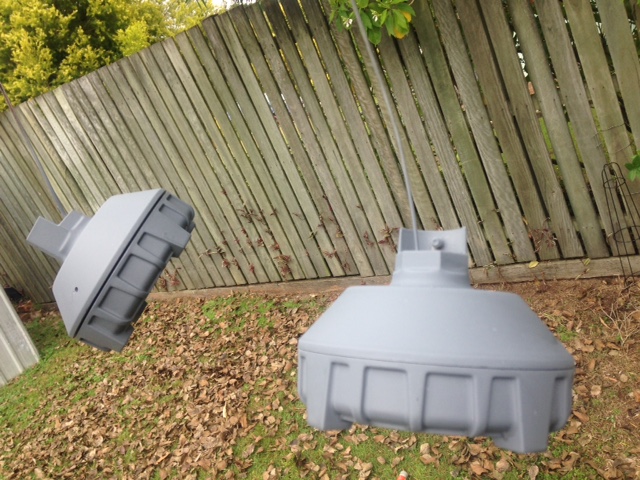

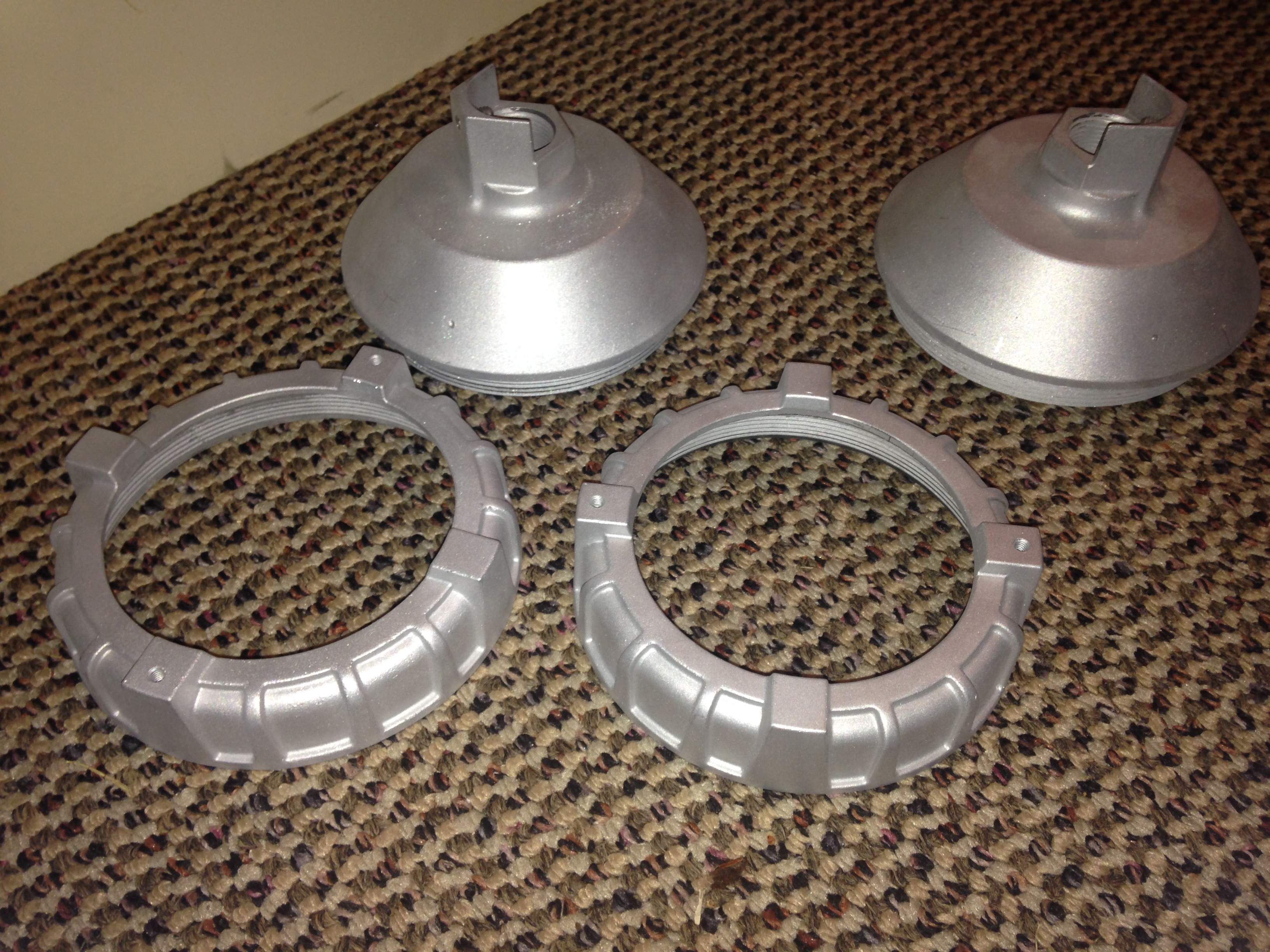

I have managed to sandblast the black powder coating off the light bodies, then etch prime and re-paint them the correct colour.
had to delicately remove the ID plates and re attach them afterwards.
also got some 12v DC globes for the lights to make my display safe in public, no 240v and can run off the car's cigarette lighter ;)
I'll add more pictures as I achieve more (doing a million things at once).
Sandblasted
Sandblasted
Primer
Primer
Grey paint and ID tags back on.
