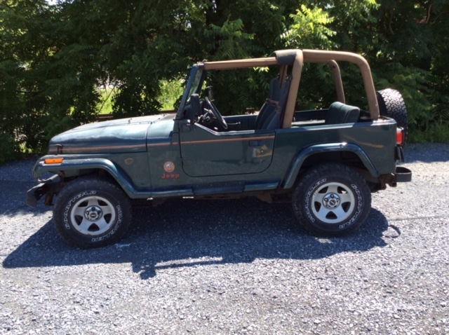

I am posting this for the owner of this Jeep
It started out as a pretty rusty Jeep Sahara sitting near Reading PA
The seller actually told us that this jeep was passed up by someone else a year earlier for a Jurassic Jeep because it needed too much work
It included soft doors and top parts to keep it screen accurate
It also included 2 original rust free jeep fenders to replace the ones that came on the jeep
I replaced both front fenders and a really bad tailgate
found a used tailgate

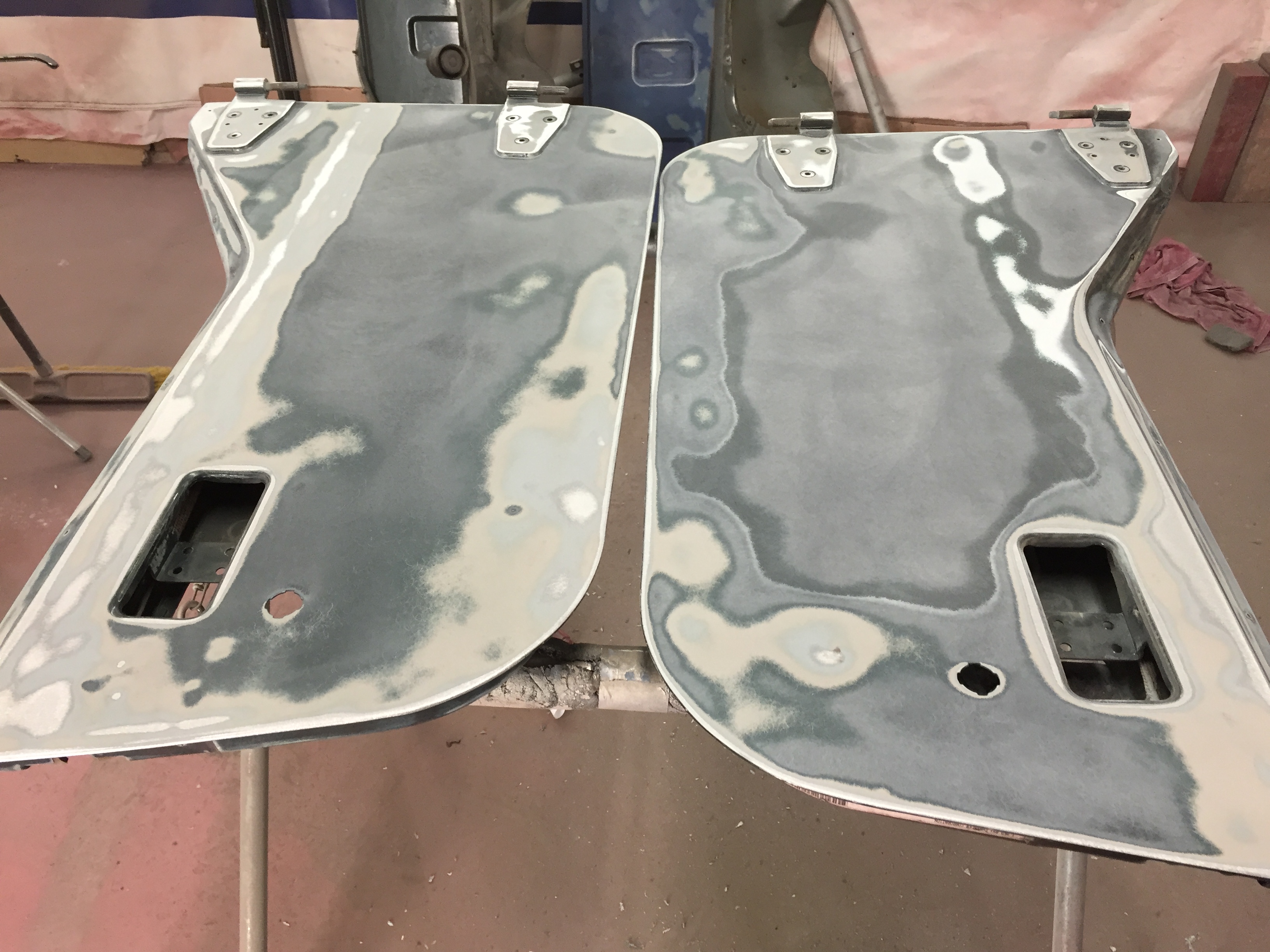

The body overall was in good shape but the paint was worn and peeling, Jeep was sanded all dents removed and primed for block sanding including doors

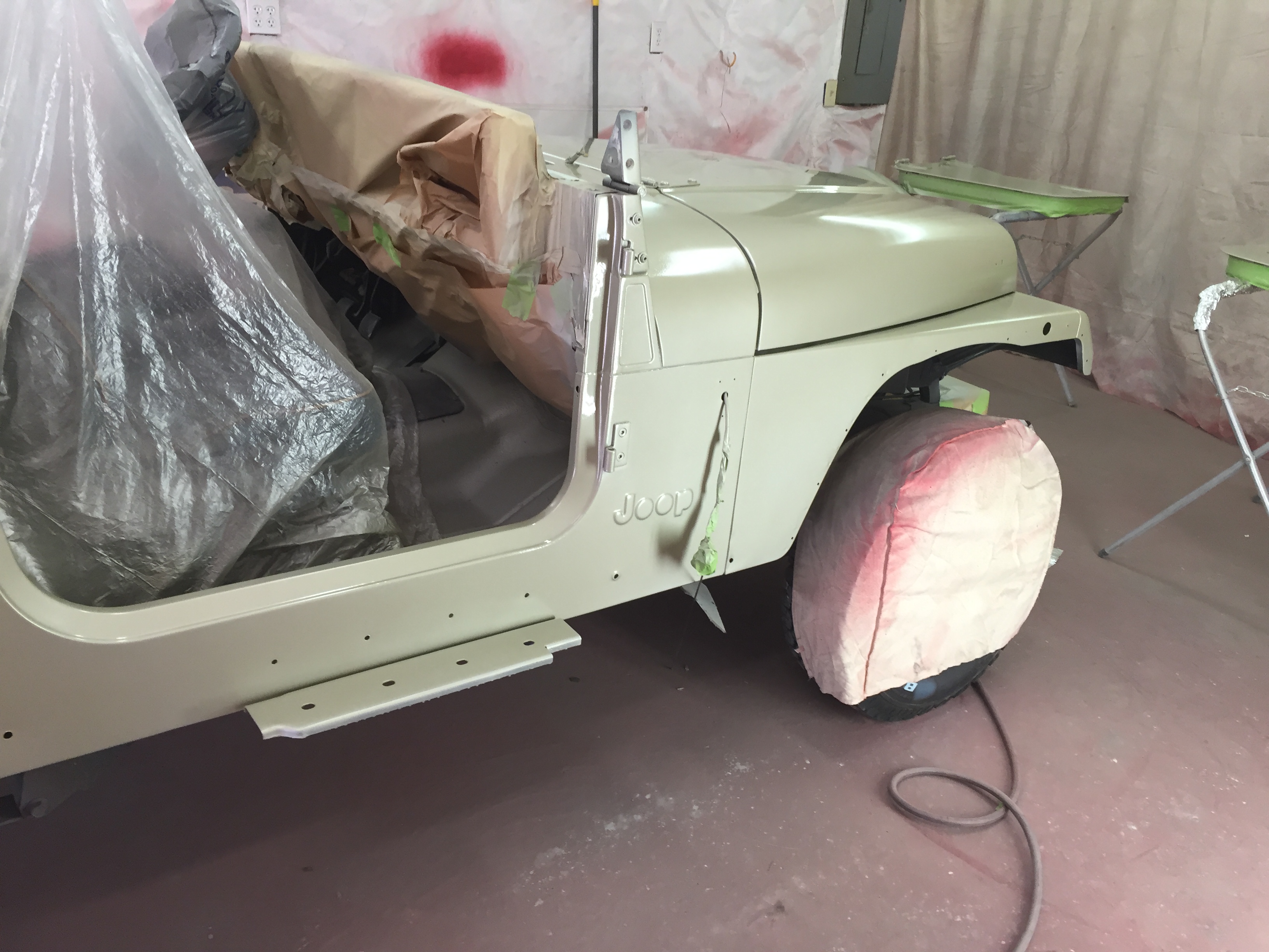

After block sanding the primer , the jeep gets a second primer coat and the final sanding is done prior to painting
Jeep then gets 4 to 5 coats of sand beige low gloss poly paint,the color is amazing
All flares are also painted at this point and flex agent is added to the paint for those so the plastic parts can flex and not crack the new paint

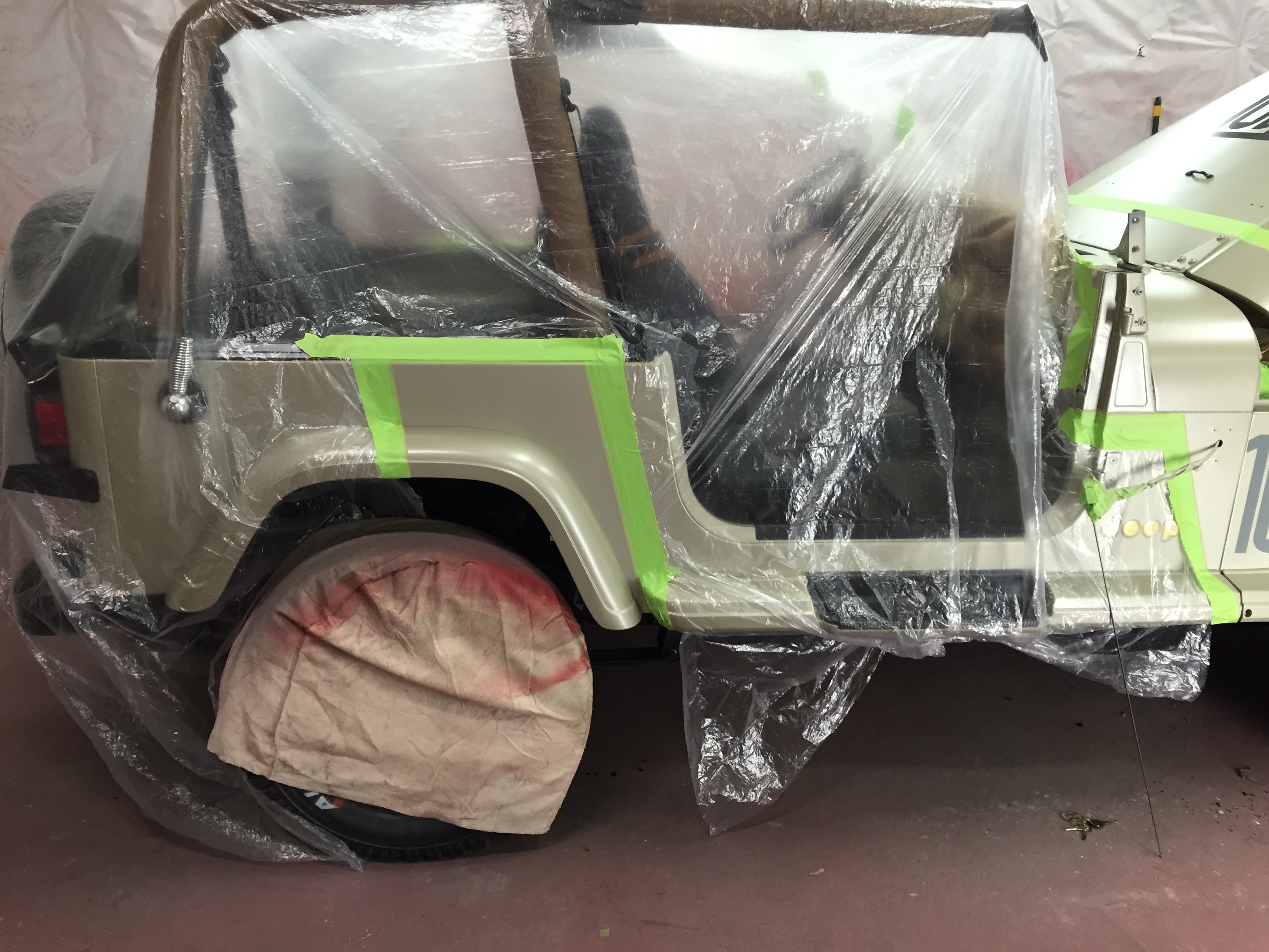

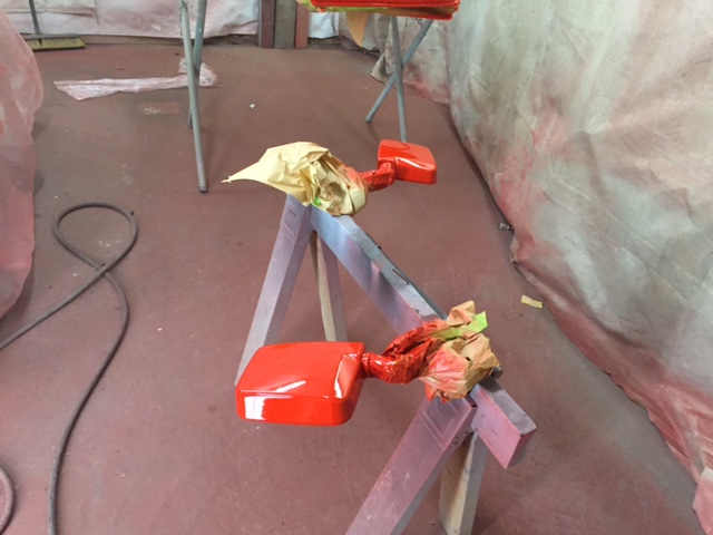

Once the jeep is back together the entire jeep gets masked off again so the stripes can get painted on
This includes light sanding of the beige areas to give the red good adhesion
Then the red is applied to body mirrors and the windshield
