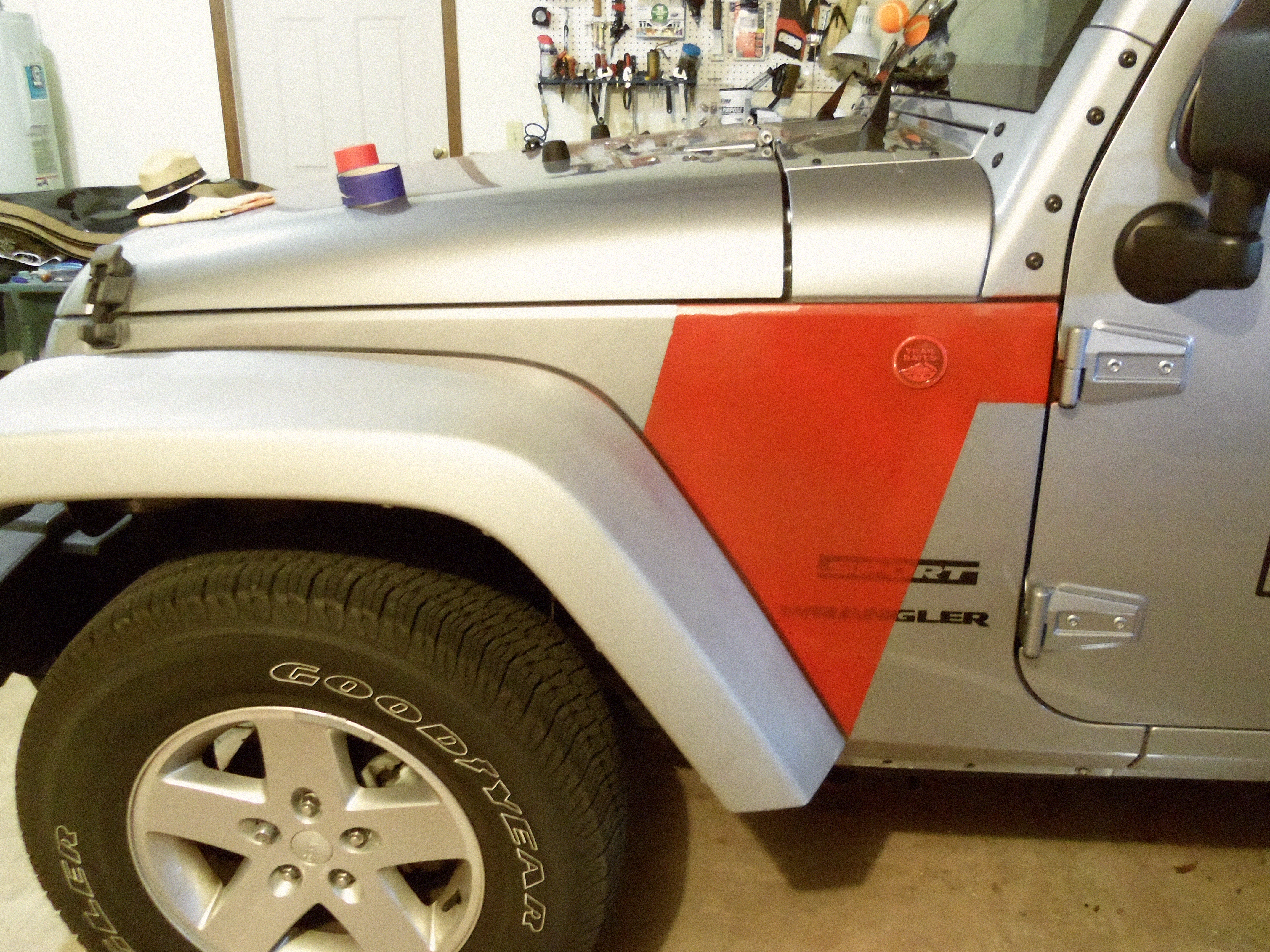

I've decided to start experimenting on the best way to add the red for the JK model... So far, I've started a little test area to figure out the best way to paint on the red strip near the front. Here's a pic of my progress. That red will be removed and re-applied when I finally paint the rest of it. I'm grateful for whomever came up with Plasti Dip. :D

I like how you laid the stripe out. Is that a 2 or 4 door? if you put the plastidip on thicker its easier to peel off. the plastidip will only last a year or so, especially if you drive it every day. mine has been on for 1.5 years, but I dont drive it everyday. It's about at the end of it's life, since there are places where it is starting to pull off. My once clean straight lines aren't so perfect anymore.

Thanks. Its a 2-door. And yes, the final application of plasti-dip will be much thicker. That in the picture has already been peeled off.

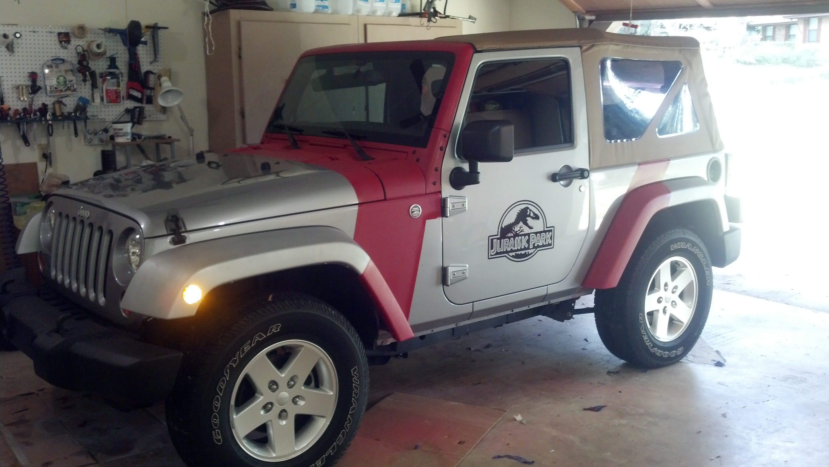

Here is my progress so far. The difficult part was timing it just right to peel off the painters tape from the Plasti Dip. I will have to go back and touch up a few edges where the paint pulled. Also, I found a supplier that makes a spice soft top for the JK model. And, just for good measure, I've attached that all black JP logo and will go with the full color one once I'm finished with everything else.

Nice. Have you thought about trying to match the angle on the back stripe with the angle on the front?

No, I was going with the angle of the back fender.

you have to pull the tape as soon as you finish spraying.. at least thats what I found... Whileit as still wet basically, as soon as it starts setting up it bonds to itself and then you get lift.
I think the stripe angles would look better if they were close to the same angle (though I realize that is hard on the new body as there is almost no room behind the front wheels)
Wow I had no idea anyone even made a spice/tan softtop for the new models.... who makes it?

So far, I like how the front turned out, and I didn't want to angle that part anymore than I already did. The sharp angles on the screen accurate jeeps look funny on the frame of the new JK in my opinion. Haha, this would be sooo much easier if Jeep didn't change their body style. :? Oh Well.... I did re work the back strip to closer match the front though.(will post pics later). Thanks for the tips on the Plasti-Dip. I did figure that out when I re did the back stripe. Basically,just before peeling the tape, I sprayed it and it removed quite nicely. And a company called "Rough Country" makes the Spice soft-top for this new model. They sell just the cloth and you have to attach it to the fame yourself.

Im with fantomas but I do see what you are talking about with the fender and door design. It might look bad with that door corner so close to that fender. Looking fantastic!
