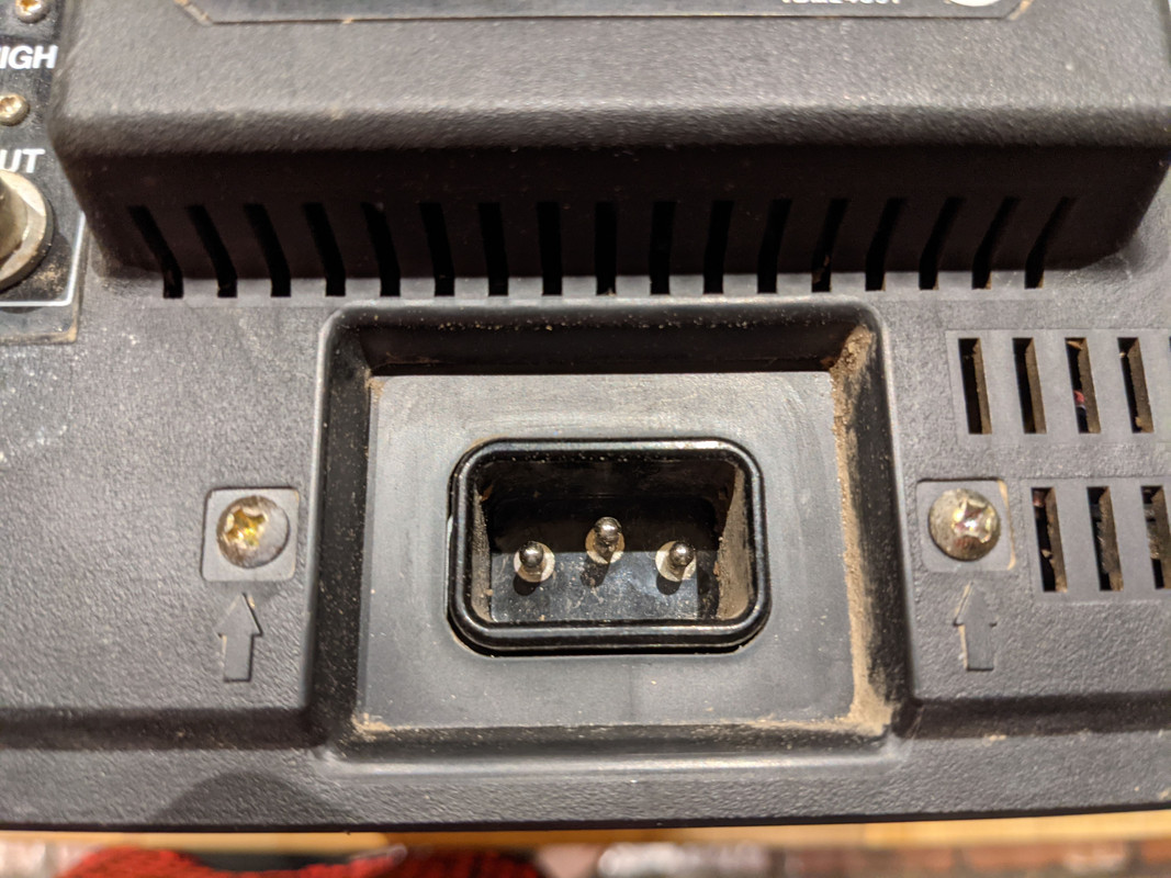

Still need to finish wiring the adapter so I can charge the Maxa Beam. I'm excited to see it work.

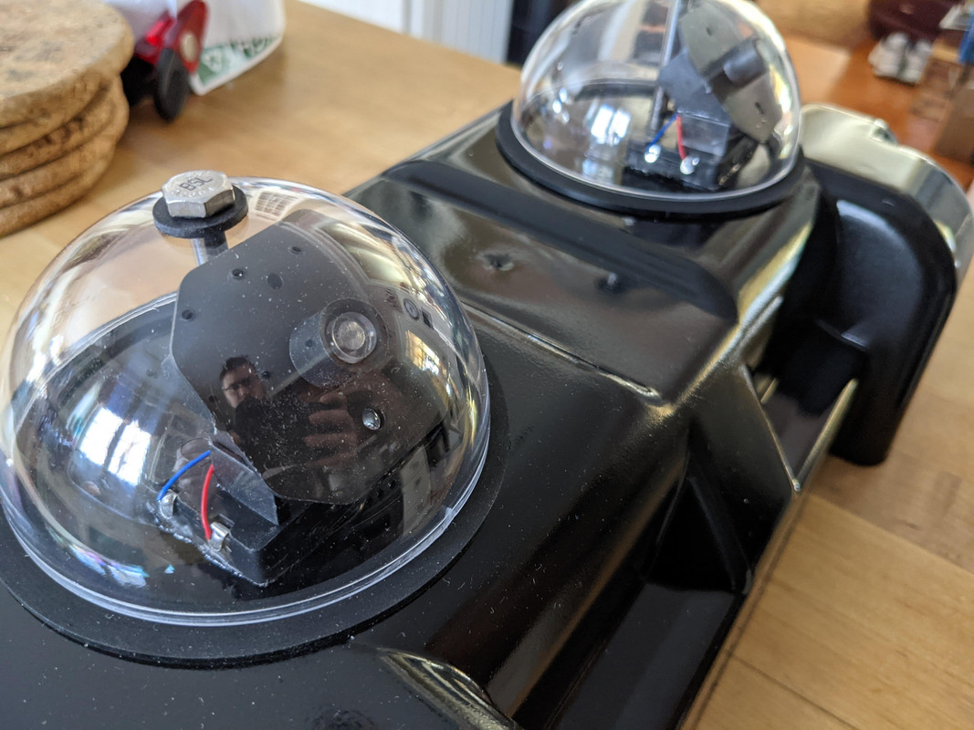

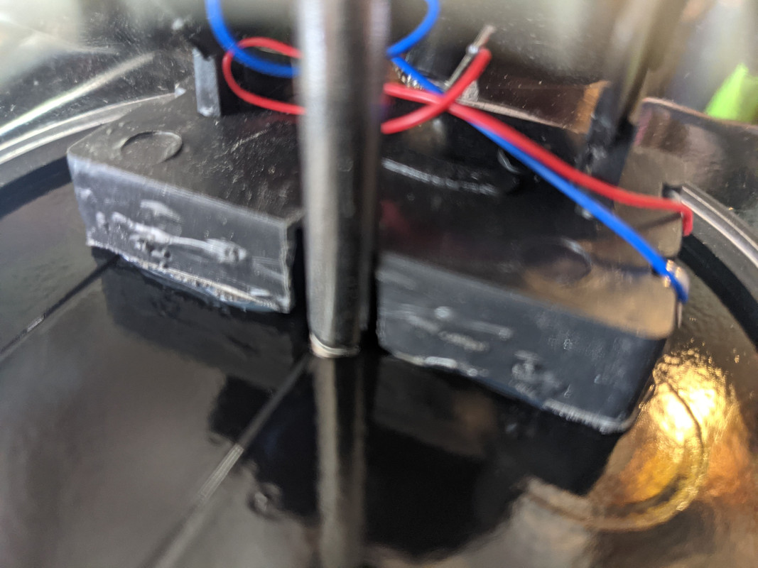

I re-visited the fake dome cameras I picked up for the track sensor and got a little crazy with the Dremel and some E6000 glue. Still need to attach the brackets to mount it on the front license plate holder.

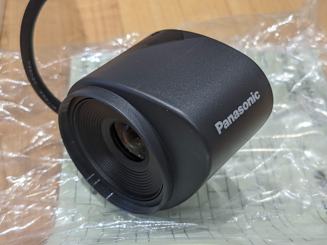

I picked up the BL-90 US cameras that Mr. DNA found a while back; just added some reference photos in case anyone was curious how those compared to the BL-90A and the BL-90 Japanese version. Mine have generic 6mm lenses on them. I can pick up a pair of WV-LA6A lenses that would be the correct profile for about $120. I guess it comes down to the old question of "screen accurate or close enough?"

Got the fake dome cams from Amazon: https://www.amazon.com/gp/product/B079G ... UTF8&psc=1
The camera, bracket and base of the dome are all one piece. I cut around the base of the battery box to get rid of the dome base and wound up cutting off about half of the battery box to get it to fit inside the clear dome. Also had to put a notch in the battery box to fit around the bolt. I ran around the edge of the battery box with clear E6000 glue and stuck it in place.
I scuffed up the box with a Scotchbrite pad and hit the areas I cut off with some sandpaper. I didn't use high enough grit on the sandpaper and will have to revisit the area again with some filler-primer at some point to fix what I messed up. After scuffing, I wiped it down with isopropyl alcohol and sprayed it with some Rustoleum satin black that I had on hand. Finished it off with a couple coats of Rustoleum gloss clear coat.

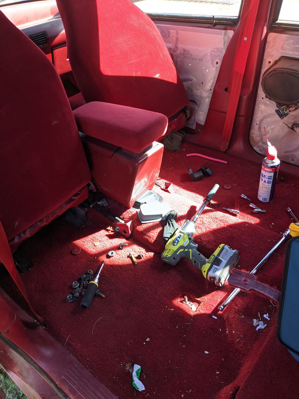

Did some more cleaning on the 92 Explorer and started stripping down the 91 to get ready to swap doors. I also pulled the seats out of the 91 and discovered that the floor pan profile changed between the 91 and 92 and I'll need a different slide track. I've found some aftermarket replacements but those guys want $124 per seat for the rails. My local scrapyard has three pre-95 Explorers on the lot right now and, if I'm not mistaken, I should be able to use the slide rails all the way up to an 01, which gives me 23 vehicles to pick from. Hopefully I'll be able to find some AS2 glass in that mix and maybe pick up some new side mirrors in better shape than mine while I'm there.

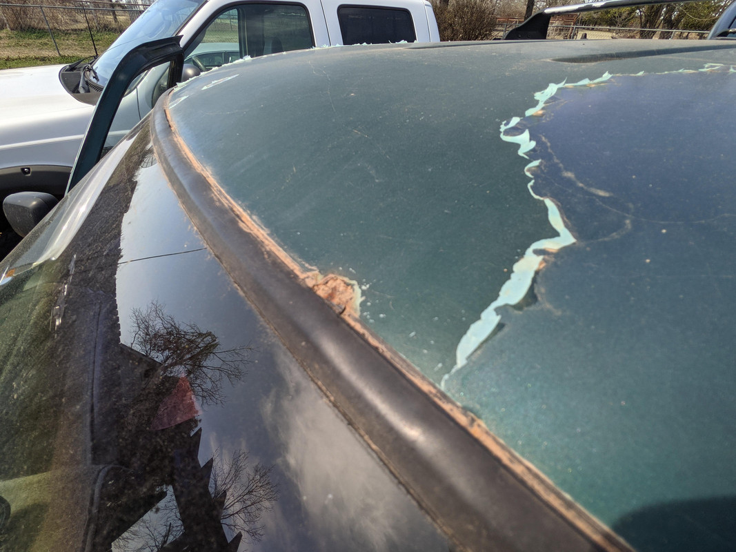

While stripping down some of the 92 interior I noticed water in the cupholder. Found a small drip coming from the headliner. Tracked it back to this lovely rust spot. Probably going to do a temporary patch on it until I get to the painting phase, at which point I'll pull the windshield, correct whatever lies beneath and have a new windshield put in.

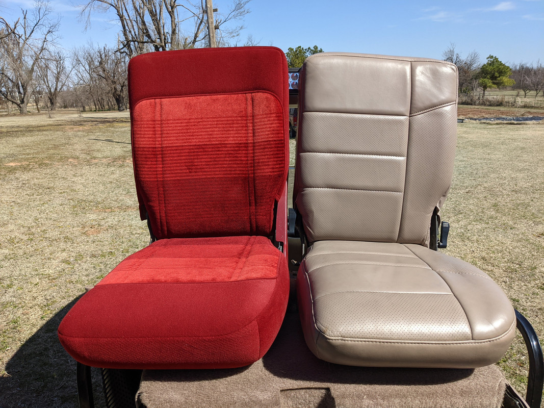

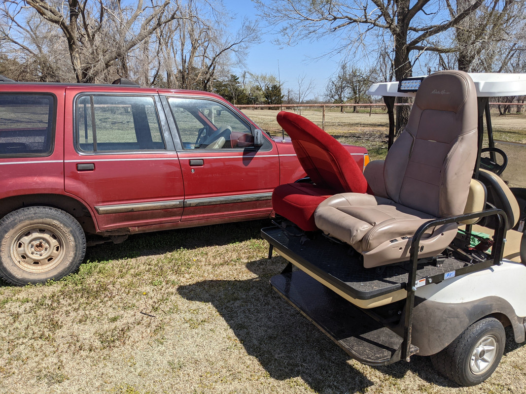

I pulled all the seats out of the 91 and started prepping them to go in the 92. Discovered that the floor pan changed a bit between the 91 and 92 resulting in different seat tracks. The 91 seat tracks are two seperate pieces with some springs connected between them. The 92-01 seat tracks are all one piece. A quick trip to the junkyard yielded a nice pair of seat tracks from a 96, rear quarter AS2 glass from a 99 and a factory premium sound subwoofer plastic faceplate from a 93. It's slow going pulling the aftermarket tint off the quarter glass and one of the windows has pitted rubber but it should work well for the time being until I come across something in slightly better shape.
Snapped this for a quick comparison of the back seats. The red cloth is from the 91 XLT and the tan leather is from the 92 Eddie Bauer. The seat foam and mounting brackets are all identical. Just the front seat mounts changed.

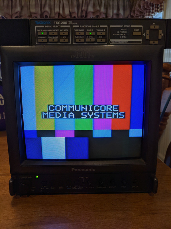

The 7" Panasonic monitor showed up and looks pretty good. Just need to rip out the weird power connector and replace it with a standard one. Or just wire it directly to a cord - that would probably be more reliable since it's going in a vehicle.

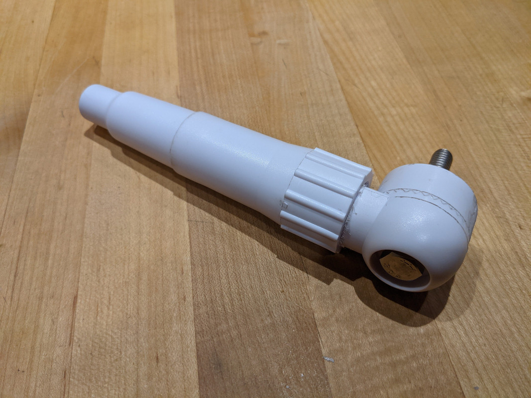

Also started in on the mirror antennas. Got the Tram mast cut off from the mount, cut off the additional mounting ear from the mount and shaved off some of the plastic from the threads so the antenna holder sits a bit lower on the mount. The original Tram mast was very thick and rigid. I wanted the antennas to move like in the movie when they closed the doors. I picked up some fiberglass yard markers from the hardware store that move the way I want them to and got the holes in the mount drilled for them. Just need to finalize the length, epoxy everything together and give it a good coating of black paint.
