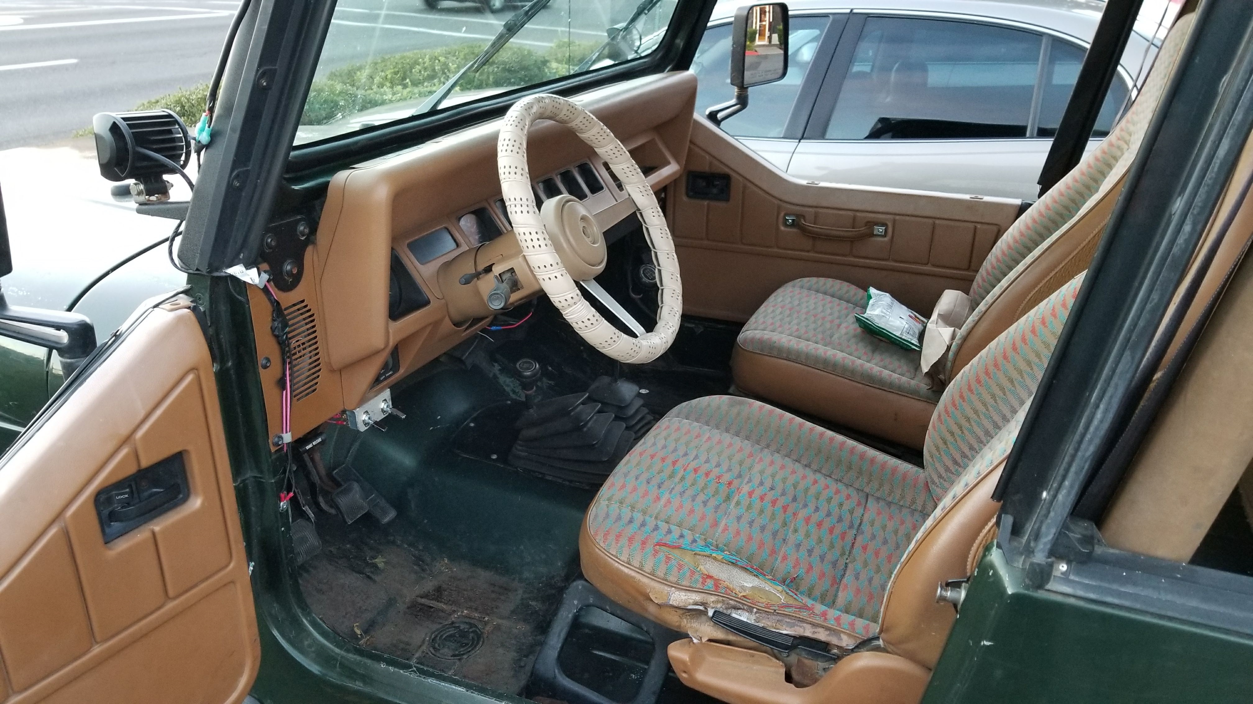

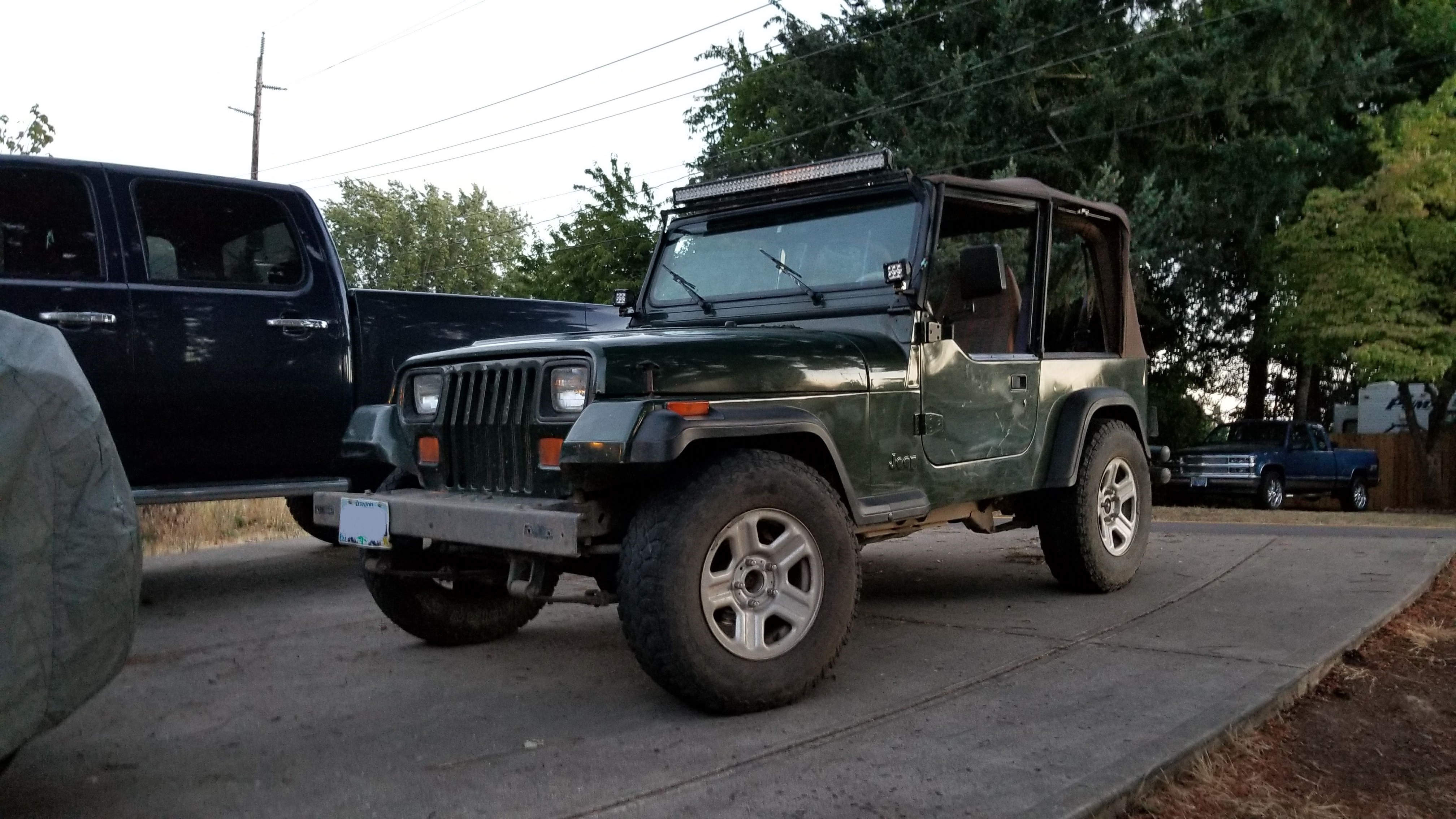

Hey Friends!
Probably goes without saying, but I've been obsessing over these Jeeps since I was a kid. Grew up watching the movies, and fell in love all over again when I finally read the novels as a teen. I was only 19 when I joined forum back in 2009, but I was enthusiastic about following people's builds and watching as people were researching and discovering details. I put the idea of doing this project on the back burner while I focused on LIFE things (education, house, car... Etc.). Nearly 10 years later, I finally fit the criteria of an 20-something-year-old with a bit of disposable income to throw at a project like this.
ANYWAYS. I finally managed to make it to step 0: Get a YJ. It's a little rough, but overall it could be worse. I found this 1995 2.5L SE locally in Oregon for about $2900, which felt like a steal (assuming there isn't some crazy mechanical problem I haven't noticed in the 8 months I've had it).
Here are my To-Do items!
To-Do - Short Term
1. Clean: Inside and out! The top is dirty, the seats are dirty, the dash is dirty, the roll bar padding is dirty.... You get the idea.
2. Get it Watertight: A SUPREMELY dumb issue, but my Rampage soft top has a zipper on the rear window that doesn't have a block to prevent the slider form just sliding right off. Original owner lost it, I'm just waiting on a replacement. And for anyone who needs to know in the future, a Rampage soft top for a yj uses a #10 non-locking vislon slider. It took me WAY to long to track down that info.
4. Sand/Paint/Body work: I intend to do this on my own. Obviously it needs to go from green to Sand Beige. The only quote I've got so far was from a local paint supplier. They are asking $700 per gallon, if they match it to PPG LJ1. Which is obviously insane. So I'm still looking around. Anyone in Oregon/Washington feel free to hit me with advice on where to source the paint! The body shops I've talked to don't wan to just sell paint, they just want me to pay them to paint it. :p
5. Get Side Steps: Already found a set on CL for about $60 up in WA. Got lucky on that one!
6. Get stock wheels: Again, already got a set of 5 off CL for about $125 total. Lucky again!
7. Get decal kit: I think I"m set on JP22. Just need to put the order in with kccaprice!
8. Get Whip Antenna
9. Replace Carpet: Going with Spice to match my current interior, please don't stab me! Not screen accurate, but accurate enough for me, lol.
10. Bring Existing Parts up to Parr: Cracked windshield, broken driver's side seat belt, broken nylon strap for driver's side door, broken stereo, missing zipper for rear window, cracked headlight bezel, and rusty hardware.
To-Do - Long Term
3. Get Sahara Seats (Ditch existing seats/covers)
4. Get Sahara fog lights (Ditch existing LED fogs)
5. Get custom light bar (Ditch existing LED light bar)
6. Replace soft panels (Ditch existing, but OLD Rampage top)
7. Get Ramsey Winch/custom tow hooks
8. Get/reproduce Sahara Interior Fixtures (center console, door panels, dashboard.... Maybe carpet again if I go that far. I'm probably leaving it Spice though)
I think that covers most of it! For those detail oriented folks, I know, I feel your pain. This has a LONG ways to go before it is screen accurate. I hope to hash out the details over time. Well... Maybe not a 4L engine swap... Or full interior replacement but who knows. "Screen accuracy" is likely something I'll never reach, simply because I will personally feel satisfied with getting it 95% there.
THINGS THAT WILL BE WRONG FOR A LONG TIME... Either because there's a cost/availability issue that I'm not able/willing to accommodate or because I simply don't intend to make a particular change:
1. Seats: I'm just putting covers on them for now. Sahara seats are impossible to find for a reasonable price locally.
2. Light bar/fogs: Simply put, I kinda like the look of these LED lights it came with.
3. Spice interior: I'm in no rush to replace the door panels and dash. Plus I personally like Spice over black/green (blasphemous I know)
4. Rear Bumper: Not pictured just yet, but there's a chunky after market bumper on mine. Again, I just kinda like it!
5. Winch: Just one of those details that's hard to track down. I'll be taking my time
6. Rear KC Hilites: Another hard to find detail. I DO have a set of random orange fogs that are SIMILAR that I might use. Again, I"m not SUPER concerned with total screen accuracy.
With that, I'll attach a couple photos, but expect more details in the coming days/weeks!

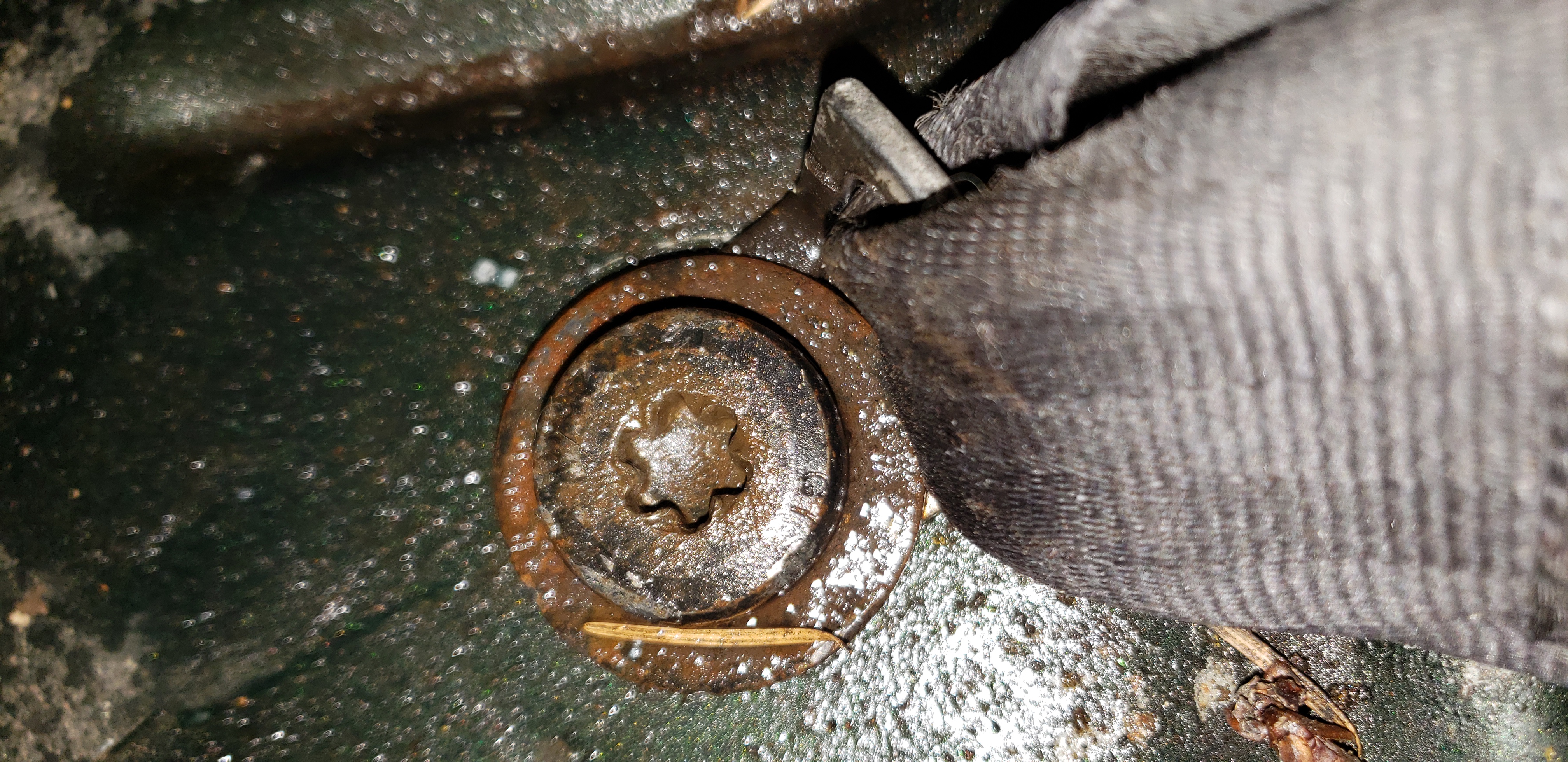

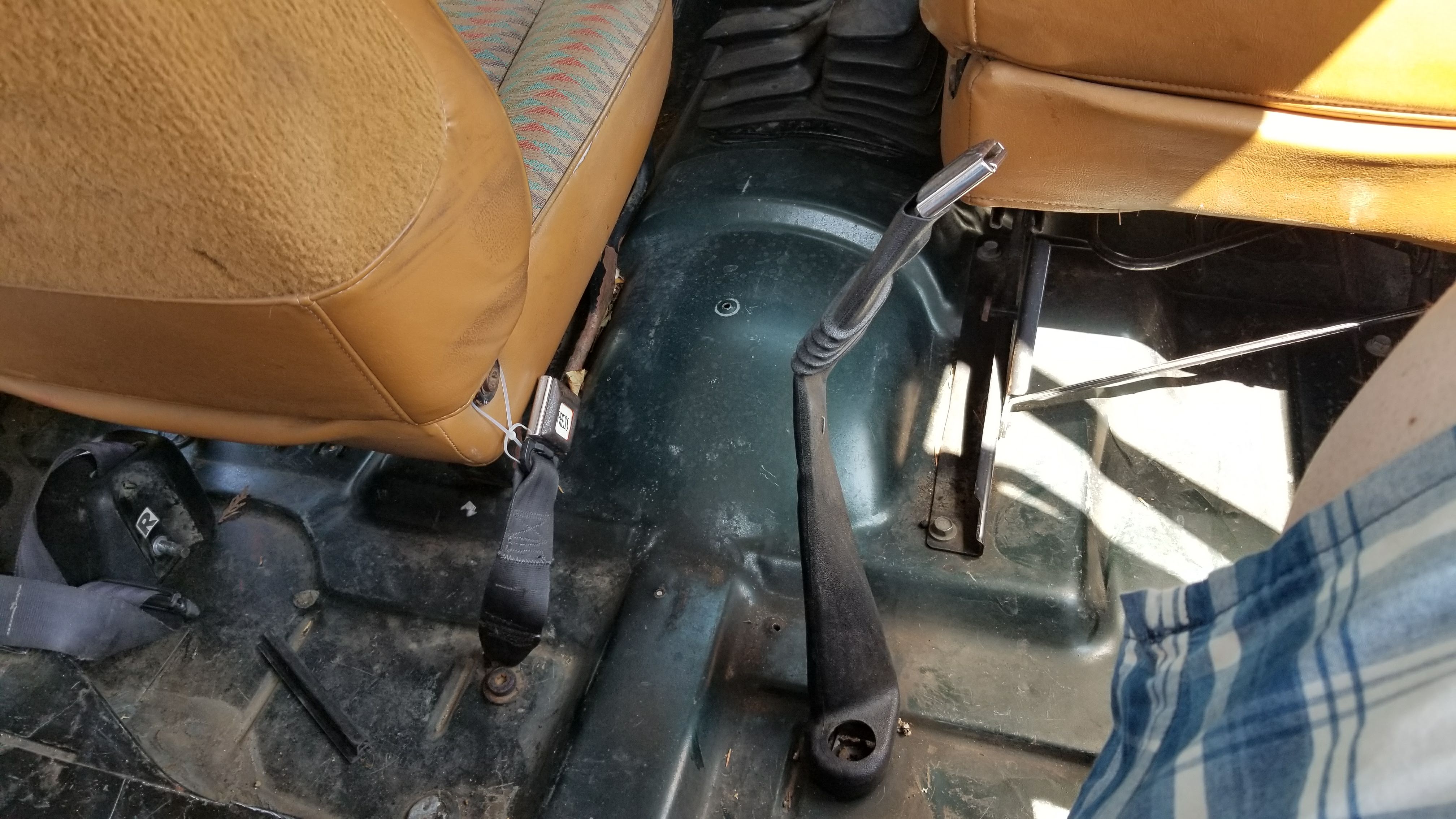

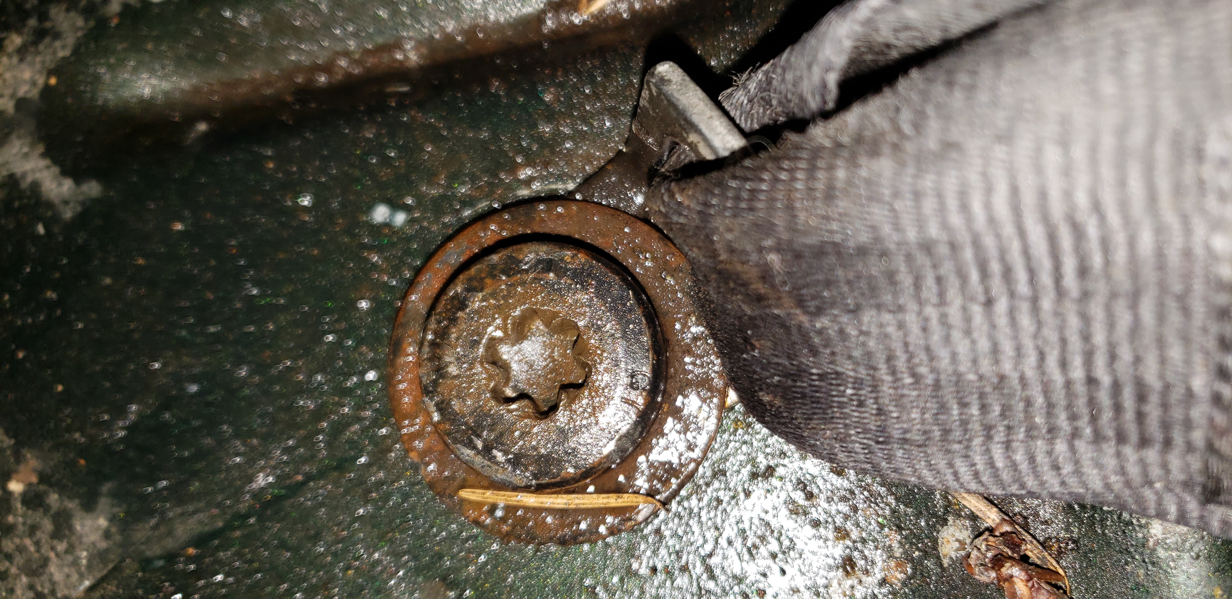

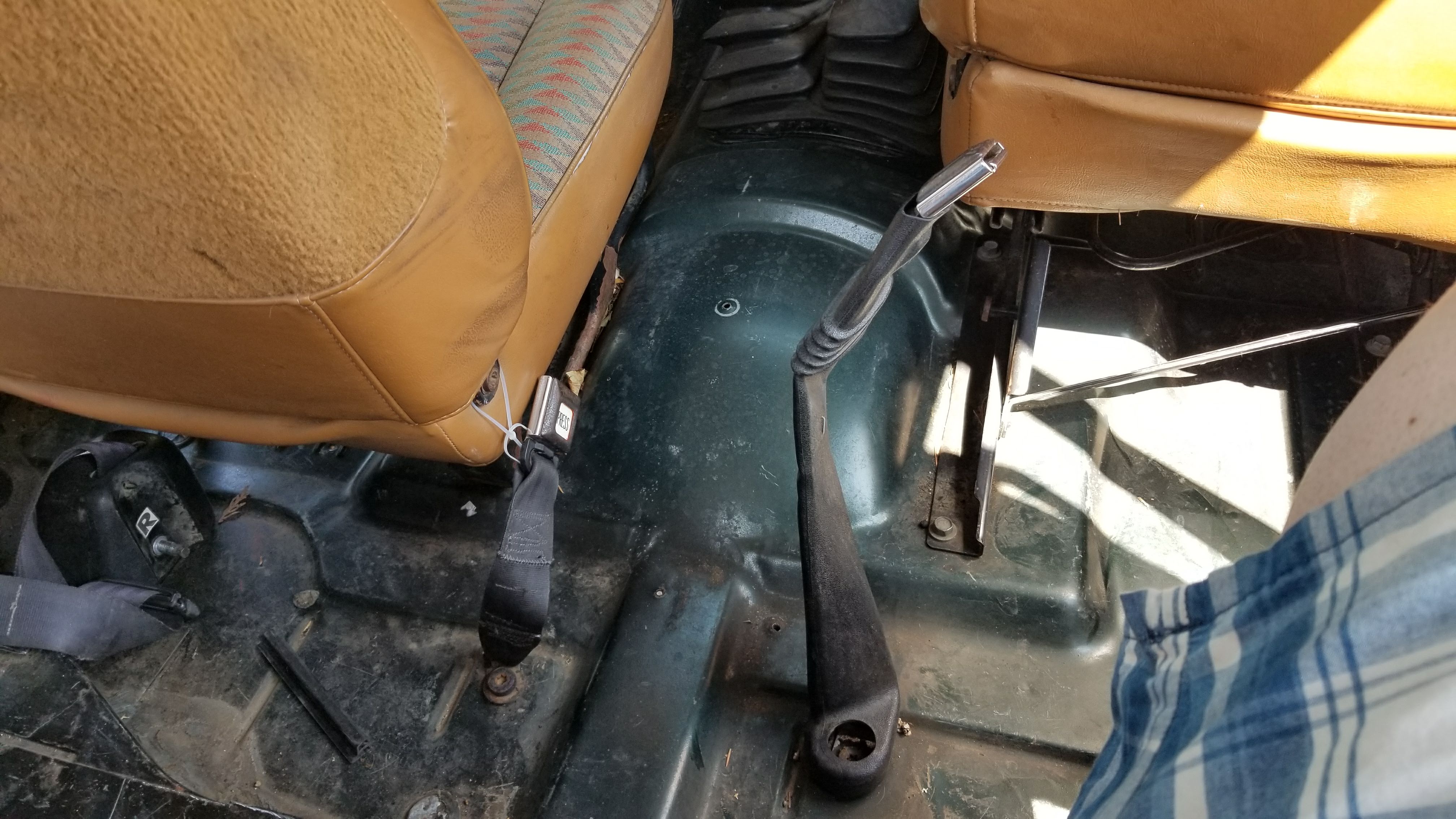

As a teeny tiny update, the original driver's side seat belt clasp failed at some point. The previous owner took the rear bench seat clasp and just kinda bolted it down zip tied it in place
I tracked down a replacement but THIS STUPID TORX T50 WON'T COME OUT
Vent session over. I"ll let you guys know what ultimately works! Fingers crossed that I just need a better penetrating oil, lol.
Re: JP22 Build Thread - Willamette Valley Oregon
I didn't discover the cepek rear fog lights and idk who did. no one said anything on here and I was blown away that it was common knowledge to everyone but the forum members. kinda seems like the knowledge is flowing backwards now.
a impact drill will get it.. are you soaking it from the bottom also
also... put valve grinding compound on the end of the bit for a damn good bite. I little mud works as a substitute.
I'll give it a go this weekend! And yes, I had sprayed WD-40 on the underside of the screw as well. It's just very stubborn.ratrace427 wrote:also... put valve grinding compound on the end of the bit for a damn good bite. I little mud works as a substitute.

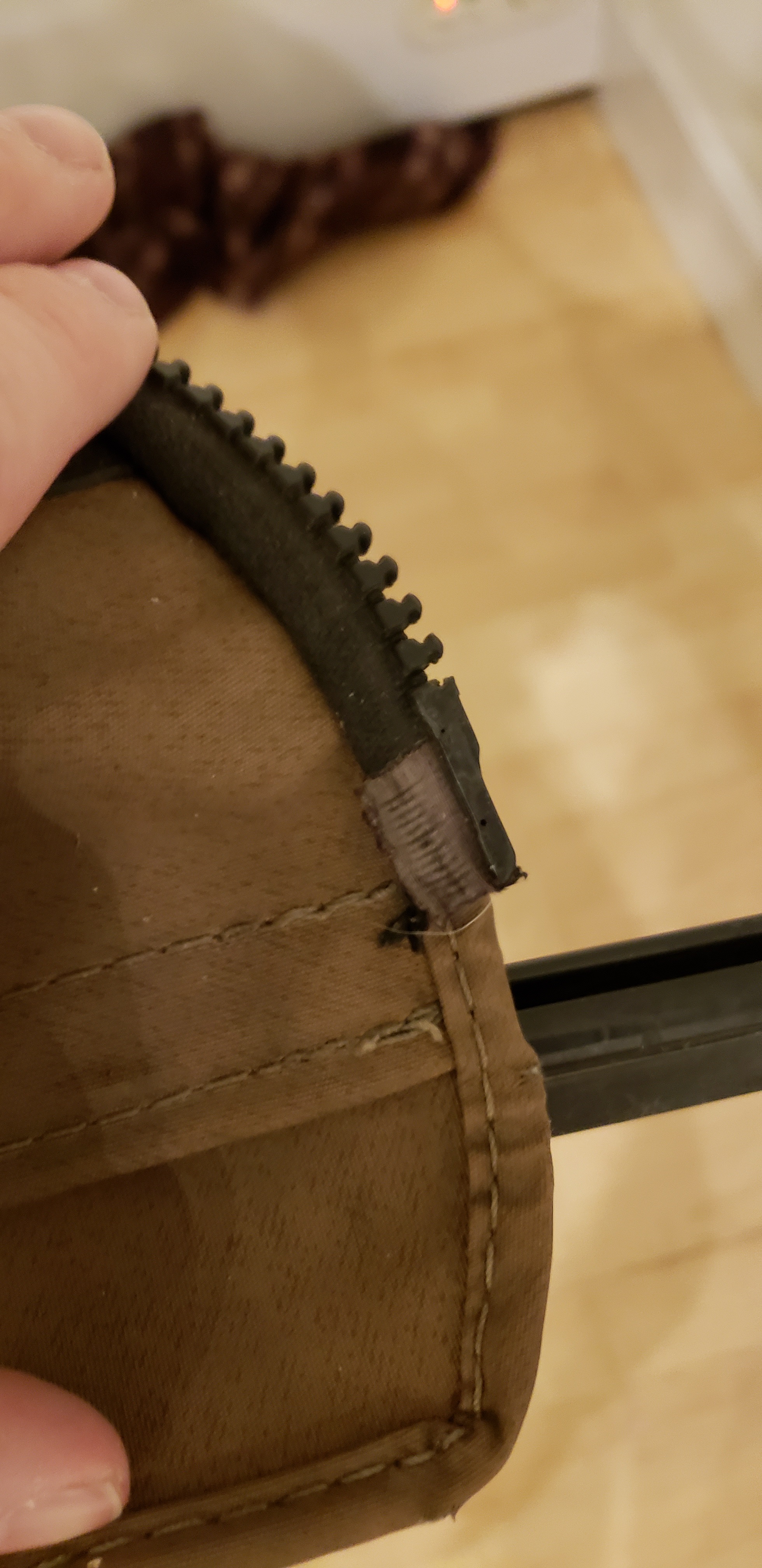

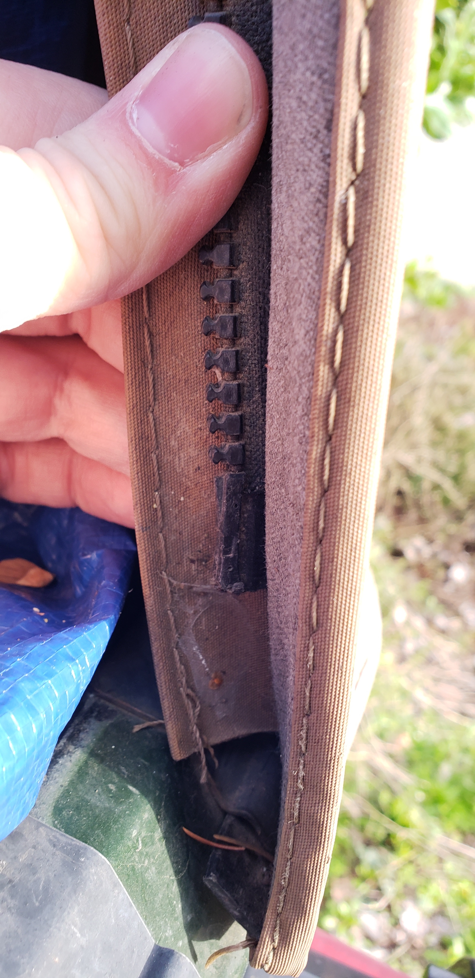

Another small update. Here are photos of the DUMB design of my rear window panel, which is a Rampage model 68217. As you can see, there's no block on either the window side or the top side of the zipper track. This means there's nothing to prevent the slider from simply falling off. I suppose I shouldn't assume that the soft top was always like this, perhaps there WAS a block and it just broke or fell off. It just doesn't look like it was ever there to begin with.
The rampage rep I was speaking to hasn't replied since I gave them the model number via email, but their initial suggestion was replacing the rear window, which is clearly not necessary at this stage.
To reiterate, this is a "Vislon" style zipper, this just means the teeth are flat and made from molded plastic. The slider is the #10 size. My only indication of this sizing was a tiny "10" embossed on the back of the OTHER zipper sliders. Otherwise, it seems zipper slider sizing changes depending on the type of zipper you have.
I went ahead and purchased this slider from amazon -> https://www.amazon.com/gp/product/B005I5JA2G/
My hopes are high based on the reviews
If it works out, I'll get some of the interior stuff done while I wait on paint quotes. This will mainly consist of removing all the interior fixtures (Seats, seat belts, shifter cover, etc.), giving the tub a good scrubbing, laying in the new carpet, cutting holes IN the carpet for everything to screw back into, and reinstalling everything, including that stupid seat that's giving me a hard time. As a note that I will later elaborate on, I intend to secure much of the carpeting with durable adhesive 3M Velcro strips. This is to help make the tub area of the Jeep more serviceable.

Already digging this! For stuck bolts, I always have the same solution- fix it with fire!
