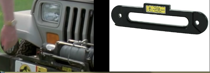

If it matters, the amazon one doesn't match the screen-used piece.
On the screen cap, the logo is at the bottom (and not upside down) the sticker is different, and the top 'lip' comes out farther. That being said, Ramsey still makes the exact match—but it's more expensive.

http://www.summitracing.com/parts/rwc-251152/overview/
There is the ramsey one since you actually have a ramsey winch. sorry I should have noted since my winch is not a ramsey I didn't care that the fairlead was slightly different too.
