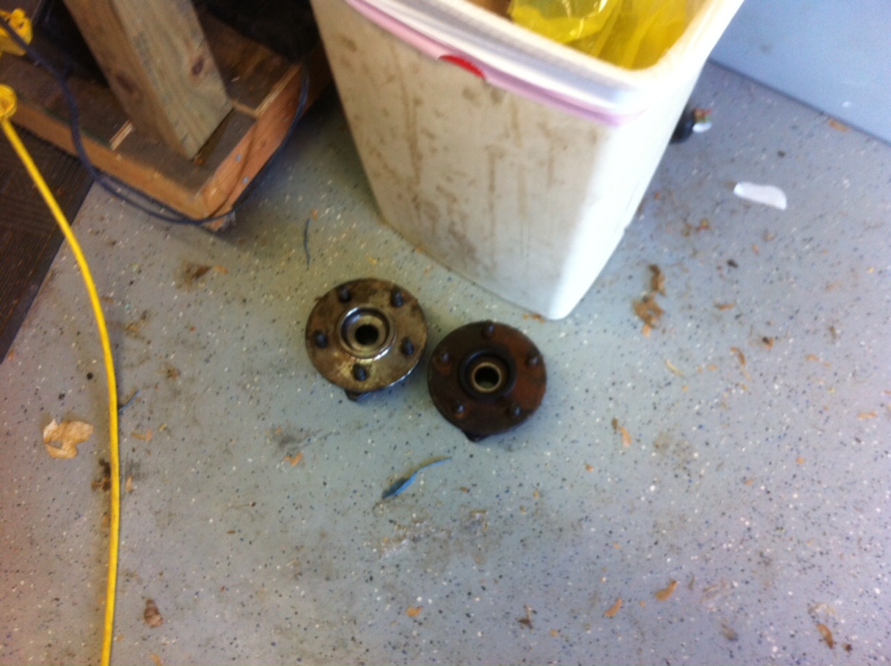

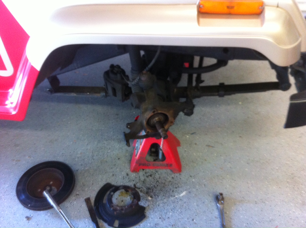

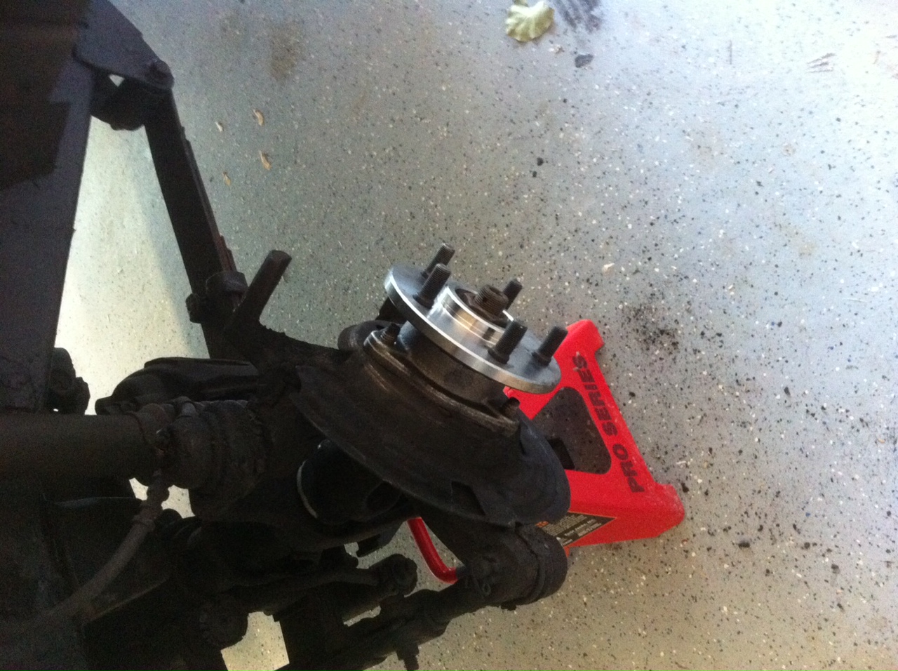

Had to take 29 under the knife. I have had this rotational noise from 35-55 mph. I thought it was carrier bearings at first. Isolated to the front unit bearings so I swapped those out today. Some of the 19 year old bolts were a bit tough had to get out the flame wrench to warm up those bolts on the axleshafts. Now the only noise I hear at speed are the other jeep noises :).
