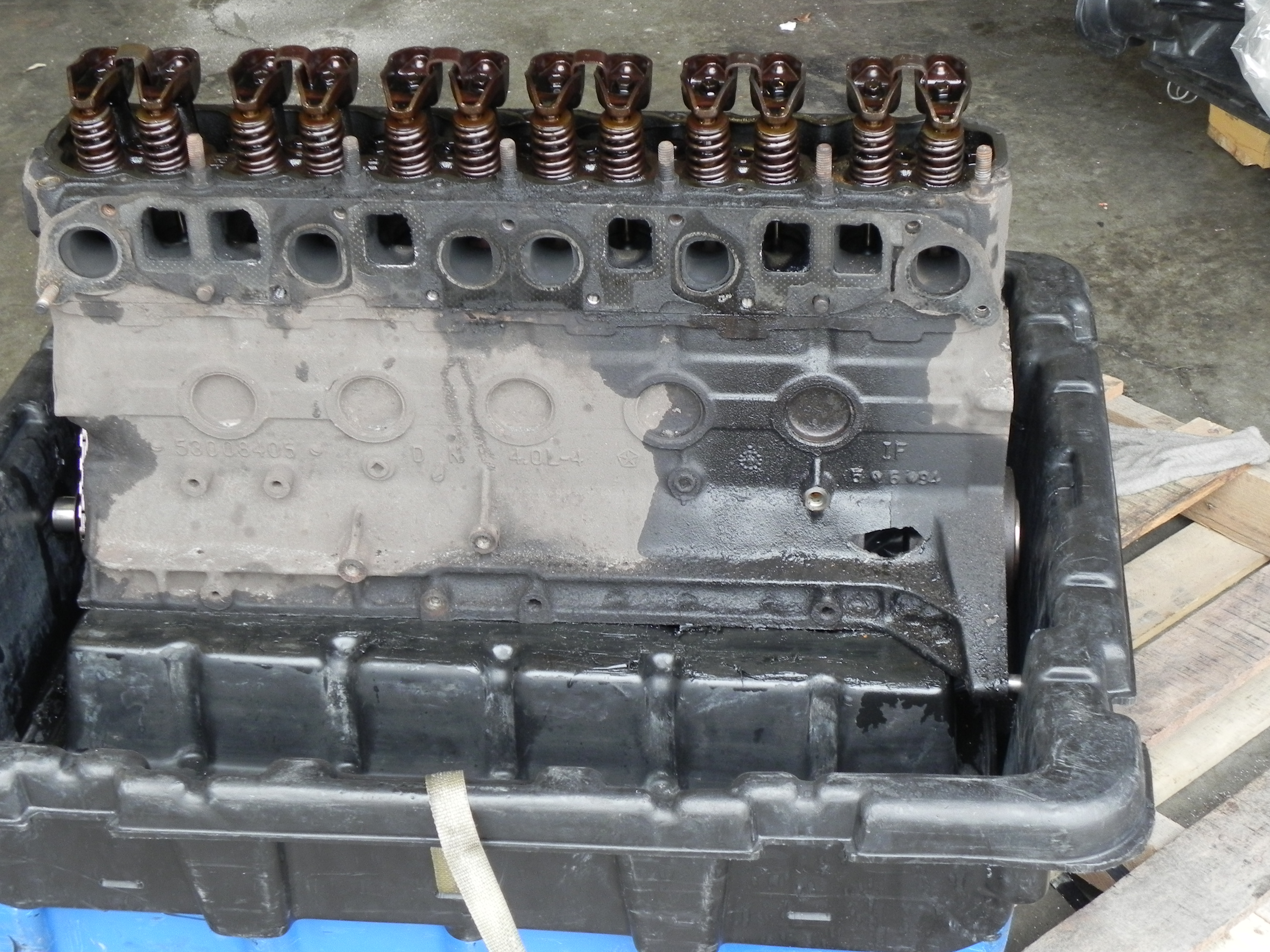

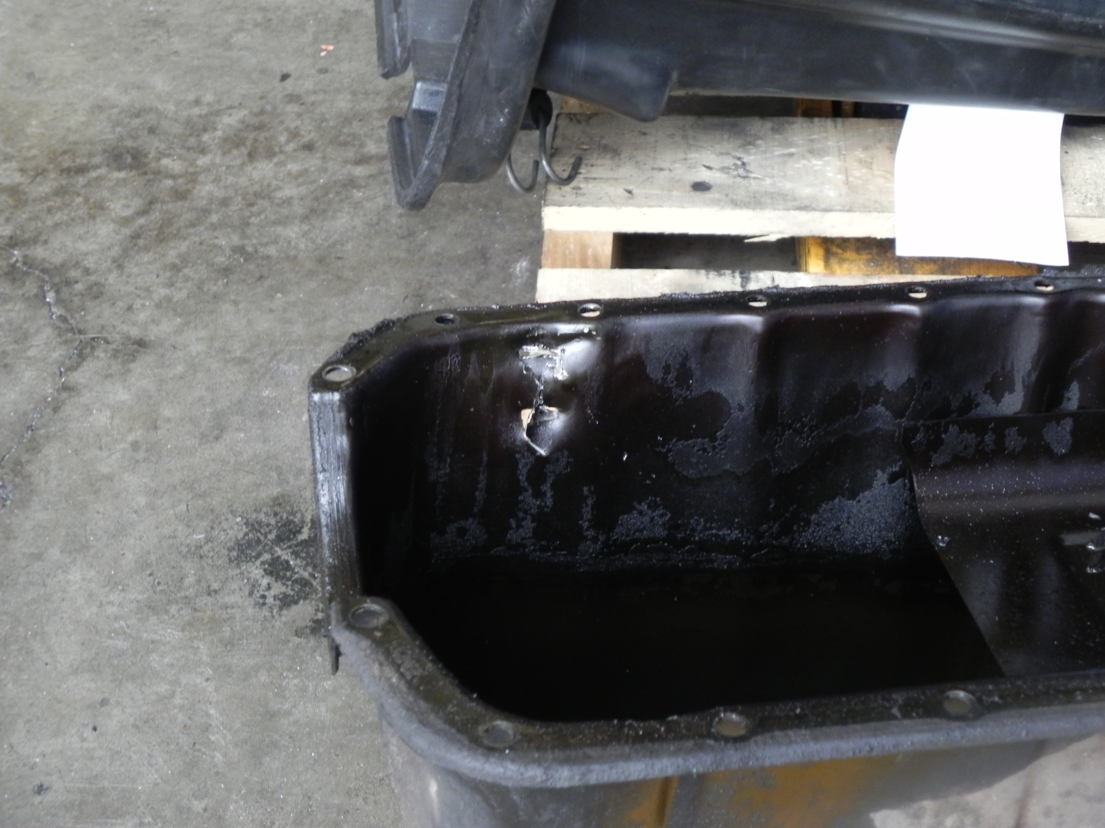

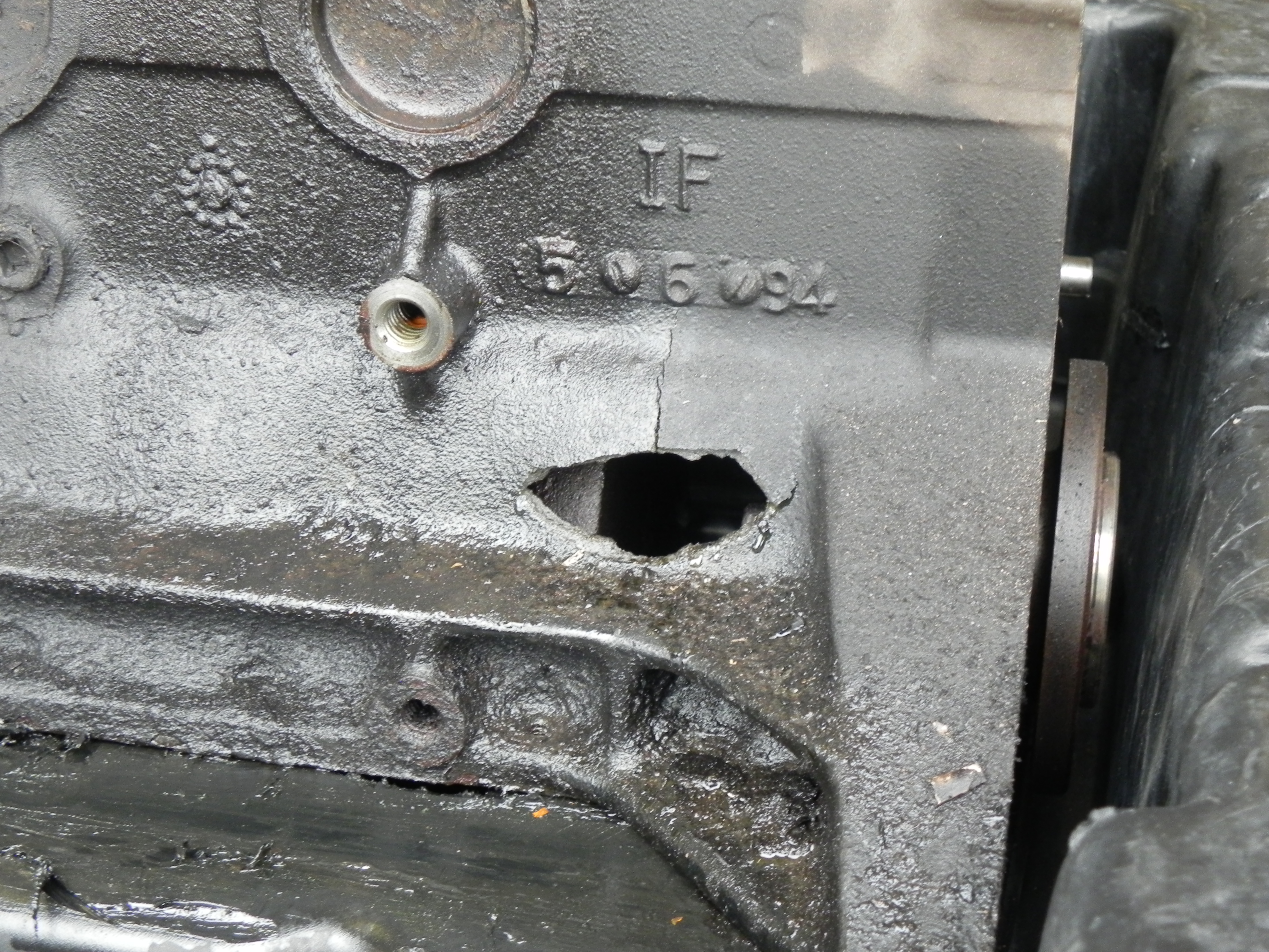

How the hell does that happen, I've never heard of a piston doing that
- Zombierockstar10
- Posts: 235
- Joined: November 14th, 2012, 8:33 pm
Re: FL JP Jeep 18
here is the hole on the engien and oil pan
