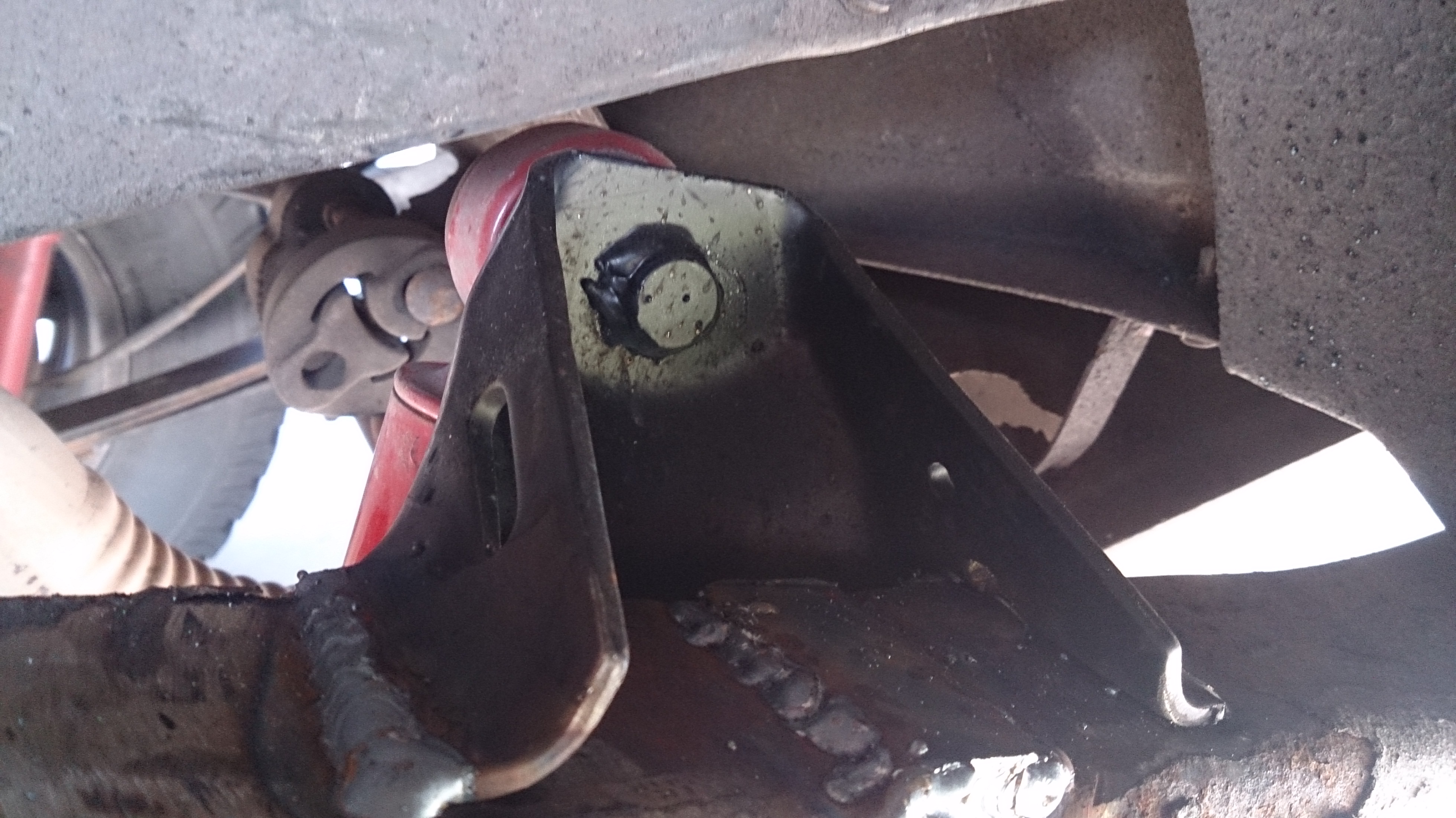

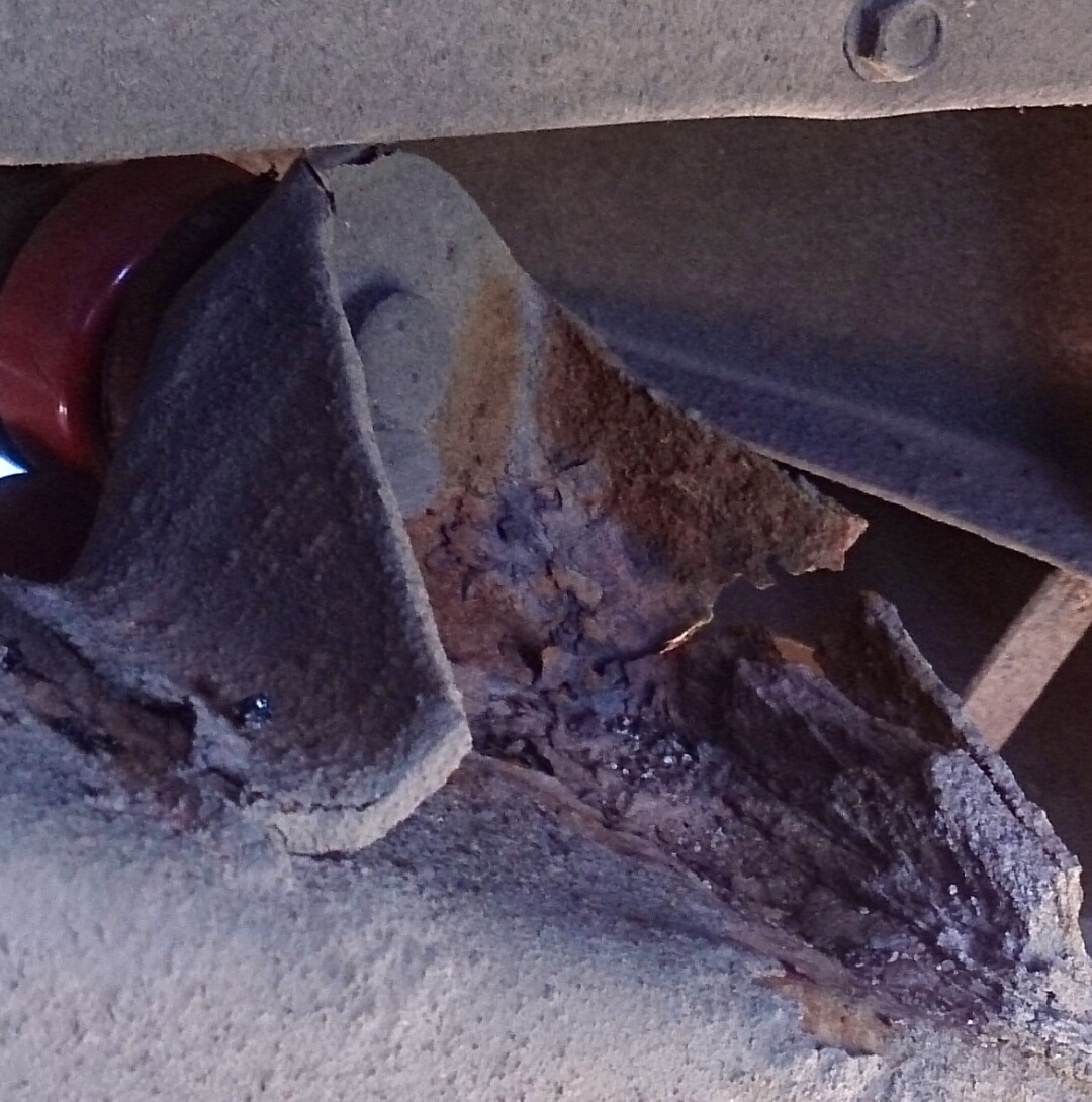

Re: CplTony's Jeep # 18
Check your rear shock mounts.
The design allows for water to sit and rust them.
Was airing up my tires and thought 'DAMN'
$25 replacement mount and got my local welder to cut and and weld this one on.

I had that problem.... So many bad designs on that rear, but glad they are all fixable with ease

FYI if you're replacing your springs make sure you get the right ones (don't believe the compatibility chart)cpltony wrote:Well after feeling every darn bump in the road I took the plunge and ordered new leaf springs, bushings and shackles.
Tired of mouse turds bouncing the Jeep around every time I ride over one.
JCWhitney came through and I found 4 of them on my door step yesterday evening.
Bushings and shackles should be here today so this weekend should be a fun time.
With discount code they ran me about $410 overall which I thought was OK.
No lift though, just a direct replacement for the stock 4 leaf ones I have.
Knowing they're new will make the Jeep drive better
Those who see my Jeep see that it rides high, but it has no lift.
The springs JC Whitney sent me are fully 100% compatible but you don't know until they're on and by then it's too late.
These ripped my shock mounts off the axle as the shocks were fully extended so had to get new ones welded on higher up.
Also wait to order your shackle bushings until you know what size to get for the new shocks.
