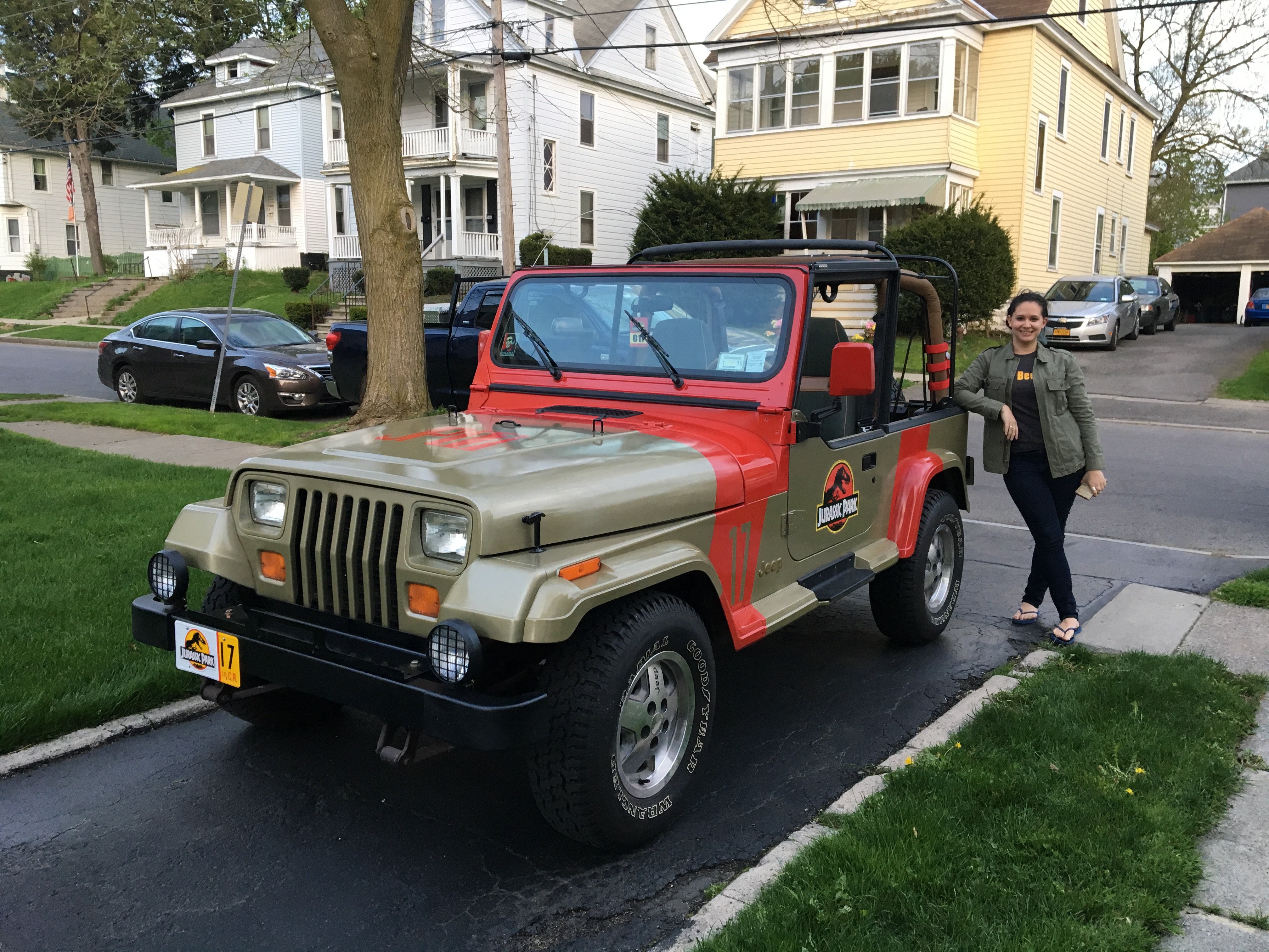

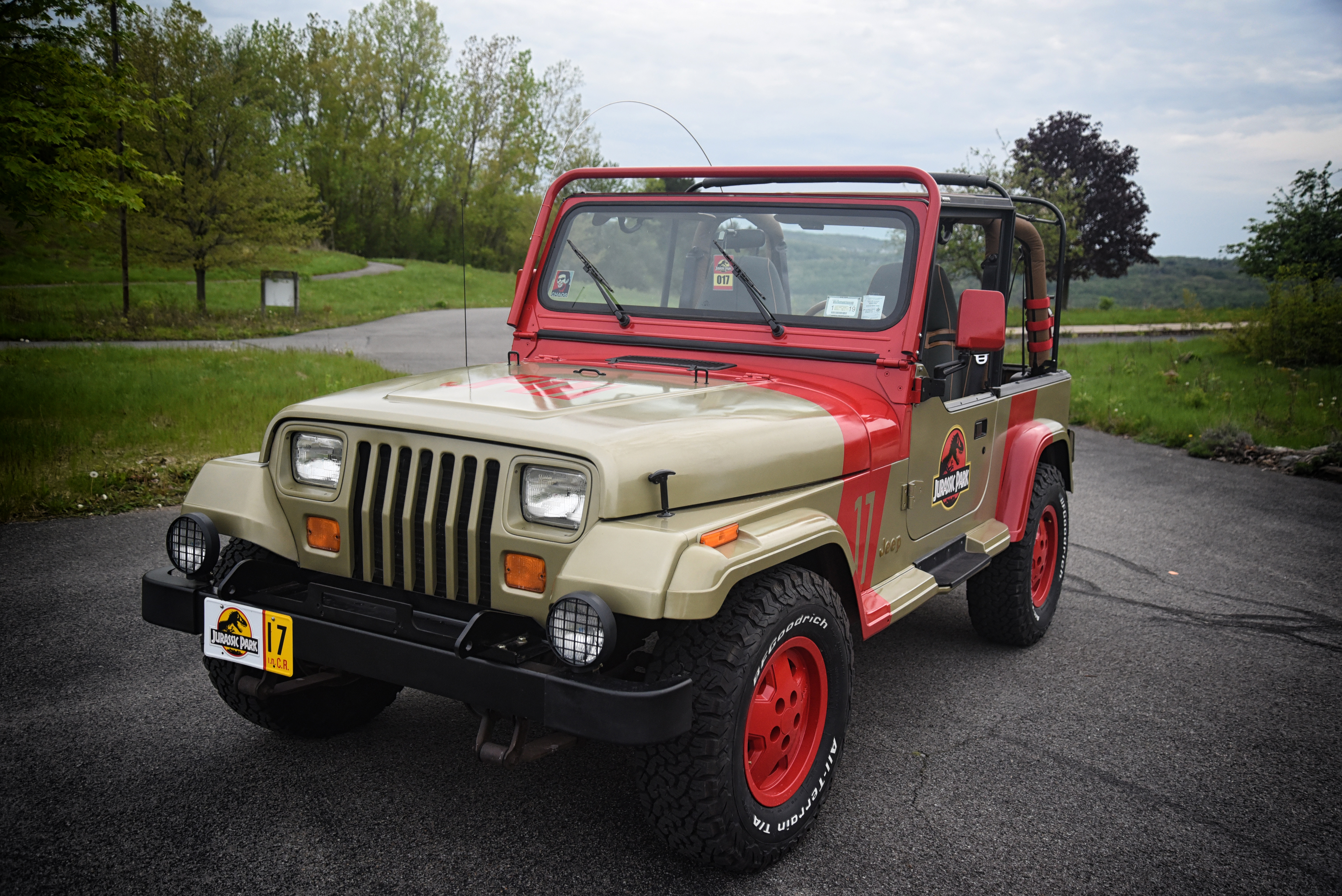

I still have to paint the wheels, but it's on the road!

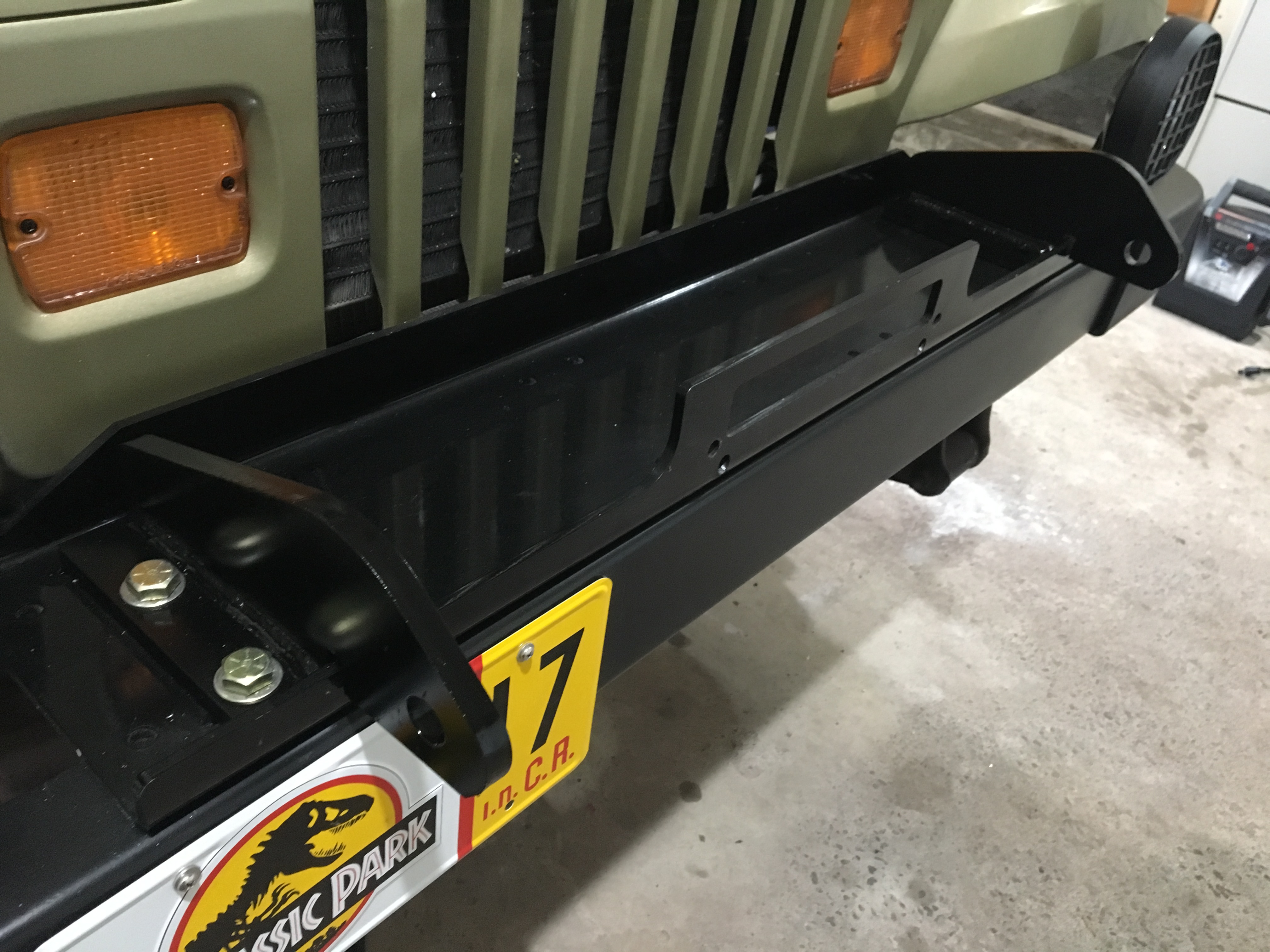

Tow eyes are in, painted and installed. I'm also setting up a group buy in this thread: viewtopic.php?f=32&t=15875

Man that looks great! Good job! Is that a Ramsey winch plate?
- KytorIndustries
- Posts: 99
Re: Kytor Industries JP17
Yep! Ramsey plate. Full specs are on the first post if you're interested.

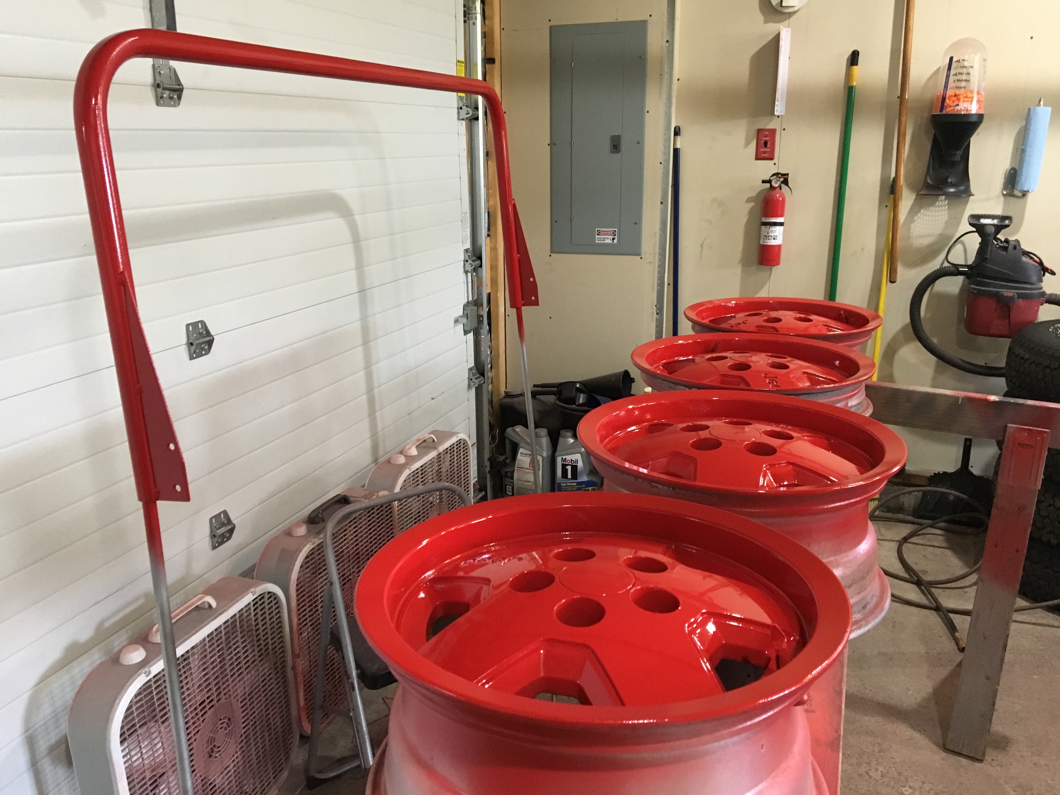

I got the lightbar and wheels painted and clearcoated over the weekend. The lightbar is from Obsession Offroad. I will say, they did a great job. It was slightly too wide, but it compressed down just fine once tightened. I'm actually glad it was too wide versus a tight fit or too thin. I used a rubber gasket between the hinge and lightbar to prevent rainwater from draining into the hinges and replaced the awful factory Torx hardware with stainless steel bolts and washers.
