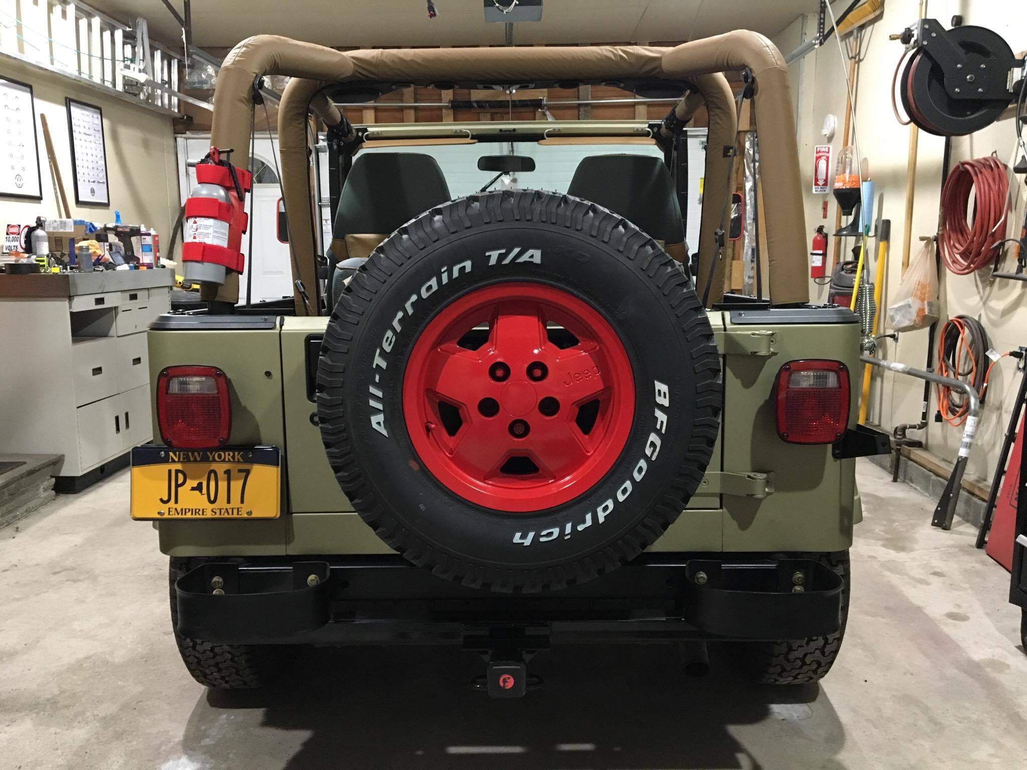

I was so ruthlessly productive and then I disappeared. But I'm back! She's insured, registered, and technically "on the road" with a custom name tag. Those with a sharp eye will notice the movie accurate lightbar in the corner:

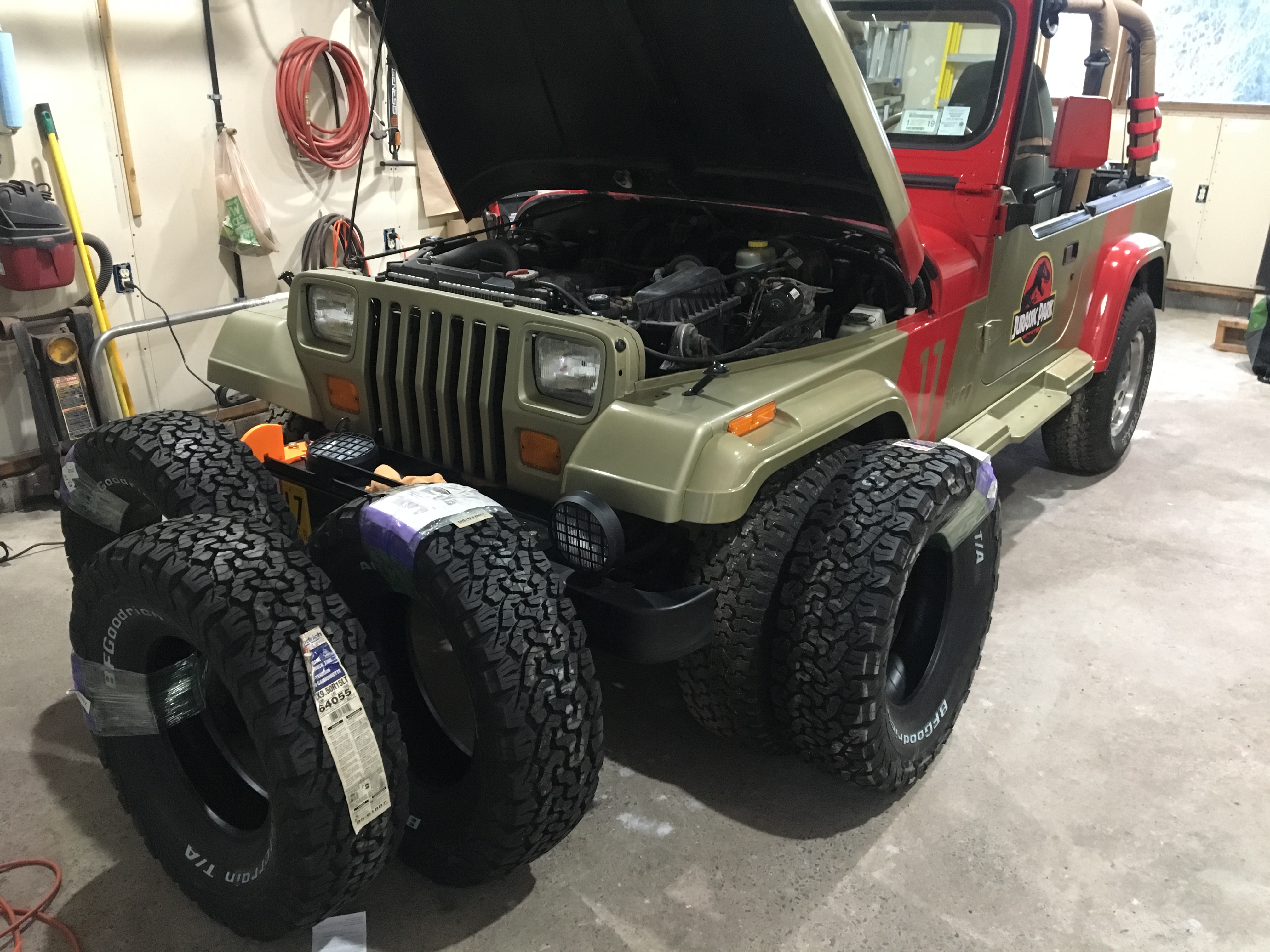

I also have on order a set of BFG All Terrain KO2's, I went with 30x9.5 R15, about the largest you can go without a lift and not get rear flare rub. For comparison sake, that's 1" taller than the common 235/75 and 2" taller than stock YJ.
The spare is already on there, it's also 30/9.5 but a KO1 series.
When the new tires come in I will take the old shoes off, paint the wheels, have new tires mounted, and replace. I'd rather do that than paint wheels with the tires on.

You can take your spare off and mount a wheel there for more space if needed. I'm interested in seeing how the 30x9.5 looks compared to the 235s I just bought. 235s look good but do seem a bit skinny in width.

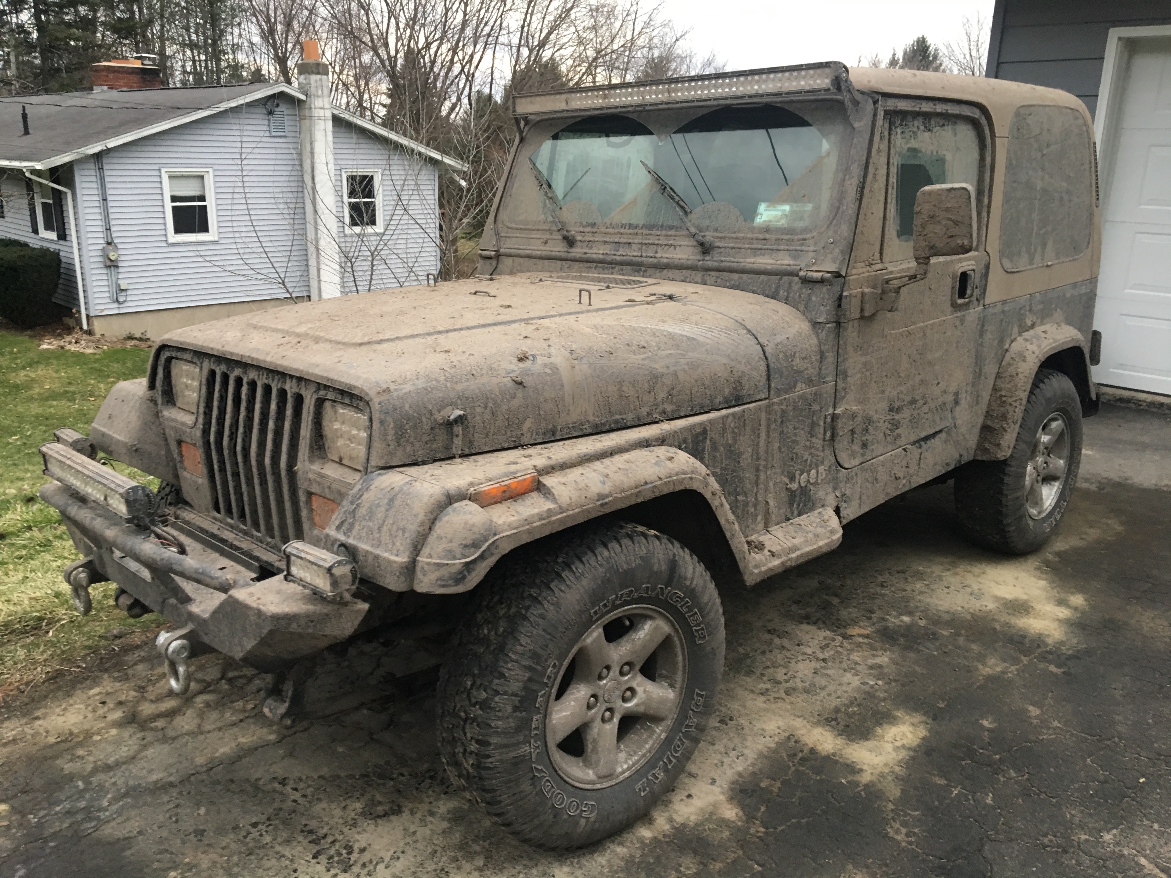

On a more positive note, the shoes arrived. I also took the SJ on some trails and got some dirt on her.
