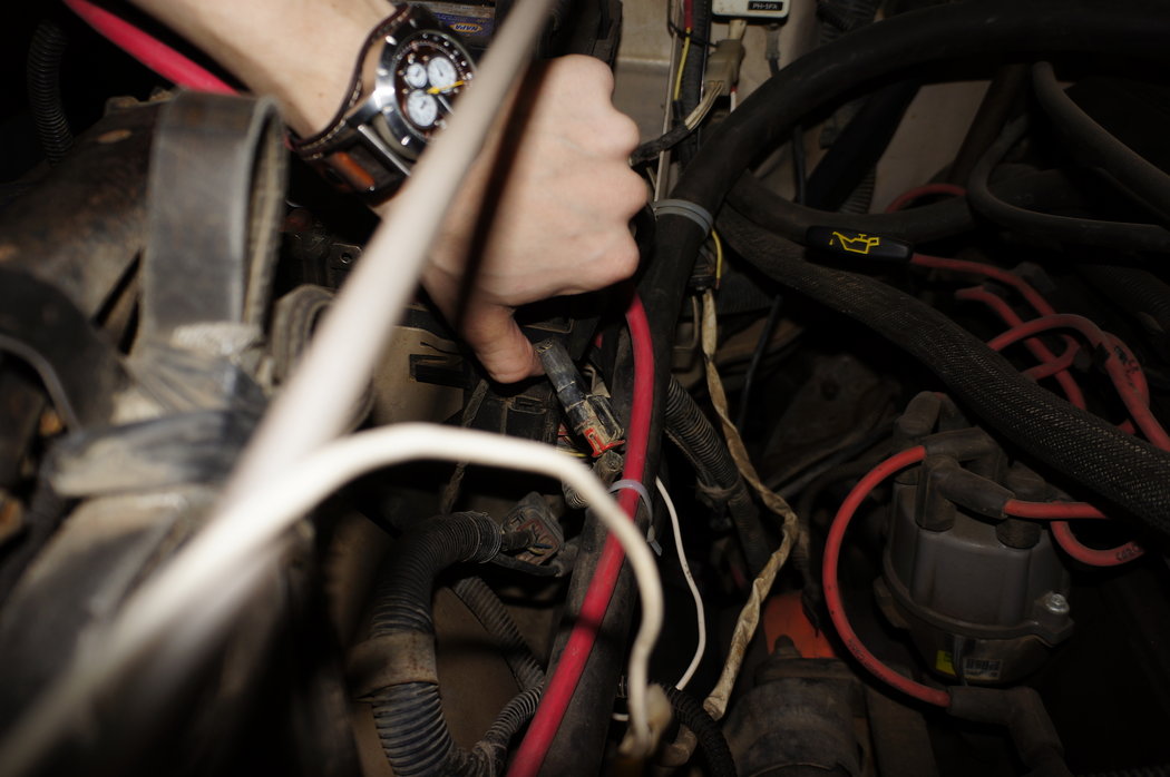

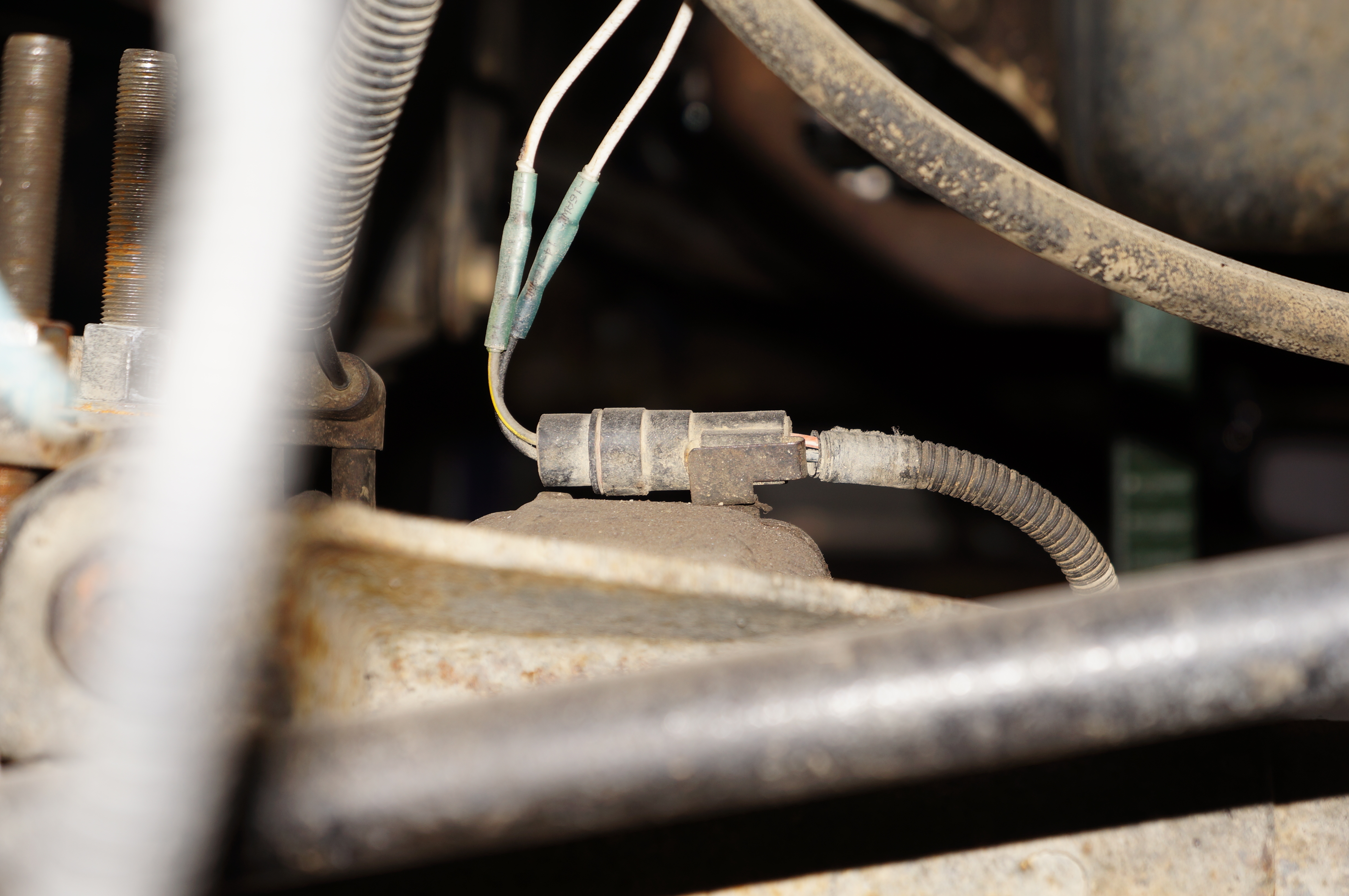

Check the harness leading down to the front axle. That double plug should have a mate around the battery box for the four wheel drive. Looks like someone has disconnected the locker for the front wheel drive. Have you tested the four wheel drive system? That single wire is just the diagnostic pin.

Thanks. Yup, 4 wheel drive does work, however, even in 2 wheel drive my 4x4 indicator light remains on. I wasnt gonna worry about it to much since i know when it is or isnt in 4 wheel. I was looking down around the front axles and wires do come up from there and go into a conduit, but havent gotten around to tearing the plastic tubing off to see where it goes. Ive seen on other forums where they say that the 4x4 light is due to a wire not being connected somewhere. maybe this is why. You say the blue wire is just a diagnositc pin...does that mean it doesnt need to be connected to anything 24/7?

That blue one just hangs out waiting for the day when you need to pull codes. So do nothing with this one. You should not need to take the tubing off to find where the other plug goes. Both the male and female plug for that wire pair hang out of the tubing so that they can be connected. The other half should be somewhere close to the plug you show in the picture. They connect in the batter/distributor area. I wonder if it got damaged at some point and was cut back and then taped up vs. being replaced. You could look for a bundle of black tape. Once you find the other half to that wire pair i bet that four wheel drive light goes out. I know that there are some vacuum lines going to the four wheel drive system up there but i was thinking the electric system allowed it to engage. For example the vacuum does the work but the electric system releases the lock. Are you sure the front tires are doing work? I dont know how the system works for sure because i have not worked on mine. This is how i see it being made so unless you have seen the front tires spinning in mud/snow i would double check. This is a concern though because what if there is something wrong up there? The PO might have just unpluged it vs. taking the drive shaft out. I have see this done many times before. People just take the drive shaft out... "There we go...its fixed!" :evil:

thanks for all the answers. I went down and rooted around today after work and found two wires that are the same same, but things are aready plugged into them. Here are some pics.
This is right ontop of the front axle on the left side (if looking at jeep from the front) The wiring that is currently plugged into seems to have been spliced since the tpe and color of wires dont match what they are plugged into. I think the PO spliced them due to the lift. The wires then run into the plastic wire covering so im not sure where they lead to. This is option one because I pulled the mystery wire down to the axle and without the lift it would reach.
Far away pic of possible location 2.
and here is a closer pic. This is right next to the battery. Again the one end seems to have been spliced because the wire colors dont match and the tape is different.
Here is the problem with both connections, the spliced ends are the male ends. The mystery cable is a female end...I dont see any "stock" male ends anywhere. Thoughts...Could anyone take some pictures too? that would help a great deal if i can see where its connecting wire goes.
This is another pic of the mystery wire. As you can see it has a T intersection in the plastic tubing. The top part goes to the engine and the lower part loops around and goes over to the drivers side to the computer.

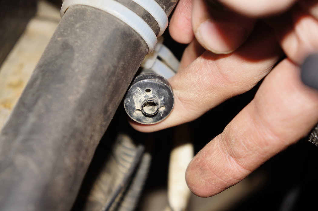

Now this is something new that I found today poking around.
and here is a closer pic...it almost looks like a hose sensor or something. Any thoughts? its up to the right of the battery and it comes out of a the plastic tubin the come from down around the transmission.

I had that little plastic hose thing by my battery snap off, not sure what it is, but my Jeep works fine without it. LOL

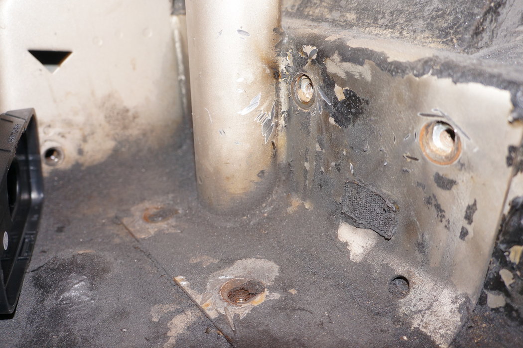

I had had it with the roll bar, it was coming off one way or another. The first step was I ended up making the round TORX bolts into a sort of HEX bolt shape
Then went out and got these awesome sockets from craftsman. They are meant to extract messed up hex bolts, outter TORX bolts, and etc.
(My new toy from lowes, its not craftsman but it will do the job, but back to the build) used a bit of the air tools to help get the bolts out
VUALA, they came out.

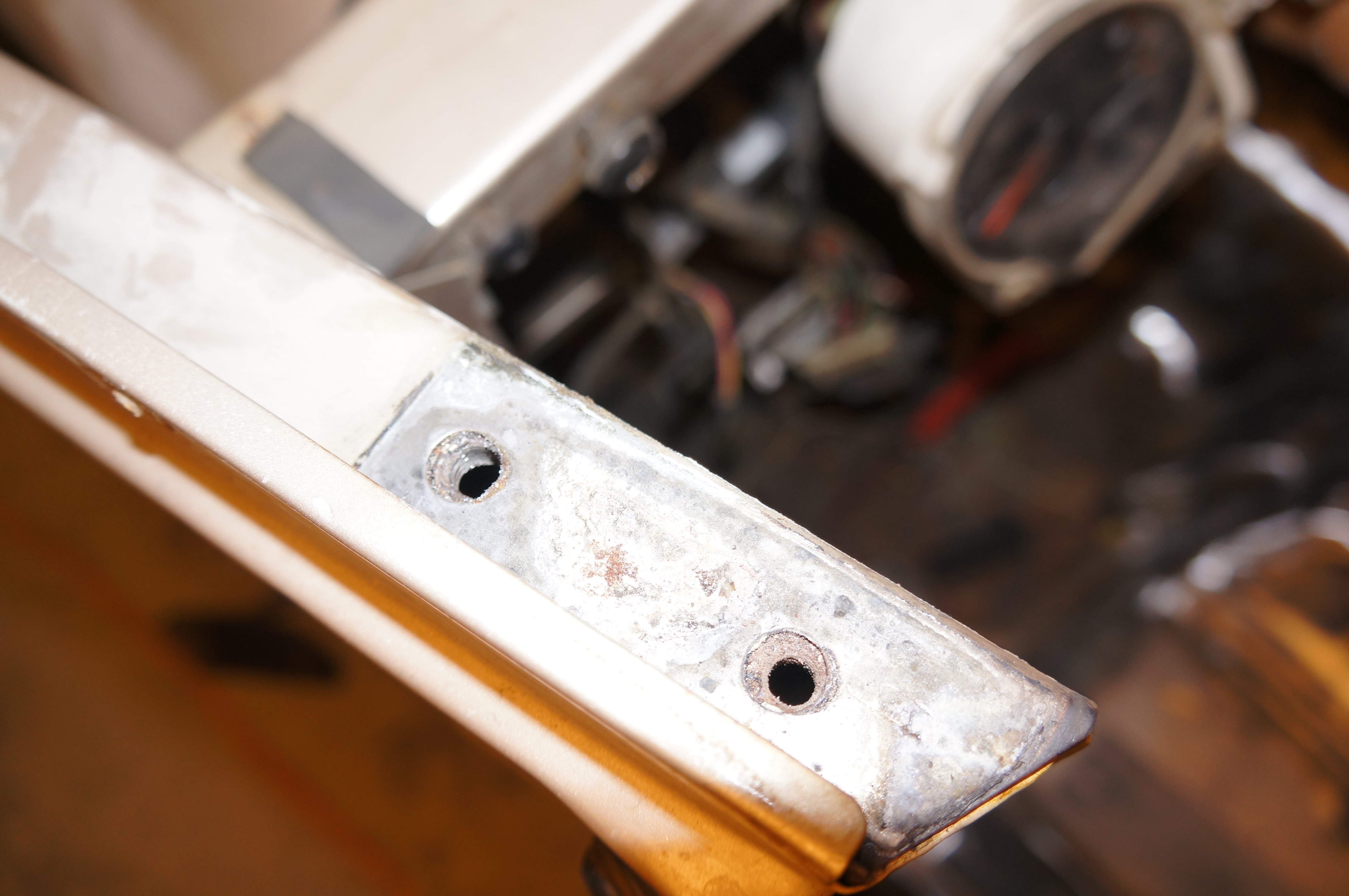

Finally...after weeks of shear blood seat and tears, the roll bar has finally come off the jeep. The next task was to get the stripped screws out of the window frame.
Getting the screws out was a very gut wrenching experience since I knew if i messed up even slightly I would have to get a whol new frame sine you can only get to the screws from one side
But yet again, I was victorious!!!

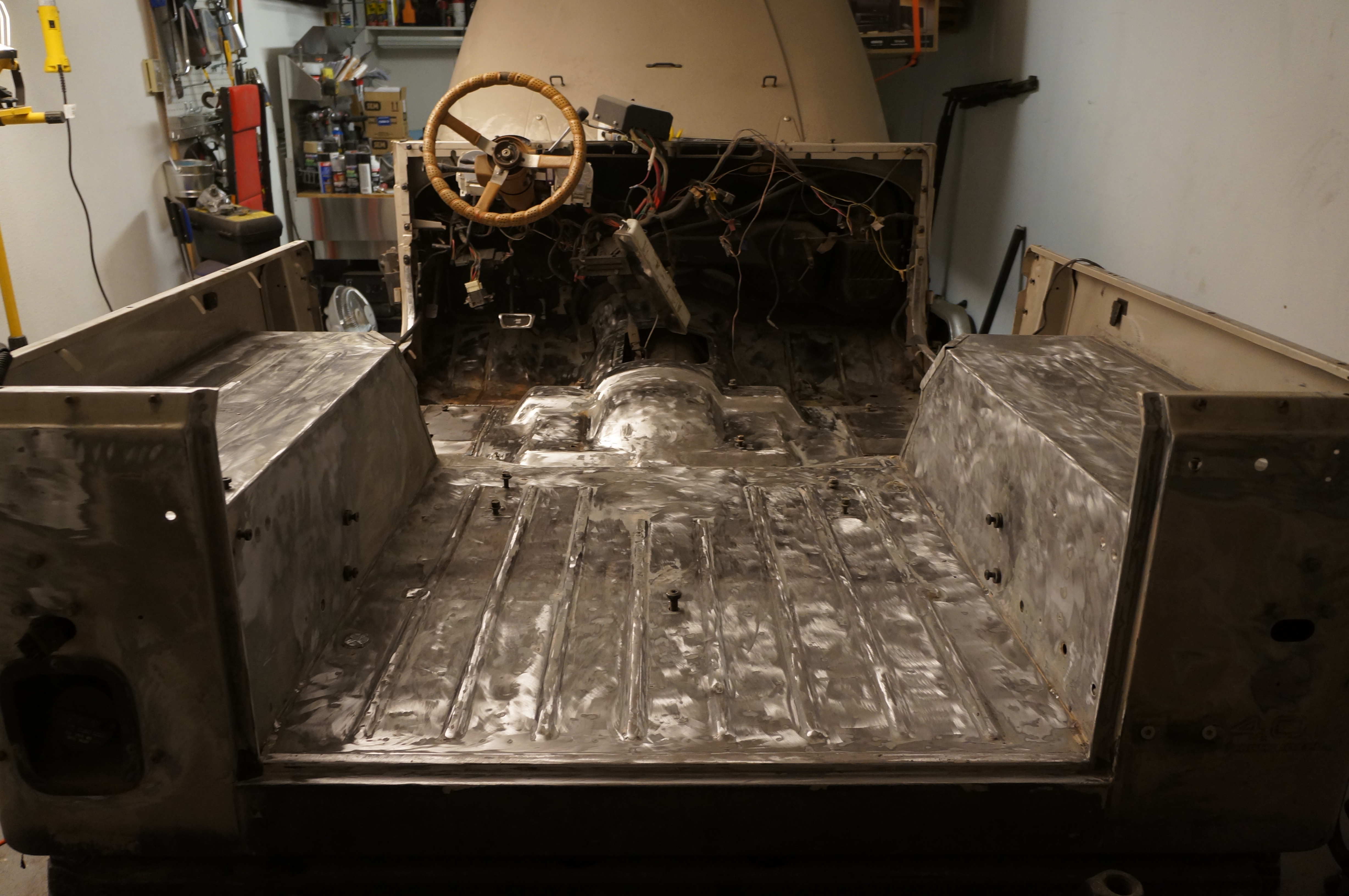

That about did it for day 6 with the jeep, I just finished up the night with sanding and stripping of the jeep floor again

When I got home I completely dedicated the night to finishing up the sanding of the tub interior.
