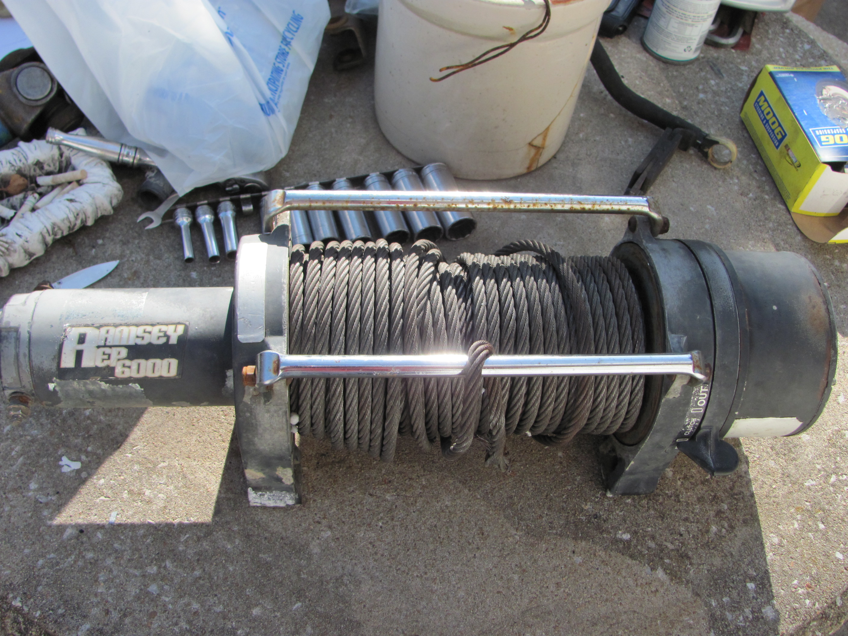

I worked on it for hours today. I had to layout the position of the plate and drill 1/2" holes for the mounting bolts. Its strange that the bolt holes were not already drilled. The instructions say that it is for our model of wrangler so IDK why there was no holes. It is very straight and i am happy with how it turned out. The winch also came by UPS today. It was packaged very well and i hooked it up to try it out. There is a in and out button on the remote but it only clicks when i press the out button. To the best of my knowledge the 6000 does not need a out button because of the clutch. When you want it out you have to pull it out right? There is no reverse on the motor?

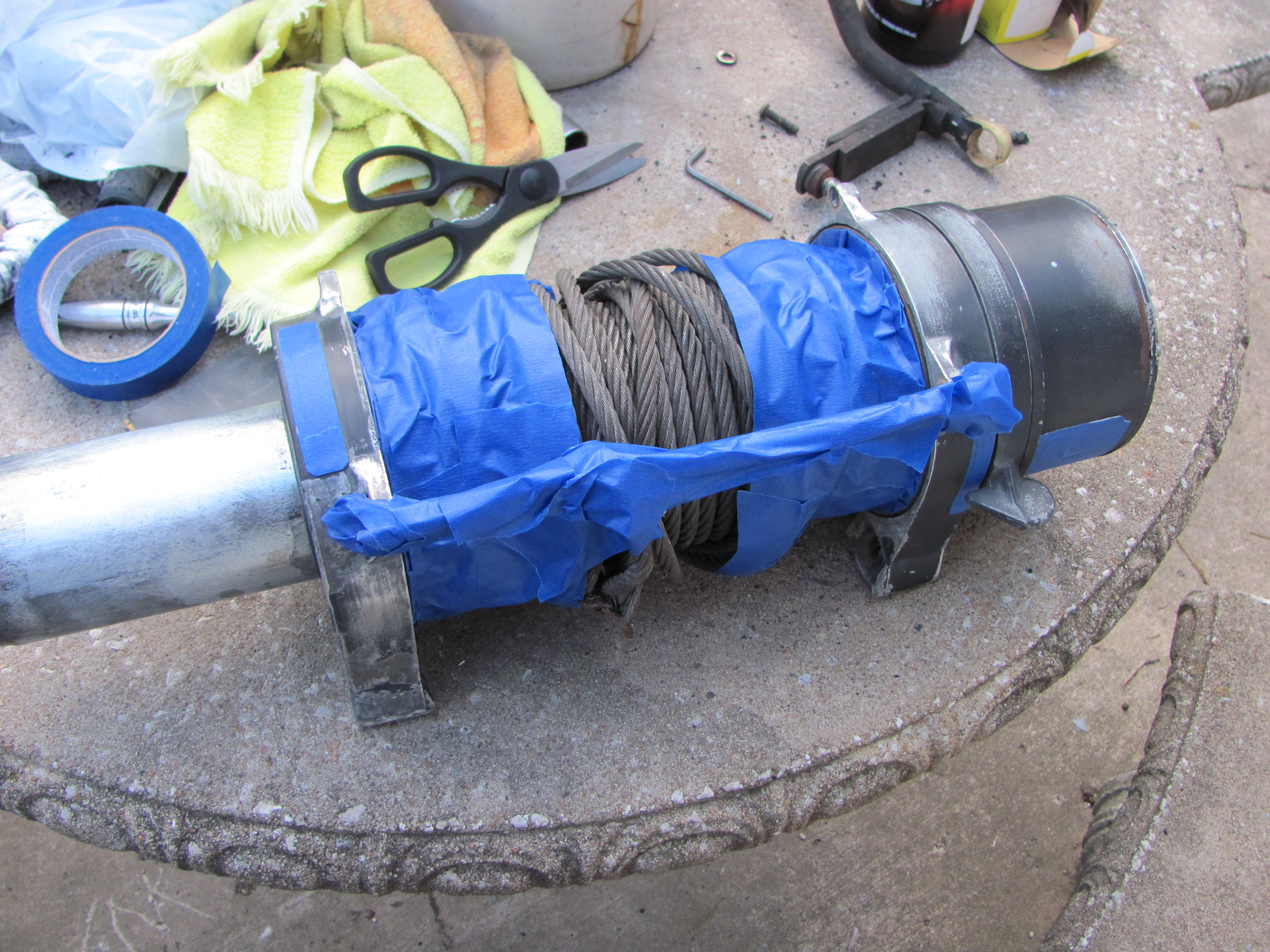

Tomorrow the plan is to sand, paint and mount the winch. And also pictures

Yes, there is a reverse. There should be a pretty clearly marked lever on the side for forward and reverse.

Let me rephrase...Is it a power reverse? The remote has a reverse(out) button but that doesnt do anything no matter the position of the clutch lever.

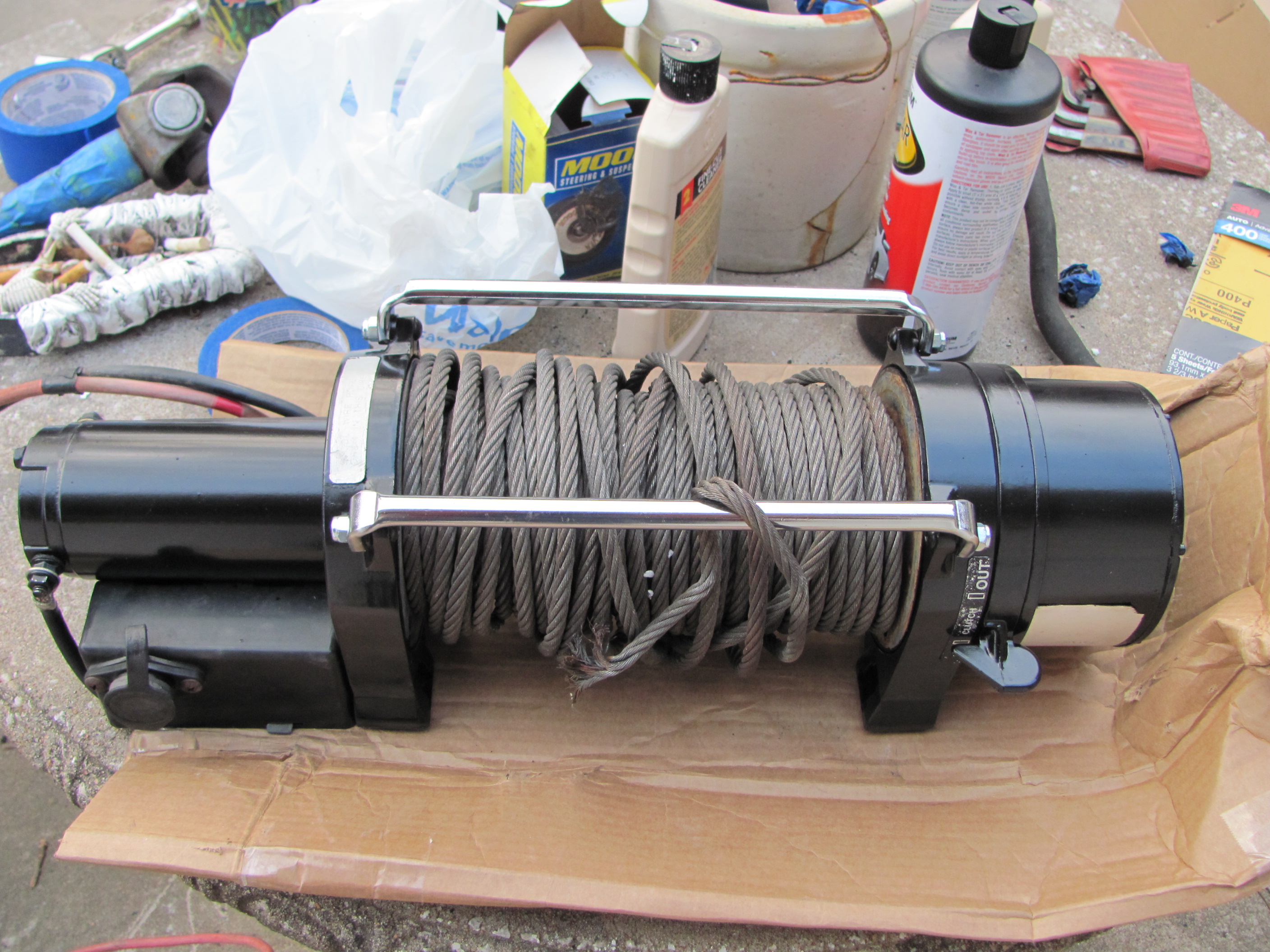

I almost got done when the rain came in. The weather was almost 60 degrees today so i cant complain, but I wish i would have finished. I am down to putting three more bolts in the winch to hold it to the plate and run the power wires. I also need to make a ramsey sticker for the motor and get a new hook correctly attached to the cable.
