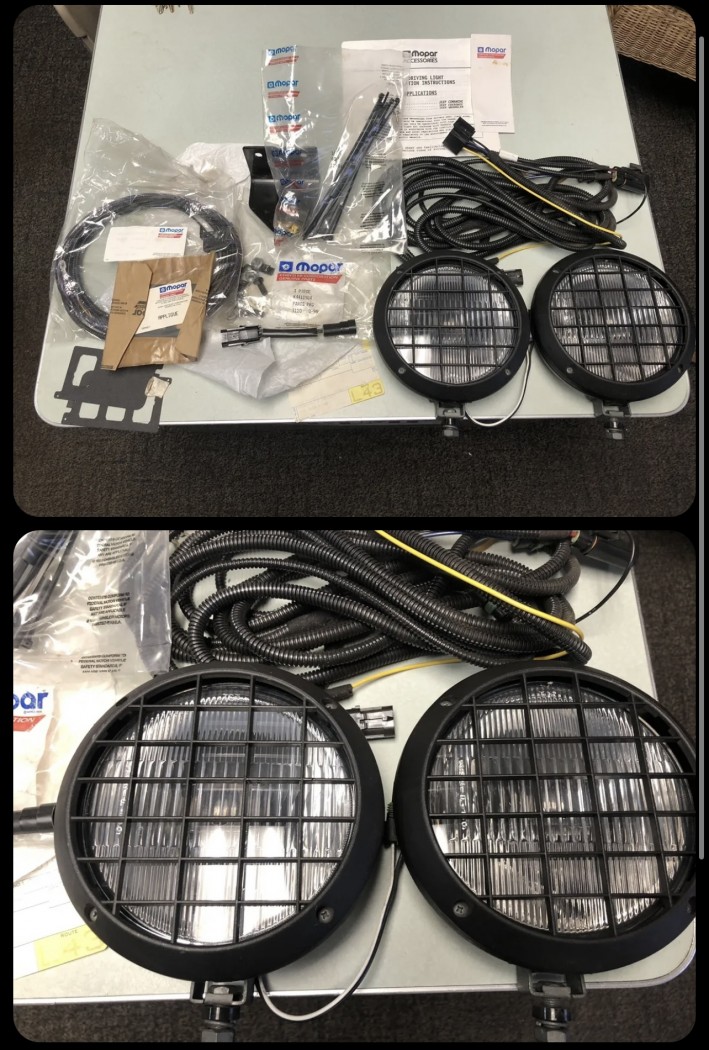

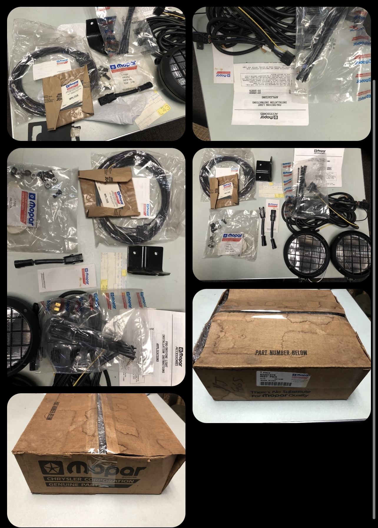

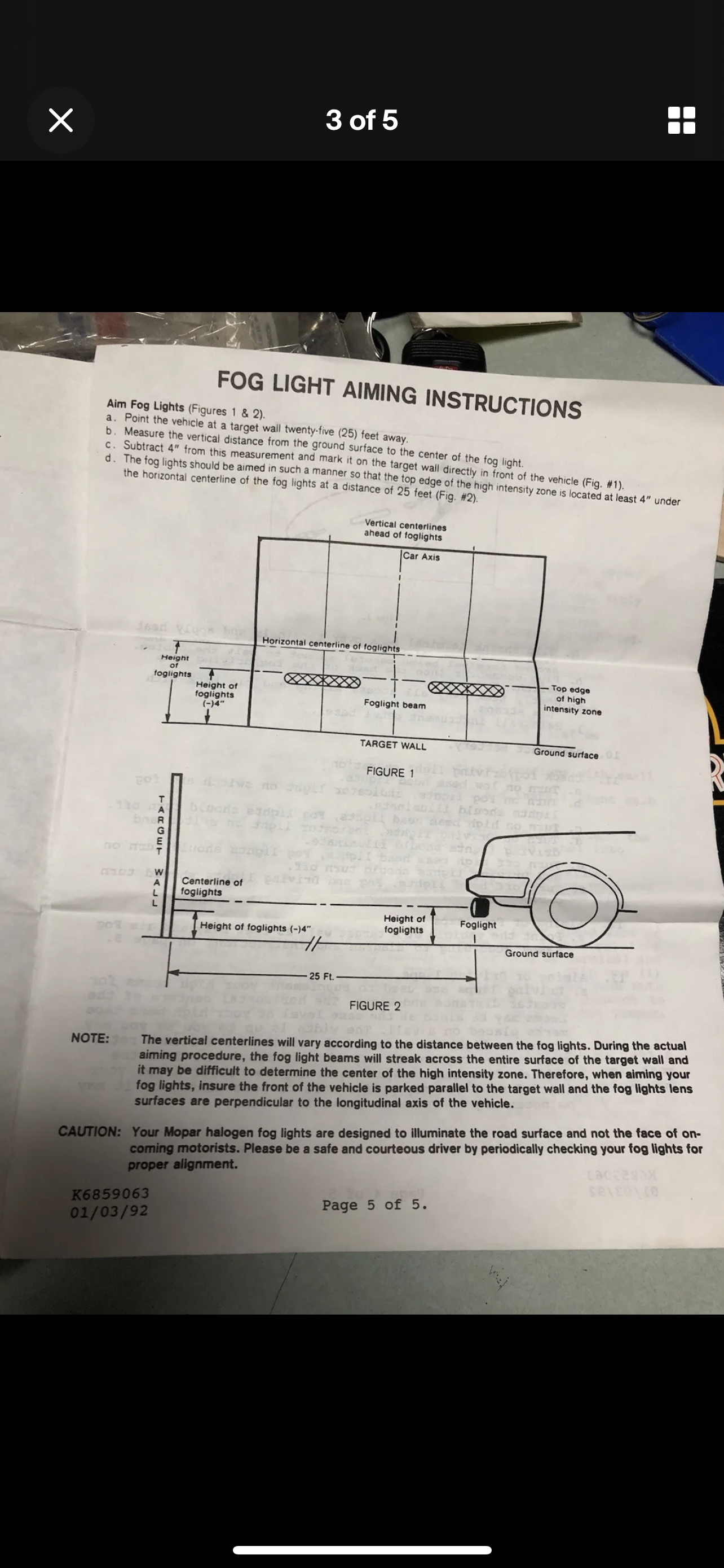

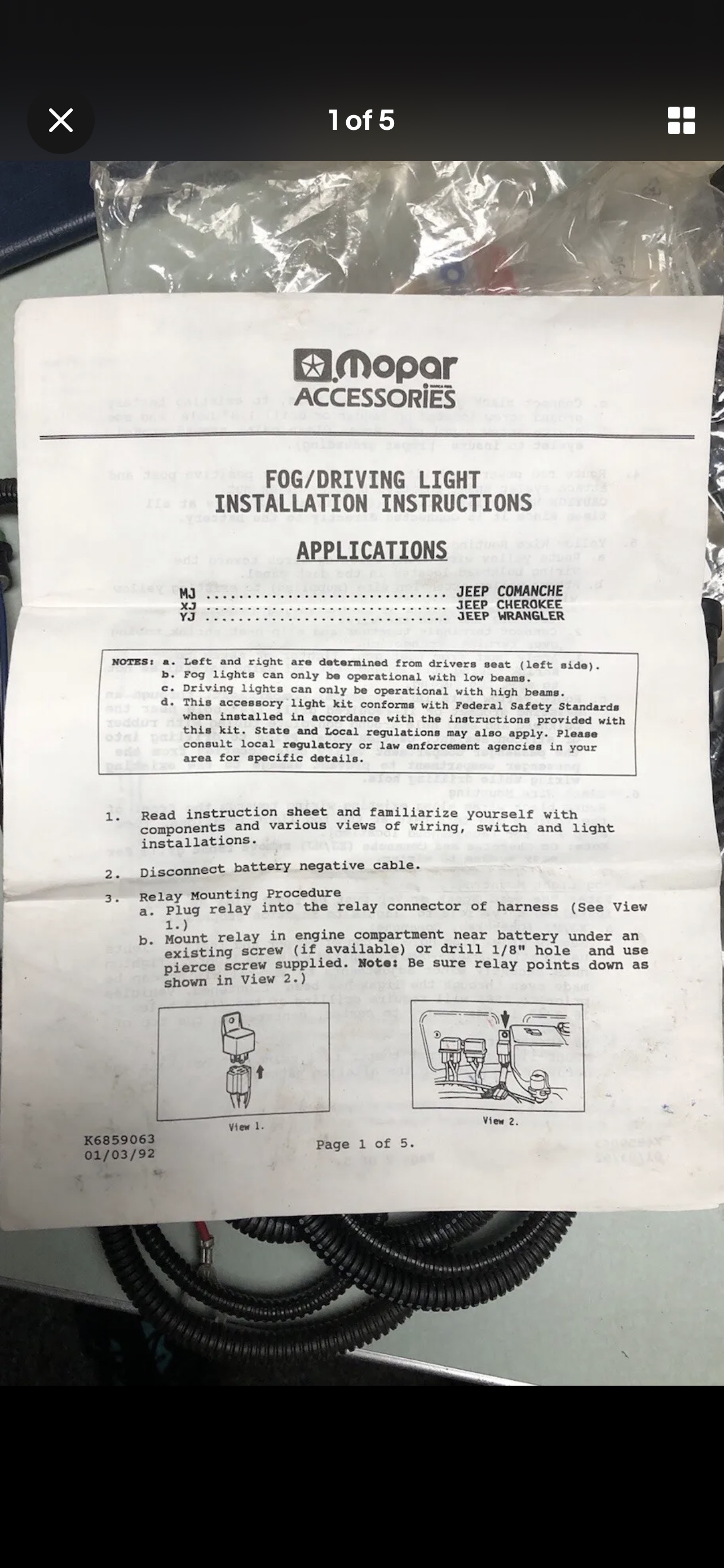

Small update.
I ended up buying the fog light kit on eBay. Ari and I are going to archive it for historical use.

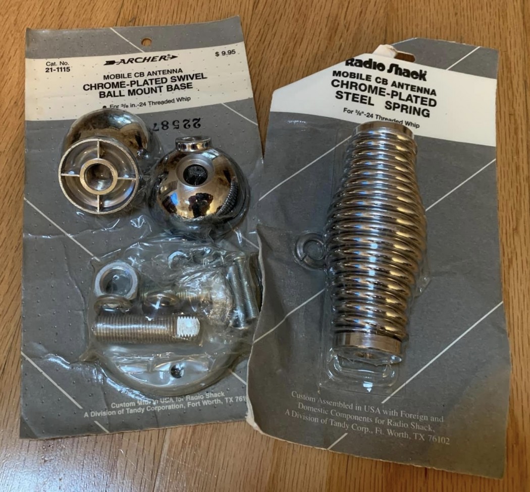

Small update:
Found the screen accurate RadioShack spring with another cb radio ball.
