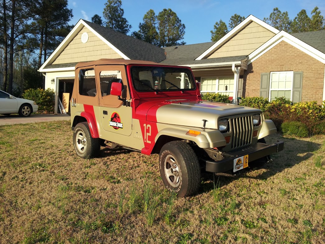

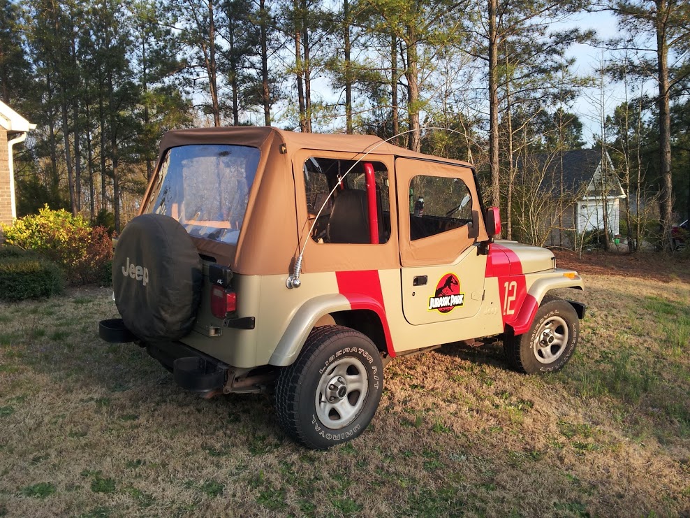

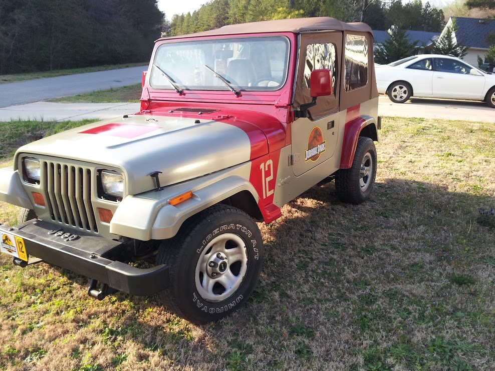

Hey guys, here are some updated photos that I made yesterday. I've been working feverishly to get this thing presentable by Friday. I'm going to pick up my BFG's today, so I'll post some pictures with those tomorrow, probably. I also plan on doing the hood reverse stencil tonight as well as a few "touch up" areas and the shroud that goes around the front head-lights.
Also, I played around with the door uppers and still couldn't get it to fit properly. Maybe there was an issue with those frames/my doors. I trimmed between 1/4 to 1/2" off of the front peg to get the upper to fit in the frame. Anyway, here's where I'm at currently:

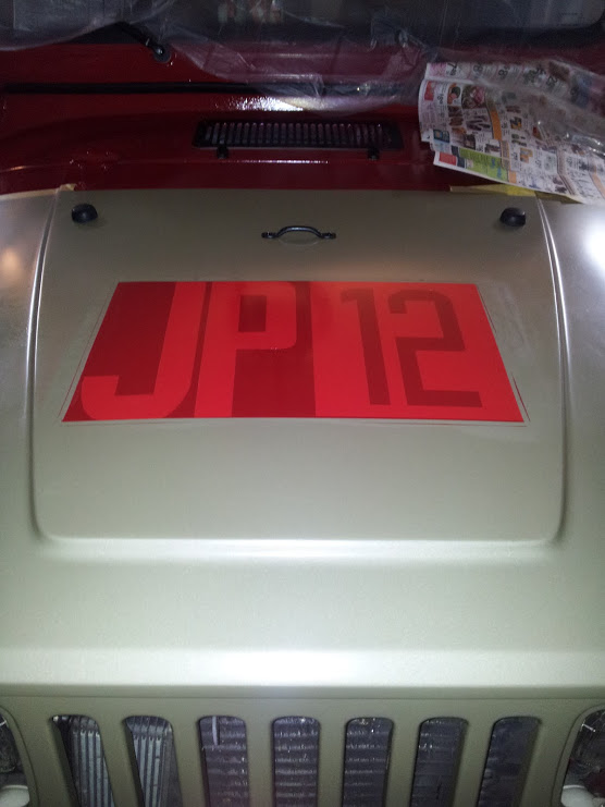

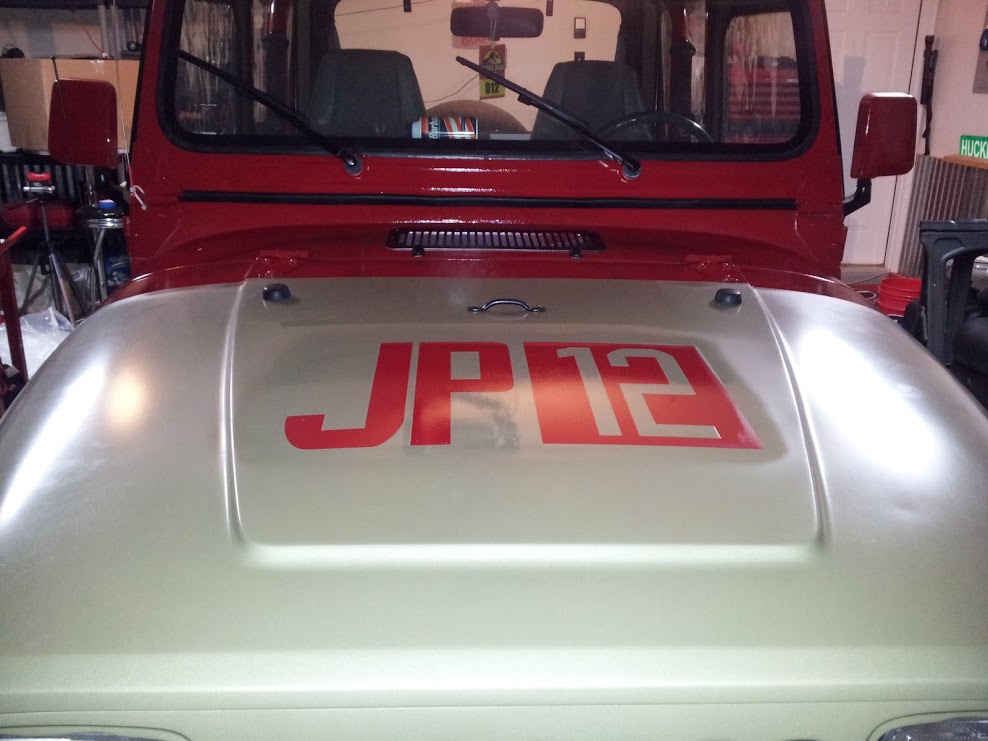

I'm finished with the hood and paint touch ups. The base color from TCP global did really well for the price. For a hundred dollars a gallon you get a good product IMO. Looking back, I would have researched a flattener for the red, but I was running out of time and really wanted it ready for the premier and I don't hate the gloss look, but I'm trying to shoot for as canon as possible. Once I got to the painting stage, I sprayed the entire base coat from end to end. Next, I came back and painted everything that needed to be red. Since I already had the vinyl graphics made for reverse stenciling, I sprayed the red box on the hood for that. I knew that I would have some touching up to do anyway, so I didn't mind having to spray paint for a third time to create the hood logo. Here is a picture with the R-Stencil on:
I had a few small spots where red had blown through onto the base color, so I opted to use an airbrush (http://www.harborfreight.com/airbrush-kit-47791.html) for those spots and liked the results and control so I used it to paint the hood too.
