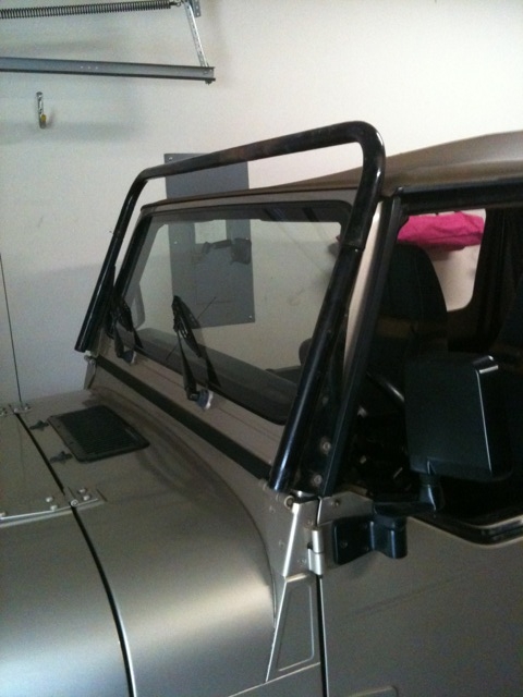

Post by Railtech » December 8th, 2010, 3:14 pm
Test fit the lightbar, its got a good bit of surface rust/paint bubbling. But should clean up well. I think it is the same as Dan's and Cyrix' I am going to pull the thru bolts and see if I can get it apart. If so I am going to shorten it maybe 1-1.5 and weld it back to make it more movielike.
