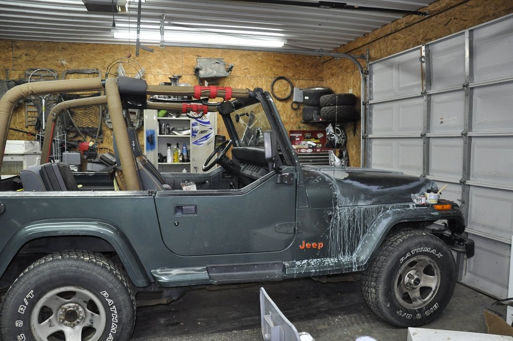

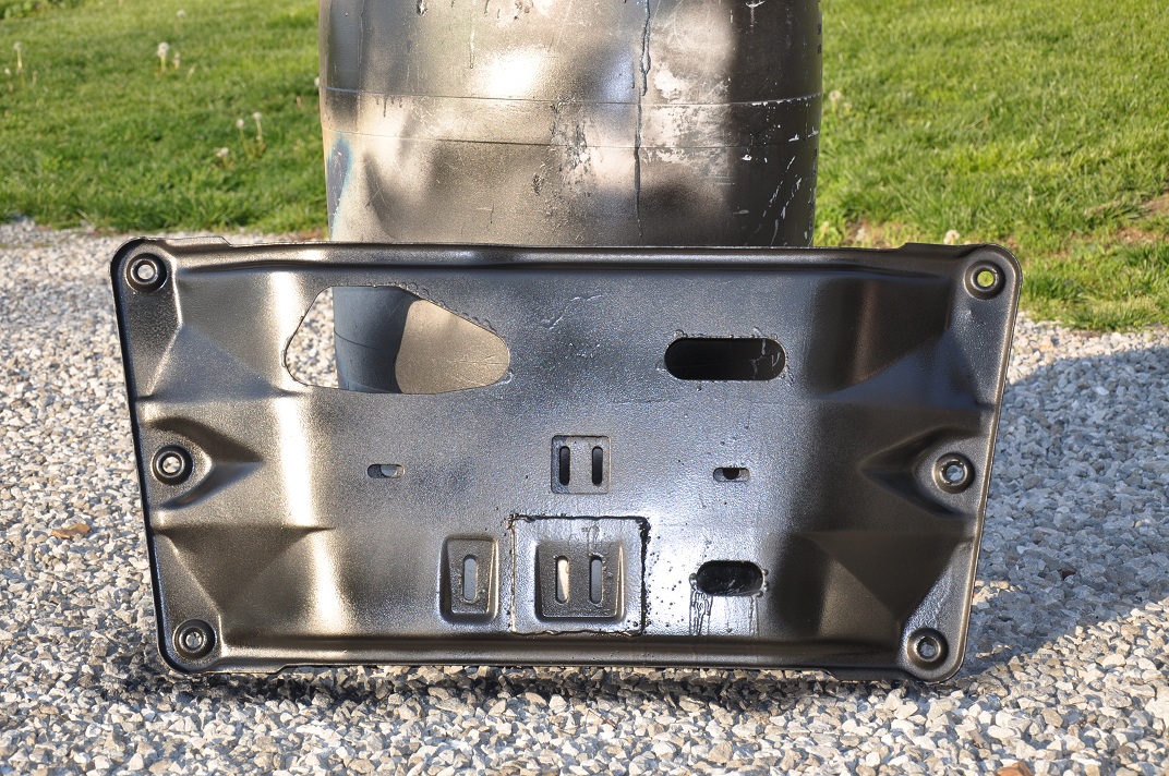

Finally some warm weather!!! I work for toyota, so the recent earthquake and what not is causing me some "extra" vacation days. Hopefully I'll be able to put some man hours into my Jeep. Ive made some progress, but since im trying to fix/restore a few things before the major transformation happens my progress wont excite most of you. oh well, here it is anyway. I hope to post more in the next few weeks as I make more progress
after POR-15 and some chassis paint my skid plate is looking much better. Pay no attention to the runs, i didnt think the skid plate needed to be perfect ;)

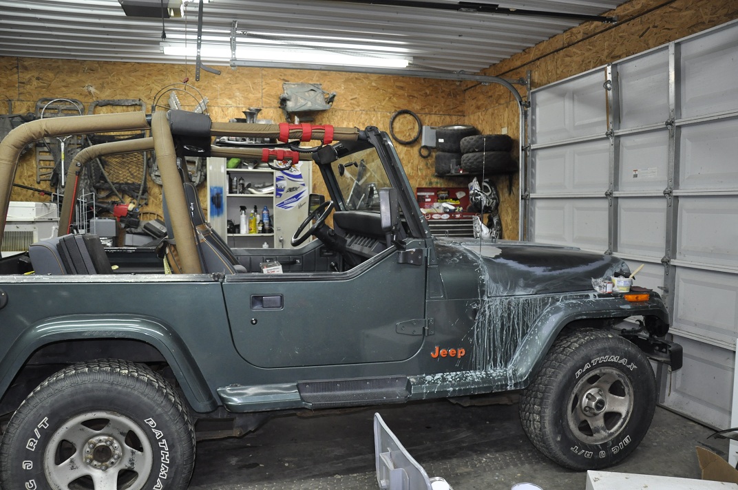

about an hour sanding but finally made it to the factory paint in the spot im working on :lol:

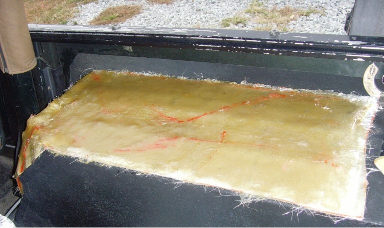

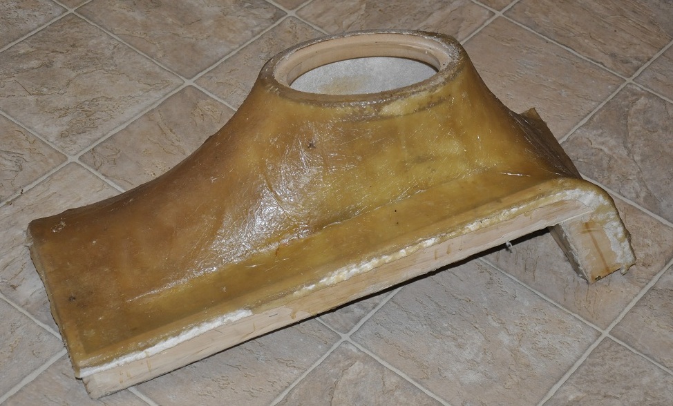

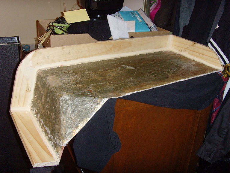

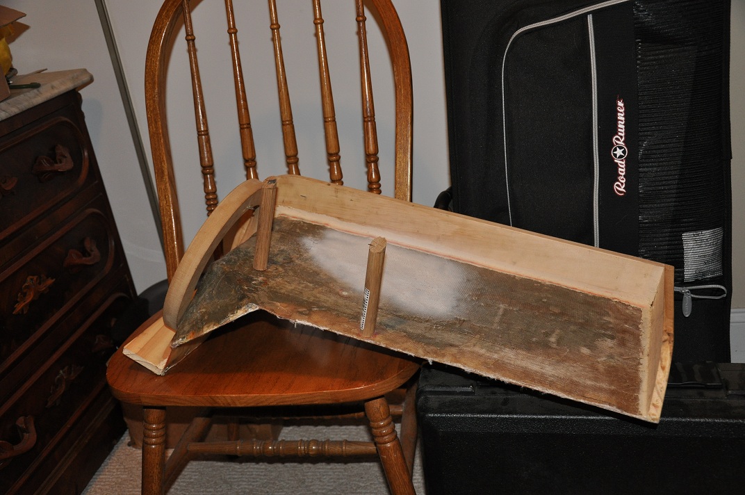

Been working on the jeep but nothing worth posting. I have however started on a speaker box for the rear of the jeep. Ive never done anything with fiberglass so figured it was time. I made the base by molding the fiberglass directly over the tub on some aluminum foil. I made the walls out of wood. I cleaned up the edges and placed two wooden posts where the speaker ring will be mounted. So far I have 3 layers of fiberglass making my shape. I hope to add more and then cleaning it up smooth. I have several ideas on how to finish it but wanted some input from you guys before I decide. My ideas are
1) herculiner it since my tub is done in that manner.
2) paint tan to resimble the tool boxes on Jeep#10 (even though im doing 12, mine wont be a complete replica anyway so no harm done).
3) use the primary and secondaey base colors of the JP Jeep in some way and maybe place a blue ingen logo on it.
Im open to other suggestions as well, let me know what you guys think.

No carpet. I think i will herculine it, maybe put an ingen logo on it. It should be done soon. I had planned on being well into the painting by now, but the Japan situation has affected my pay checks. Might have to sell a couple toys so I dont use the whole summer working on my summer vehicle. lol

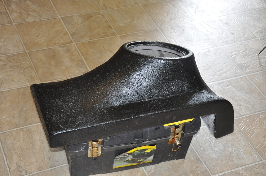

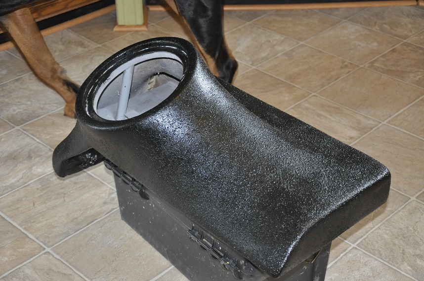

Finished with 2 layers of herculiner and 1 layer of their UV topcoat.
