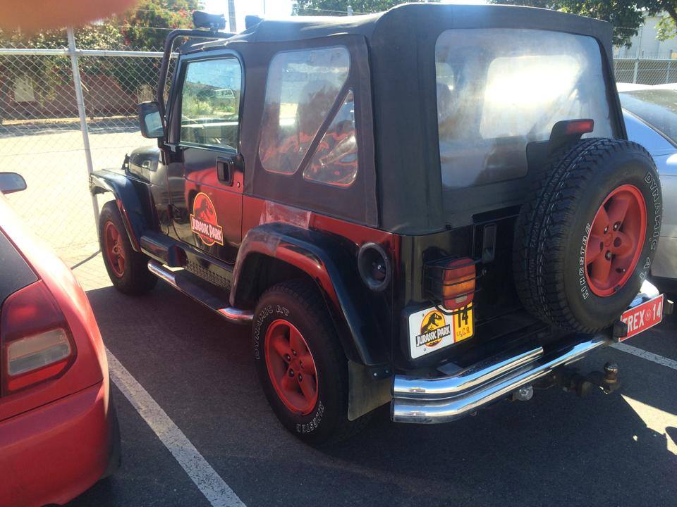

someone linked me to a facebook page called "exotic car spotters of Adelaide" and between the ferraris and maseratis was this:
today i tested gloss coat vs matte coat. i know which one i like better but unfortuantely its not the cost effective one...
other than the paint i have everything i need to finsh the jeep sitting in my amazon cart/ebay watch list and its killing me to not be able hit a button and have it all on its way. only a few more payslips and i can afford it.
