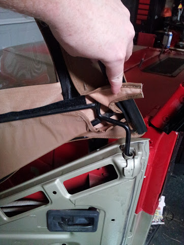

Hey Guy's, in need of some help. I'm nearing the end of installing my soft top and I've gotten my door skins on, however, when I put the frame into the door (with or without the inserts) the front leg keeps the skin from touching door. I was just about to get out the grinder and shorten the leg, but wanted to make sure it wasn't supposed to be that tall.

Post by ImperialTrooper » March 31st, 2013, 1:57 am
Do you have a picture? Could is simply be because the skin needs to stretch a bit more?

I could take another if this one isn't clear, but it's like the corner is still a good ways away.

Post by ImperialTrooper » March 31st, 2013, 11:36 am
I know I sometimes have difficulty in the front peg to get it all in, but after some wiggling it usually fits. If I can find my ruler, I can take a measurement, but I really don't think you should have to cut anything.

Post by heartyfield » March 31st, 2013, 11:44 am
I'll give it another shot. I'll measure what I've got on this one. I got a good deal on the frames off ebay and wasn't sure of the brand.

Post by ratrace427 » March 31st, 2013, 11:21 pm
The factory door frames are four inches long on the two rear and six inches long on that front one.
