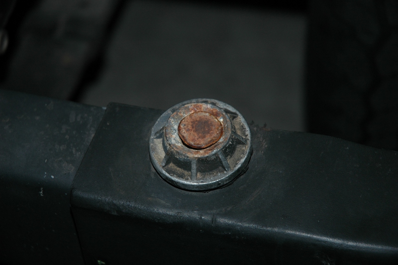

Well that was fun.... Just spent an hour taking off the completely rusted aftermarket fog light mounts off my front bumper....(at least thats what I think they were.)
Thats what they looked like... The Center is a carraige bolt basically, then that round thing has a bushing between it and the bumper, then under the bumper was another bushing about twice as thick as the top one, then a bushing holder/washer thing, then of course the lock washer and nut.
I had to cut out the rubber bushing below the bumper to have enough room to get the cutter into the bolt. Removing the bushing, I just used a chisel to hammer through it, and then pried it out, in order to get to the bolt. Then I used an air rotary cut off tool I had to cut the bolts off in order to remove them. Air Rotatry Tools Rock! But I need a bigger compressor.
