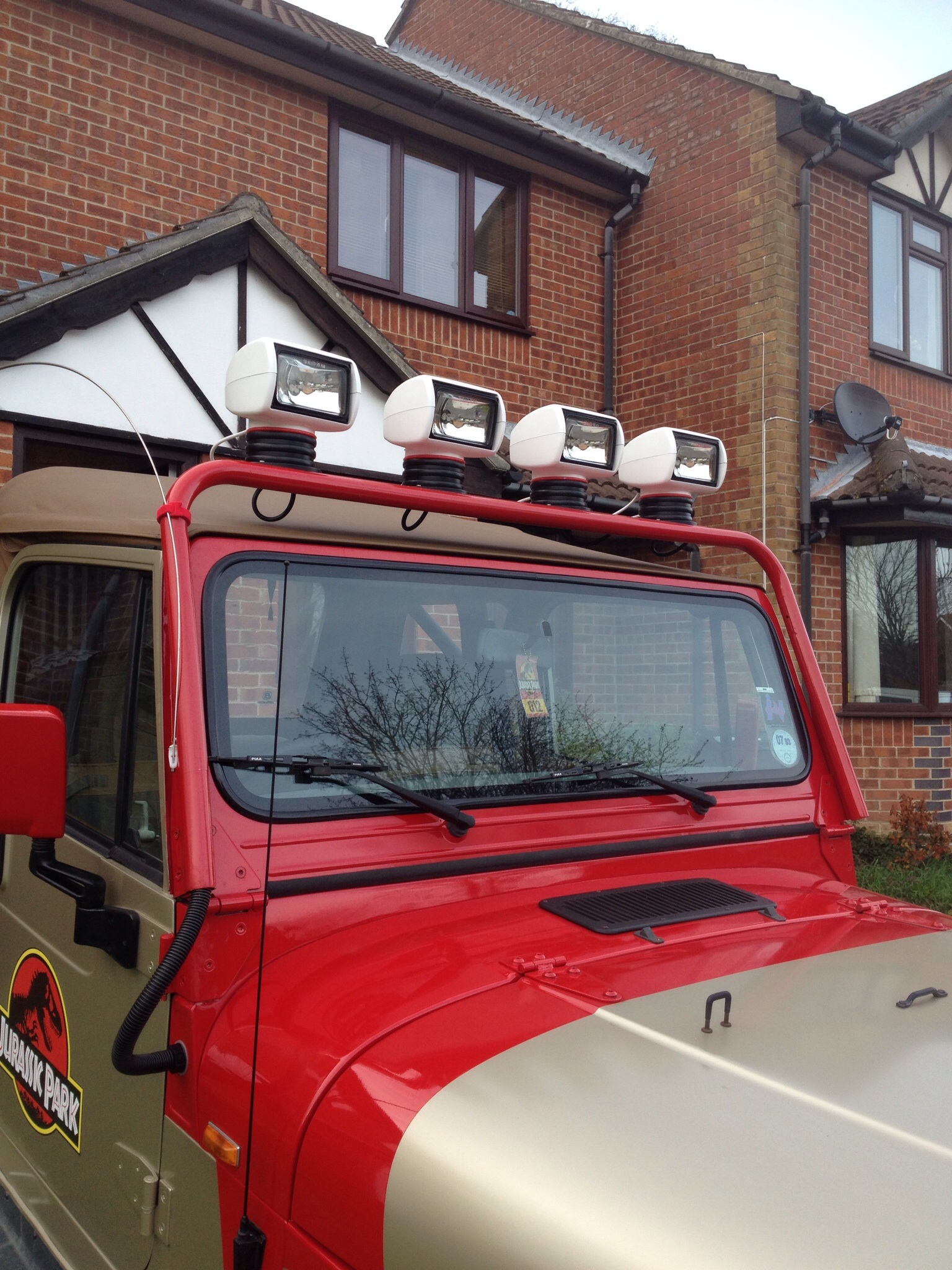

Turns out ingen have stepped up their security game ;)...
topgearuk98
Posts: 39
Joined: March 20th, 2015, 8:47 pm
Location: Colorado
Re: weapon lxxxi's jeep 12
Post by topgearuk98 » April 8th, 2015, 12:45 pm
That looks awesome!

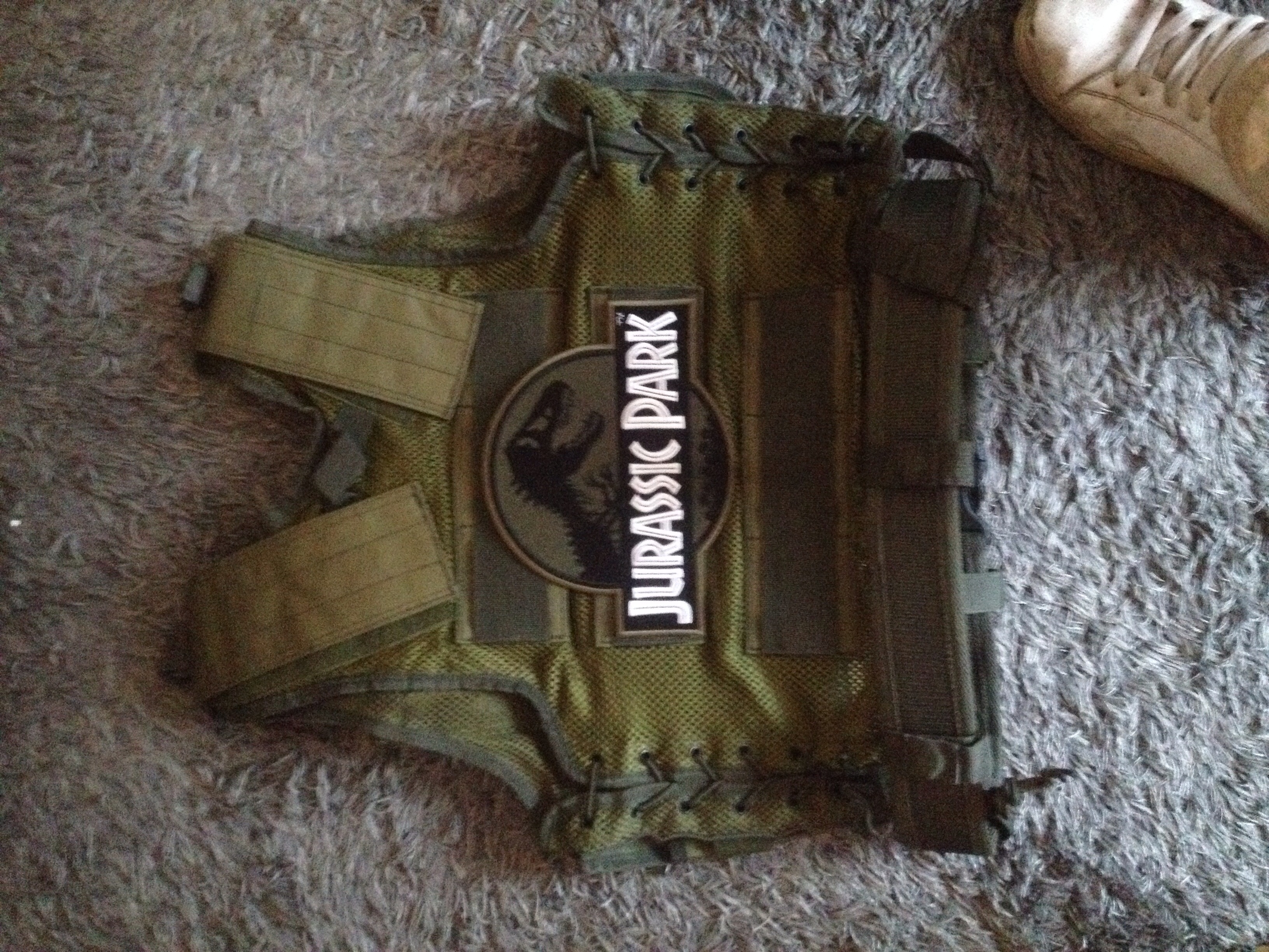

I know love it!! Once I've sewn it all on & pieced the other bits I'll do a full pic....
topgearuk98
Posts: 39
Location: Colorado
Post by topgearuk98 » April 8th, 2015, 5:27 pm
Where did you get those patches?
Image [ ] |||||||| [ ]

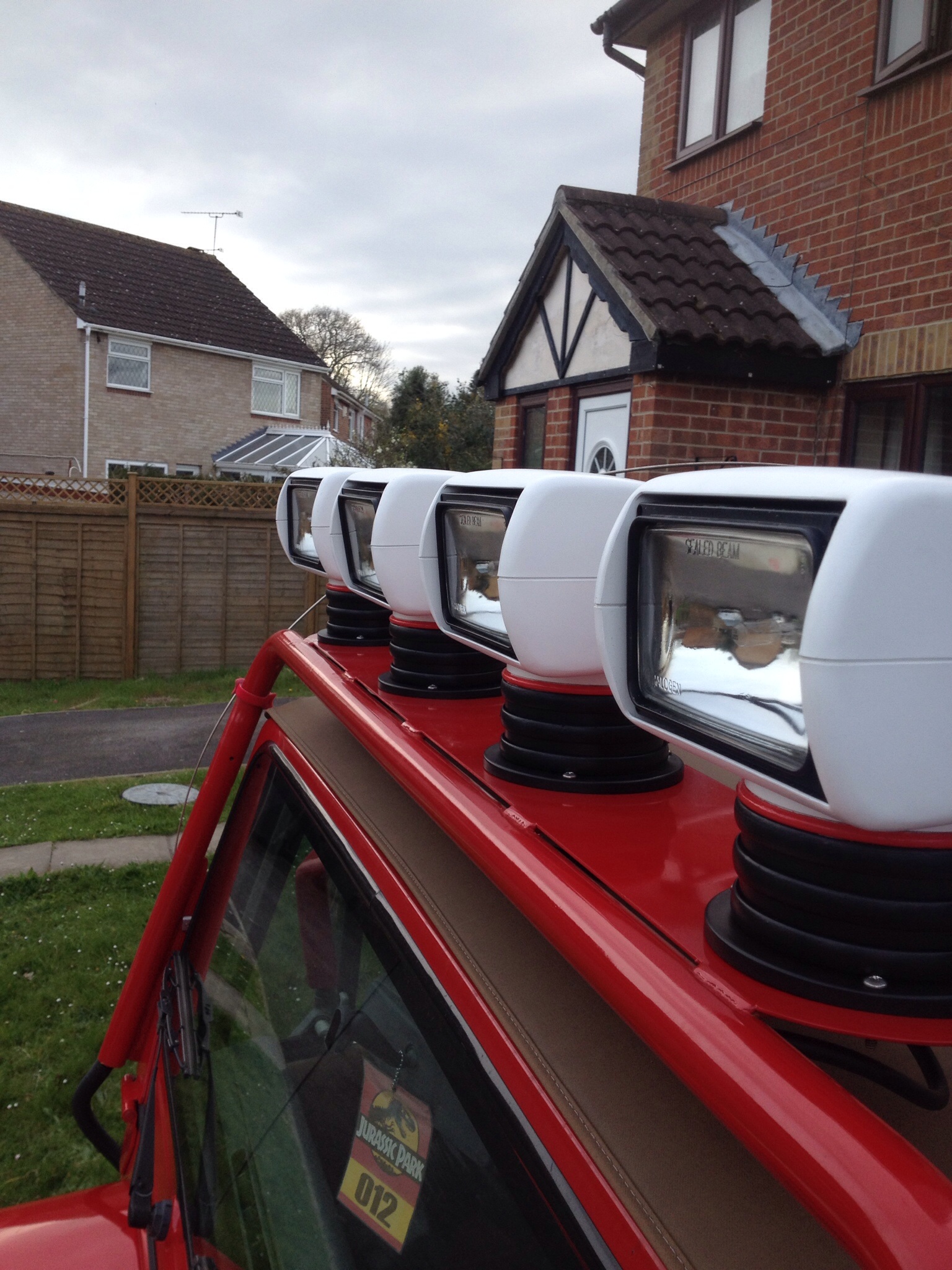

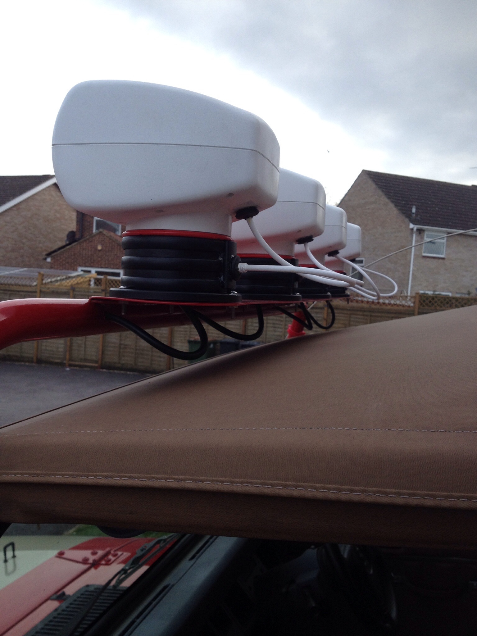

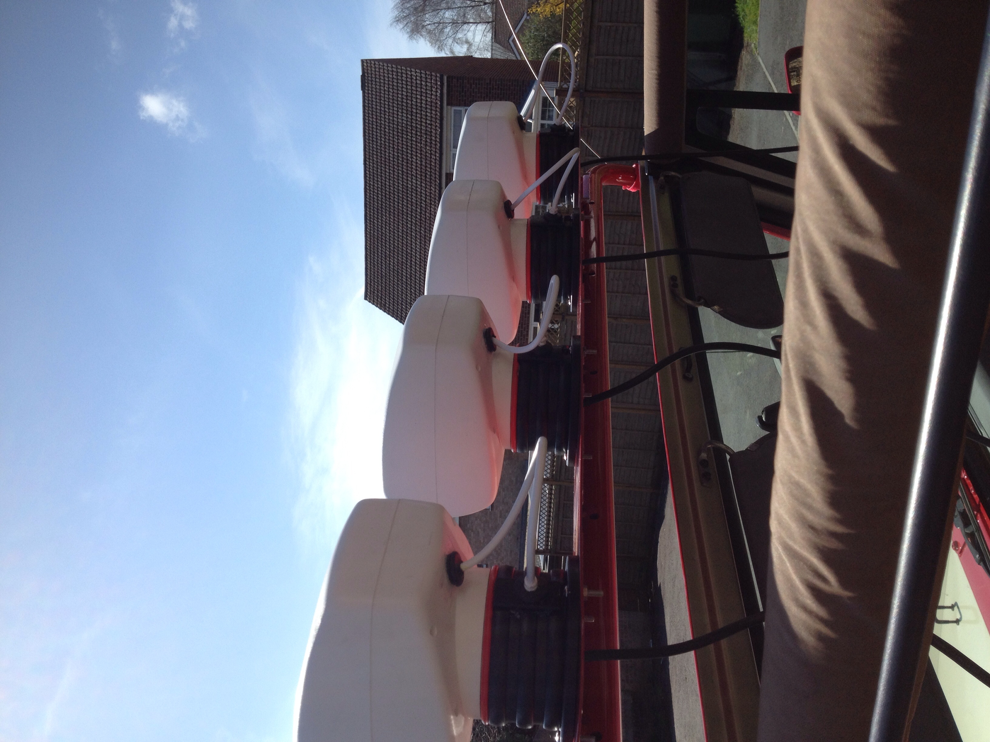

Sunny day roof off... Mounting these! Step one on, step two (not looking forward too) wire threading........
weapon lxxxi
Posts: 456
Location: South coast UK

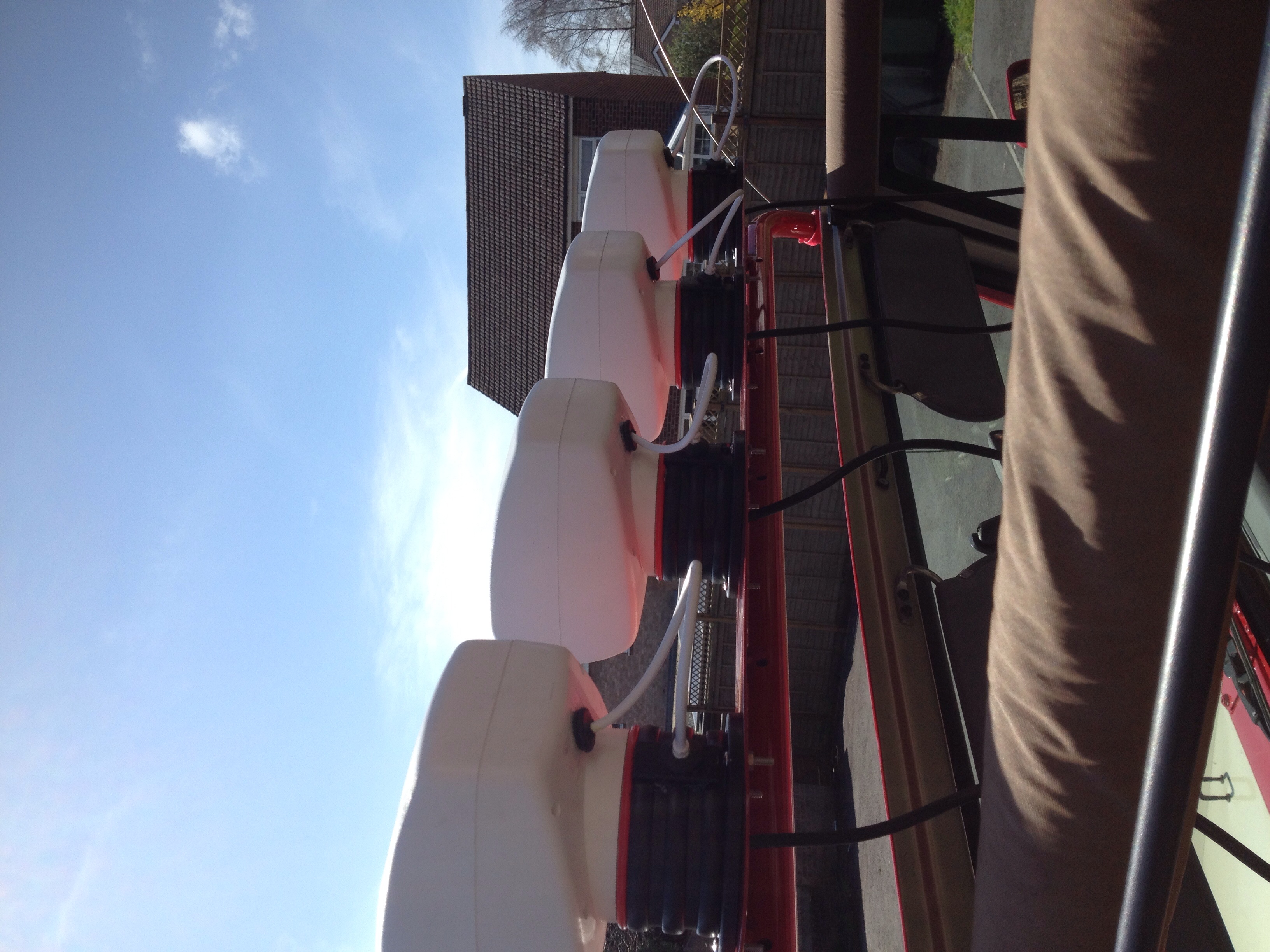

Post by weapon lxxxi » April 12th, 2015, 5:10 pm
After a long afternoon the wires are in!! blood sweat no tears tho! The first one took nearly 40 mins to get the wire through. I think the rust inside the bar didn't help. But with enough wire pulling lube (see jabsco feed topic for link) it went & the others where then easy. And as I'm going for outside correctness the wires on the inside stretch from the drivers side all the way over to where the switches go. Now I just need to work out how to wire them all up & connect it all to the battery. (Any tips welcome) (winch too). Also the guards are in hand....
Post by fantomas » April 15th, 2015, 3:47 am
Looks great! This is the last thing I need to do to finish the Jeep... I don't know why I've been dragging my feet, but it's car show time so I gotta get going on finishing the guards.
If you still haven't wired them up by the time I get to it, I'll post how I did mine. I had already ran a 10 gauge cable from the battery, to a relay, and have a bare wire above the glove box. I have a bunch of switches above the radio, one of which controls this relay as a "master" switch to turn all the lights on and off at the same time. You'll have to deviate from the instructions when wiring all the connections to each switch plate because they'll be mounted vertically, and the instructions call for them to be mounted horizontally. You can also look into wiring them so the lights can be adjusted without the light being on.
