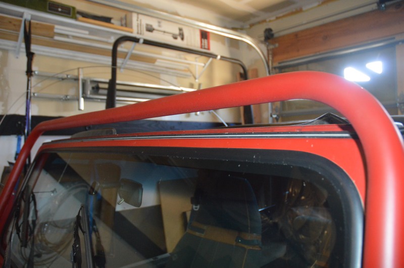

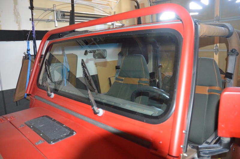

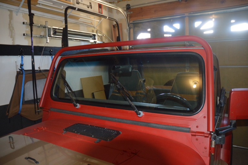

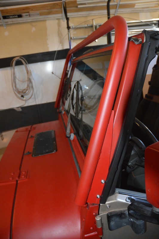

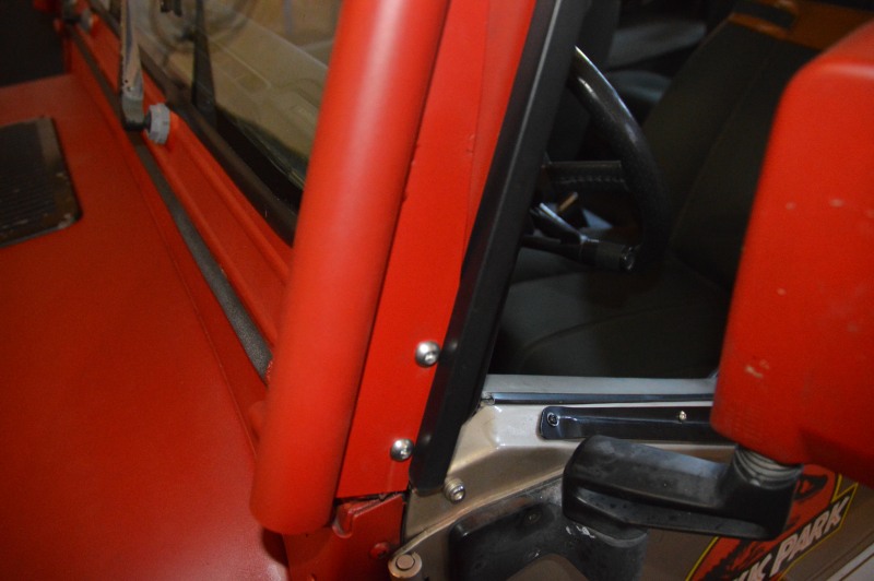

Hey Brian, could you post a few more pictures of the lightbar? I'm going to have to go down the fab route I believe. Was this one done with the DOM tubing?
Re: Colorado JP #29
Post by COBrian » August 26th, 2013, 3:25 pm
yes 1/8 thick DOM tubing. so it is very strong. I'll get some more pics tonight.
Re: Colorado JP #29
Post by COBrian » August 27th, 2013, 1:41 pm
Here are some more pictures. let me know if you want something specific I didn't get in the photos.
In making mine, I had a lightbar I had bought off of craigslist that was correct, Except it had brackets for a TJ. I would have just altered the brackets but it also had a fair amount of rust, and I would have had to cut off the light tabs and such, so I figured the cleaner solution was to haev one made (though more costly). I took the tj light bar and had the new bar bent exactly the same as the tj bar (with extra length on each leg). The brackets were made from the lightbar measurements AJ Quick posted in this thread : viewtopic.php?f=9&t=215&start=10 . With the bar bent correctly and the brackets attached to the jeep, we held the light bar up to the jeep and adjusted till the height looked right, its about 1.5" to 2" above the top of the windshield. Marked the tube at the end of the bracket, and then cut off the excess length. With the length cut off, we lined it back up on the jeep and tacked the brackets onto the bar. We then unscrewed the brackets and removed the whole thing. Then the welds were beefed up. I kinda wish I had him run a solid bead weld up the outside of each bracket as it would look cleaner. But its fine as is, and plenty strong.
