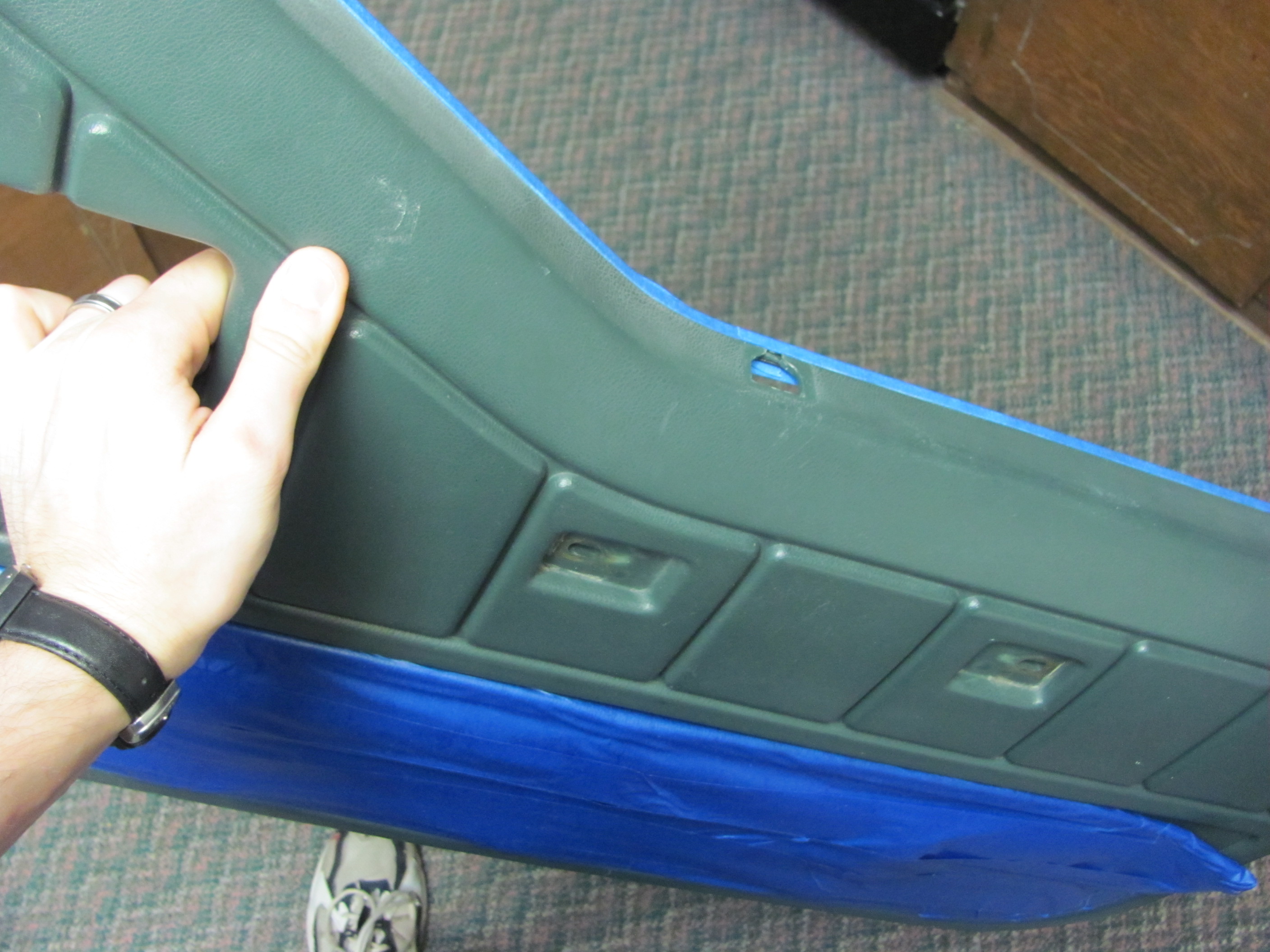

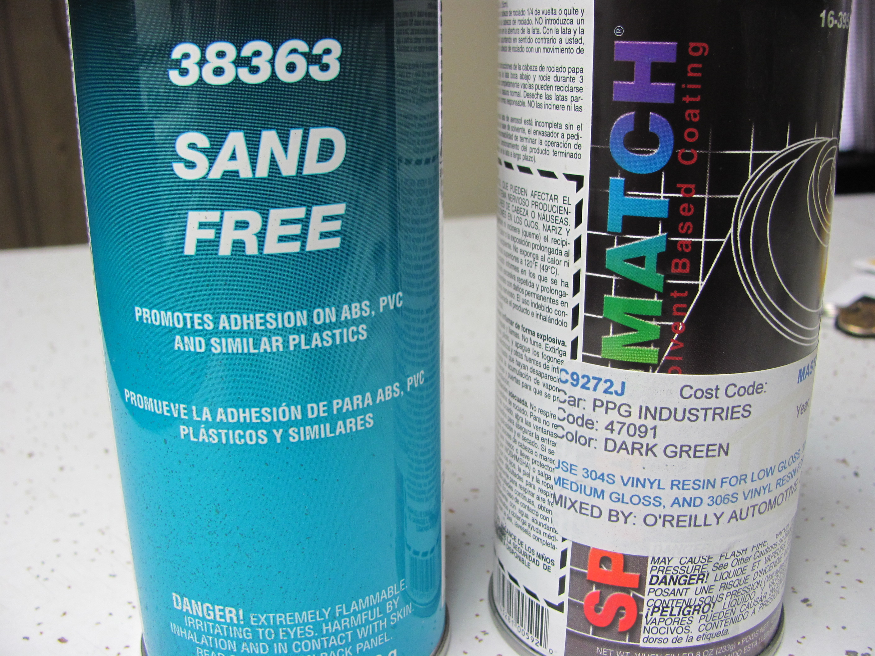

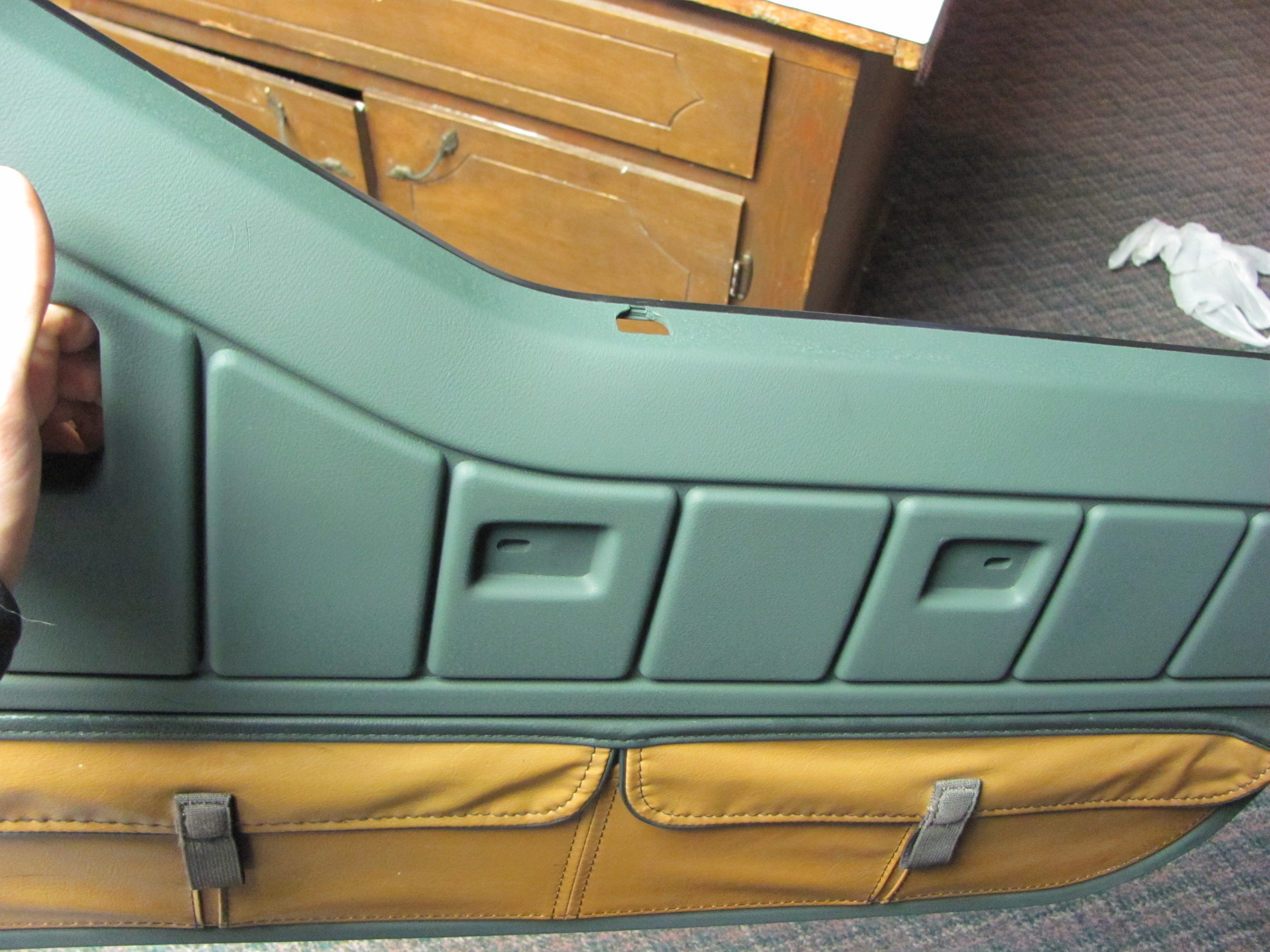

I have not had the time to mess with the fog light issue but i got all the green pieces of the interior done yesterday. I was going to do only the door panels but after seeing the color difference i had to do everything. It works out better to do everything but i kinda wanted it to be the exact color. The problem i think is that the guy that mixed the paint said he always uses the flat additive. You can also use medium and high gloss. When i was spraying the door panels i could not tell where i was painting and where i needed to paint. It is that close but when it dried it turned foggy and much lighter in color. I like the flat look but i think it needs to be at least a medium gloss paint. I didnt want to spend another $30 dollars and the time to drive back to the Oriellys to have another can filled. This only coast me about $40 for both the adhesion promoter and the green so i think this is the best way to do this project, but use at least the medium gloss.
You can see in the two photos how close they are but look at the green border around the pockets. The door panel had that same look to it before i changed the color. Now the pocket border is darker than the panel very slightly. I think the panels match the seats better than before and the panels are a solid color so.. win..win

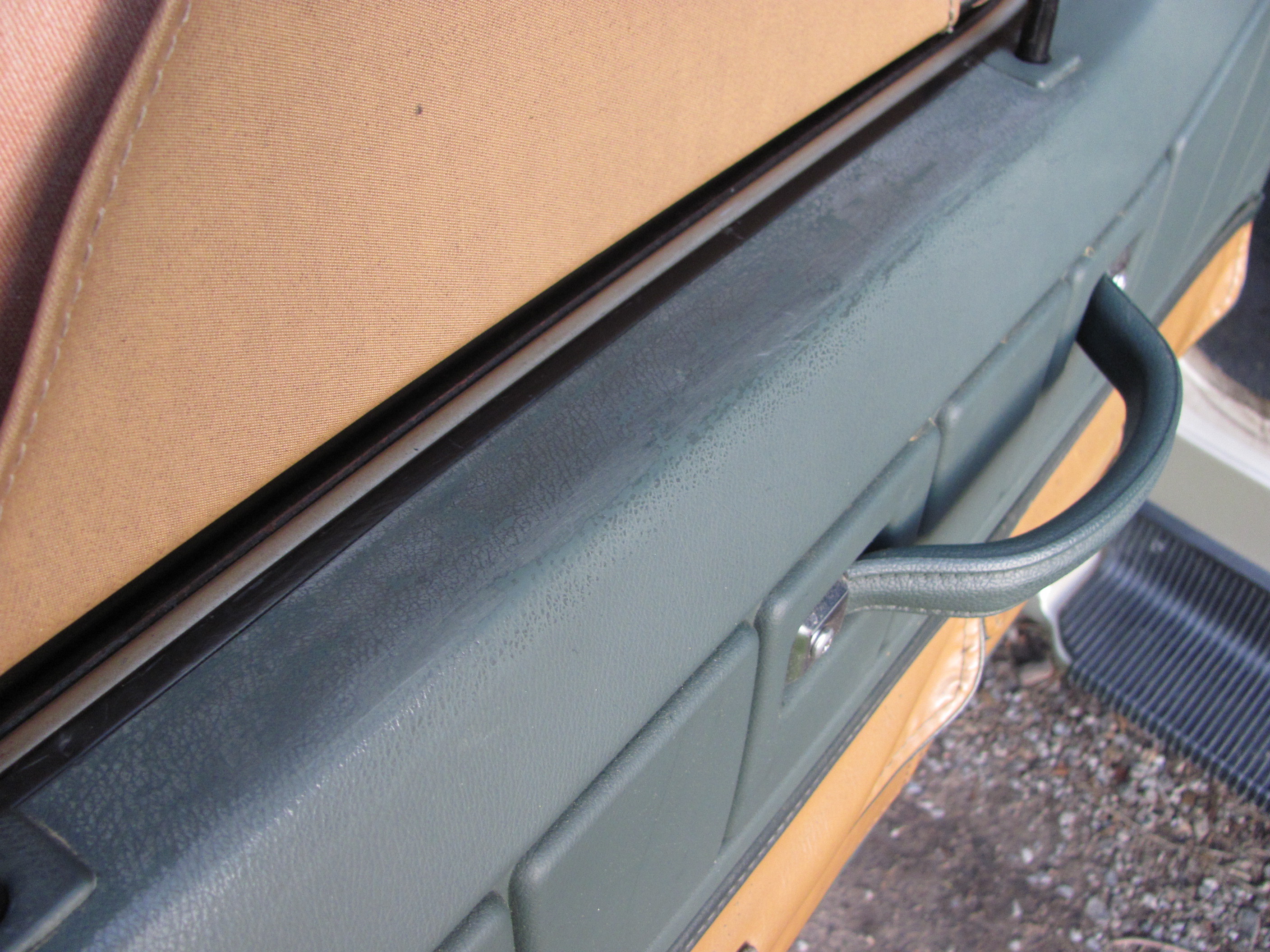

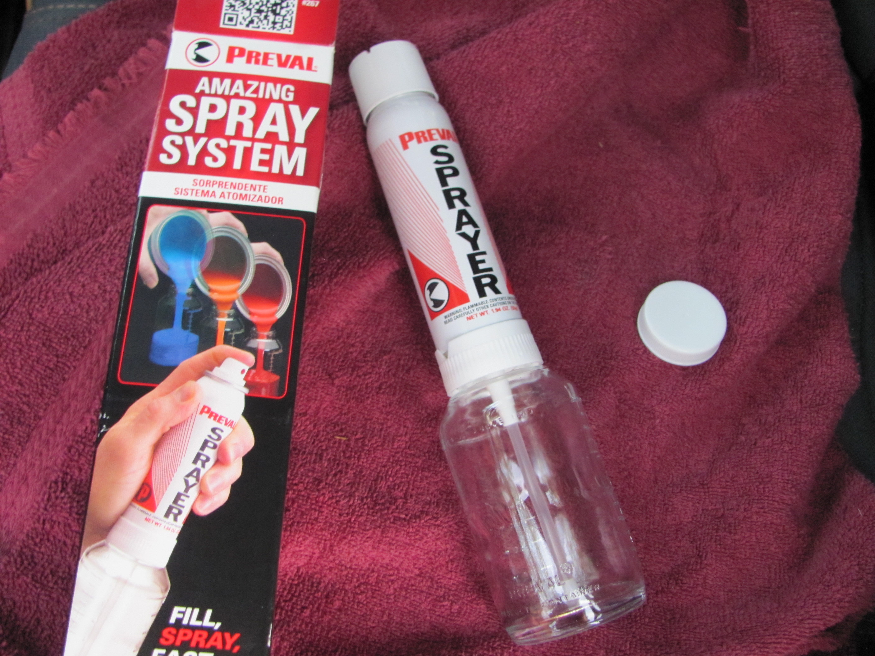

Last week it was nice and warm and my arm stuck to and removed the paint off the top of the door panel. :o WTF... figures.. So now my plan is to use this sprayer to touch up the top of the panel with it still in the jeep. The can with the paint has lost its propellant but the paint is still sloshing around. I lightly sanded the affected area tonight and it only seems to be loose on the top edge, and only in that one area. I have several theories on why this happened but none are a for sure. I am not going to use the adhesion promoter this time because i dont want it on top of the good paint and i hope that when i spray the new paint it will match and not leave a line of new and old area. Worst case scenario i will have to do the whole panel over again. I think if that is the case then i will go get new paint mixed with the medium gloss additive and do both panels.
