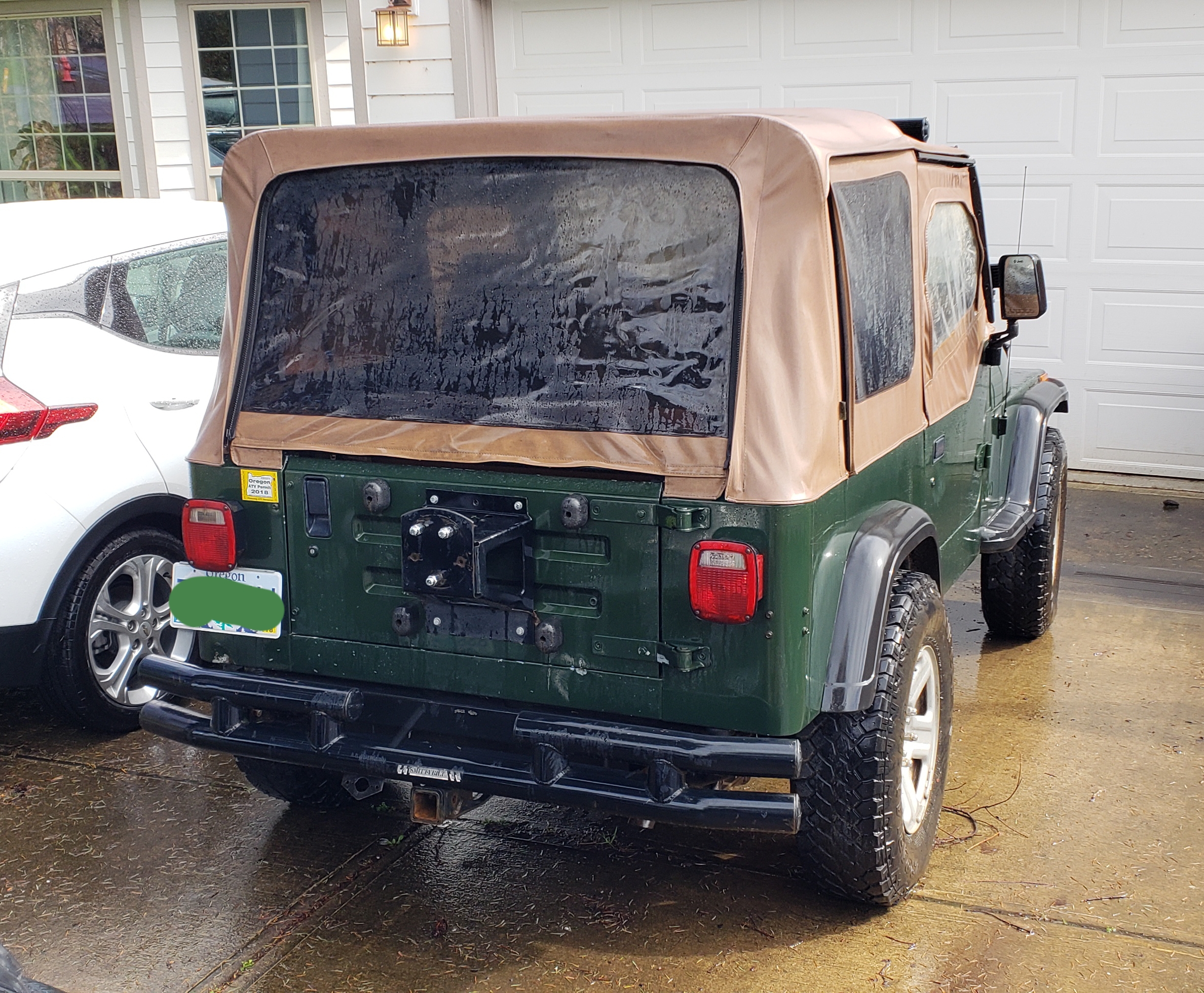

It has rained every single day this week... But despite the gross weather, I have had a minor success!
I finally have a back window! It took a good 30 minutes of loosening and tightening the right parts of the top, but I got there eventually. The non-locking #10 vislon slider fits this old Rampage top perfectly, but without the keeper block on the right side, it's still prone to coming undone on it's own... I intend to fix that as well.
I picked up some vinyl window restoration cleaner, and I'll scoop up some soft top cleaner. It's still not the prettiest top, but I'm hoping it cleans up nice!
Only thing I'm still worried about is that big gap between the bar at the base of the window and top of the tailgate. Can't seem to find any evidence to suggest that there's supposed to be a weather seal attached to the bar, but I'm sure I can find a way to blank it off and keep any stray drips from getting inside.
