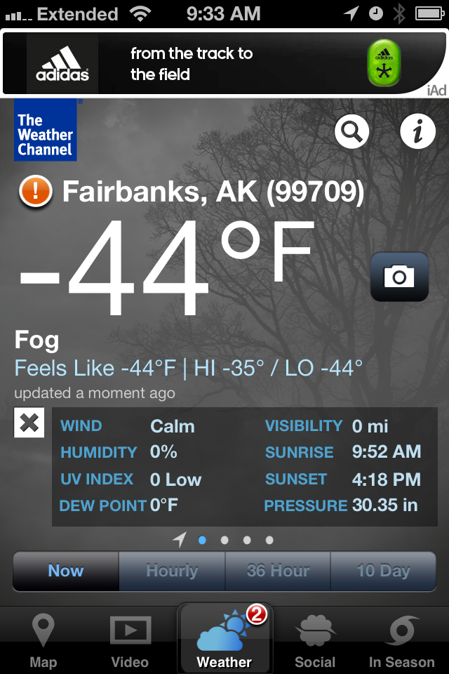

As for the Dash, if I do the grey I am going to do what Jack_fauth did, gonna get a stock grey wheel and get the color matched and then spray the dash parts. Its to damn cold up here to fiddle around in a junk yard getting a dash haha. its -44 today, perfect day to stay inside and work on the jeep
One of those days that I regret requesting the Army to send me to Alaska!!!
