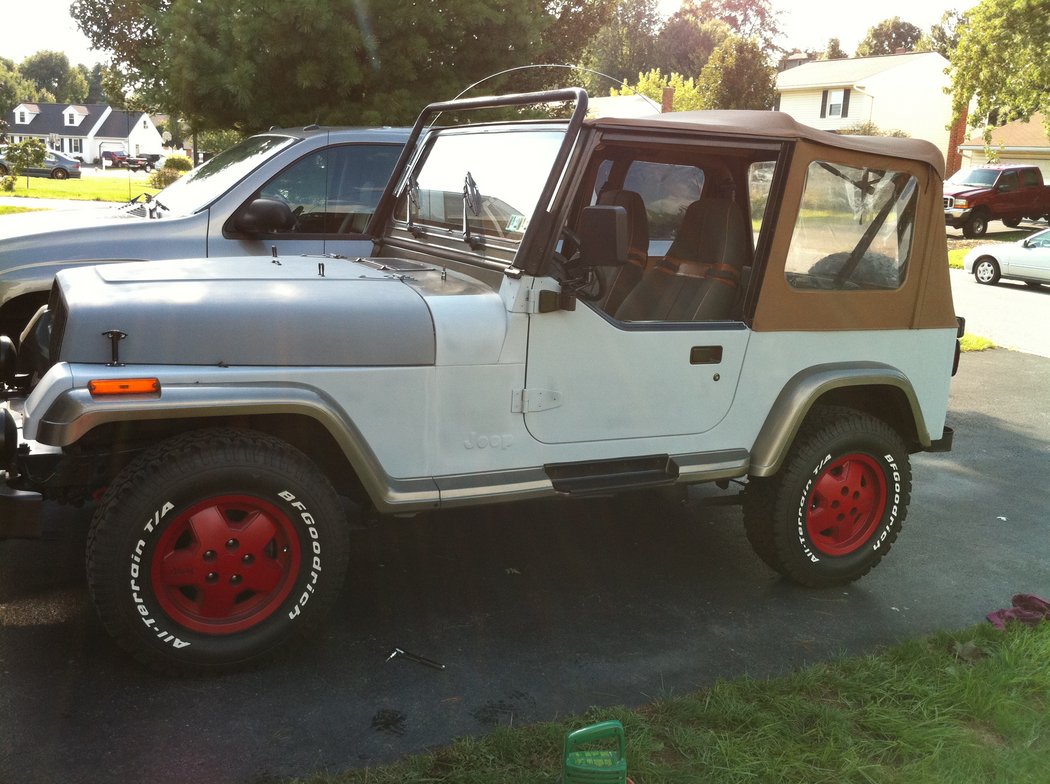

Finally got around to getting some work done on #12
Lightbar showed up Friday, an original Mopar one, cut it down by a little over a 1 1/2" and the height looks pretty good to me.
Also my plate showed up, all the ones related to a JP12 jeep were all taken
I chose this one... Also got to work on the body Saturday and Sunday. This jeep had oversized tires that ruined the wheel wells so i got a set of perfect ones.
here is where she sits after owning it 6 weeks

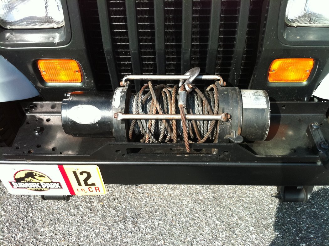

Got my lightbar sanded and painted and found another light , just need 2 more... next i remounted it
also found a Ramsey winch on e-bay with the old sticker...

Still have to decide if i want a working winch or just a prop...

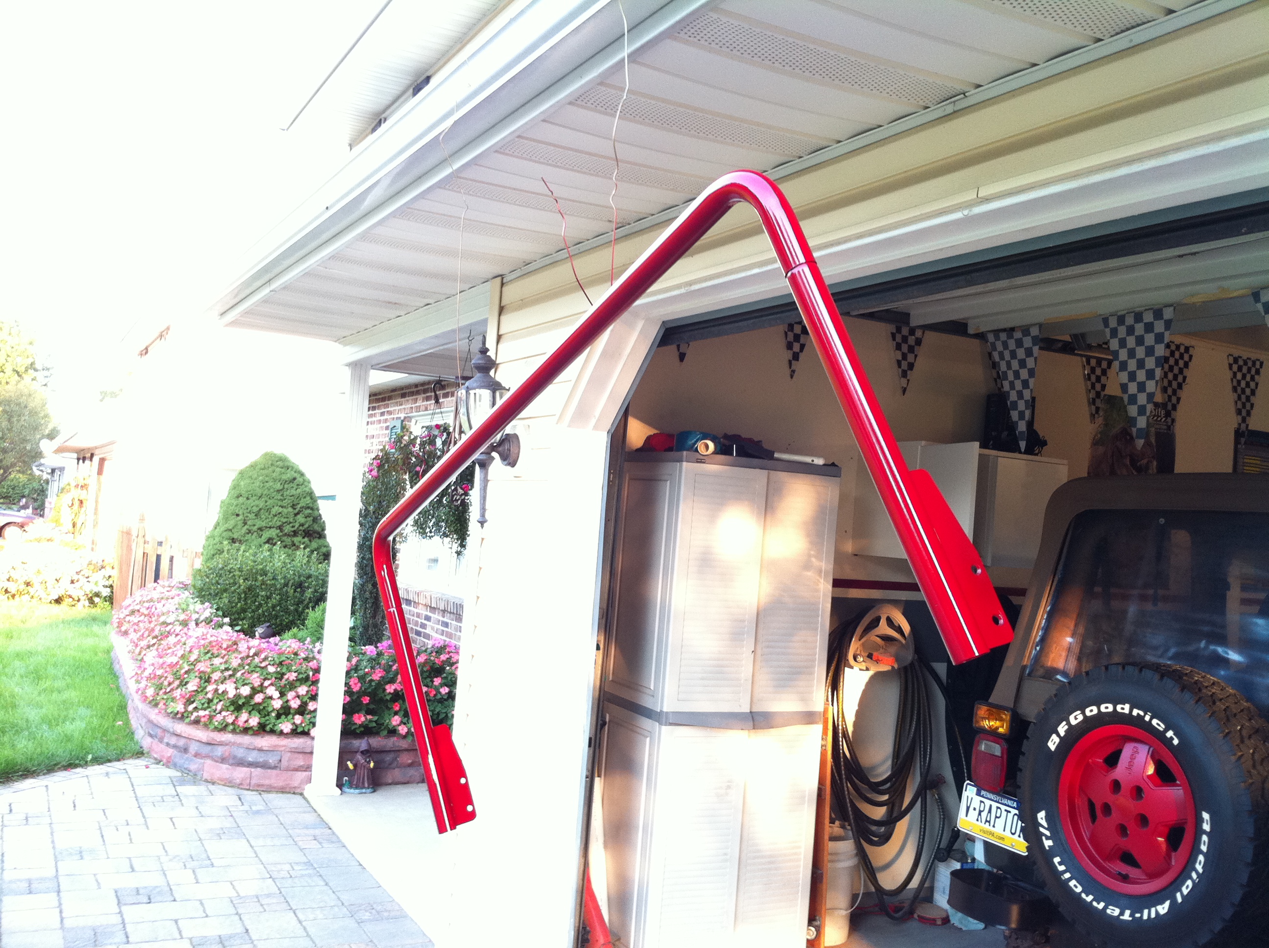

Speaking of props I also got this finished up to take to car shows to sit beside my #12

what winch plate did you use? i didnt know you could still use the tow hooks with a winch plate?

it came with the winch i got from e-bayMaverick20 wrote:what winch plate did you use? i didnt know you could still use the tow hooks with a winch plate?
The lister said it was a 36" Promark Universal Mounting Channel
It worked out well, it bolts right to the tow hook spots and the driver side has the channel cut out to put your old hook back on.I even used the factory tow hook bolts to mount it. The passenger side is not cut out and needs shorter bolts which i picked up at a hardware store. No drilling required to mount the plate.
It came with a roller fairlead which i removed and now just need to replace it with the screen correct flat one.
