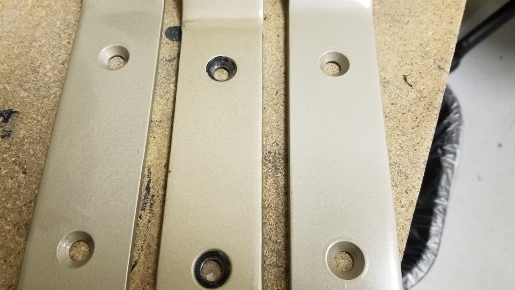

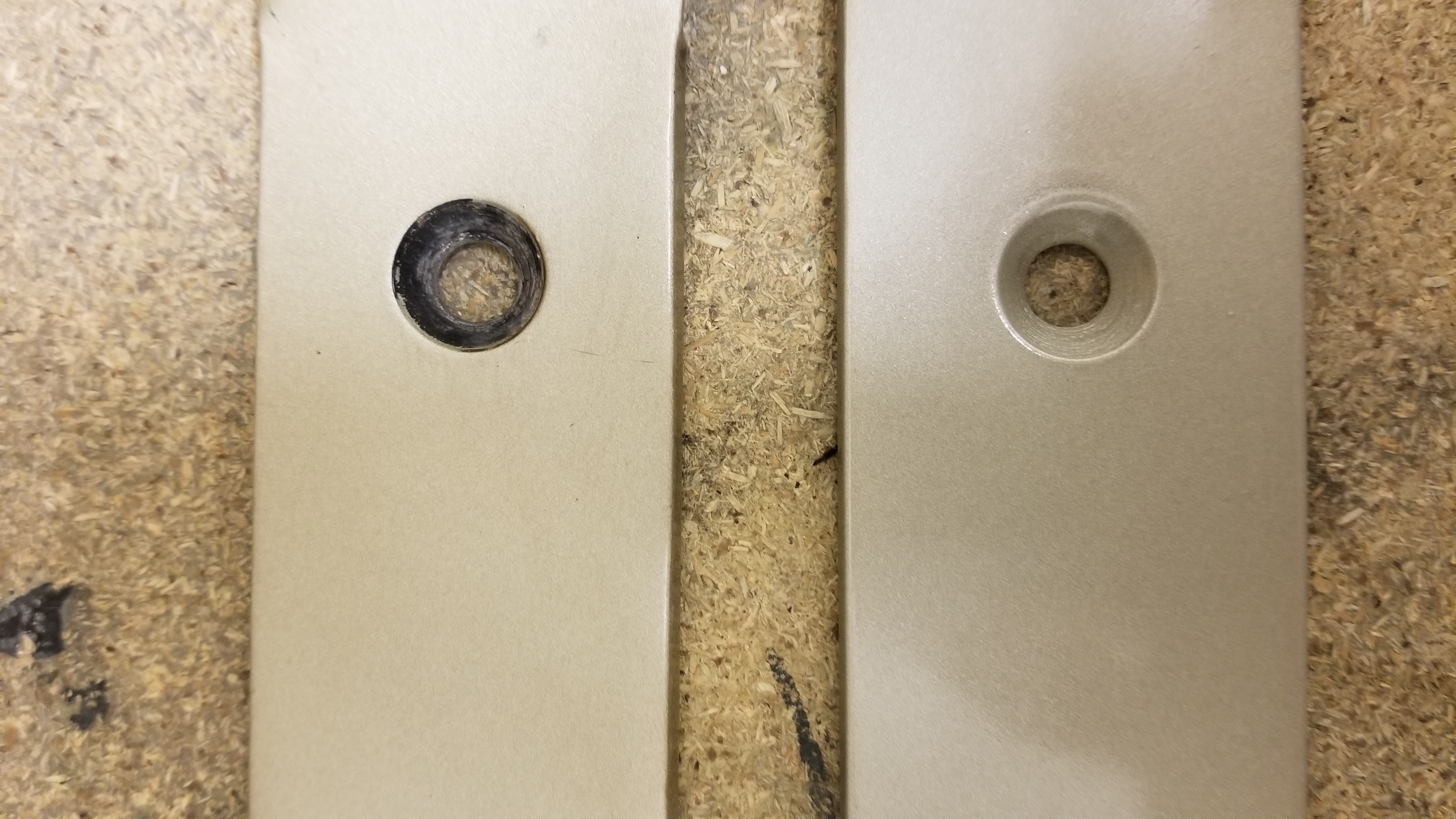

Post by ratrace427 » August 22nd, 2018, 10:28 am

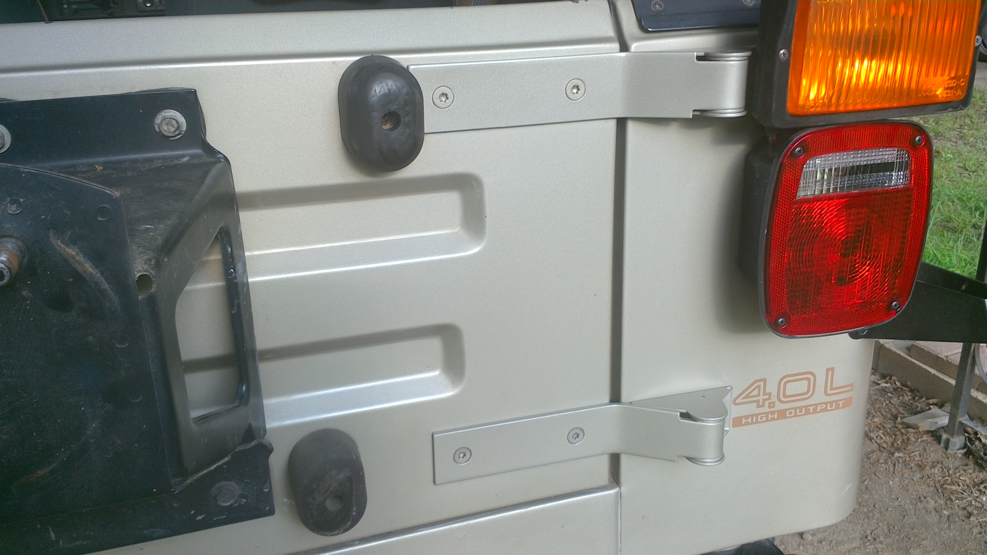

here I tried zero reducer. it's the best I can do. the paint recipe just isn't right. zero reducer is on the left/ top of photo.
2oz paint
.5 oz hardener
Post by ratrace427 » August 22nd, 2018, 1:21 pm
I polished the original 1992 hinge seen in the photos. seems that the color gets lighter the shinier it is and it's more gold when the surface is dull. this finding makes sense but it can't get any shinier or polished than it already is. I think it's a combination of several factors that makes the new paint different. out in the sun the original polished paint and the reducer free re-painted hinge look really close, but there is a difference in the metal flakes within the paint. I wonder if the 25 years of sun has made the original paint more gold?

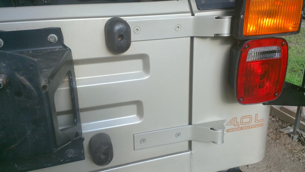

Post by ratrace427 » August 23rd, 2018, 7:46 am
I got the rugged ridge hinges installed last night. what junk! anyways I should have found good used instead. If I was doing this over maybe just adjust the play out of the hinge. it was dark by the time I got this junk adjusted but I will get a photo uploaded today. the reducer free paint looks awesome! my eyes tell me it's the exact same color when bolted down against the body. I will see what the camera picks up later.
Post by ratrace427 » August 24th, 2018, 6:31 pm
finished

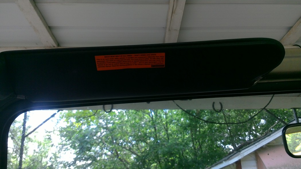

Post by ratrace427 » July 1st, 2019, 2:02 pm
Just a few little things that i have done this summer. I bought a few stickers from johnathan householder and from summit racing to freshen up some things. I also installed the metal round 4 pin connector on the solenoid pack. RV-528C is the part number for the 4 pin connector.
