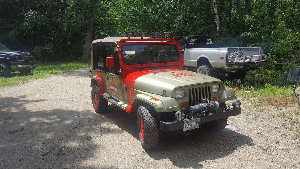

Okay Im going to give a run down of what I did how I did it etc. and cost.
COST 1300 for the Jeep and Plow
800 for jeep 500 plow
2 new fenders and windshield frame about 350
1 sheet metal for repair ebay 30
paint primer etc. 500
winch and mount ebay 350
light bar and lights used ebay 80
tires and rims craigslist 150
herculine floor 20
fog lights amazon 50
rear yellow lights ebay used 30
cb antenna ebay 50
speaker bar craigslist 30
lug nuts and various stainless bolts 80
1 new tire back to match ebay 140
resistors 5 ebay for cpu
exhaust 200
fix seal brake front axel 100
decals stickers ebay 60
grand total 3525
I could have probably saved some money by doing jeep 29 and if you minus 500 for the plow its 3025 not bad. I would add the 500 just for miscellaneous so thats why I left it.

Where did you find the new fenders so cheap?
I take it they are not used fenders?

The fender I found one on ebay if I remember it as around 140 150 crown automotive and the other I found on craigslist old stock oem 100 bucks guy bought the wrong one needed a tj and had been sitting in his garage for while couldnt return it. I will say this the old stock fender as heavier and fit a little better but they both looked fine.
