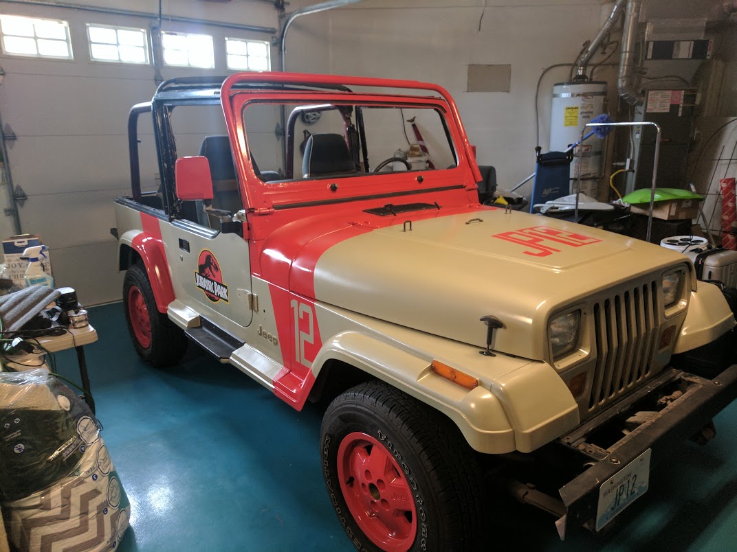

And with that. Shes all done. Mostly...
Theres a list of parts I can still add to the jeep over time like the rear KC fog lights and the jabscos have a space on top of the bar, alongside the winch and the whip antenna. Most importantly I want to get the correct roll bar, Sun visors, and I'm still missing windshield glass which should happen in a day or two here.
But most importantly into the process.
The person I bought my jeep from brought her out alot as a beach car so there was naturally ALOT of paint chips on the front and the windshield. This took a majority of my time to fill and get it smooth.
For the fendors I used Bulldog adhession spray and its come out nice and strong.
When it came time to spray the primer I went with what the shop considered the "cheaper" of the two primer options but its still a very quality product.
Primer went on nicely I ended up sanding down alot of it to make sure things were smooth.
Sand Beige Metallic LJ1 went on very clean and I gave it awhile to dry then masked to the Kytor Industrys dimensions I mentioned earlier.
Now puting primer over sand beige wasn't necessary but this was one of those things I figured the prop department probably got Fords stock primer alongside Performance Red as they would have gotten an already finished dry stock Jeep they would need to put primer on top. Alongside the paint shop told me stock car colors need a specific color of primer underneath to achieve the original shade of red Without coating 5 or 6 times. Its a small detail I was willing to spend the extra bit on to make sure the red is the right shade.
Ford Performance Red went on a bit blotchy the first time so I ended up waiting a day and doing another coating. Turned out amazing.
The day I could unmask was a wonderful day. All the lines turned out perfect.
I cant stress enough for those looking to build a Jurassic Park Jeep to get the right color. Even though the movie shots look more grey or the red could be any red. Take it from someone who tried building his Jeep with dark grey matte vinyl to start. Its nothing to the metallic shine the sand beige gives off and the red is a beautiful eye catching almost orange looking color that works amazingly with the sand beige.
I'm considering the jeep "done" for now although I would like to buy legit Jabscos as I did get the light bar custom built with the plate for that reason. Alongside all the other Parts Ill be adding but the main part of my build is there and done and I'm very relieved to have it turn out the way I wanted. I cant thank everyone on the forum enough I definitely couldn't have done this without the years of research this community has built up. THANK YOU SO MUCH!
-Aiden H
