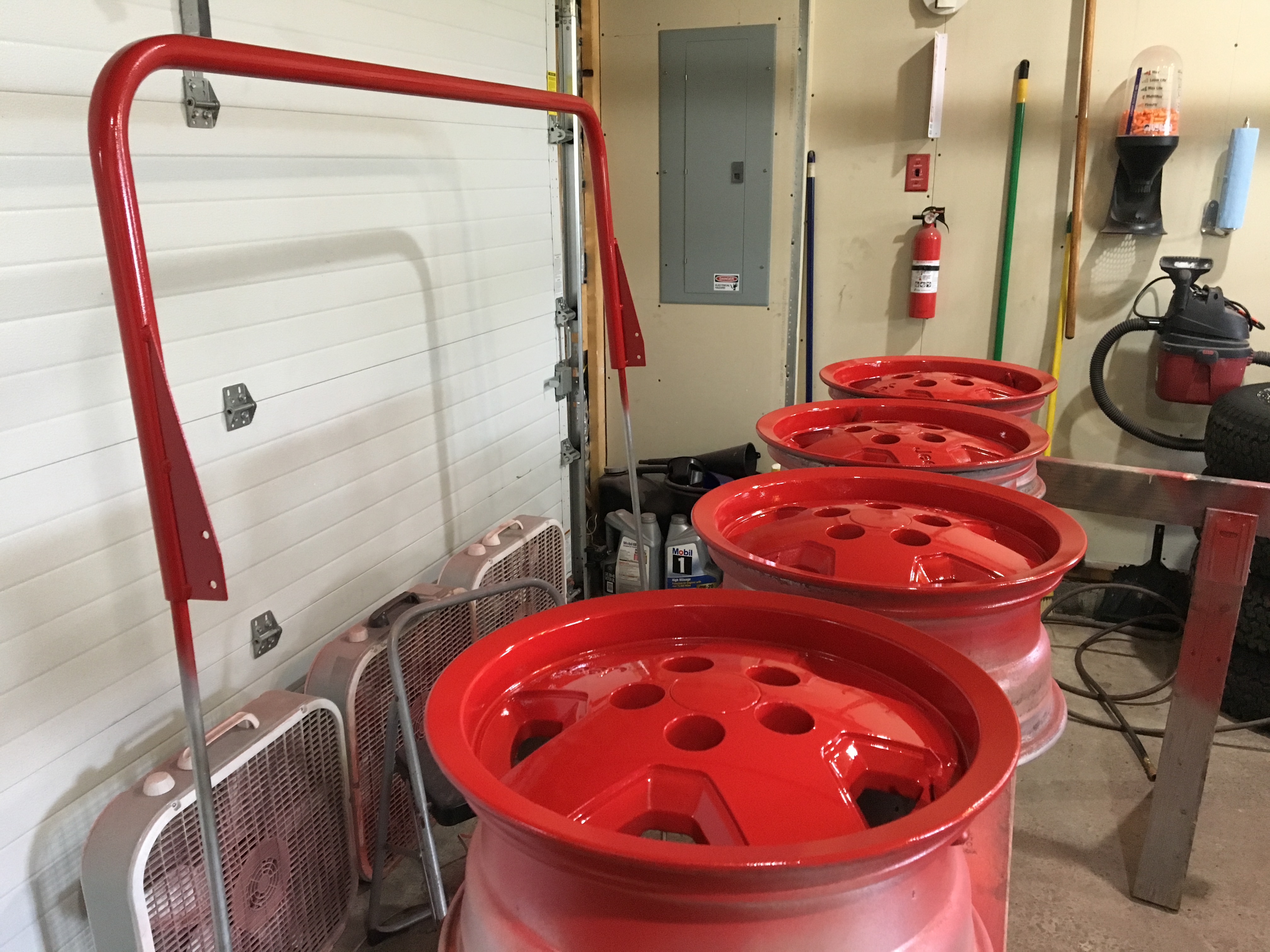

I got the lightbar and wheels painted and clearcoated over the weekend. The lightbar is from Obsession Offroad. I will say, they did a great job. It was slightly too wide, but it compressed down just fine once tightened. I'm actually glad it was too wide versus a tight fit or too thin. I used a rubber gasket between the hinge and lightbar to prevent rainwater from draining into the hinges and replaced the awful factory Torx hardware with stainless steel bolts and washers.
