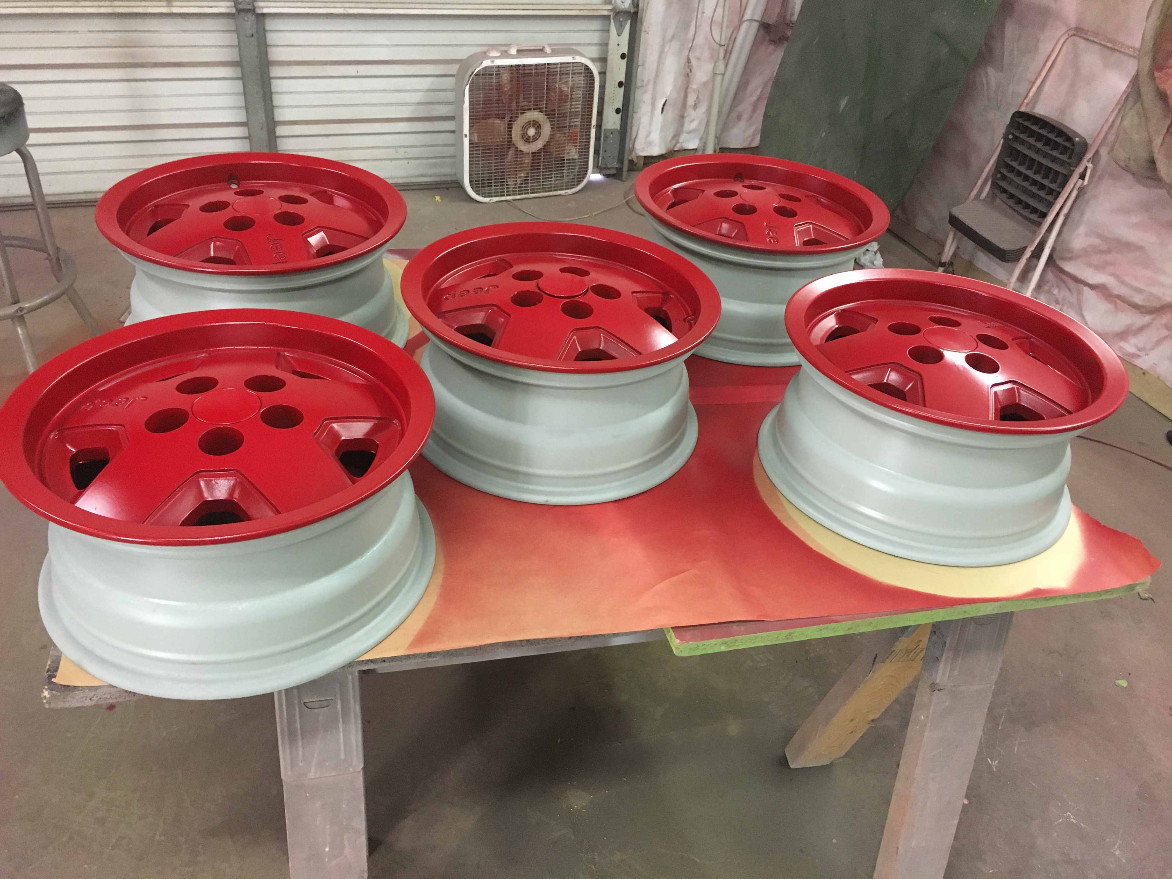

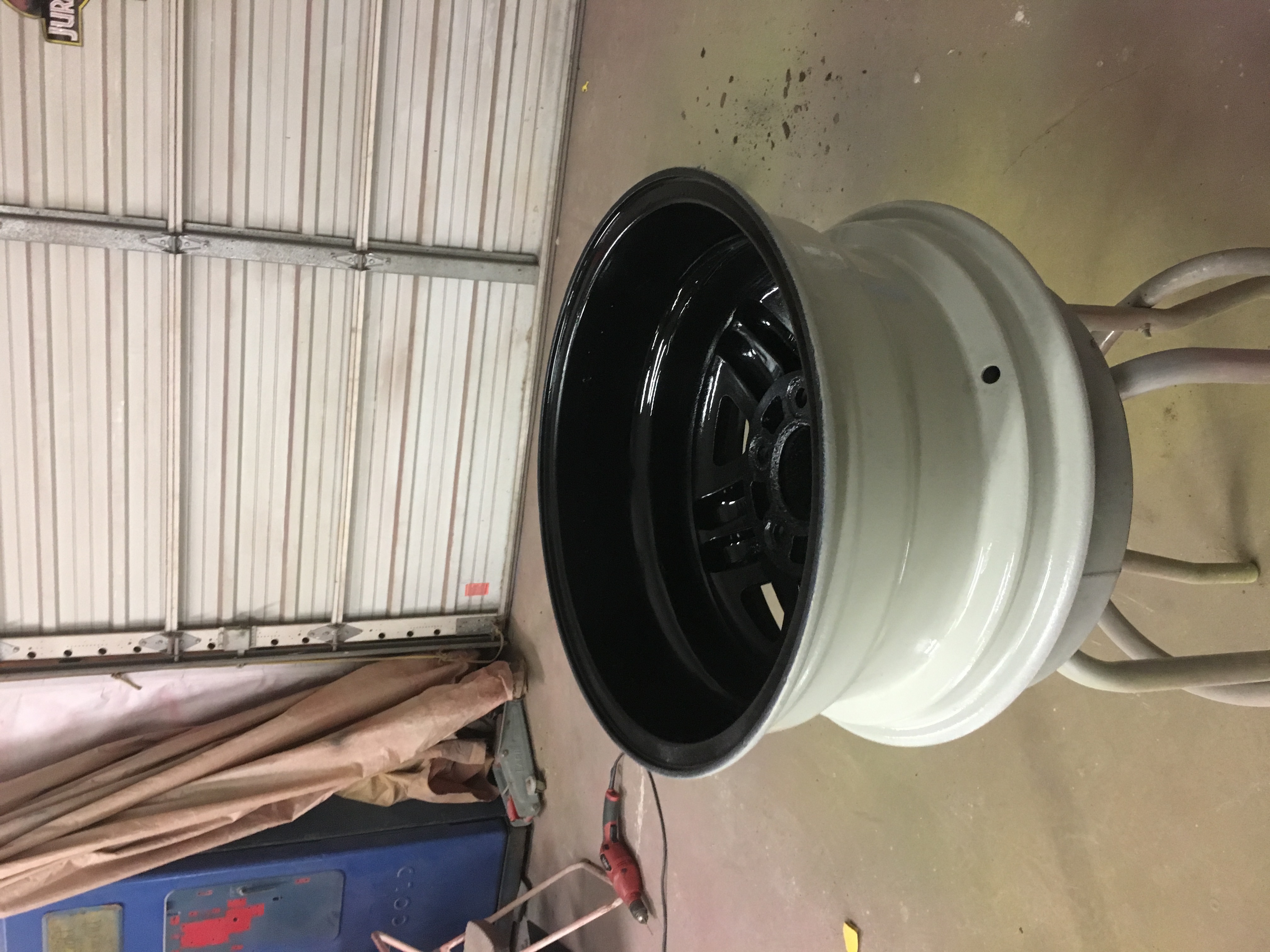

Remove the valve srems and any old weights that are on the wheels
I sandblast the wheels inside and out, it makes a better job and the tire will seal better as these wheels tend to corrode around the bead area
Also average price for these wheels is around $25 a wheels but i have gotten a set of 5 for less than $100 before

Yeah, I have one guy that said he sells these wheels for scrap at $15/each, he refuses to wait and save them till I have time to drive out to him...
but I have another guy that I can always get $20-25 per wheel any time of the year.
As for painting I just taped around the valve stem before a light sandblasting, scuff pad to finish, then painted. I only did the face of my wheels.
I did have my spare tire professionally sand blasted and powder coated though because I have a RADIAL ALL TERRAIN tire on it, which will never be changed.
