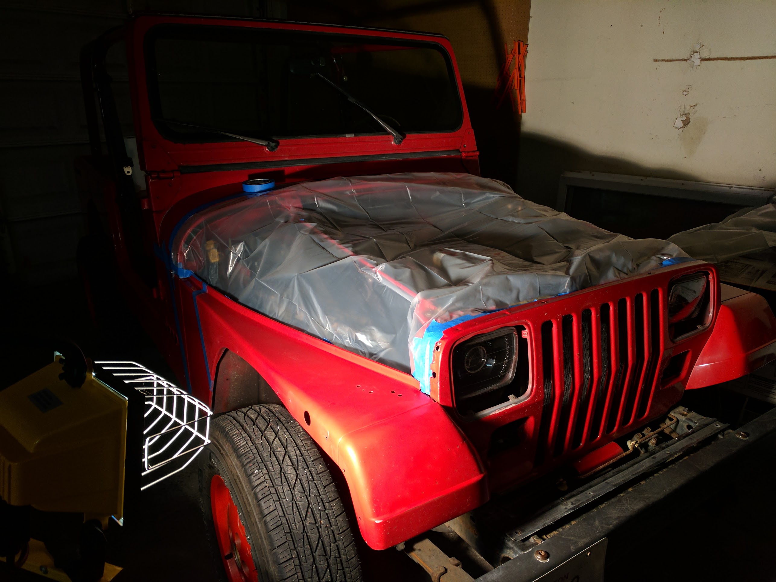

I pulled off all the vinyl and talked with the other JP Jeep owner about details like paint colors and such. I nicknamed her RedBarron with the amount of red. Overall I wanted to make a new post about some of the stuff I'm doing with the build.
I put Red Barron in the garage I plan on painting her in so I've got about a week to pull apart the interior and sell all the tan islander parts I've got on craigslist. Then hit the Jeep junkyard for the Sahara Parts.
I'm planning on ordering test paints in the next couple days and trying out the colors. My Jeeps already Red so I'll be leaving the interior Red except the inside window pain. I need to go down to a shop when I've got extra cash on hand and get a light bar fabricated. I don't have the money to afford the Jabsco lights so i need to use the ones I've got and try to mimic them. I expect it to be a month before I finish the build.

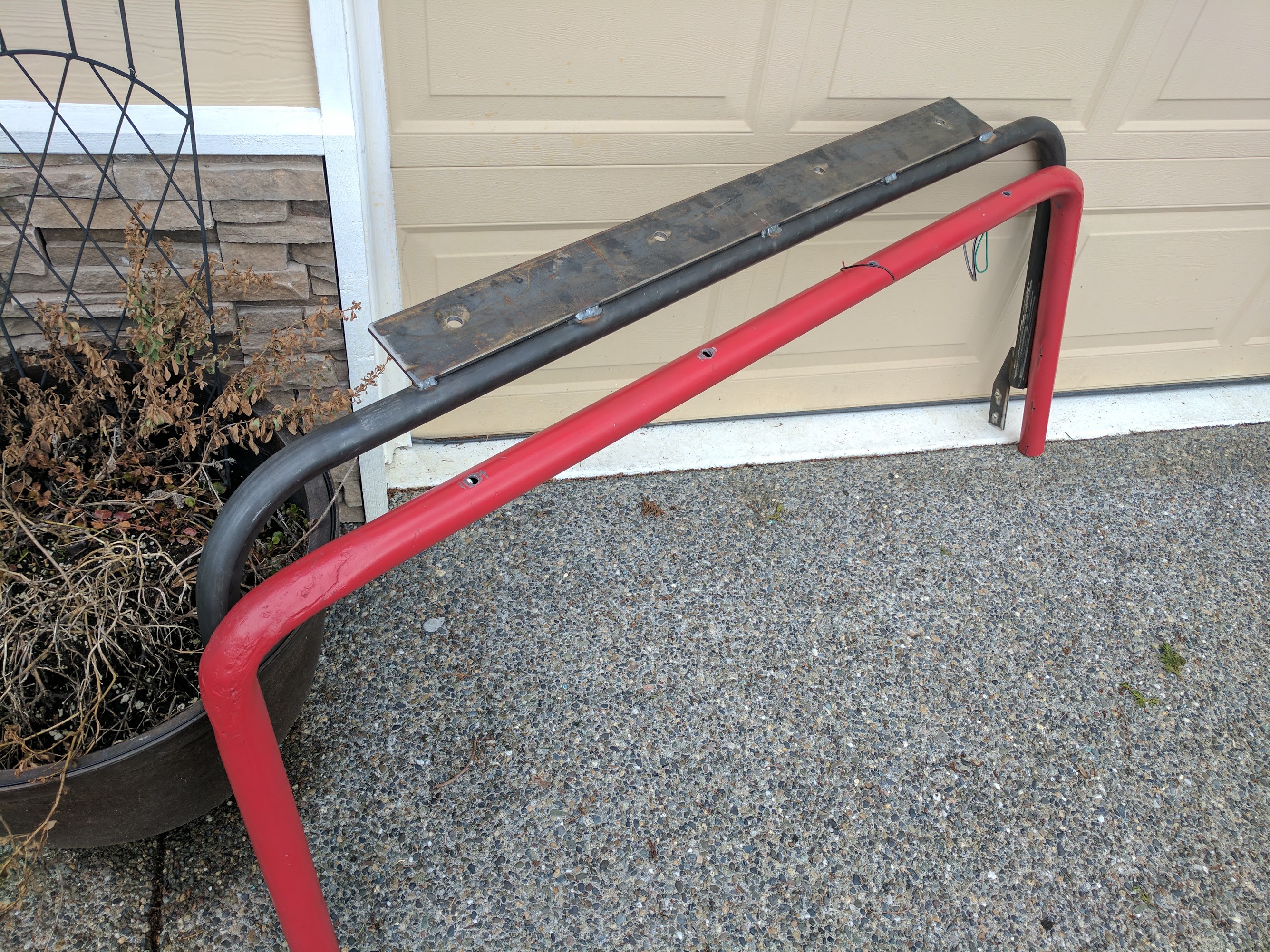

Quick Update. Thanks to The other Jurassic Park Jeep I've been lead to a craigslist ad for a 2004 wrangler family Bar that does have some problems fitting but Nothing an afternoon with a drill cant fix. For only 80 bucks with no rust I cant complain.

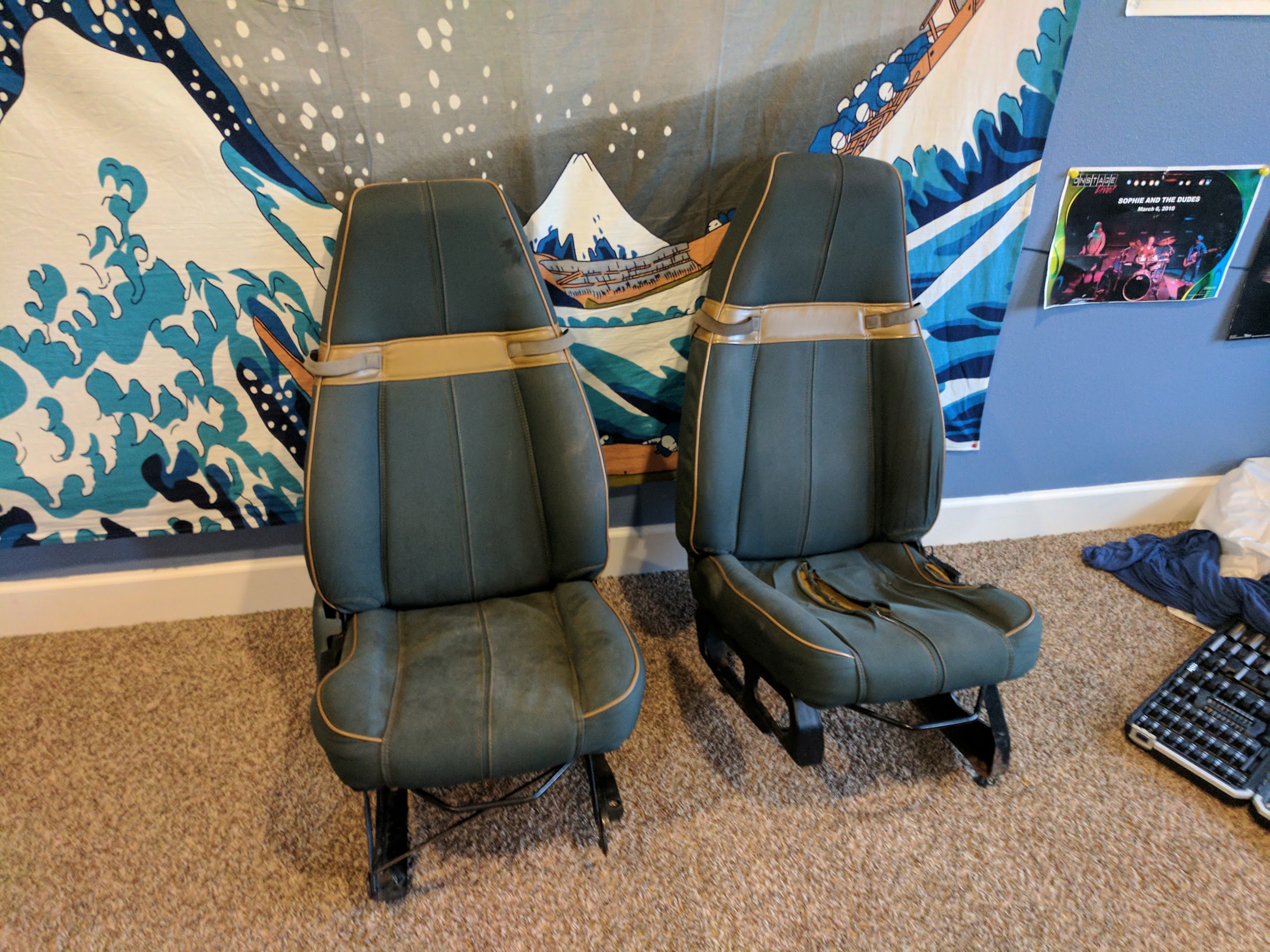

As expected with all Jurassic Park Jeep builds its 90% part finding so Ive been spending alot of time getting parts bought. One being the other JP jeep offered me his extra 2 sahara seats for 250 still need to find a drivers seat.

Lastly some sad news I spent awhile really taking a look at how to mount the family bars i bought a bit ago and I decided the effort it would take to try securing it safely was not worth it when I can just buy a family bar of the right year. So If i can sell it for 80 or higher I'll be fine. Just sad the junk yard asked 220 for one. Just a lesson to learn don't try and fit a 2004 family bar to a 1990 Jeep.

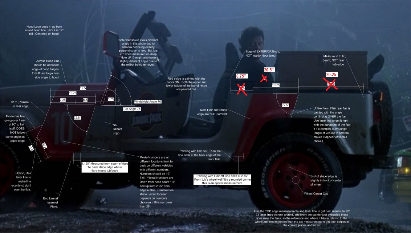

One last thing forgot to put in last post. Since the line placement and distances is a big thing and for most people theirs no going back on it. My build is strange as I have a second chance to try different dimensions. I saw Kytor Industries build post and that he changed some numbers on the Jeep 10 dimensions image. Given that I did the vinyl off the original numbers I agree with his changes. The 72.5 degrees is not possible with the given numbers. I ran into this problem when doing the lines in vinyl originally. I ultimately had to move one line an inch back so it lined up with the top fender making it easier on me plus maintaining the angle. It didn't look bad but I always kinda knew the front line was too short it felt wrong. Now that the vinyls off it left an obvious line on where the vinyl was at and I masked to Kytors new dimensions and I can already tell they look better.
You can clearly see just how much of a difference it made. If anyone needs it heres his updated image.
Again thanks to KytorIndustries for fixing it. These now line up perfectly.

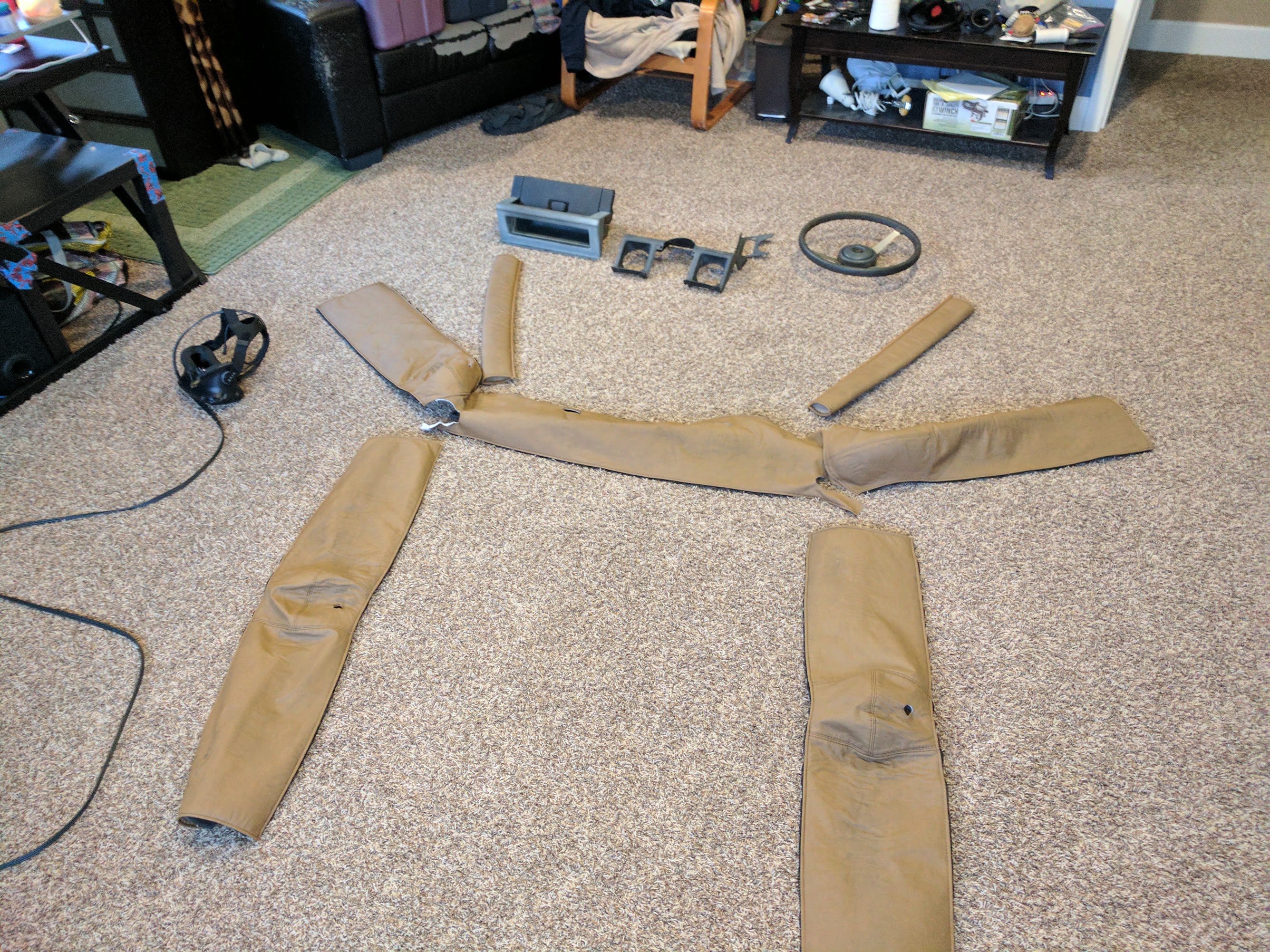

Been awhile and alot has been done but it doesnt feel like it since i cant install anything until the jeeps done with paint. So I've got a storage room full of most of the interior parts just sitting there.
Anyways its mostly been more parts.

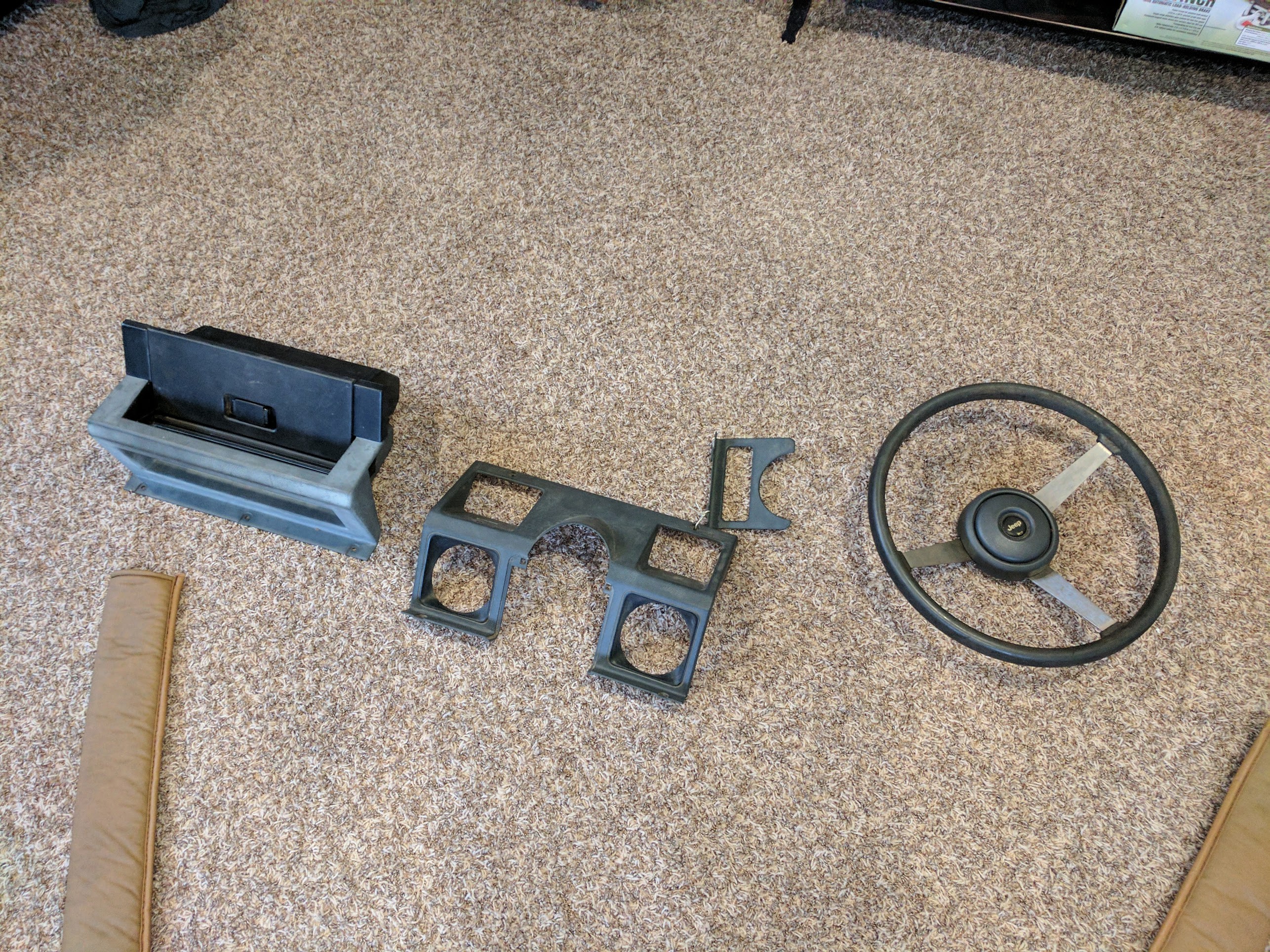

As my interior was the islander tan a big part was the dash but the junkyard asked $200 for it! I figured id wait on it till this summer or something but I ended up finding the upper dash pad on ebay for $60 free shipping. The guy that I sold my old seats to lead me to a misc jeep junkyard that was off the grid, It was an older guy with ALOT of jeep parts but almost nothing whole if that makes sense. I drove out there with $50 bucks in hand expecting to just look around that day and come back for more later. I just named parts left and right we picked them up for all $50.
I got the steering wheel (and cover), the glove compartment, left surrounding guage trim and the spice roll bar covers. An awesome find. After that I drove up to the junkyard an hour north and got the side steps along with the last guage trim for $100. Installed the dash and used my old jeep vinyl(same stuff that was the really ugly gray i used to have) to cover the backplate and the steering wheel column. Ultimately decided Id wait on painting the inside of the windshield so I reattached all the things on it. I ordered the custom door panels awhile ago and decided to just go get my panels painted for a few bucks real quick. Still cant decide if i want to use the hunter green or repaint it the actual darker color. Just going to have to wait to see how I like it installed. Just waiting on the pouches but I'm in no hurry. Lastly the seats problem. I just got this fixed today sorta. So I had bought the bench and the passenger seats awhile ago but I still needed a drivers. Running into a guy selling his sahara wrangler on craigslist it was an amazing jeep all except his drivers seat had a rip in it. I contacted him asking if I could buy the seats and give him these black seats someone gave me as a trade for the islander seats. He said we could just trade since I was saving him from buying new seats anyways and we met up today. The passenger seat is in good condition just has alot of dog hair and smells like dog. Needs to be washed. The drivers seat though... the cushion is really tore up, To get around this I'm putting both the passenger seats I have in the jeep until I can get around to reupholstering the driver. I'll have to deal with the lean lever being on the right but its worth it to save my ass (literally) from pain. couple little things left like the Bar that was wrong awhile ago got fixed and looks good. As well as I picked up a new barbasol can, made a new mirror tag and bought a driver hat from user mark brody for the hell of it. I still need to either find someone selling the correct family bar or buy it for 200 from the junkyard. Its spring break next week so I'll be in the garage getting it ready for paint. So hoping to have her back on the road then.

Looking good! Keep up the hard work! You might be able to take the bottom part of your "extra" passenger seat and put it on the driver seat (just the cushion or fabric) BAM! fixed driver seat!

Looking good. I'm glad my diagram helped you out.
