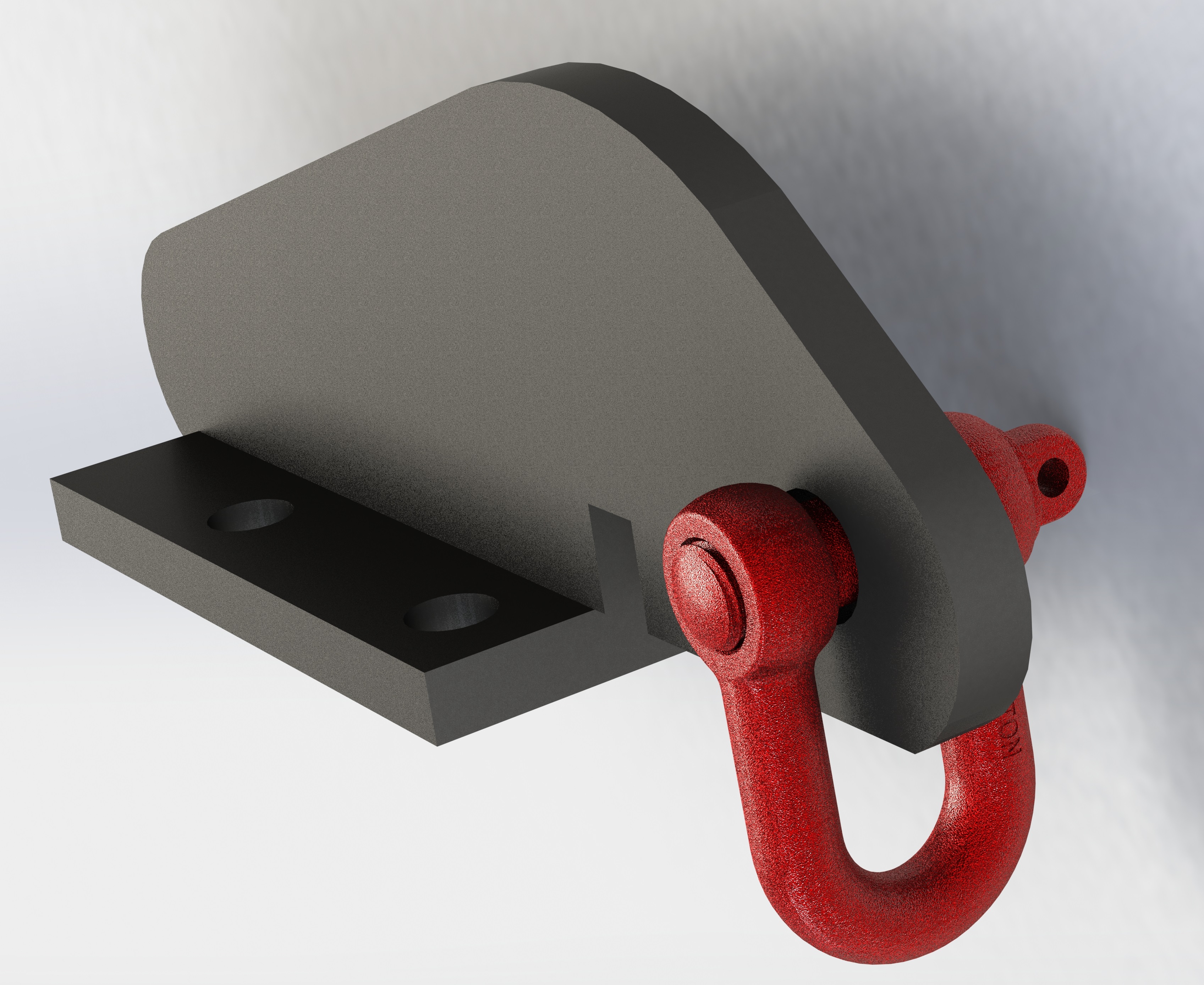

Budgetary quotes on the tow eyes so far have been... unfavorable. Unless you guys want to pay close to $300 a set, which to me is ridiculous for small sqft carbon plate. The issue is that these folks are all quoting off a CNC machine, this is a very simple pattern that should be done by hand fab. Tolerance does not need to be CNC precise. I have about 20 RFQ's out off my reference-only dwg and will continue negotiations and then open it up to a group buy.

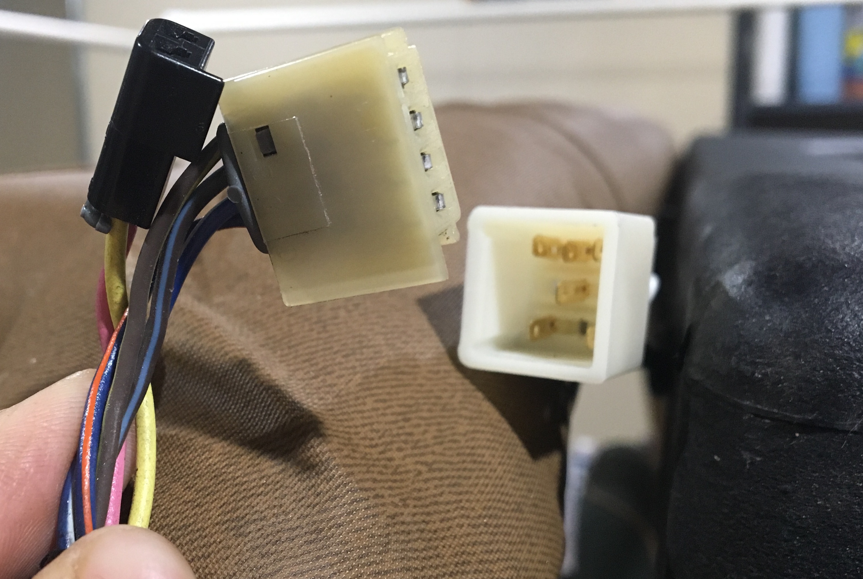

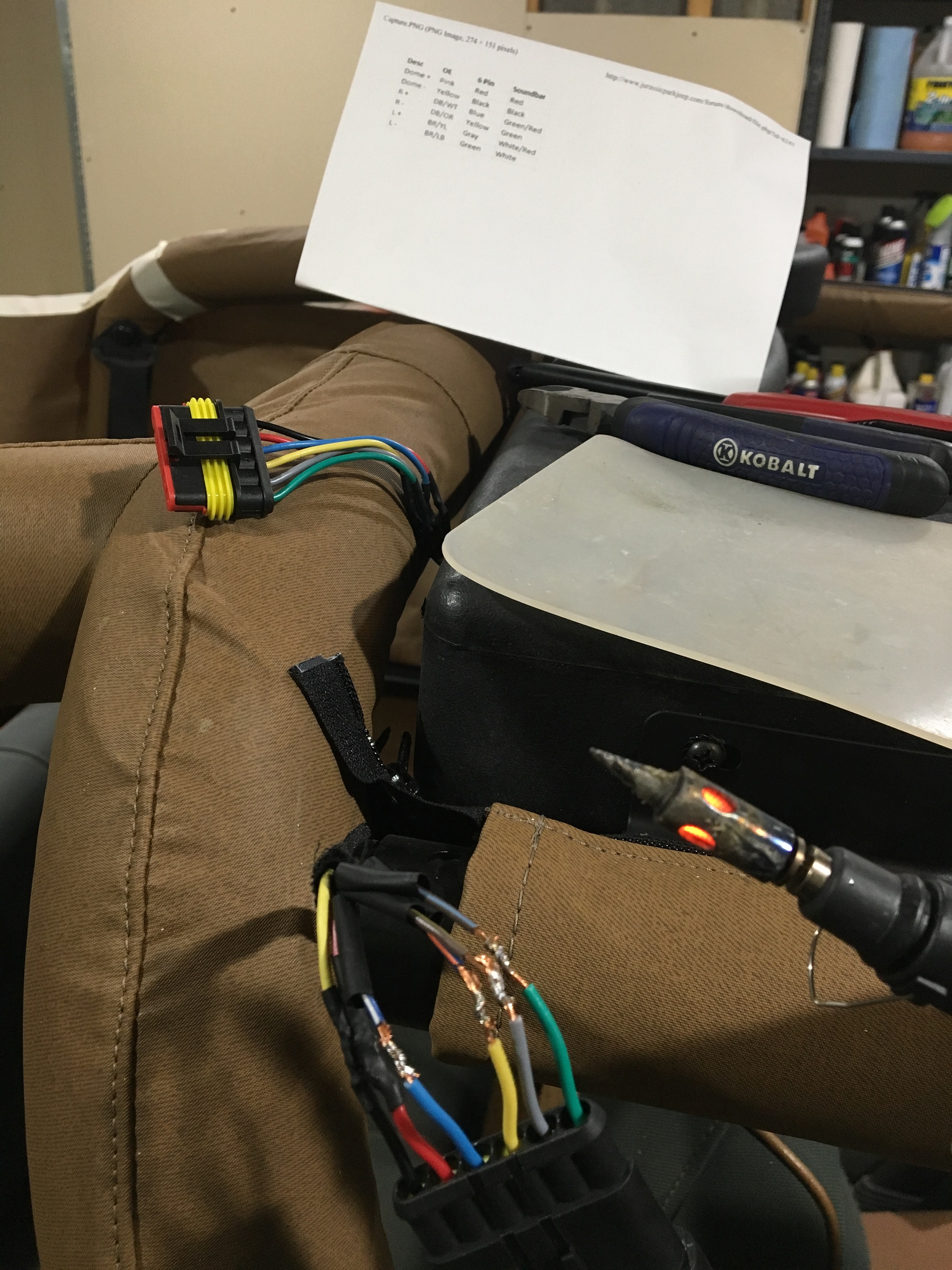

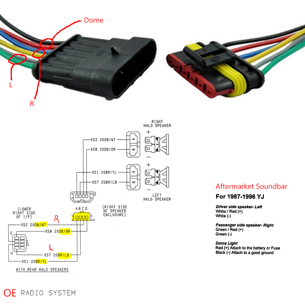

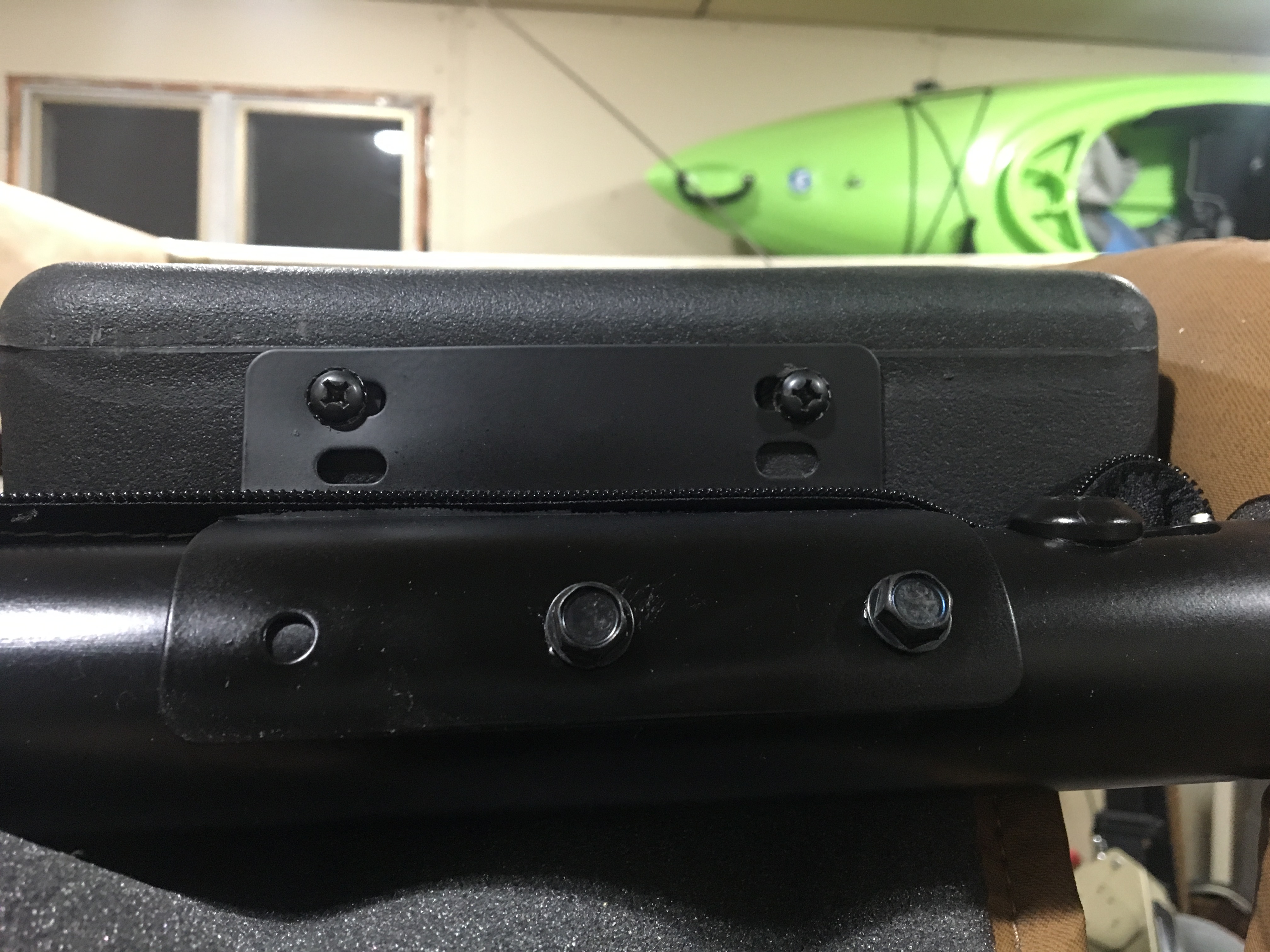

I picked up a sound bar, it's not OE but I'm okay with that. The bracket holes didn't line up with sport bar tappings, so new holes and fresh paint solved that. The supplied hardware was the wrong thread type as well, thankfully I had what was needed laying around. And because everything else was going so smoothly, the wiring harness is completely different. That's okay I tracked down the factory wiring diagram (assuming PO didn't rewire down below) for that they call "halo speakers" and I'm going to rip out both of these garbage molex plugs and solder in proper 6 pin waterproof plugs.

Right, it's a tow eye not a jet turbine. I have many sources including some local fab shops quoting it, I'll find a reasonable supplier.
I'm going to make the hole 13/16" instead of 1/2" such that it will accept standard 3/4" shackles. Will anybody have heartburn if it doesn't match the movie's pretty much useless 1/2" hole?

I'm good, I think being useful is better than being 'canon", I hate that word.

KytorIndustries wrote:I'm going to make the hole 13/16" instead of 1/2" such that it will accept standard 3/4" shackles.
That's a fantastic idea actually.

It was really damn nice to do some "clean" work for once. Wiring and soldering is relaxing compared to fighting stuck bolts, walking away like the Tin Man covered in anti seize, or sanding, painting and buffing. I'm glad to be over the hump. All that is left to paint at this point are the corners (four main wheels).

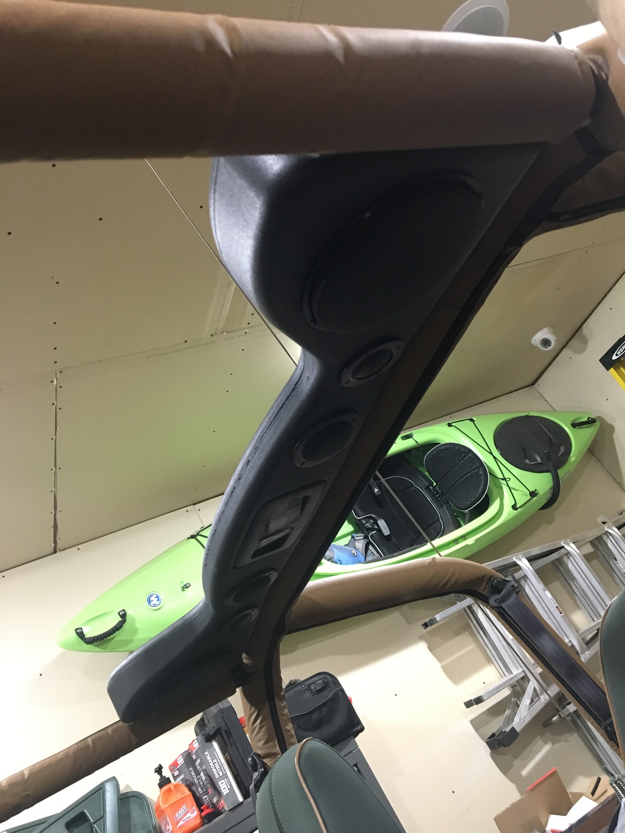

The soundbar is fully wired, I replaced the bulbs with 194 LEDs and wow, is this sharp looking. The lights are fantastic, no more fumbling in the dark YJ style. The six speakers sound great too. I have a Pioneer Bluetooth stereo coming in a few days and I'll pipe it in. Yeah, not movie accurate, whatever. I'm not suffering through cassettes when I can have Spotify.
