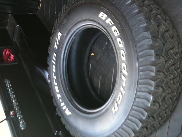

Score one barely used BFG AT in 30x9.5 for $40 off craigslist. Still need to hit the local pullaparts to see if I can find wheels.

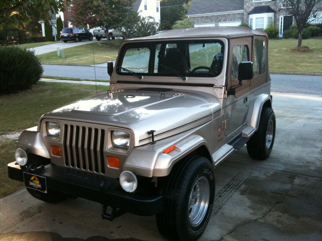

Made some small progress this weekend. My bumpstops were pretty much nonexistant so I found a set and got those put on this weekend. POR15'ed some more frame after needle scaling. Got 3 of them off with liberal amounts of PB Blaster. Broke a bolt and rounded a head on the last one. Ended up having to weld that one on. But that wasn't too big a deal. Located some 4 wheels that a friend had laying around, still need one for the spare. Also still looking for a lightbar, may investigate fabbing one if I can find a local jeeper that can bend 1.5 tube.
Found my JP plate so I hung it out front.
Actually pulled the Jeep out and washed it turned out nice:
Re: Dave's JP Jeep #14
Tear.
It looks like mine should look if mine weren't all rusty and dirty.
Looks GREAT.
Looks GREAT.
