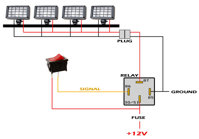

So I got the lightbar mounted with the lights, aaand the lights aren't turning on. I checked the switch, it does work (it's a OEM TJ switch that lights up) and the lights were working before I connected them to the relay.
There is 2 relays, witch is 1 for each light. So I figured that the lights should work if I run one switch to power the two relays witch in turn should power the 4 lights.
Now am I doing something wrong here? I wired up everything correctly (I think) and I checked the light bulbs, is there anything else that could have gone wrong? :(
Re: New Mexico JP Jeep 04!
Post by ImperialTrooper » May 3rd, 2014, 1:15 am
Not sure if this helps but I'll post it anyways.

Finally got the lights on the lightbar working.
@ ImperniualTrooper that wiring diagram that you posted isn't right, there needs to be another relay, but thanks for the help anyways:

Post by fantomas » June 19th, 2014, 5:39 am
Depending on the amp draw and wiring for the lights, one relay could have been fine. I took a quick look at your videos... did you ever make a tutorial for the NV goggles you made?
